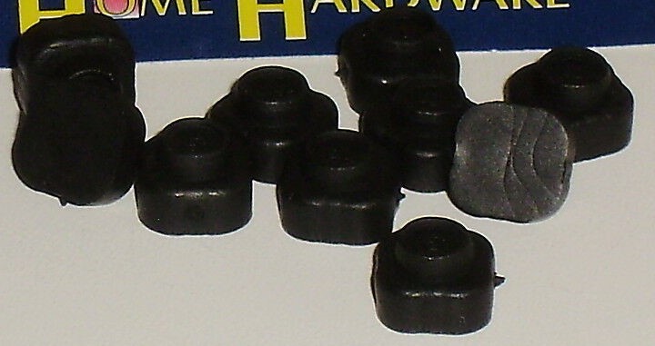

    Is there a book with all this info in ????? ](*,)](*,)](*,)](*,)
    I have a kit with 2 of these in it....
  2. David Shouksmith
    Just the various instruction leaflets posted in the library section here - oh, and getting on for 20 years experience tinkering with the little buggers.
