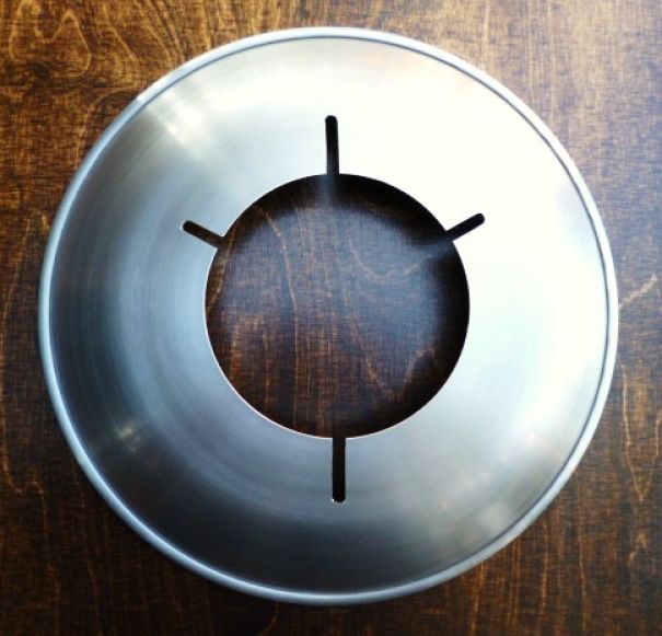

    Hi all, This is the latest effort by myself. I have made the slots in the PL53 version. I need this to complete a SL61 Hospital Lamp Kit.
    I used much the same method as the earlier KL80 reflector that I cut. But, this time I marked out the inside and outside diameters on a piece of cardboard. I then marked out vertical and horizontal axis's across. I then marked out the 60 degree axis's for the other slots.
    I then placed the reflector (inside up) on the marked design and transcribed the slot dimensions to the inside of the bowl. Made a centre-punch mark to show each drilling point, and then a progression of 2 to 5mm drill holes. Next, as before, cut down to meet the hole edges, to give a 5mm wide slot. Finish off with Swiss files to get a nice smooth finish. If I can do it, I am sure that anybody can. And it fits :D/ :D/ :D/ Have not tried doing the IL33 yet though, psyching myself up for that baby :shock: :shock: . Steve.

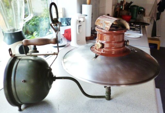

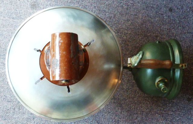

    That is good news David. I have just cut the slot for the Tilley X246 Reflector and show a couple of pictures for it. The X246 reflector slots can be cut to fit the early drop-loop handle (at 5mm wide) or can be cut at 14mm wide to fit the later Tilley latching handle. I am glad to say that cutting to the larger 14mm wide slots still allows the reflector to fit the earlier drop handle version. Here are the pictures - Steve.

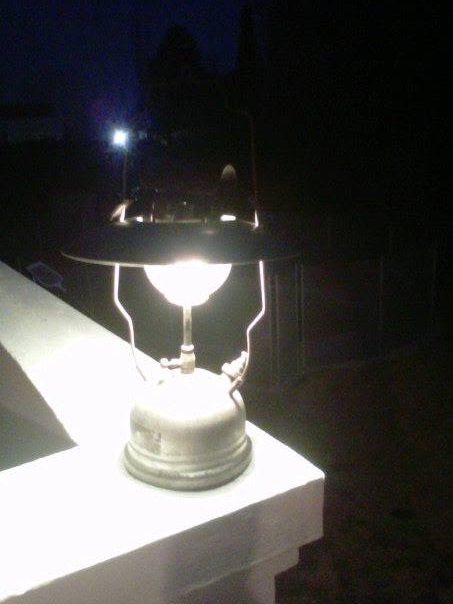

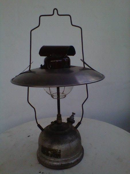

    I worked this afternoon on it but I still couldn't pint it. I'll do the next weekend. Not completely bad!
    It is almost complete now: the globe came from a TL. This is the first time I light this lantern. It works fine. 1376953404-ex100.jpg 1376953421-ex100light.jpg
