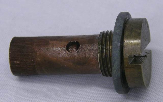

    I have just looked the detail images and I am in no doubt this was factory made like this. Makes it a very interesting and seriously rare piece which I would love to examine and photograph up close although the images you posted are pretty good. We may never know if this was a prototype or a very early production but either way I have never seen or heard of another. It is indeed another variation and will have to be listed. Complicated game this. 5 years ago there was one SDR and a rare thing but simple for me to list. Now there are 4 and I have to get into details to list the differences. This is a very good and interesting find. Take good care of it please. ::Neil::

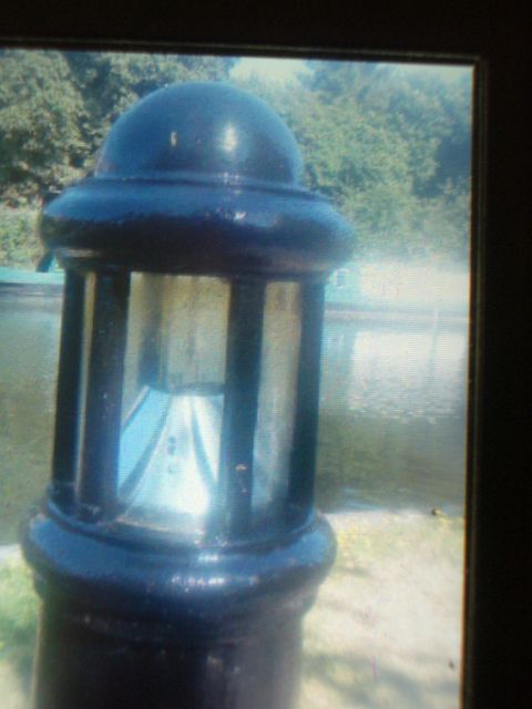

    One of the things I find slightly amusing on some of these old lamps is that they employ the same reflective cone idea as modern LED lamps...
    Yet for some reason the idea was out of favour with most manufacturers for many years which makes me wonder why.

    Something like this you mean:
  27. Gneiss
    Gneiss Subscriber
    Oct 7, 2012
    1,590
    Exactly :thumbup: Lots of those ghastly LED camping lights have them too...

    OK I have had Rob and this lantern here this morning. No question this was made like this by Tilley. The fittings in the tank are located in rolled out openings which has to be a factory job. I removed the NRV to see what it looked like. We did not unscrew it because it is working and I did not want to disturb the inner seal but you can see it is in the style of a Vapalux but actually a tad smaller.
    You can see in Rob's original images that this lantern has a 777 GF cock which was used on all lanterns up to 1945 and not the self locating 2563 cock of the other SDR types and all lanterns after 1945. This I believe makes this lantern earlier than all the other SDR types so this is possibly the first lamp to use the Pork Pie tank and probably dates the tank to 1945 or very early in 1946.
    The half mirror backed globe is listed as Tilley part 278 and although the example on this lamp has no markings I am sure it is the original globe.
    Prototype or first production run? We may never know. Right now this is unique but maybe there are a few more out there yet to be found.
