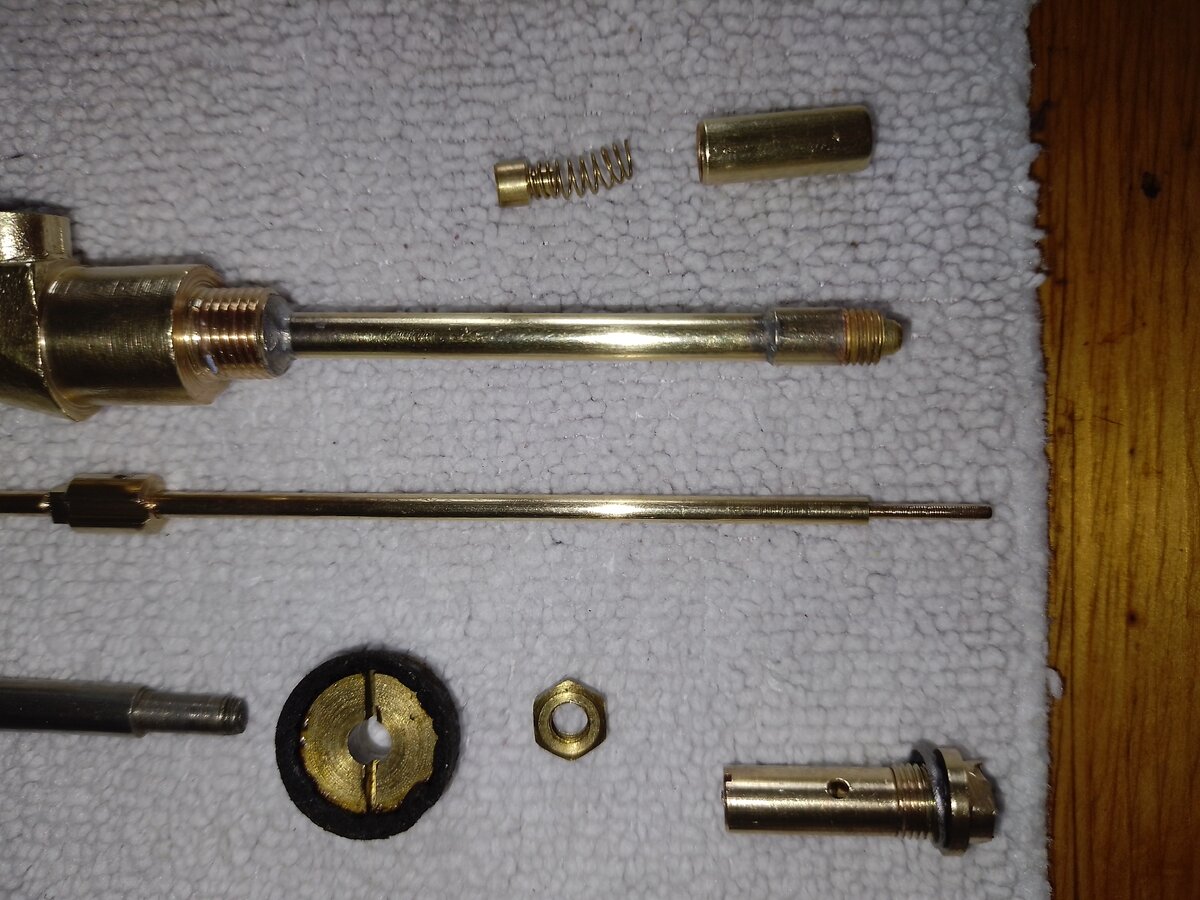

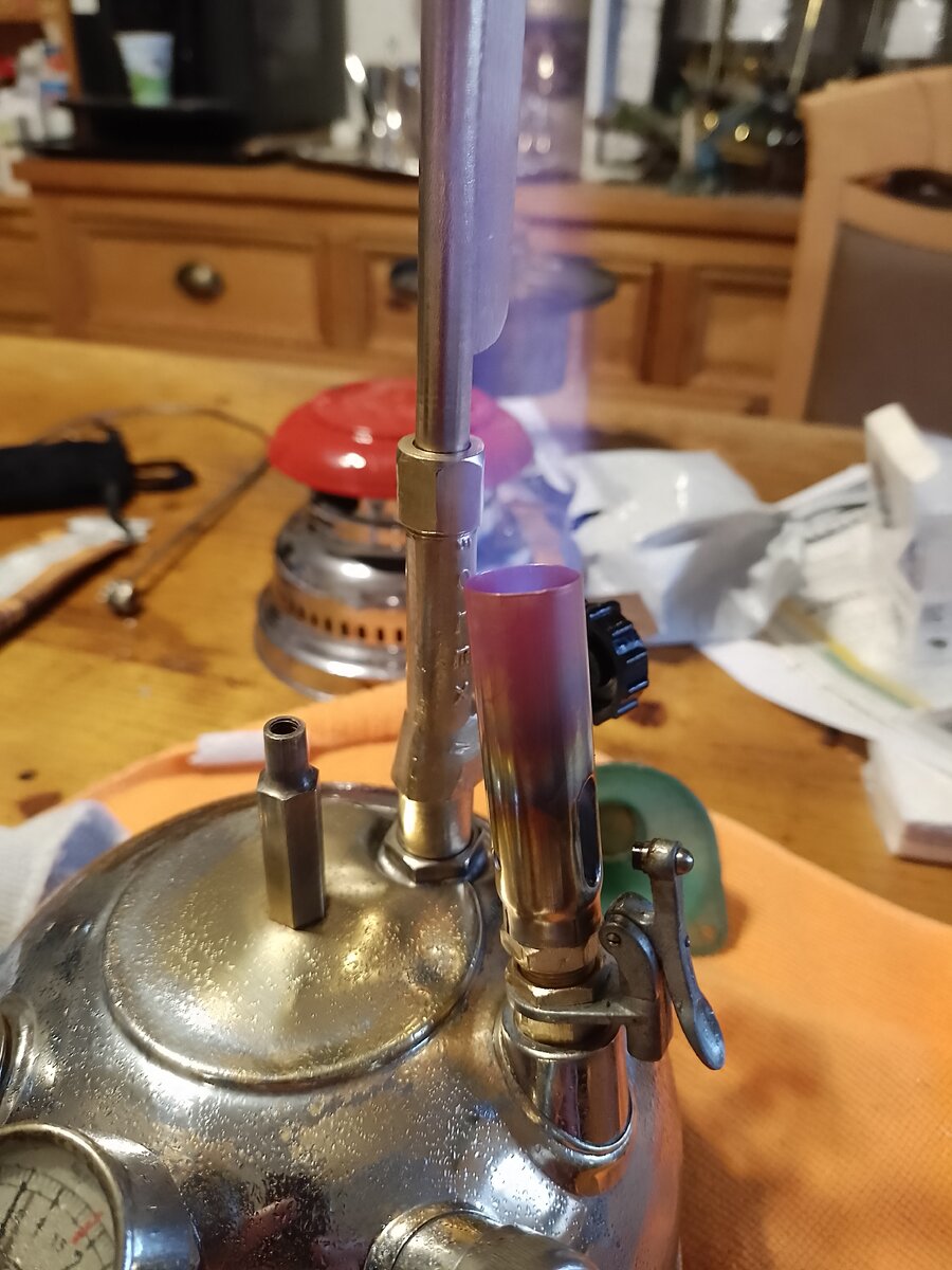

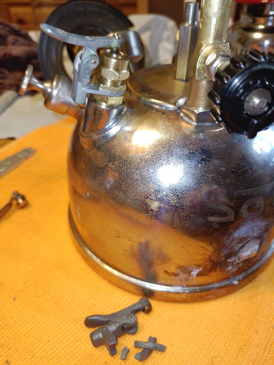

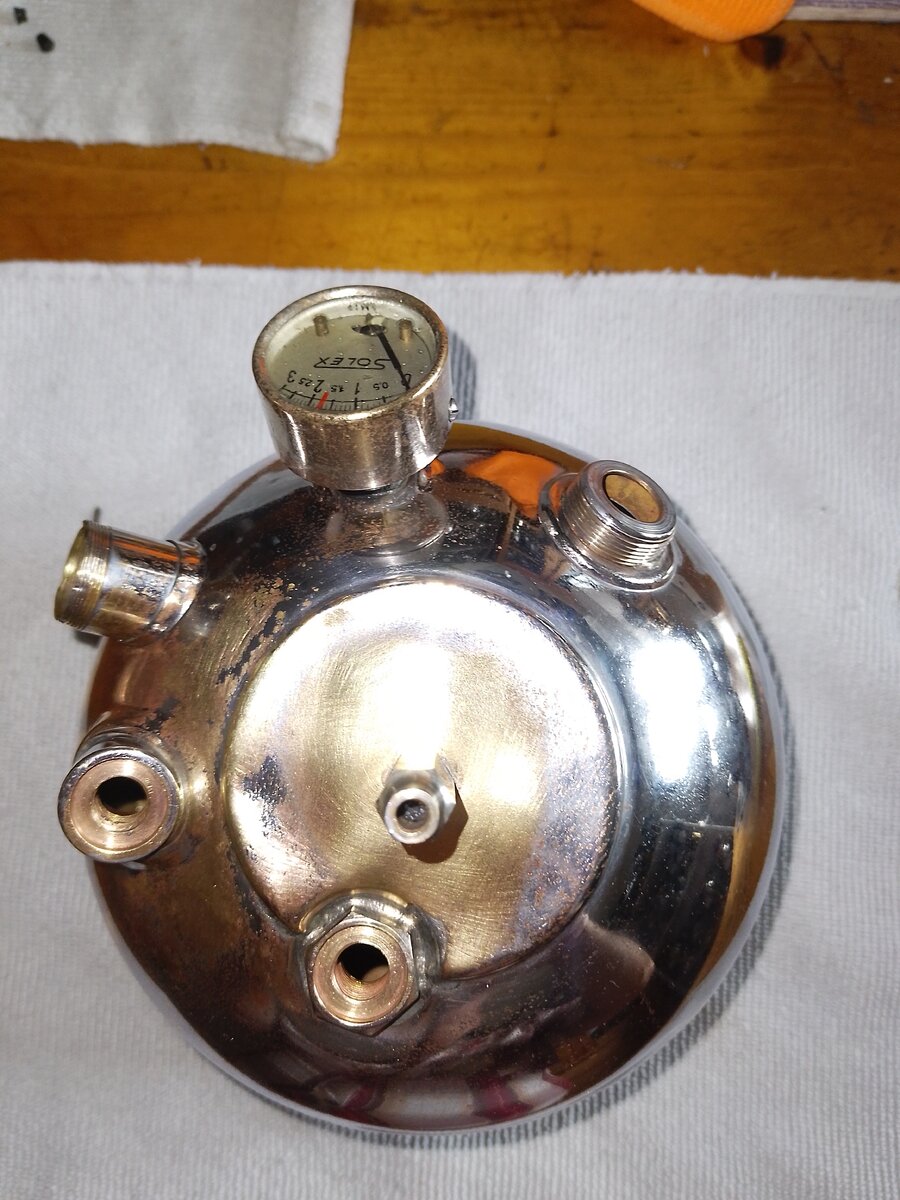

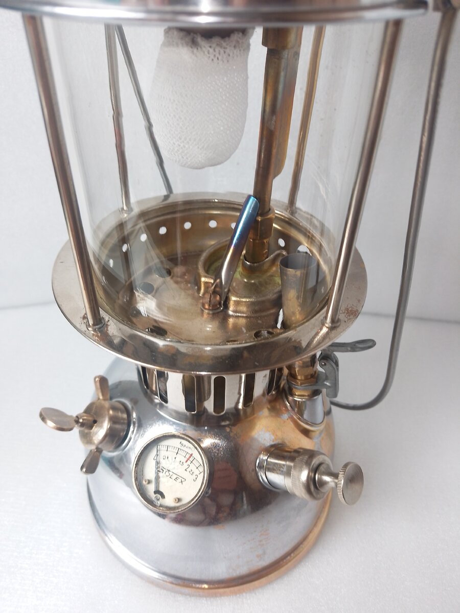

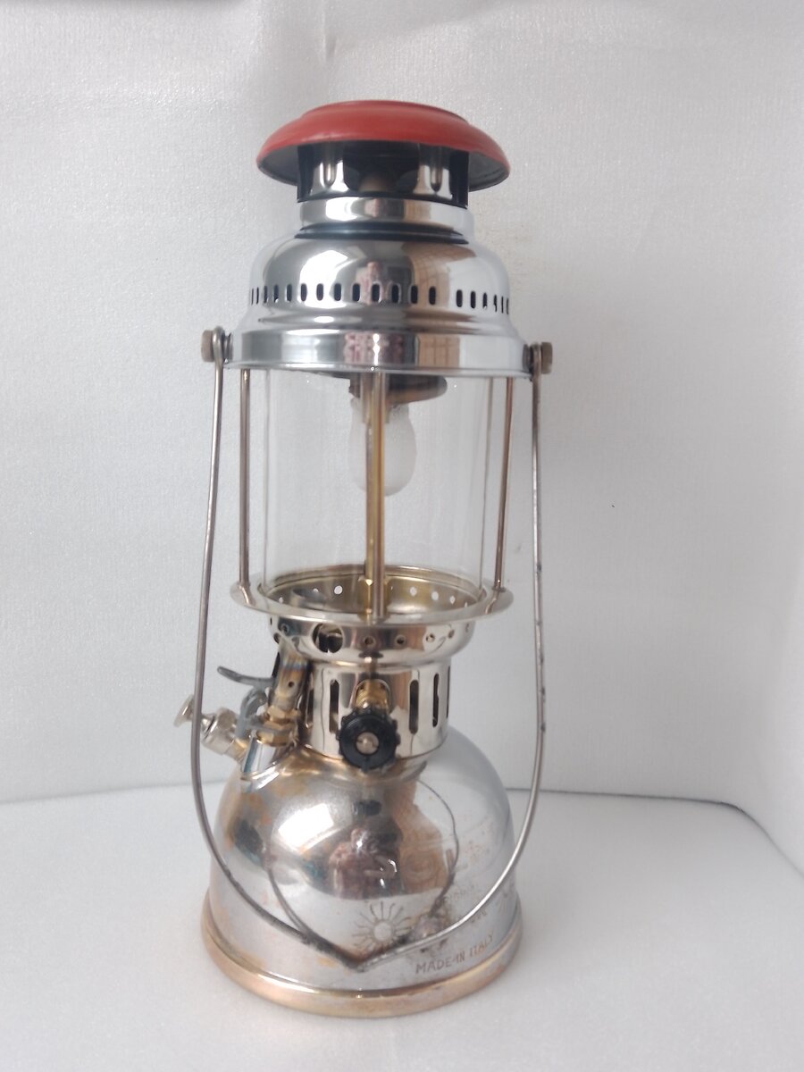

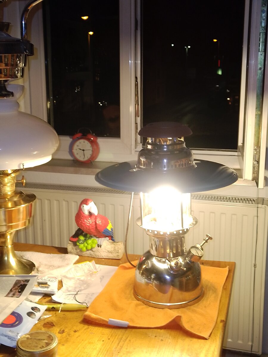

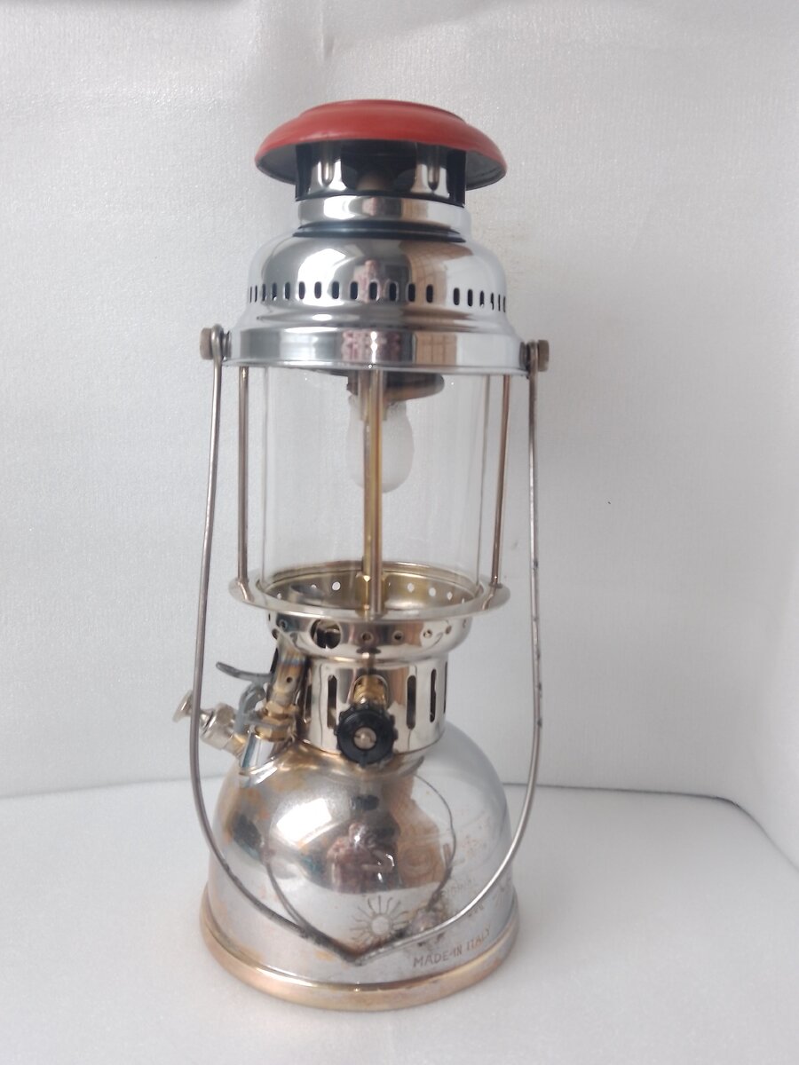

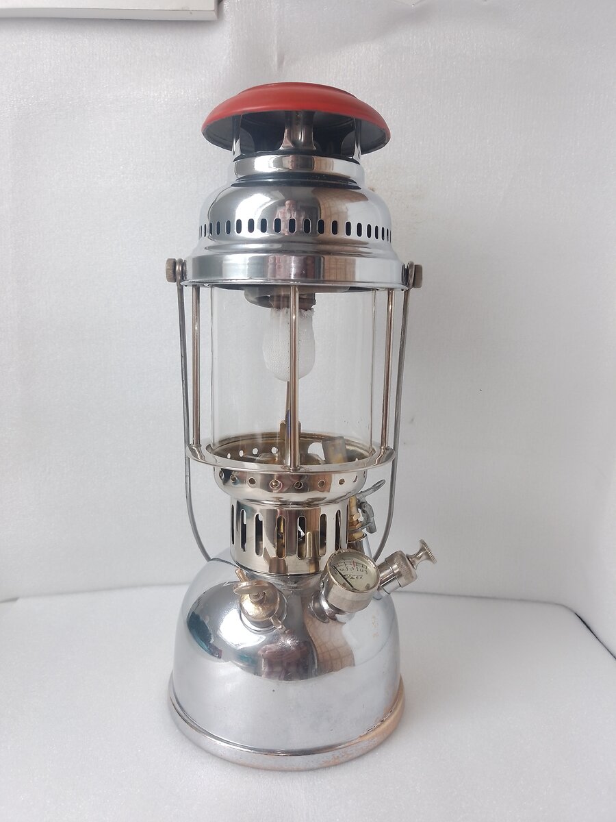

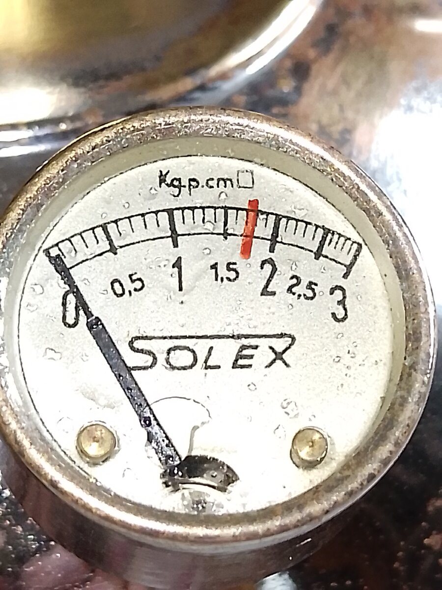

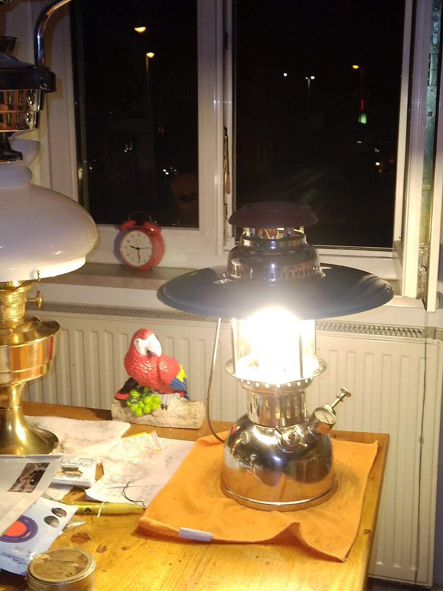

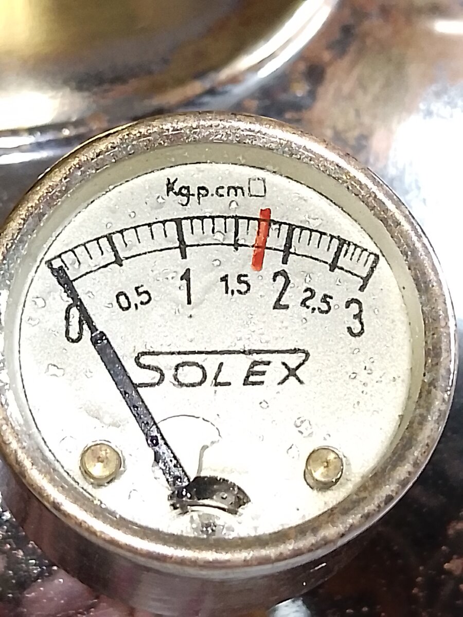

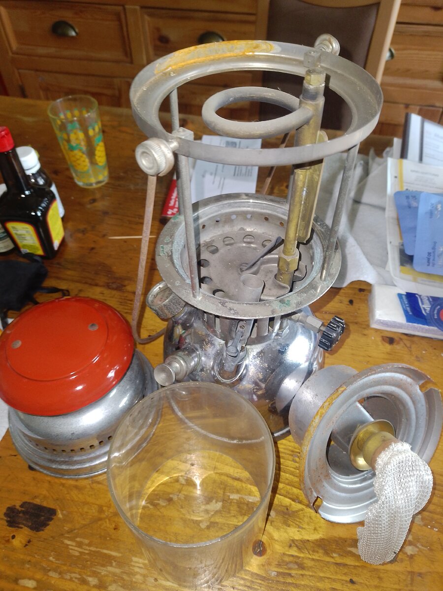

    Until now,I was unaware that Solex also manufactured lanterns with an output of 500HK-and even equipped with a rapid preheater.

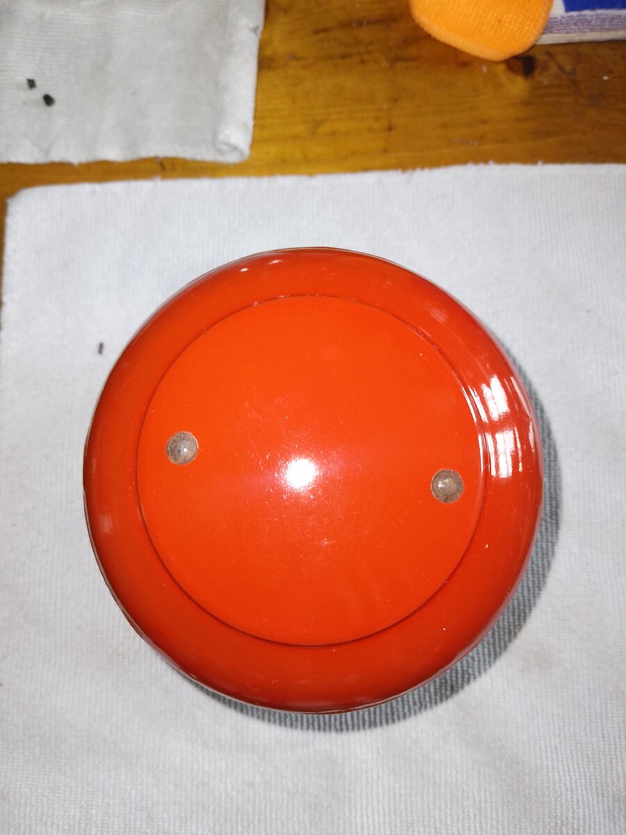

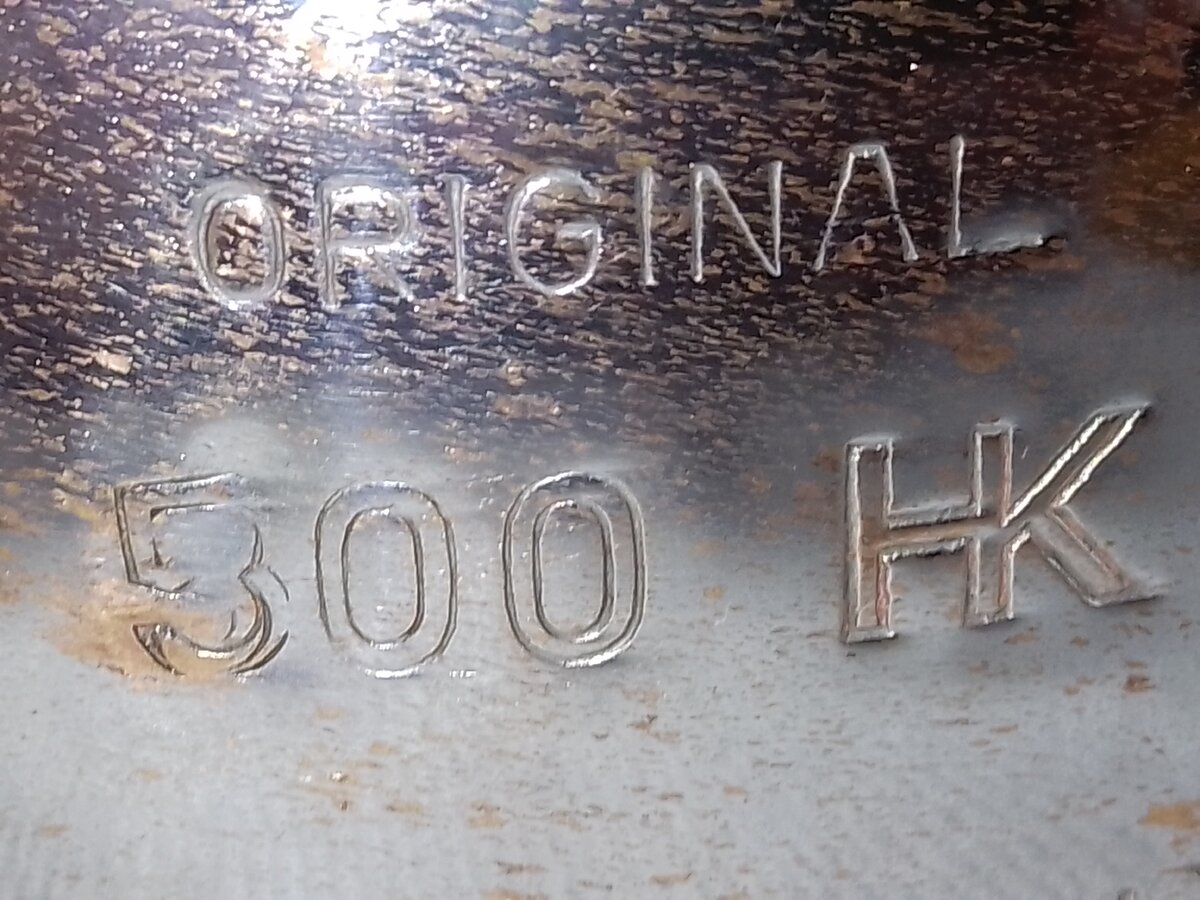

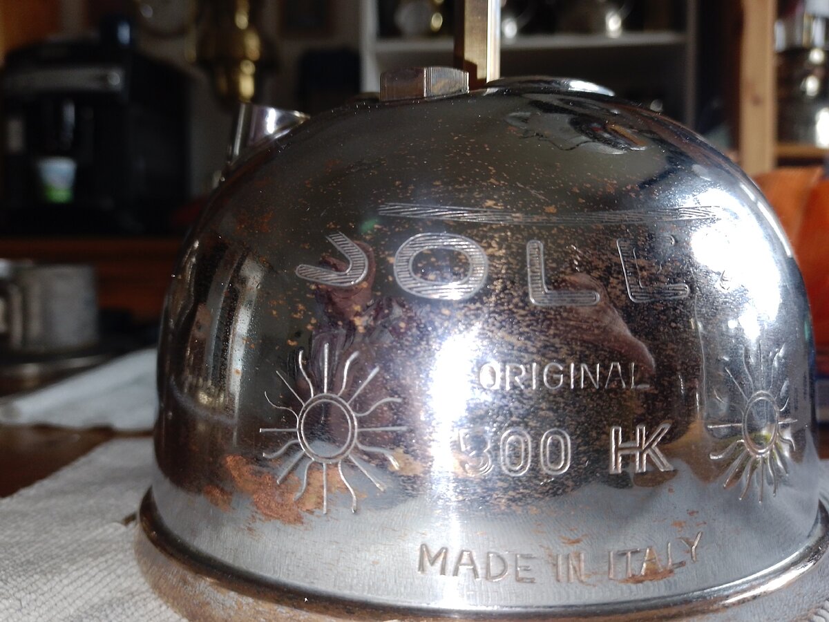

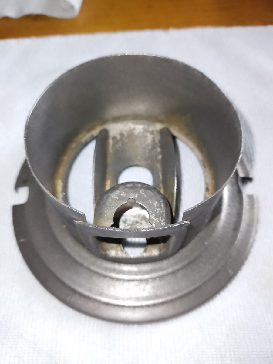

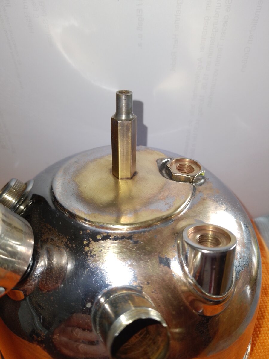

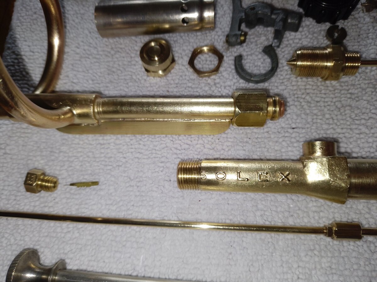

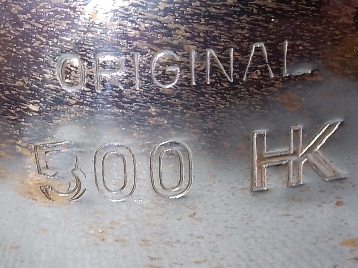

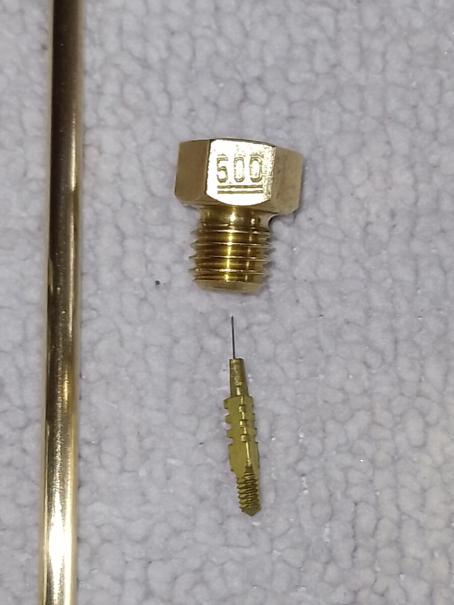

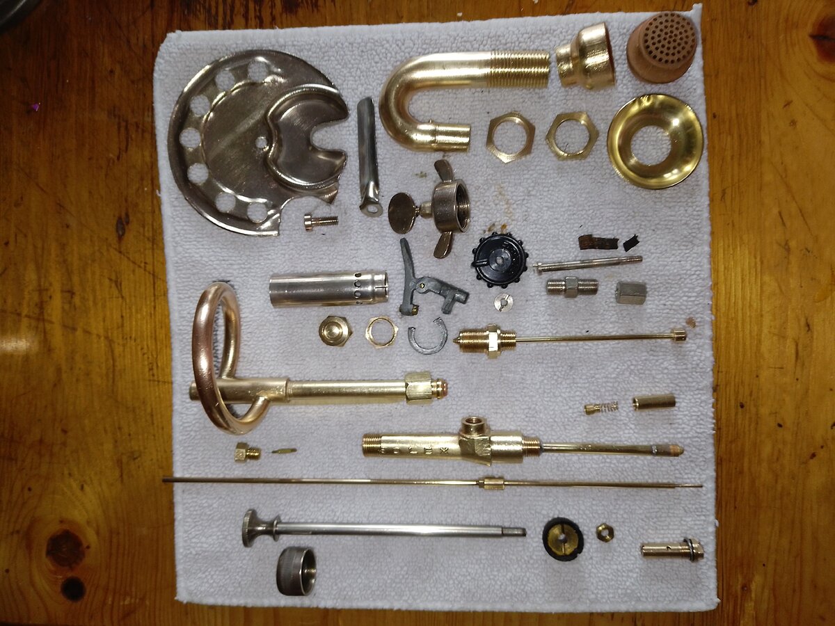

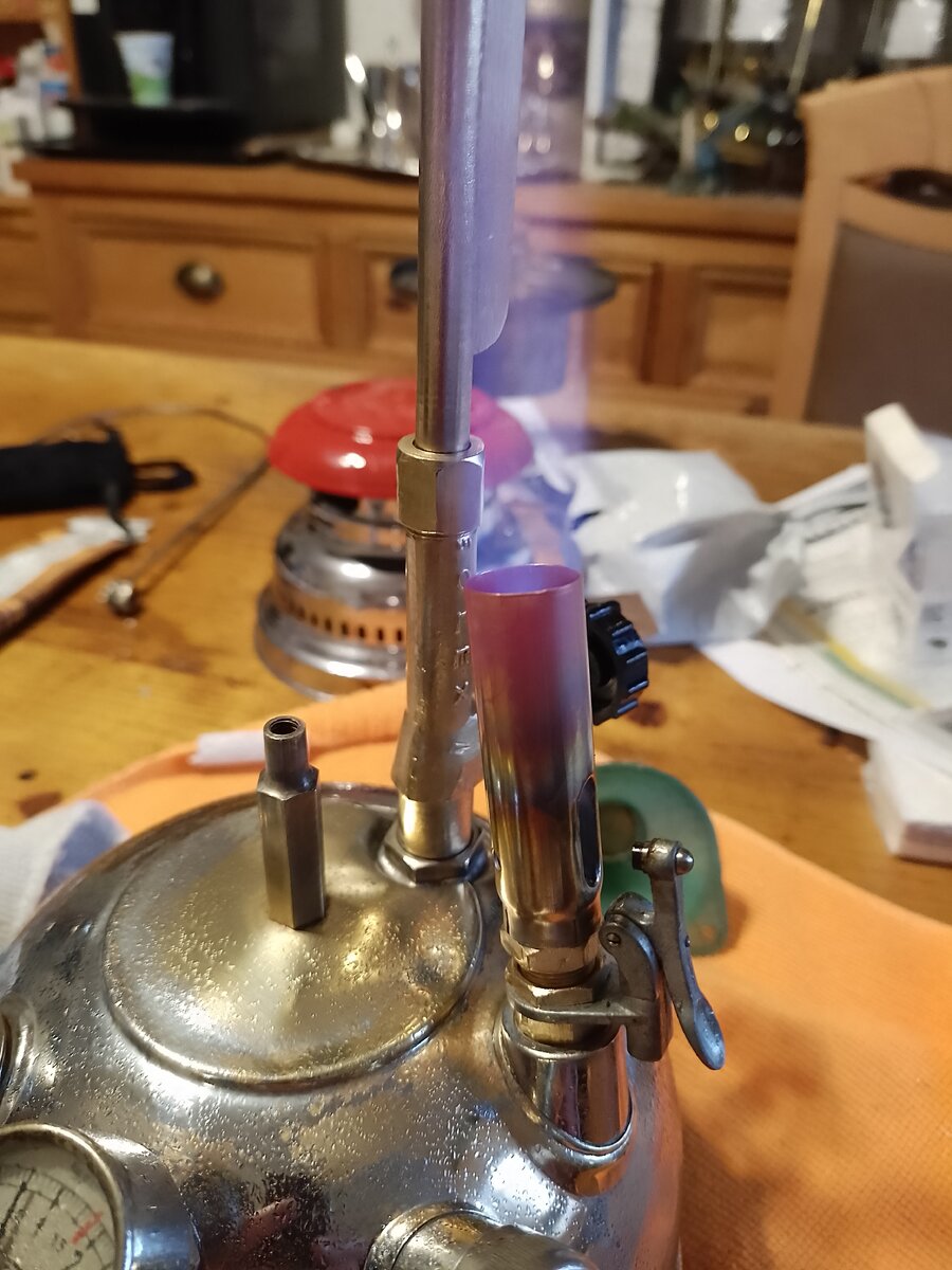

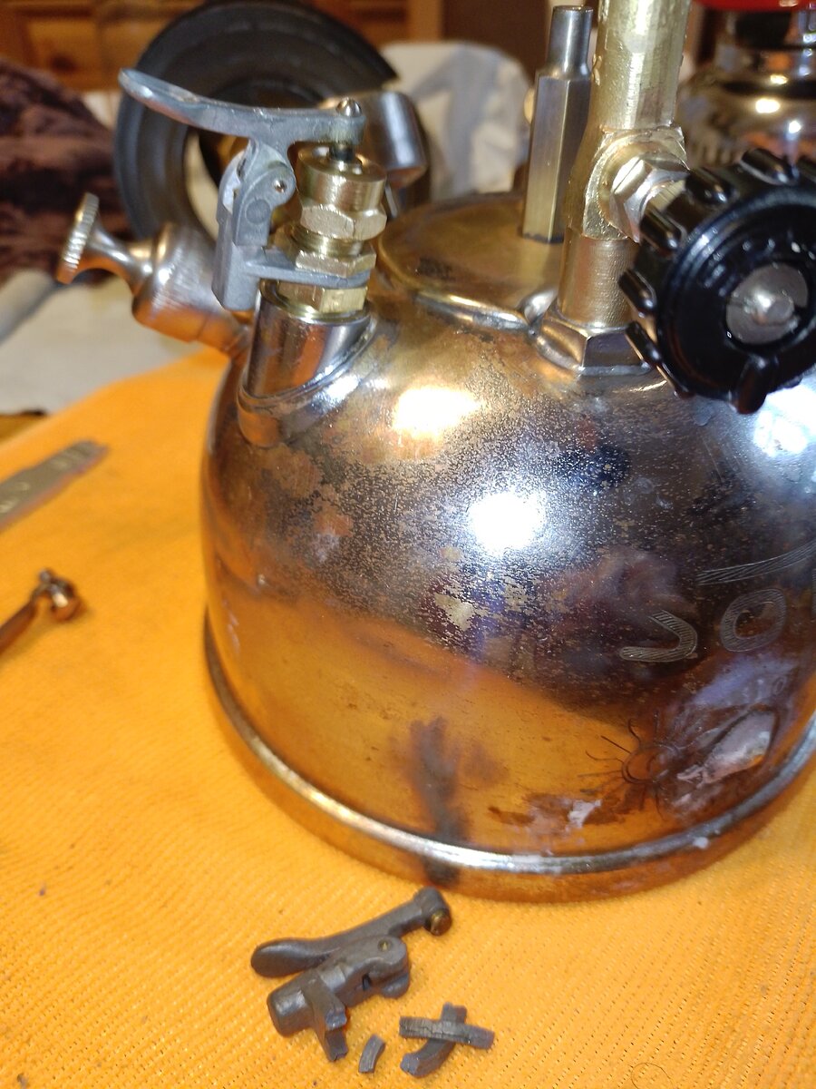

    This preheater,the upper section of the carburetor featuring a broad, outward-facing fin,and the red-enameled hooded cap bear a strong resemblance to Petromax Rapid models from around 1940. It is likely that this Solex 500 HK dates from that same period.Originally,"300 HK" was stamped on the tank ; subsequently, the "3" was overstamped with a "5". Right at the 5 , the tank had two holes . During disassembly-despite my utmost caution-the die-cast zinc ring securing the Rapid lever snapped off;however, I happened to have a nearly identical replacement part from Petromax in my stock.

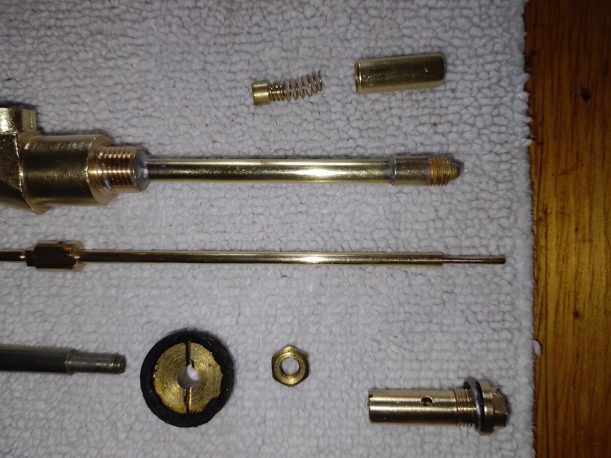

    This italian pressure lamp , too, lacks a compression spring around the pump rod and a locking mechanism for the pump knob on the pump cap.

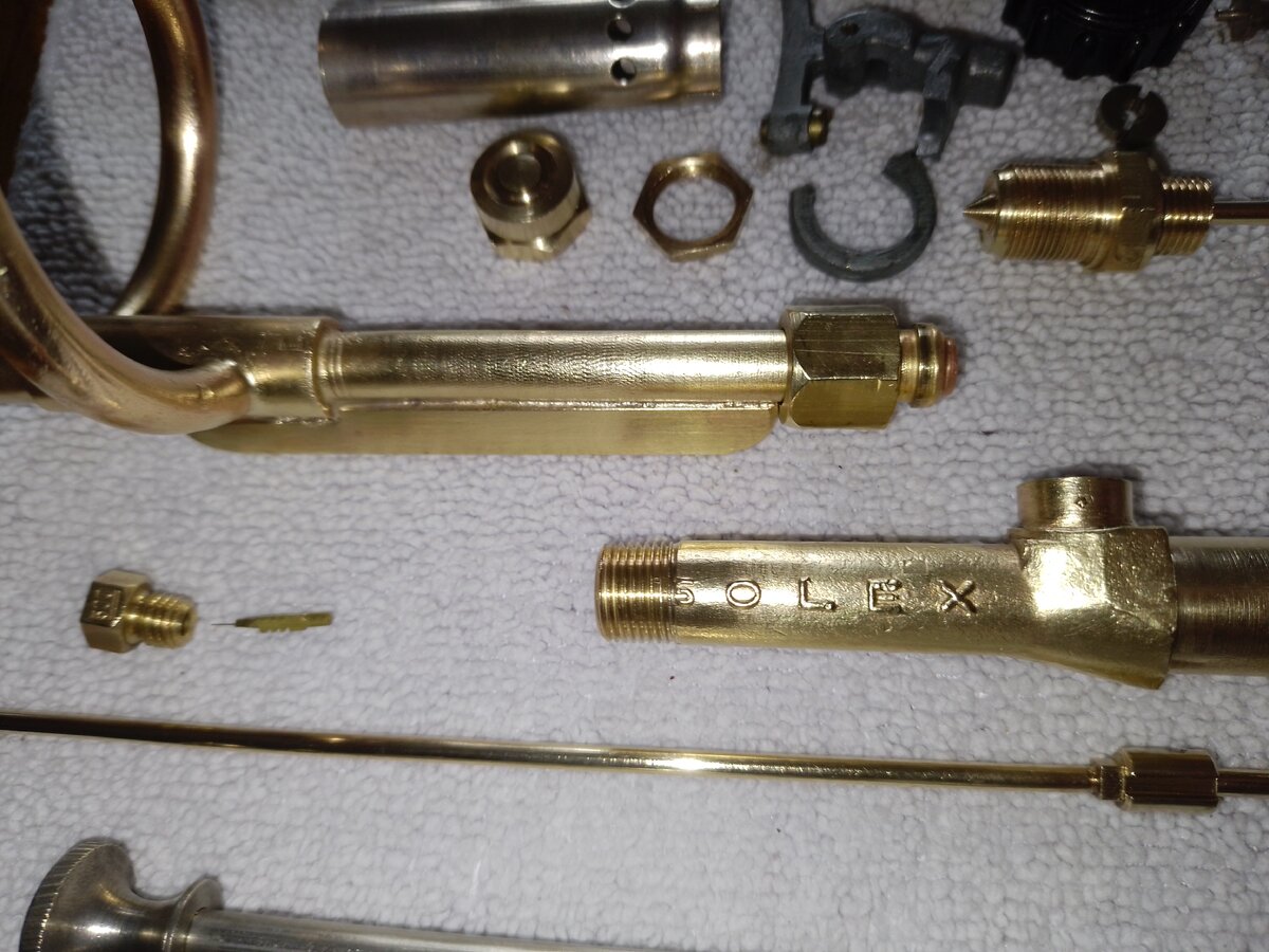

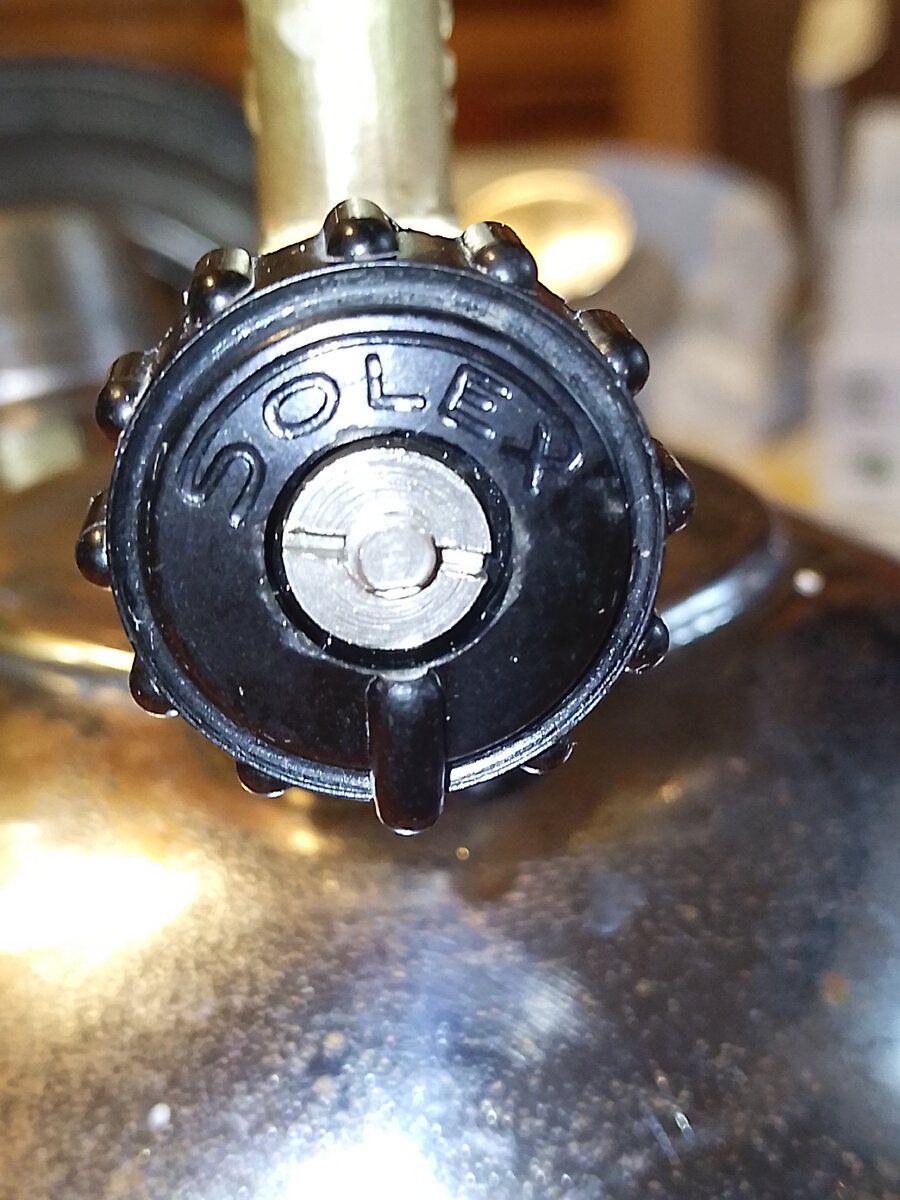

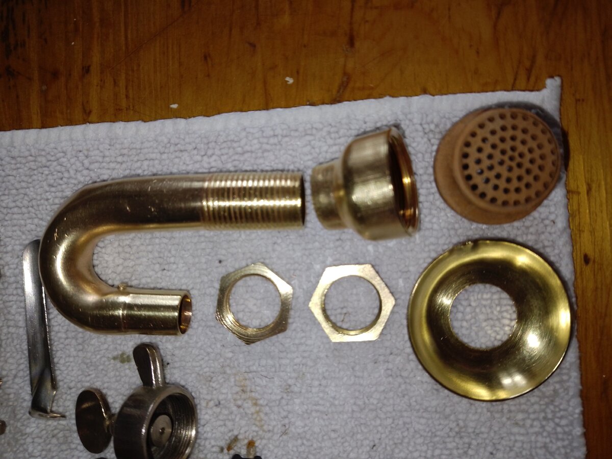

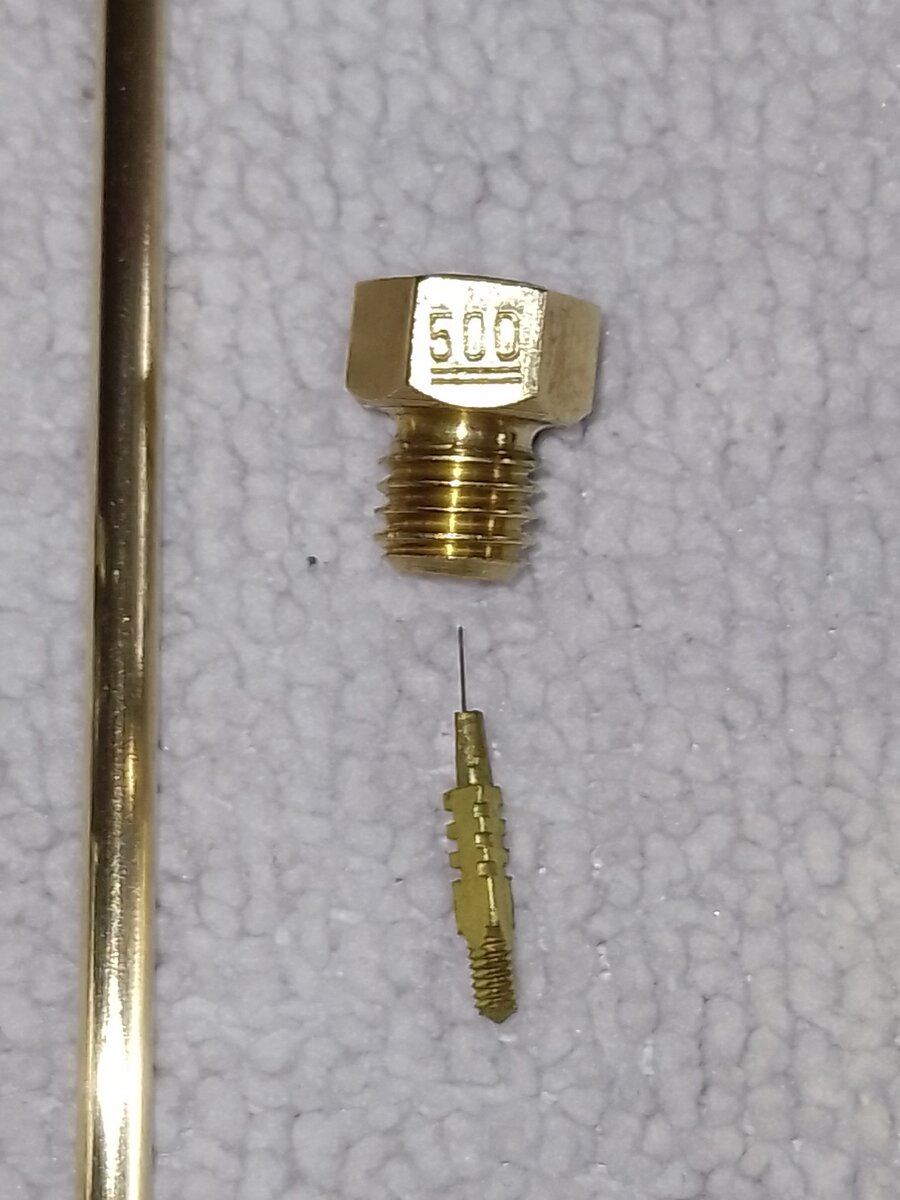

    The J-tube features a soldered-in wire,instead of a movable paddle; the connector body #224 had three airholes-whereas Petromax models had four,and later two .All the parts differed slightly from these found on Petromax lanterns . The hand wheel ,marked Solex bears a distinet resemblance to these found on Italian FAIR pressure lanterns.
    Incidentally, the resemblance between the ItalianSolex/FAIR lanterns and the German Petro Pintsch lanterns from the early 1950s is striking .
    IMG_20260515_123541.jpg IMG_20260515_123642.jpg IMG_20260515_123718.jpg IMG_20260514_191016.jpg IMG_20260514_202836.jpg IMG_20260514_212919.jpg IMG_20260513_171617.jpg IMG_20260513_171634.jpg IMG_20260513_172442.jpg IMG_20260514_191057.jpg IMG_20260513_171802.jpg IMG_20260513_171714.jpg IMG_20260513_171329.jpg IMG_20260513_171444.jpg IMG_20260513_171409.jpg IMG_20260513_171226.jpg IMG_20260513_171251.jpg IMG_20260513_171122.jpg IMG_20260513_171153.jpg IMG_20260512_182743.jpg
    16,615
    It's working well.:thumbup::thumbup:
