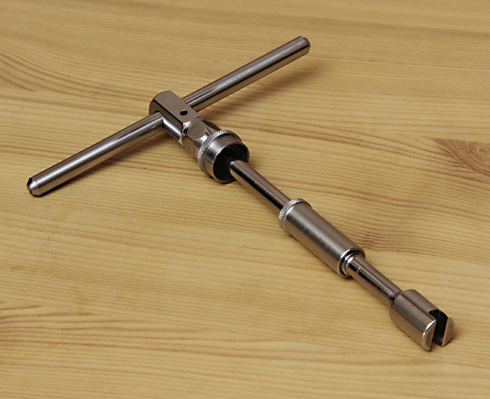

    The critical part is that it locks the tool head down onto the NRV head. It cannot rise up or slip. That is why it works so well even on mangled or very tight NRV's
  2. Carlsson
    3,937
    Yes, a locking tool is the absolutely best for these.
    The soft brass of the NRV is no good for real force, and you seldom get a second chance if you start to mangle the head.
    If the tool don't get a chance what so ever to climb of the head, much is won in the first place.
    Here's one of my versions where you can adjust the support to make it fit tight even if the lead washer is missing or the NRV for some other reason sits higher or lower than meant for the (rare) original Primus lock-down tool.
    Or perhaps if you have an apparatus with an off standard pump tube length:
    [​IMG]
  3. MYN
    3,797
    That tool certainly looks neat and dedicated for the job, @Carlsson.
    Is that a special tool that you bought somewhere or custom-fabricated?

  5. Carlsson
    3,937
    It's custom made. I got tired of destroying NRV's many years ago, so I made a couple of improved versions of the original lock-down tool.

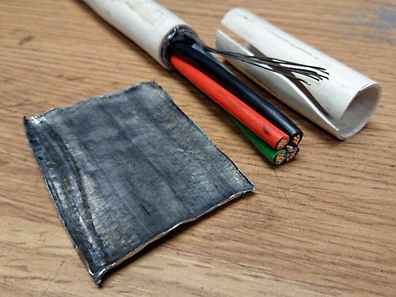

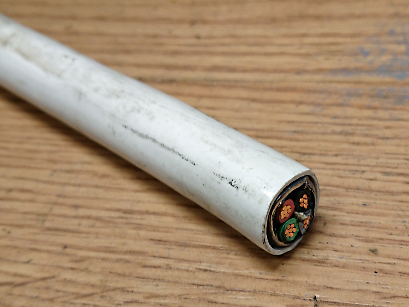

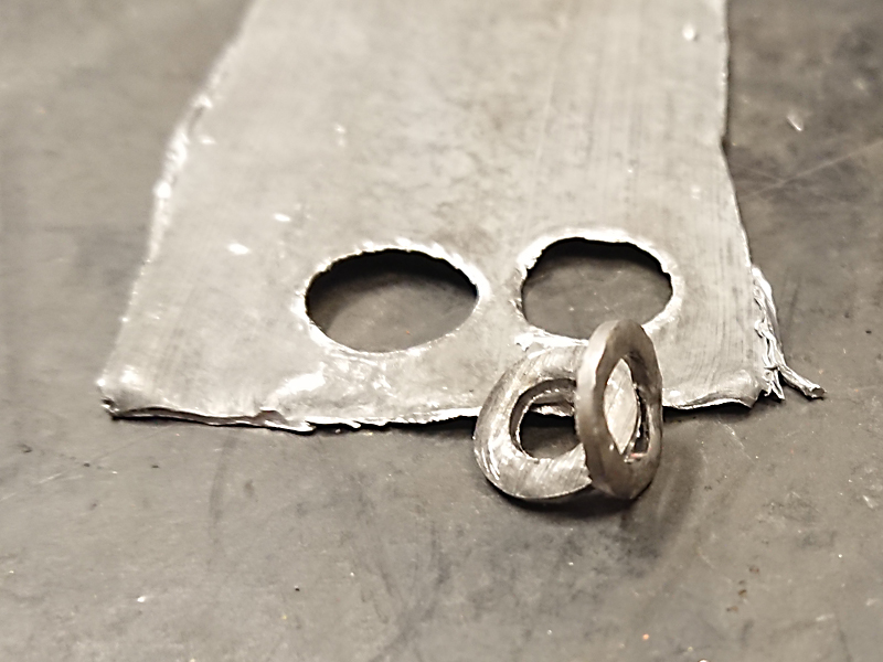

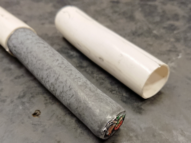

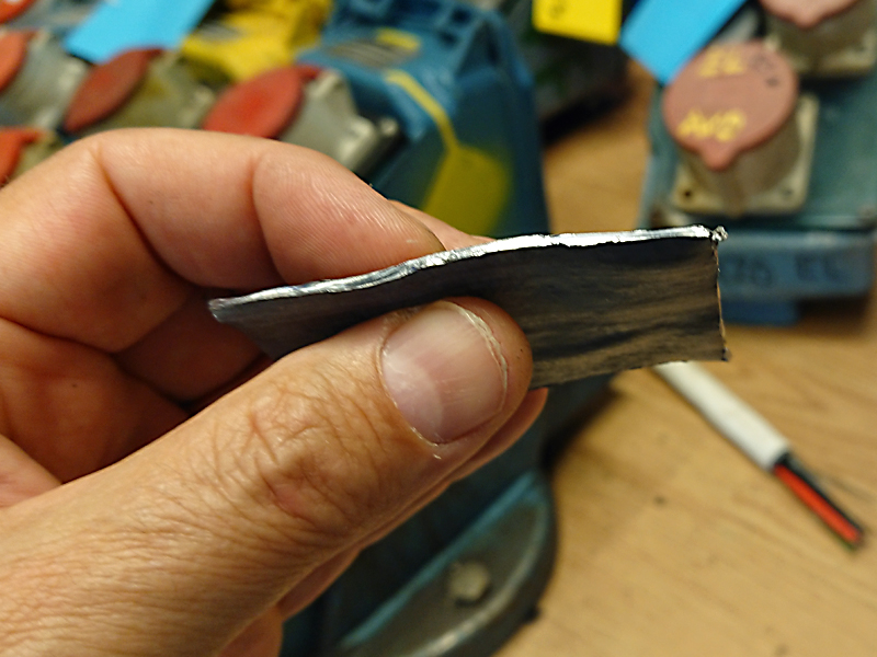

  15. Carlsson
    3,937
    No, they are not sold anymore. But I was hoping you worked at a place where you often re-do, modify and modernise the installations and then the lead-sheathed cables probably would be easy to get hold of in the scrap bins.
    The plant where I work was build in the 60's, and even if it is at a totally upgraded standard, many installations still are with the old cables, and due to the constant re-built of the different factory areas we got, I often see lead cables in the dumpsters.
    MYN, since you can't get hold of these cables now, what I write below is more as a general description for all in here since the cable lead is a good source of sheet for those who can find it.
    It's just to be seen as a general tip!
    I went to the cable scrap yard, and was lucky to immediately find a suitable cable. Not a large one, but good enough: a 4x10mm.
    It's just to peel off the outer, plastic layer to expose the lead sheath.
    'Circumcise' it, then cut it lengthwise and flatten it out, et voilà: there's your sheet!
    About 1.2 mm thick, which is good enough to most of the applications where a lead washer is needed. And so much easier to punch out a washer from than thicker lead. If a thicker washer is needed, you can always use two.

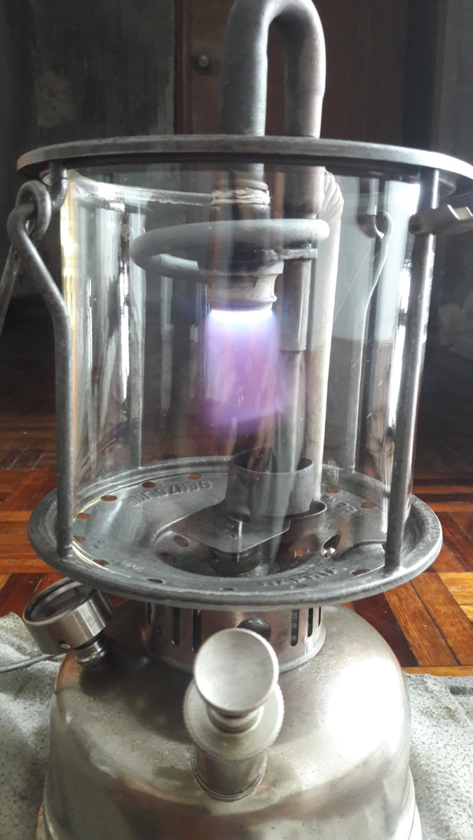

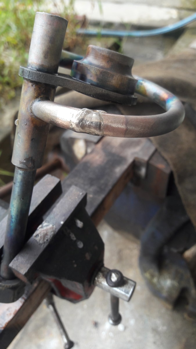

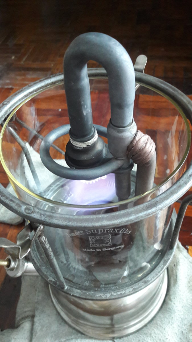

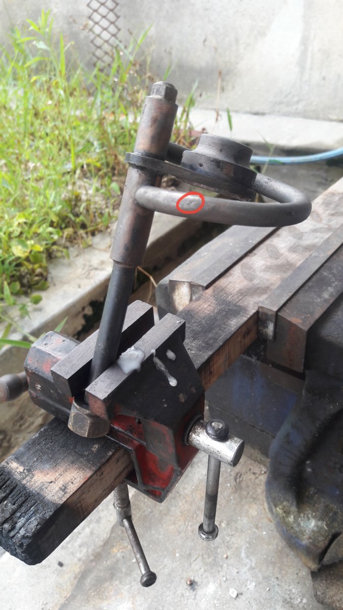

    Some updates on this hybrid Primus:
    I found a tiny pin hole on the generator after some heat-quench carbon removal routine. This I tested with 8bar of compressed air.
    Since I did not have any spares, I had to braze it up with some silver-brass alloy with an oxy-acetylene torch. Not a neat job but it sealed that pin hole up. 20180911_120927.jpg
    No attempts to touch it up or smoothen it further as I wouldn't want to accidentally melt a bigger hole through the generator loop.
    I did not polish the lantern. Just removed all the grime and red rust. Left the patina on.
    I re-assembled the lantern except for the hood. Rubbed it with some WD-40 and machine oil to temporarily prevent flash rusting on the frame.
    I've wrapped the end of the mixing tube where its attached into the brass burner cup with a piece of asbestos cord so that it does not leak or draw in air from the joint interface.
    I also wrapped a copper antiseize impregnated asbestos cord around the air tube at the part with a hole that's not supposed to be there in order to seal off that 'additional' air intake. After that I lit it with its spirit cup preheater. Pumped up a few strokes and turned down the pricker rod just like for the usual Petromax-styled lanterns.
    No flare-ups but a predominantly blue flame but a slight occassional tinge of
    yellow during initial burn. The flame was actually much paler than what could be seen in these pictures. It got paler as it gets hotter.
    Although I've doubted that this hybrid could in any way work, its actually doing fine up to this stage. I've not attach any mantles yet.
    I did not turn the pricker all the way down either as the exposed flame would be long enough to lick the base of the cage frame and melt the solder.
    I left it on for half an hour to see if the flame would suddenly flare up into yellow/sooty fireball. It didn't. Just remained a steady blue which kept the generator sufficiently hot throughout the test.
    I finally release the air from the fount to shut down the flame.
