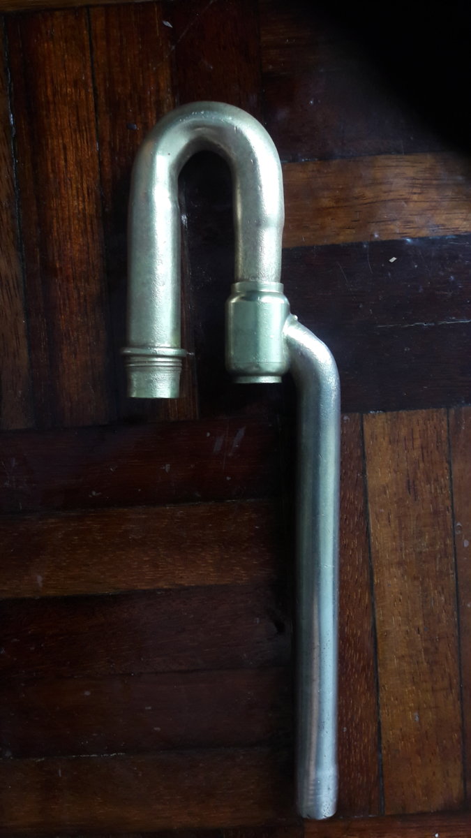

@phaedrus42 Well I've no choice but make do with whatever I've got now. I have plenty of asbestos string/rope/strips lying around and no problems buying them as they are still widely used here. Sure I could insulate the tube. I was having the same thoughts as you about the the sealing where the J-tube enters the flame spreader. I'll see if I could improve on that. Just before you mentioned this, I've found that the top surface of the jet might not be sitting at the height that I normally feel comfortable with. From my measurements with a vernier caliper, it seemed to be too far beyond the center axis where the air tube intersects the chamber. I'll try shimming it up 3-4mm and see what happens with the extra air tube hole remaining closed. Anyway, I've removed the tube to check for any tiny leaks and cleaned it up a little:
The nickel still looks very good. You can try sunscrewing the 2 tubes a bit from each other if needed. Sometimes they are screwed in a bit too deep.

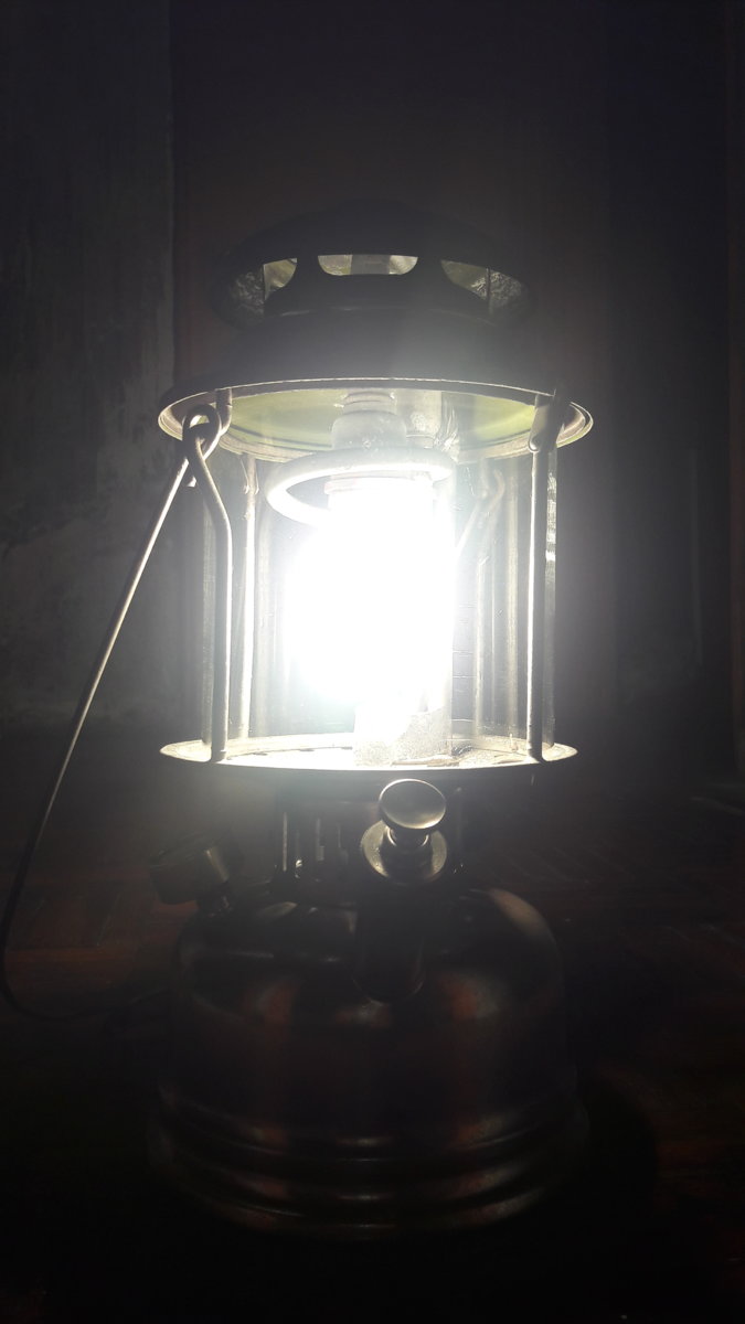

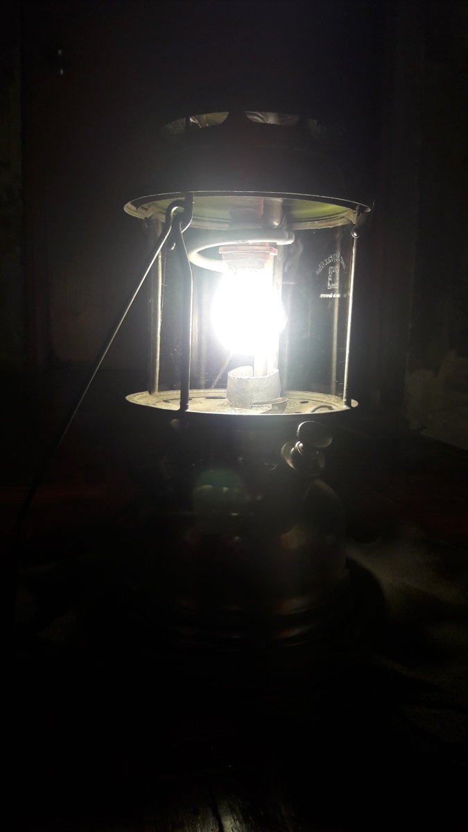

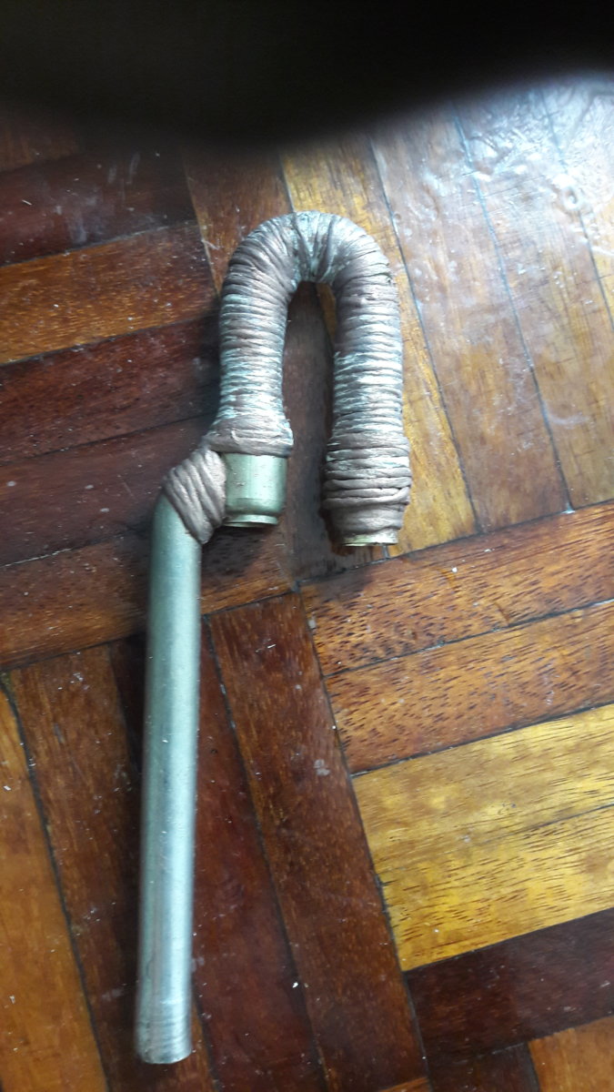

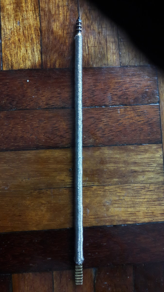

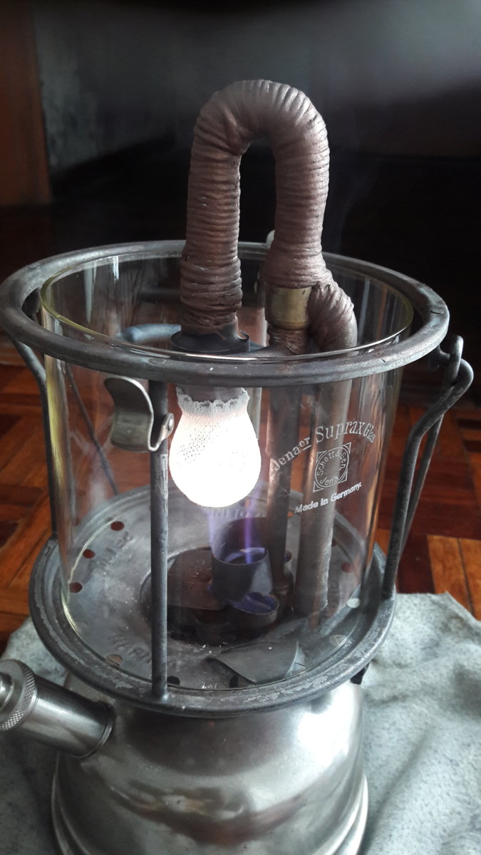

Here's another later update: I've wrapped the air/mixing tube with asbestos string and coated it with copper antiseize slip, just for a test. Looks a little disgusting: I've also added a nickel-plated copper braiding into the generator. Here's a picture of the braided sleeve on the pricker rod: Re-assembled the lantern with a liitle adjustment on the air gap with the mixing J-tube mounted 3-4mm higher than before. Here's the lantern burning-in with spirit to remove oils from the antiseize: After that, I put the hood on and lit the lantern as before. The previous combustion within J-tube was gone. The pulsing/flickering stopped and the fount was much cooler than before. Here's a picture of the lantern operating well beyond an hour without the previous problems: But its having a new problem. There was a slight(near invisible) flame halo outside the mantle. Worn jet or not enough air this time? The kerosene's fresh, clear, clean and colourless.
I don't really like the asbestos wrap. My feelings that the mantle is burning a little less brightly than before. I'll remove the modifications one by one, including the blocking of the additional air hole and see if the previous problem returns.

Thanks for the info @phaedrus42 . I've broken the earlier mantle while dis-assembling it again on the 2nd trial. The 2nd mantle did not form as nicely as the first. The earlier one burned brighter without a visible halo. Maybe, this could be a factor too. I removed the asbestos insulation on the J-tube mixer and the earlier problem returned. But this could also be due to excessive heating on the tube by the external flame(quite significant) halo during the 2nd trial. Not too sure yet. I've adjusted the J-tube higher for the best light output from this unit.

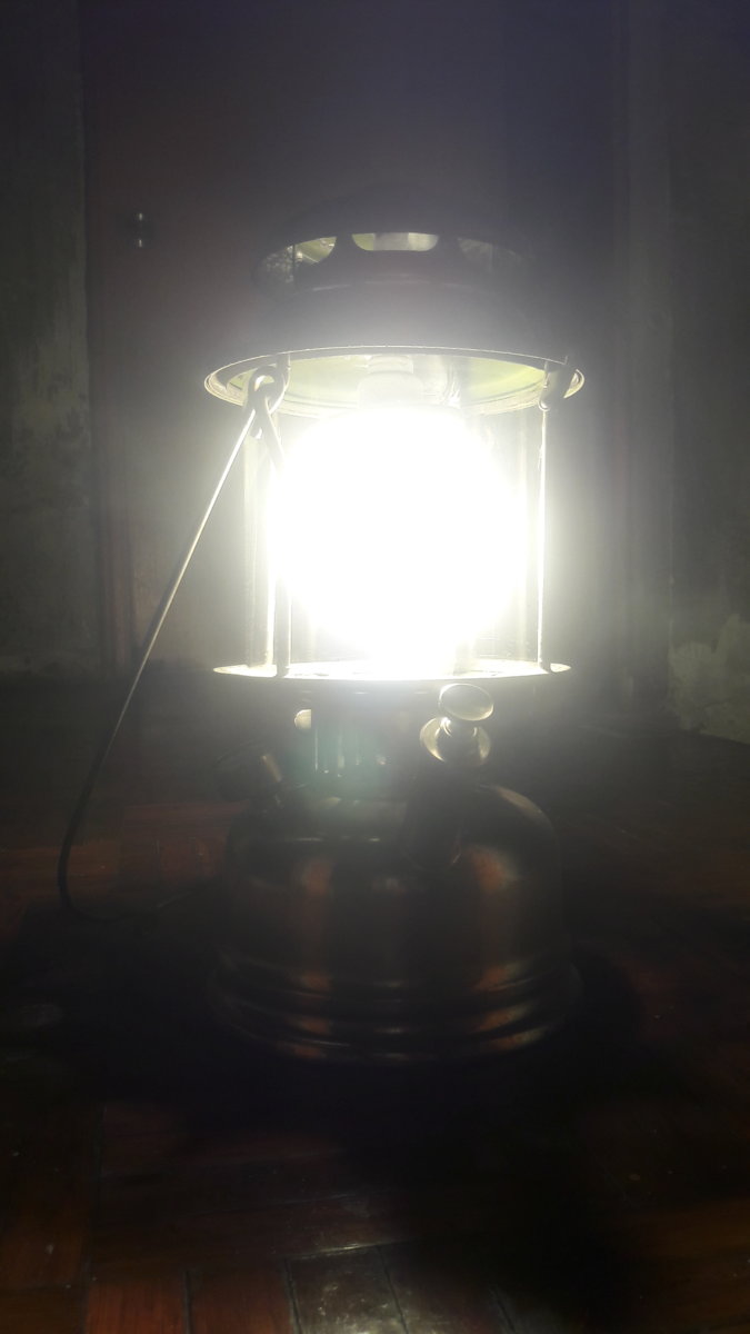

Hi all, After trying almost everything without any Primus spare parts at hand (almost giving up too), I've finally been able to completely sort out all the previous faults. Now its running without the combustion inside the J-tube, no overheating and without the extra asbestos string insulation wrap. No more pulsing and no more flame halo outside the mantle. I have adjusted the air gap between the jet and mixing chamber(J-tube) to the maximum and replaced the clay burner nozzle with a slightly larger ceramic(Petromax or Butterfly 350cp size) burner cap with a metal screen/mesh inside it. Lit and tested it for more than an hour with the hood on. Deliberately operated it at a slightly higher than normal pressure (between 2.5 to 3 bar). Appeared to run satisfactorily. Thanks for all your inputs, which kept me thinking, exploring and questioning myself on my own understanding on such devices. Here's a snapshot of the lamp after all that: Note the extra brass flame spreader above the original unit. That's for connecting the much-raised J-tube to the original flame spreader.
Well done Btw, how did you adjust the height of the mixing tube and do you know what height it ended at?
@Nils Stephenson I estimate that the jet's tip is now very near the bottom level of the air tube intersection. With the aid of an extra Petromax type flame spreader piece to join the J-tube to the original Primus flame spreader.
