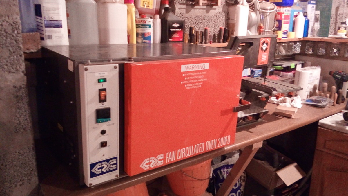

    I only recently started to bake my paint in an oven, but when I say oven, this is what I mean....
    ...and the reason I do is time and the risk of damaging the surface before it's properly hardened. Through trial and error I have found the 45 - 50 deg for a couple of hours has the same effect of leaving the paint to air cure for a week or so and after it's cooled, the surface is bone dry and very hard! I only put a tank/fount in the kitchen oven once to dry it after washing it with warm soapy water having stripping and de-greased it. The whole house stank of paraffin fumes that day and the oven had to be left on full blast for an hour or two to burn away the remaining smell! I won't be doing that again - I'm quite surprised I'm still married to be perfectly honest!
    BTW I was given this for free by local school's Design and Tech dept. I only asked if they had a metal cabinet I could convert into a dryer and they gave me this! Happy days!

    A box like that with "WARNING!" on the front was far too worrying for the school to keep then...
    All done now on the computer by "simulation" we suppose. Great for you though Colin!
