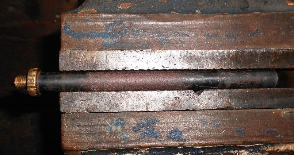

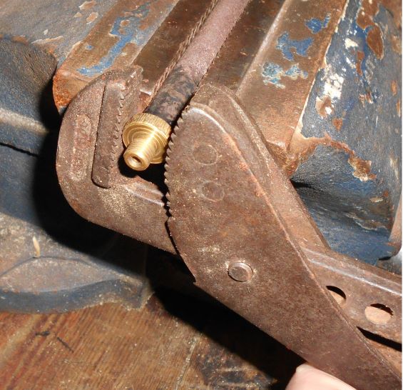

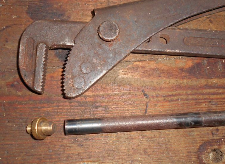

    You're not trying hard enough. Do this cold! If you do heat the end, allow it to go cold before proceding. (I speak from experience).
    Hold the vapouriser firmly in a vice as shown.
    Grip the brass fitting FIRMLY !
    Unscrew a little way and lubricate. Repeat as necessary until you feel confident that the fitting will come out rather than shear off.
    Use a little copper or nickel based grease on the threads before reassembling.

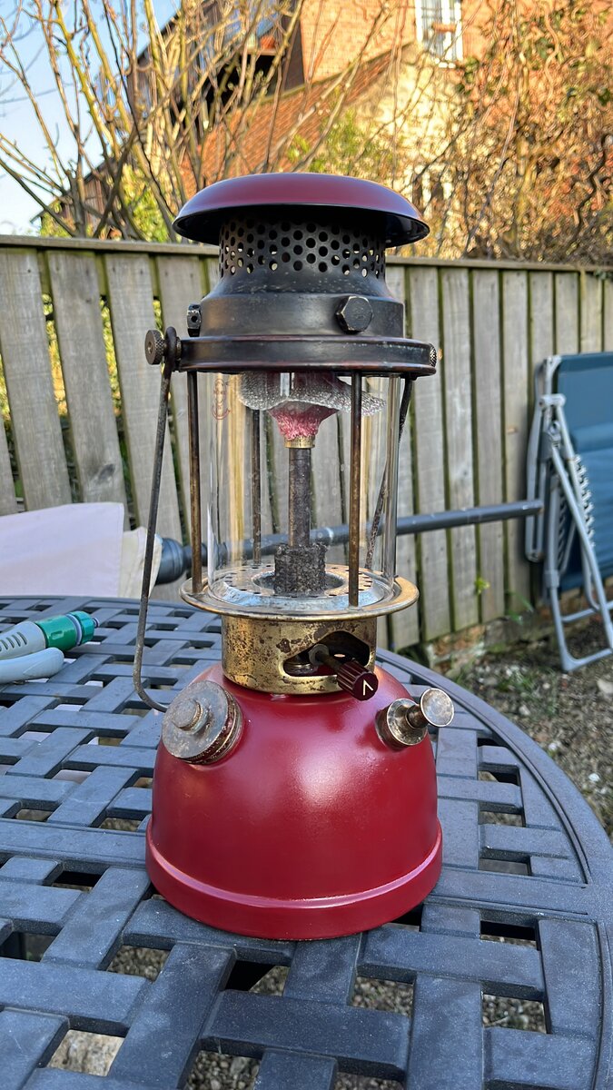

    It’s not looking too bad now…
    managed to get the end off the vaporiser - no pricker end inside so god knows where that went. Lots of crud cleaned out though!
    anyway, tank sprayed, new cap, replacement brass screws and there we are… it’s not perfect but it was never going to be. I’m happy with it though and will do the first test lighting tonight!
    best, Chris

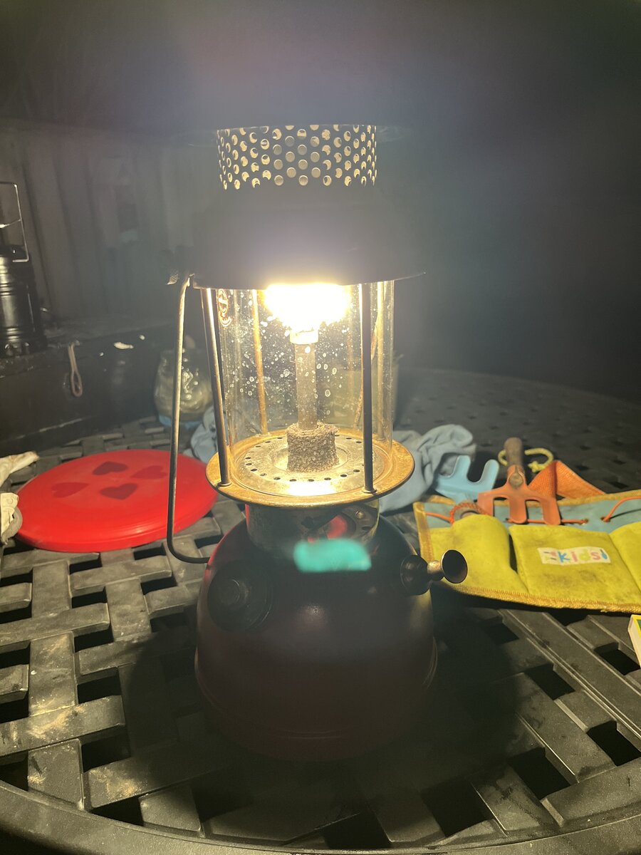

  5. Automedon
    Automedon United Kingdom Subscriber
    Jan 28, 2024
    112
    Pickering, God's Own Country
    Now that’s a win! Test passed … some initial reluctance then it just kicked in - maybe some residual muck in the vapouriser IMG_2930.jpeg

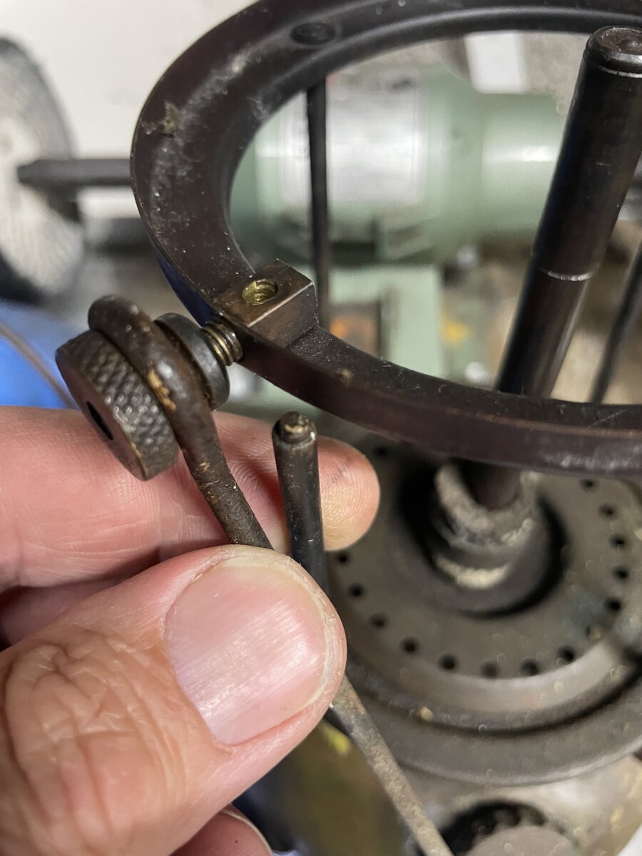

    Hi @ColinG a question if I may , I have a “riveted” 300 brass frame.
    On both handle mounts the rods are not attached , have you any previous experience of drilling and tapping these in situ ?
    Is it possible to clean up the parts and silver solder ?
    Or can it suggest a better repair ?
    Any advice appreciated
    Thanks
  13. ColinG United Kingdom
    4,816
    Hi, Beanie, I had the same problem and I managed to use a tiny computer screw which was either 2.5mm or 3.0mm from memory. I drilled and tapped the rod and the tiny computer machine screw then kept the rod in place nicely. Some PC screws have built in flanges that help to spread the load . It was fiddly work but doable for sure.
    Hope that helps.
  14. Beanie United Kingdom
    Mar 2, 2026
    92
    United Kingdom
    Thanks, I have the correct BA threaded screws, so may go that way, not got around to tackling the fix
