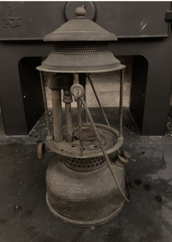

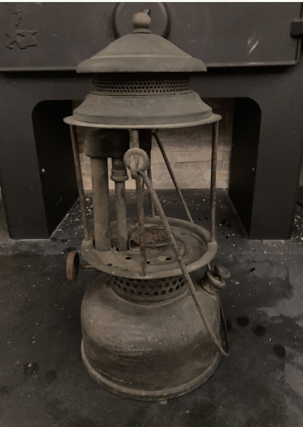

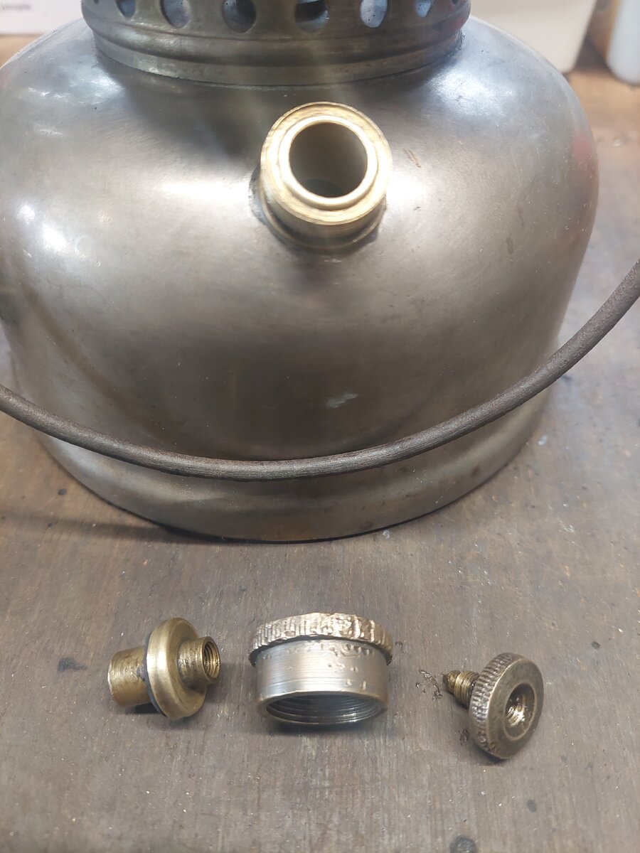

    Hello guys, new member here, I'm from Holland and Im always tinkering with old lamps and heaters,
    I recently acquired a storm king, but it's missing the cap or ring to keep the pressure valve in place also the litte bolt that goes into the valve to shut it completely,.
    Because I'm from Holland, we have different bolt and nut treats, metric,
    So I can't find replacement parts, also because the lamp is super rare here,.
    Can some one conferm that maybe a coleman ring would fit,.
    Also, I need to know how to proper light this one up.
    Because it has no spirit prewarmer cup,
    It gives lots of flames before it's finally warm enough, then it Wil burn ok, IMG_20260504_115419.jpg

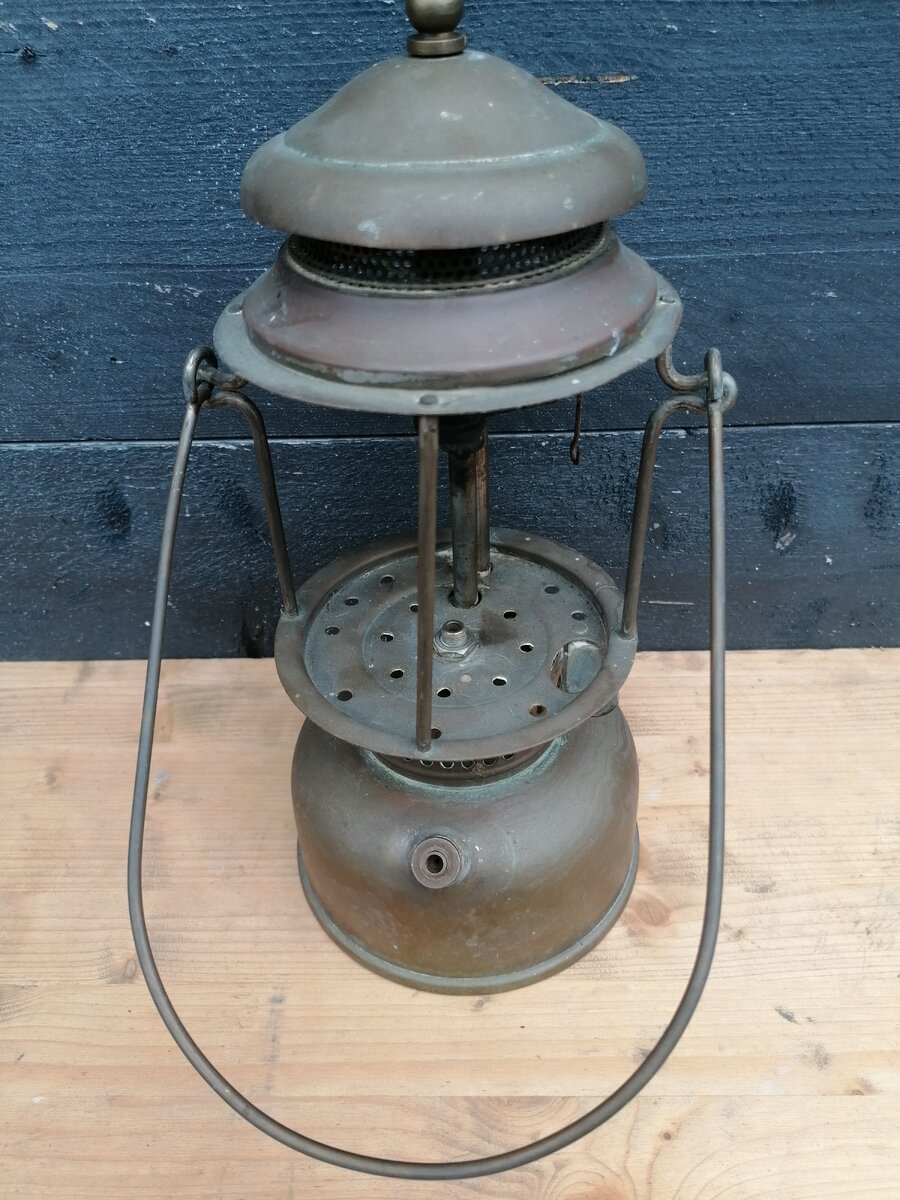

  4. podbros
    4,013
    Hi @Loe and welcome !
    there is a brass lantern made in Holland called “Summit”
    perhaps this is one?
    have a search and see what you think?
    member @Scott D restored one very similar and the heat shield was marked Summit so perhaps it is missing from yours?
  5. Loe Netherlands
    May 5, 2026
    7
    Nl
    Thanx,
    That shure looks like it,
    It must be a copy of the nulite,,
    Stil some questions about the ring holding the pressure valve in place, can't find aring that fits, and how do I lite this baby up in a safe way, I know how to lite it unsafe, lol

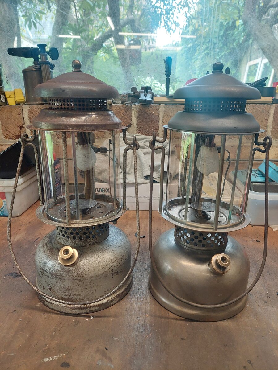

  7. pete sav
    pete sav Founder Member
    Sep 7, 2010
    1,179
    West yorks
    These stormking clones are usually petrol / coleman fuel fed lamps. When i light mine up i just use a tilley torch clipped on the generator for a bit as a heat source put pressure in the tank then open the control valve. Got a couple of these once up and running very reliable.
    Your main problem is the tank filler needs the central screw to seal the pressure in.

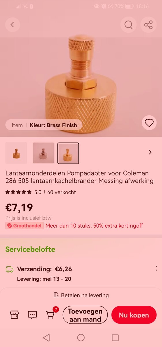

  9. Loe Netherlands
    May 5, 2026
    7
    Nl
    Well it looks like it's a summit,
    Can anny one conferm that a coleman pressure cap, would fit on my incomplete pressure valve Screenshot_20260506_181612_com.alibaba.aliexpresshd.jpg
  10. WimVe
    3,529
    The advertisement is for something else: a pump adapter.
    So this is more then a "simple" shutt off.
    I have to check but I can't remember which of my Summit lanterns has a spirit cup.
    More about Summit you can find on my website.
  11. pete sav
    Sep 7, 2010
    1,179
    West yorks

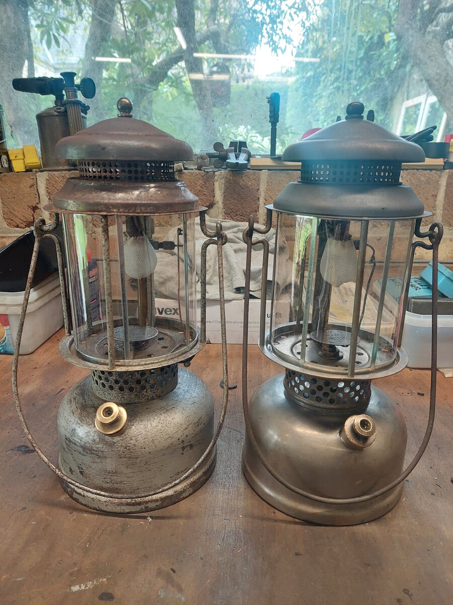

    @Loe i am not sure that the coleman cap will fit your lamp but i am not sure.
    These are what i have here on the left a stormking and a veritas on the right very similar to your summit i think

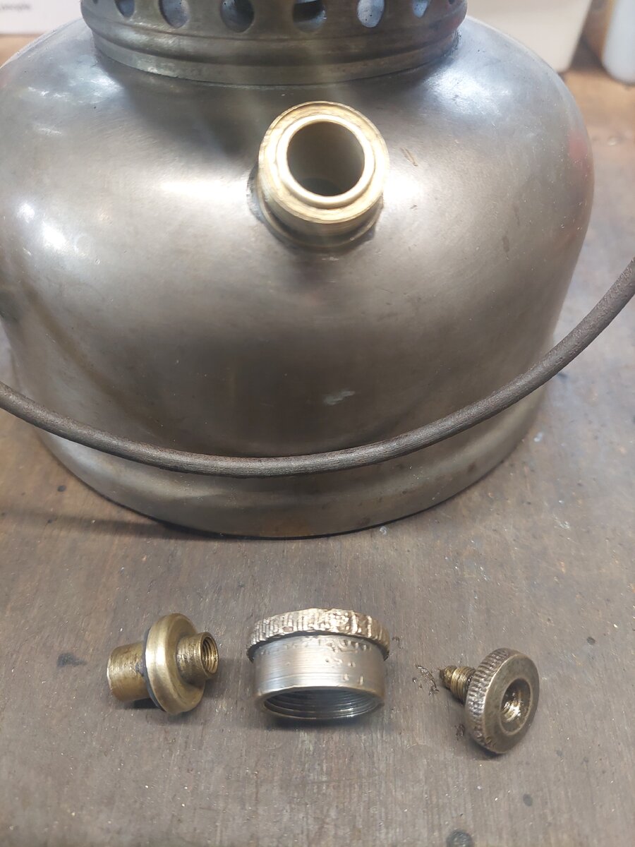

    Now the parts you need i think are these
    This is the filler cap and air filler.
    The outside thread on the tank measures
    18.70mm or 0.7385 inches with a thread at 24 TPI on them both i but you summit is the same if you can check it.
    I have a Akron here and it uses the same thread as these do
    Good luck maybe others could chip in
    Cheers pete
