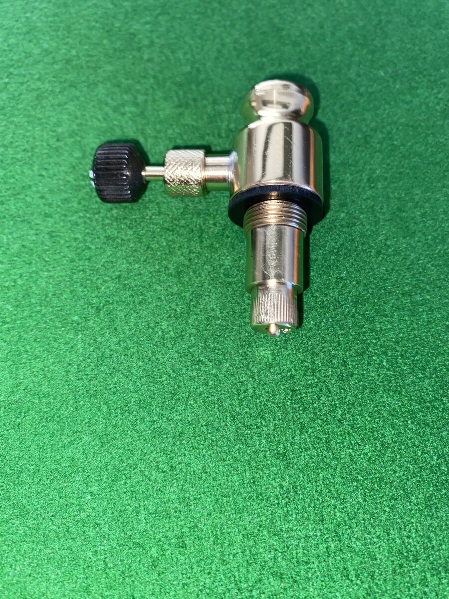

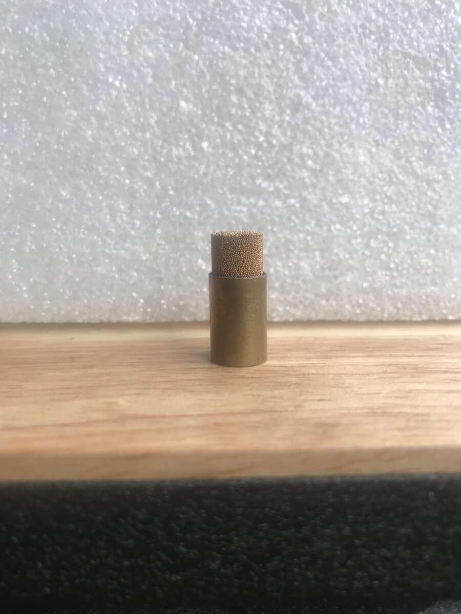

    @Henry Plews has suggested using felt in the bottom of the socket below the control cock, which is good advice. You could also use a circular piece os brass mesh.
  2. podbros
    4,069
    @Henry Plews :thumbup:
    @Tony Press :thumbup:
    Both options are 100 times better than something resembling a miniature sock handmade by The Borrowers, which is what Tilley thought was a good idea ](*,) :roll:
    11,078
    @podbros
    I have seen some XN and GF control cocks retrofitted with this type of cylinder of porous brass. I think they were used in Thacker-marketed lamps in the 1960s.
    I wouldn’t recommend going this far. Felt or brass mesh will do.

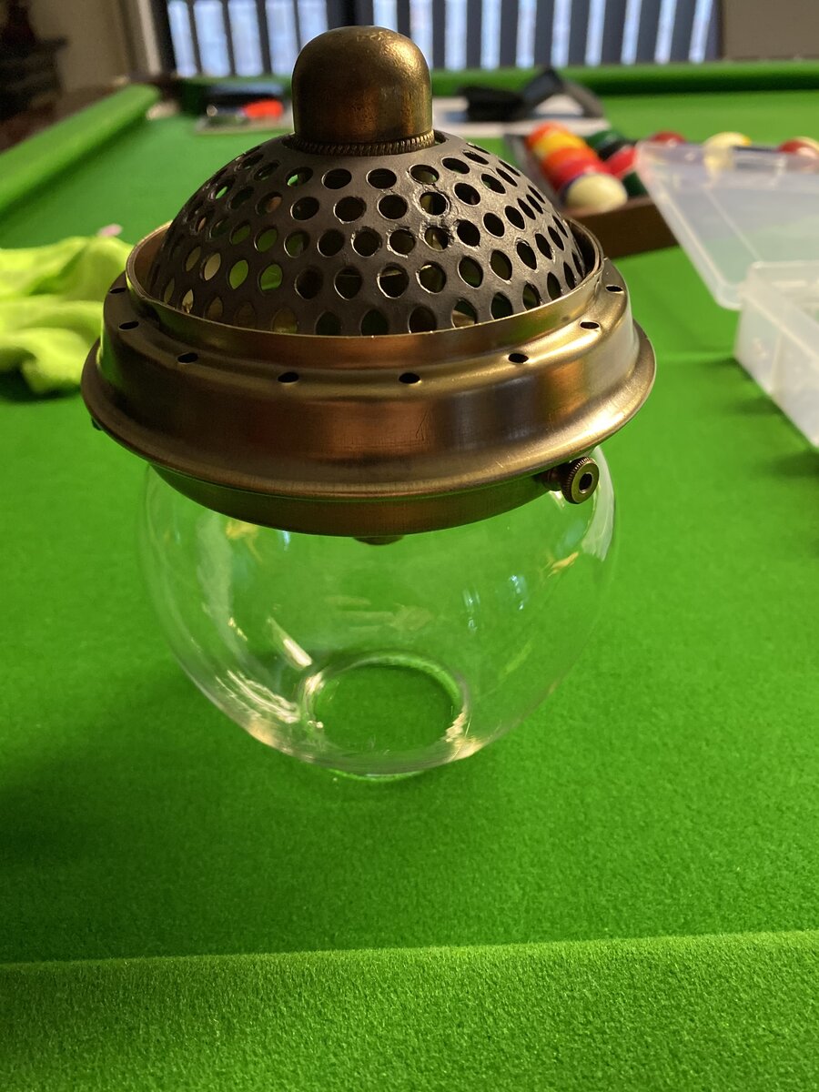

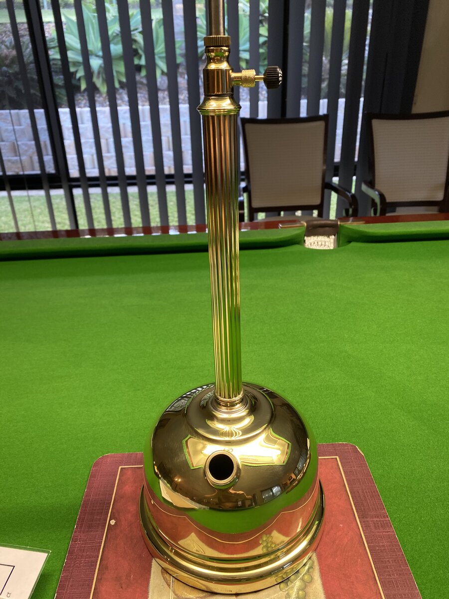

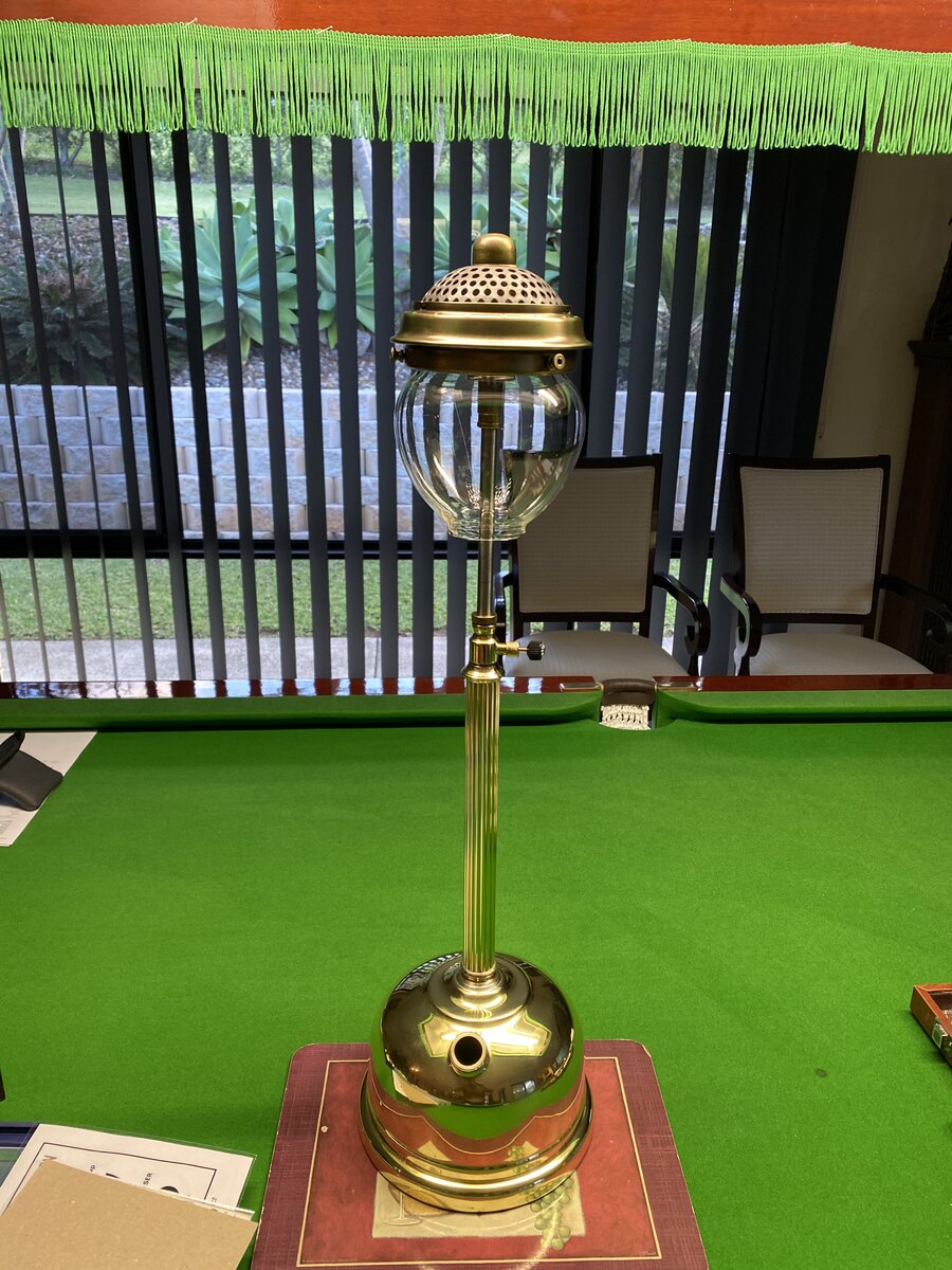

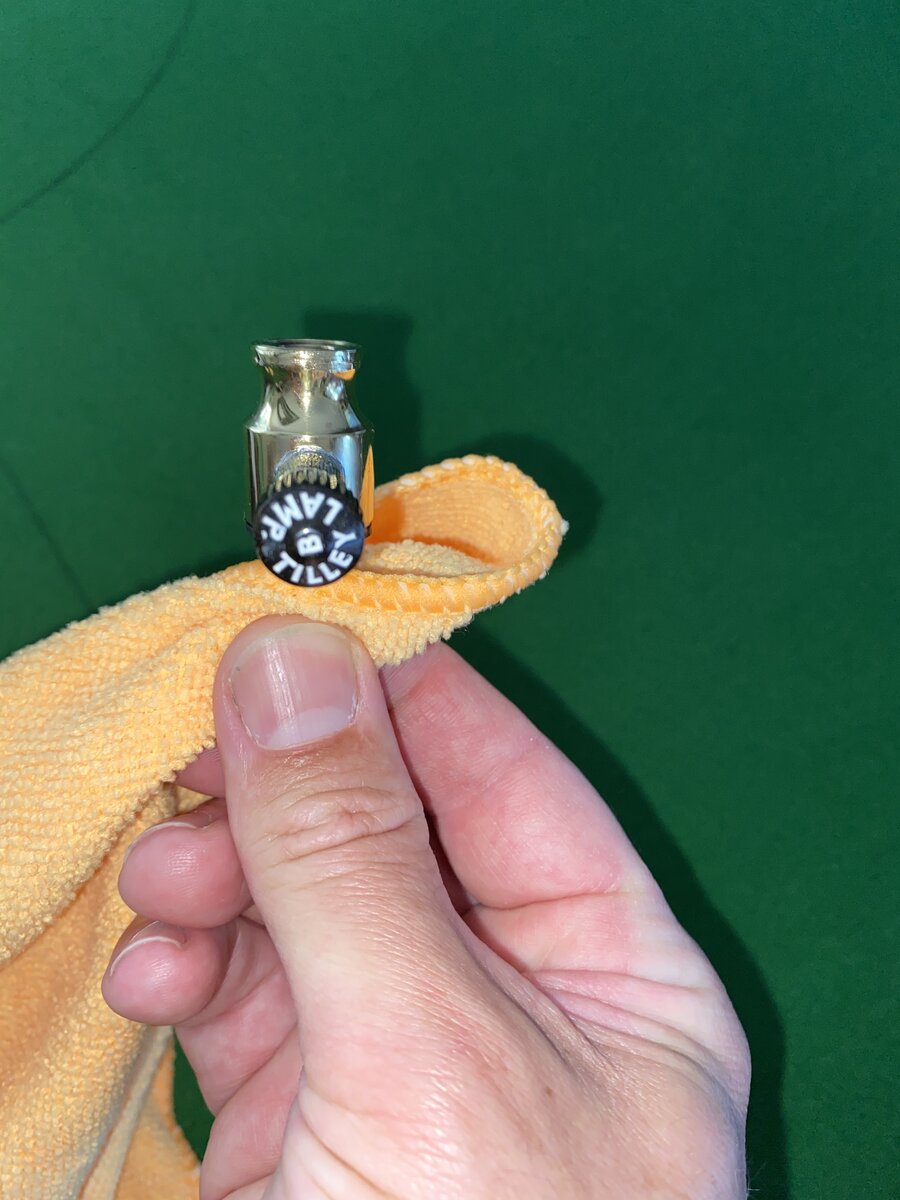

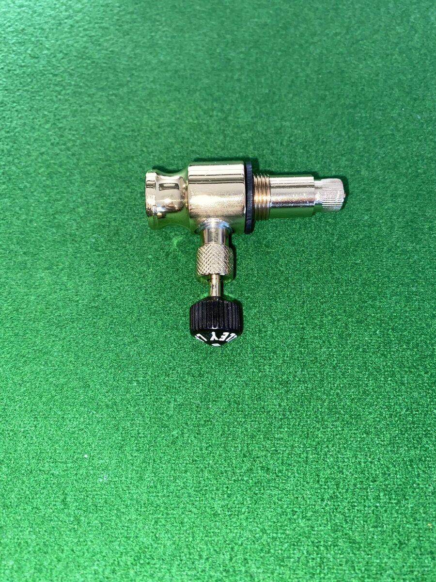

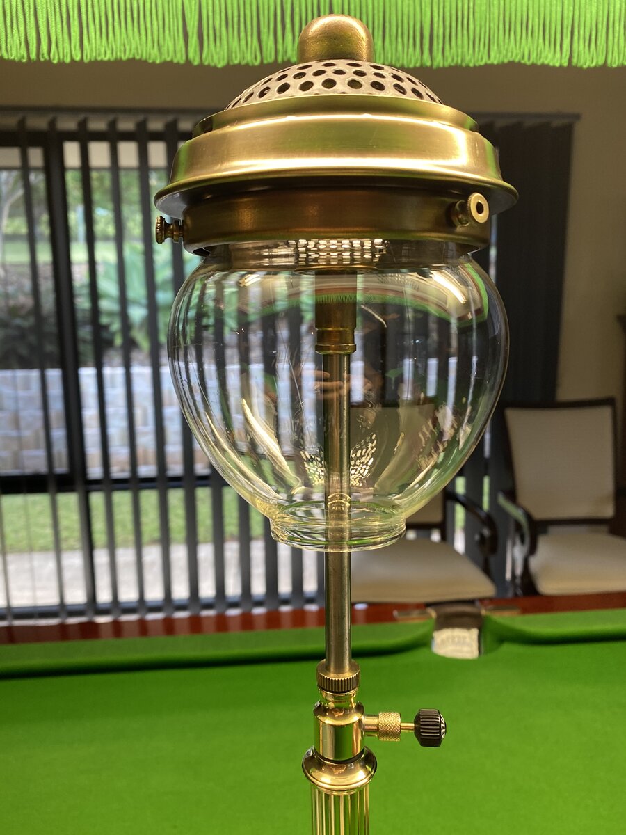

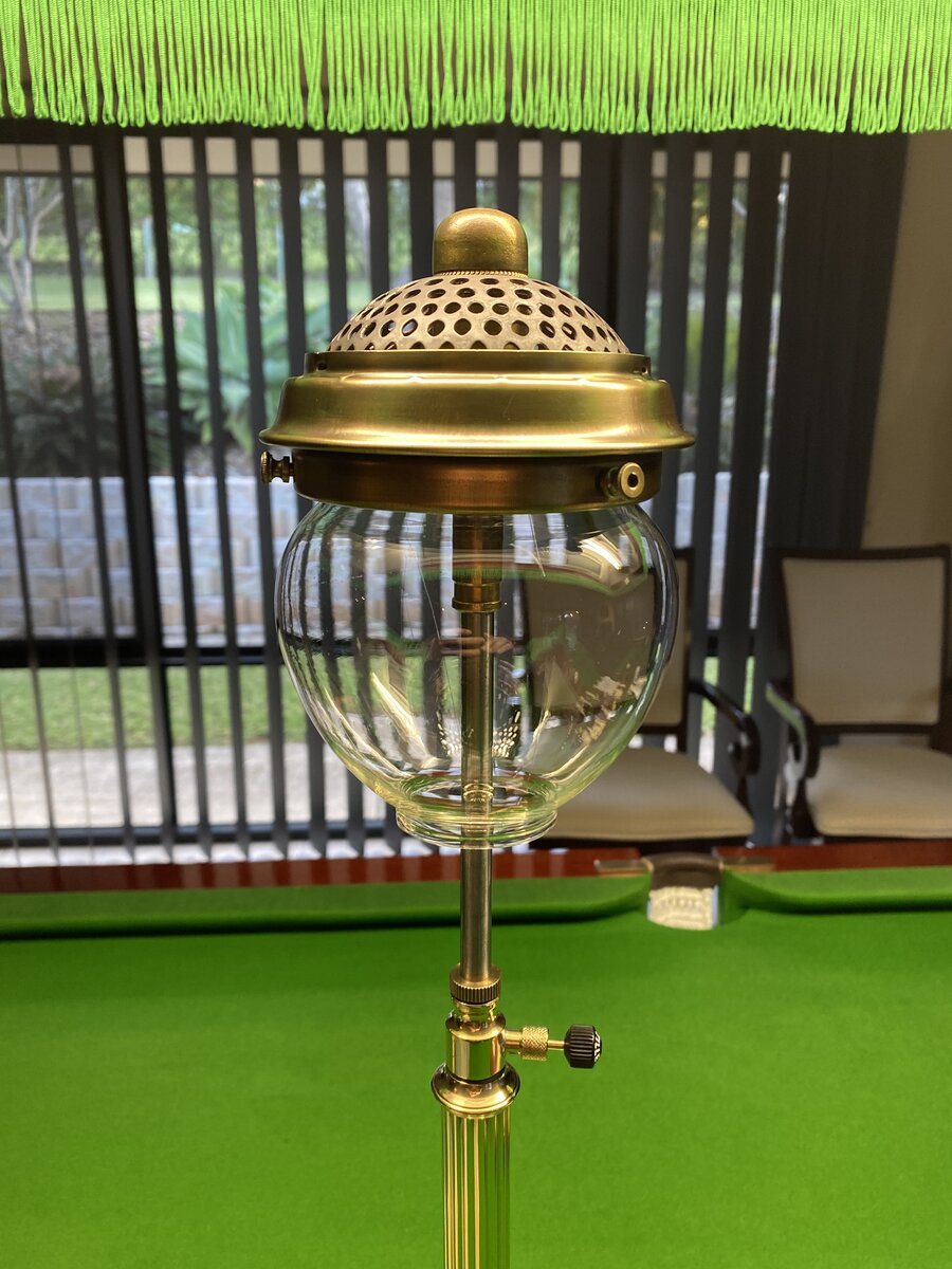

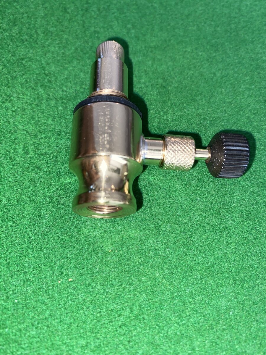

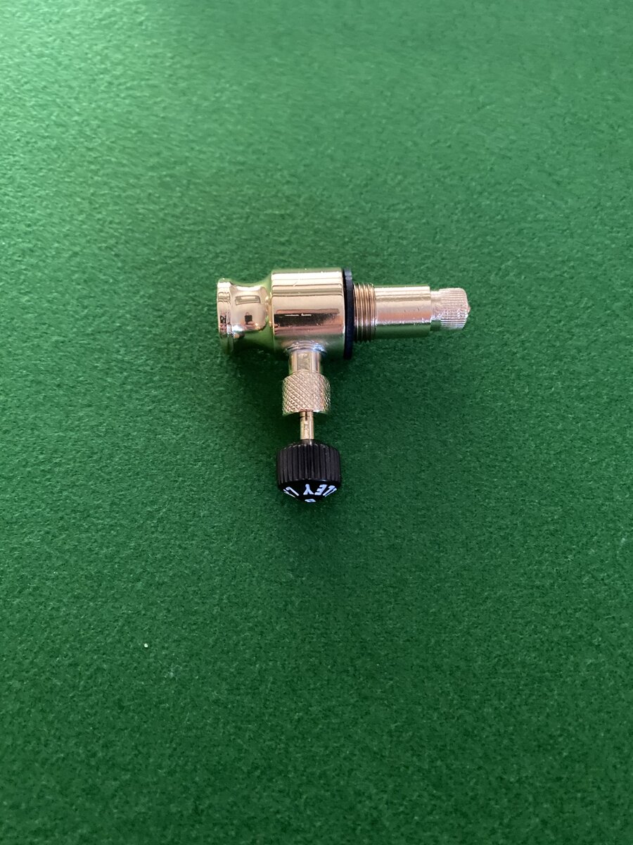

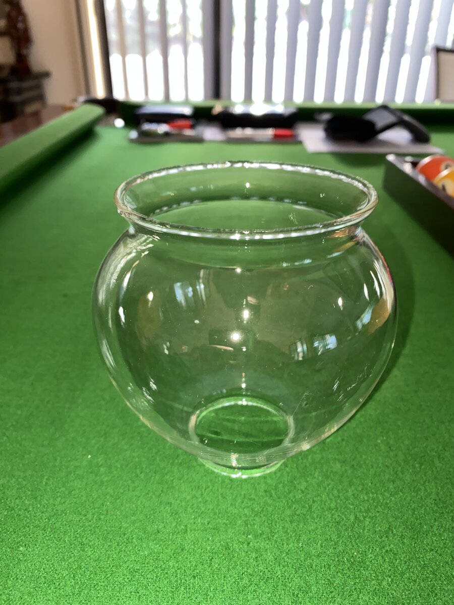

    Thank you guys for all the good advice. I’ve almost completed the restore and only have the pump to do over the weekend then she’s completed.
    I decided do put no filter in the cock and will see how she runs. Worse case scenario I can always put a filter in if I have any issues down the track.
    Below are a few photos
    EACD32FF-5D07-4057-A240-F6FB3C30BB1C.jpeg C4E08A67-D37A-4756-A39C-F813D3192B15.jpeg 4A300084-65D2-489C-9170-3E45D95D1181.jpeg AB86CC66-049B-41F9-BA6E-AD7CD13EE11B.jpeg 9FEF2A29-DF63-48D5-82F2-169B5DA2D4D0.jpeg 2FAA1662-5D09-4970-A2CF-A69DEDA07B44.jpeg B3AEEC2F-032A-45C3-A4C0-D0748C2188E8.jpeg 9F37F58E-2D3A-4AD0-9E0E-12BF357E37B3.jpeg D1F3082D-9699-455E-9884-3390782BD9D6.jpeg D09090D1-4A56-42CD-A050-4948CE0EB8AF.jpeg D4E8B38C-CFFD-4313-BD87-2A8444F9321E.jpeg 350341AE-2C0C-4433-B4BB-77C2FDD7C406.jpeg AEE84F5A-55D6-426D-8EB5-EB0657D51042.jpeg 54BE4C4B-7070-4389-9A9C-9C41CF8252BA.jpeg

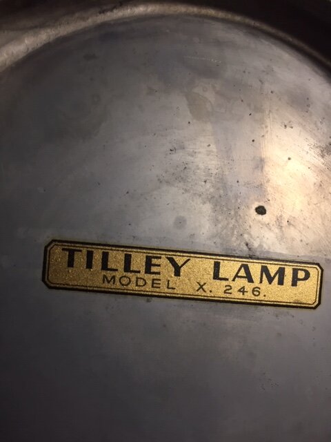

    The reason for asking about this decal is that the R1 that has it, also has an Rd number on it.
    I thought this decal didn't start until the porkpie X246 in 1946+.

    The end result looks awesome! Now you'll have to find an outer shade to really complete the effect!
    And @Jean J if you're bored of all those Tilley table lamps, I run a collection service for unwanted strays.... it's like a donkey sanctuary but much more fun!! ;)
  12. Darryl Durdin
    1,640
    @Kiwiboy00
    Your lamp looks absolutely stunning, great job as usual
  13. Buggerlugs
    I agree well done looks fantastic to me, she's like a new lamp.
