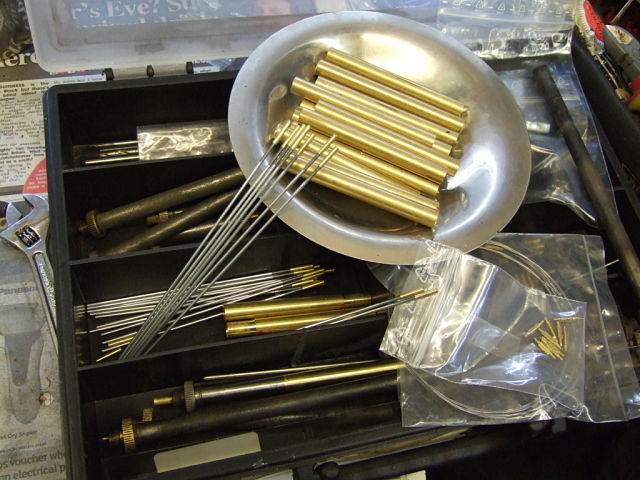

    Each one is anywhere from an hour & a half to two hours + which includes the making of the pricker rod assembly too :D :thumbup:
    The first units are still under test & are working well , i have been told in the past that similar units have been less than successful due to carbon build up or easily damaged , but mine are made of top quality materials & the center hole is only just under 3mm leaving plenty of strength in the new vapouriser tube :thumbup: .
    The end where the jet screws on is kept as shallow as possible this keeps plenty of material in the top end to help stop the top of the tube bulging or filling full of carbon & clogging the jet :D :thumbup:

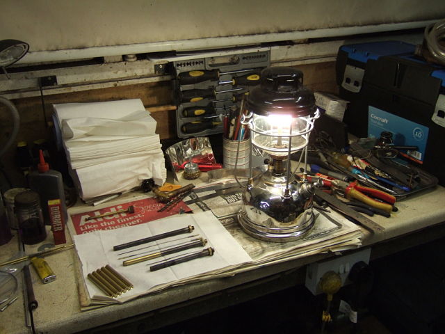

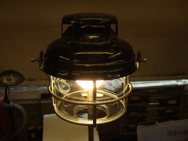

    My workbench as busy as ever :doh: :D :thumbup: with the test lamp in full swing & nearly 12 hours on the clock

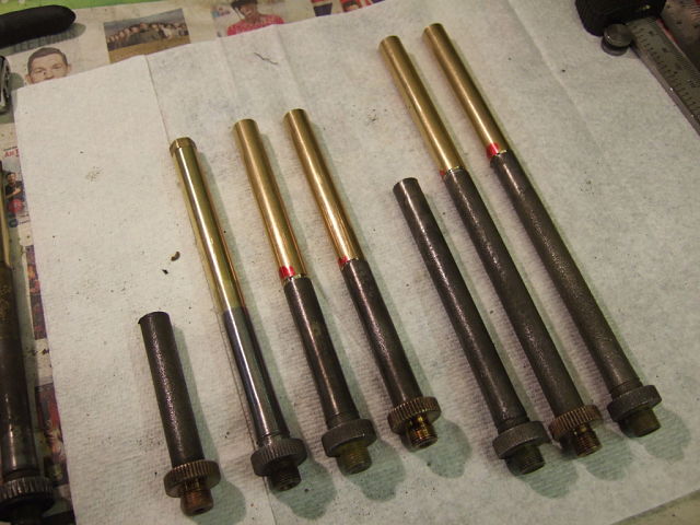

    More pic's of the 169 vapouriser ready to be silver soldered along side two standard types :thumbup:
    The light output is very good & has heavily dimmed the camera in close proximity :shock:
    Five more new vapourisers part machined & a trimmed of 606 teady to be adapted :D :thumbup:

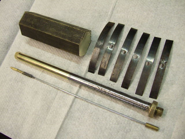

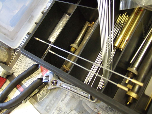

    Well i haven't been sitting on my laurels in between work & homelife :shock: :D :thumbup: i've been busy in the workshop too & now have machined up some spares ready to do a small run of the vapourisers if anyone might be interested 8) :thumbup:
    The most difficult part has beem machining the needle to pricker control rod 2mm threaded sleeve , a bit fiddly :shock: but not impossible :D :thumbup: Here are a few attatched already to the rods :D :thumbup: , a 606 & a 169 :thumbup:

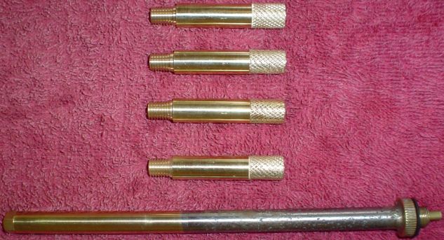

    Several folks have asked me if the 169 version of this vapouriser is strong enough to hold up a table lamp gallery [-o< & i'm glad to say that they are with no problems , i put one of my silly Tilley table lamp conversions which is really half a stormlamp & much heavier than a standard gallery & glass :D :thumbup: & here it is fitted to a standard Corinthian table lamp :D :thumbup:
    A bit of a closer pic :D :thumbup:
    This vapouriser on test is now ready for Shedman 8) :thumbup: who has sent me some dead vapourisers to convert 8) :thumbup: , when i'm ready i'll put out a post saying they are available but i will need a dead vapouriser in return/exchange :D :thumbup:

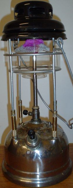

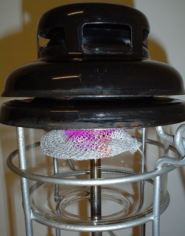

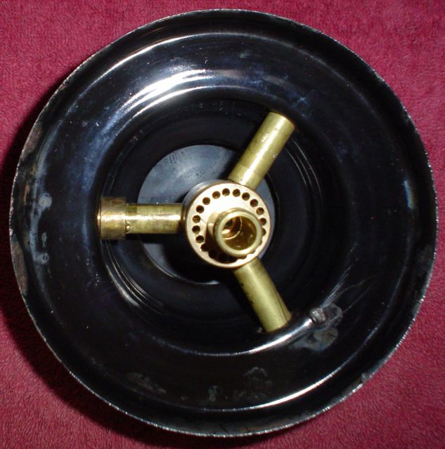

    The box of parts from Stu arrived today, all of the parts were very well made! :thumbup: :clap: :clap: :thumbup:
    These photos show the Stuman vapouriser and the cage extensions fitted to a Guardsman lantern.
    I also fitted an unused burner.
    A testing report will follow in due course, Jeff.
