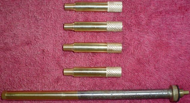

    Hi All
    The testing is nearly complete on the "Stuman vapouriser conversion" & after a few pitfalls , setbacks , drawing board re-visits ](*,) :doh: & nagging niggles the testing of the final design seems to work well [-o< :D
    This version has now been running straight for nearly 24 hours with no ballooning of the vapouriser body & the jet staying in place which has been a bit of a pain in other brass vapourisers of this type :doh:
    Once again if anyone has any dead Tilley vapourisers kicking about please don't throw them away , give me a shout as i'd be glad to have them for this project 8) :thumbup:

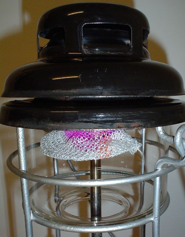

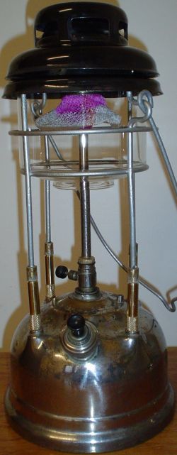

    I'm pleased to report that Stu's cage extensions are excellent and as I have mentioned before on this forum, when the cage extensions are fitted to a Tilley Guardsman lantern, and a 169 vapouriser is used then the lantern is brighter! :thumbup:
    Stu's replacement springs for the later Tilley gallery, which has the springs on the outside, also work well! :thumbup:
