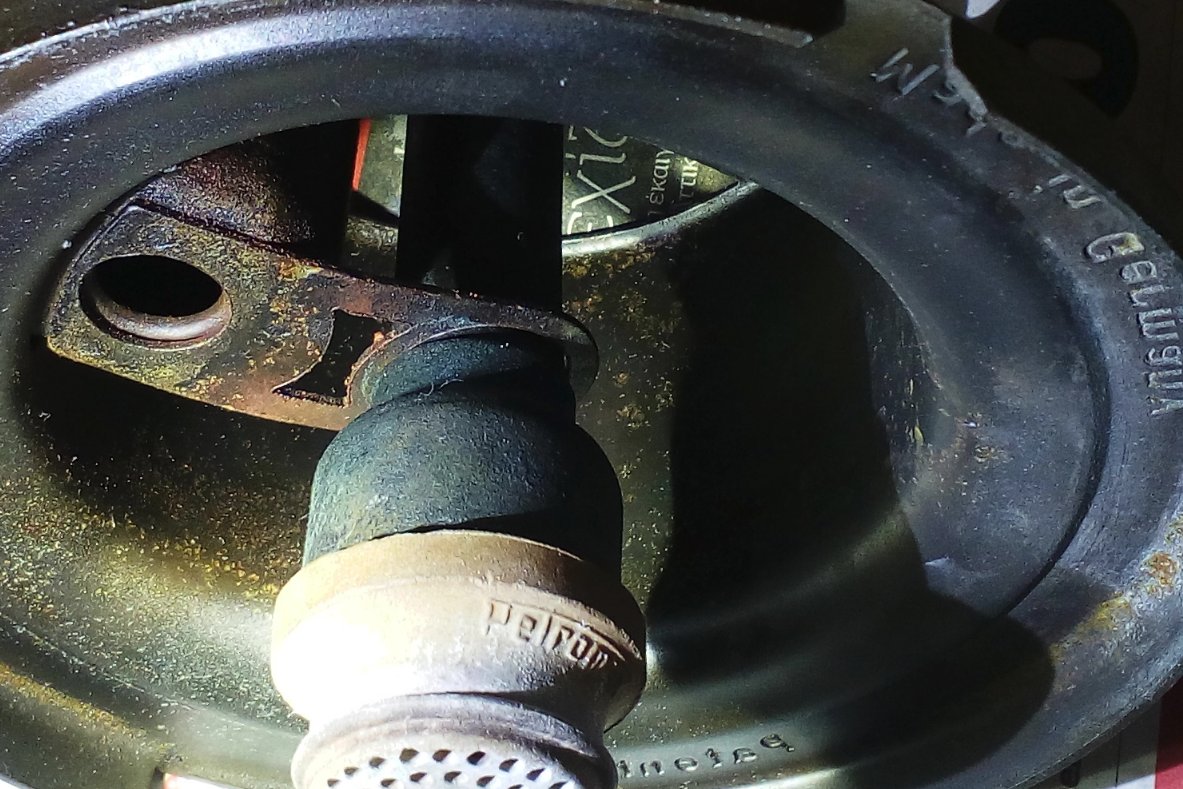

    On the first image we see that this is original petromax. The second picture shows that I have indeed raised the J-tube (the screw that adjusts the light is higher than the perimeter of the assembly). The third picture shows that the ring that holds the J-tube above the burner is already stretching upwards.
    Now I re-measured the distance of nozzle to J-tube more carefully and it is 1.2cm. The distance for 350 (according to the petromax tool) should be 1.3. So I miss 1mm which is the missing 8th turn. But I wonder @MYN how did you say that it is adjustable by a large amount? It seems it isn't.
    Either the 1.2cm is OK, or if not, I must either make the 8th turn or try to press the burner and J-tube further up if possible by 1mm.

    I had been able to adjust the gap between the top of the jet to the j-tube inlet up to a near maximum of 18mm.
    I usually set them in the 15mm +/-2mm range.
    The usual norminal distance is around 13.2 to 13.5mm but this isn't a mandatory requirement.
    If it isn't possible in your unit, you can also back out a couple of j -tube threads at the burner cap holder to get the additional 1mm. That's provided there is adequate threaded length at that section:
    Another common occurence is that the metal stopper bracket is frequently bent. This might affect the distance of the gap.:

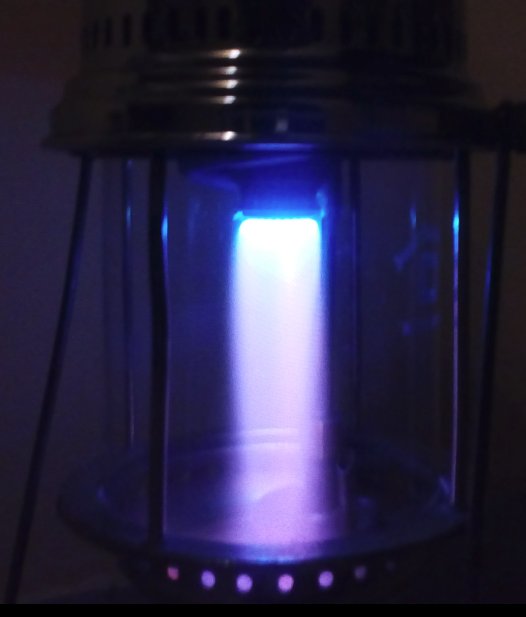

    Back on this lamp, after receiving parts and find time to install them I lighted it without a mantle to check that it works. Actually this is my first time I lighted a Pmax without a mantle. So I wonder is this picture correct? The flame around the burner is a clear blue flame but there is a downstream of flames in the center. Is this how it should burn without a mantle? I did not want to waste a mantle because it is not easy to get parts where I live.
  12. MYN
    3,859
    Its working and almost there but still a little yellow. It should be more blueish. Reduce the fount pressure a little to see if the flame gets bluer.
    Check that the jet is tight without leakage and the air gap. You can the air gap to get the best result.

    I adjusted the gap. Now it looks right, yes?
  15. ColinG United Kingdom
    4,806
    Looks good to me, now it's time to fit a mantle and show us the results!
