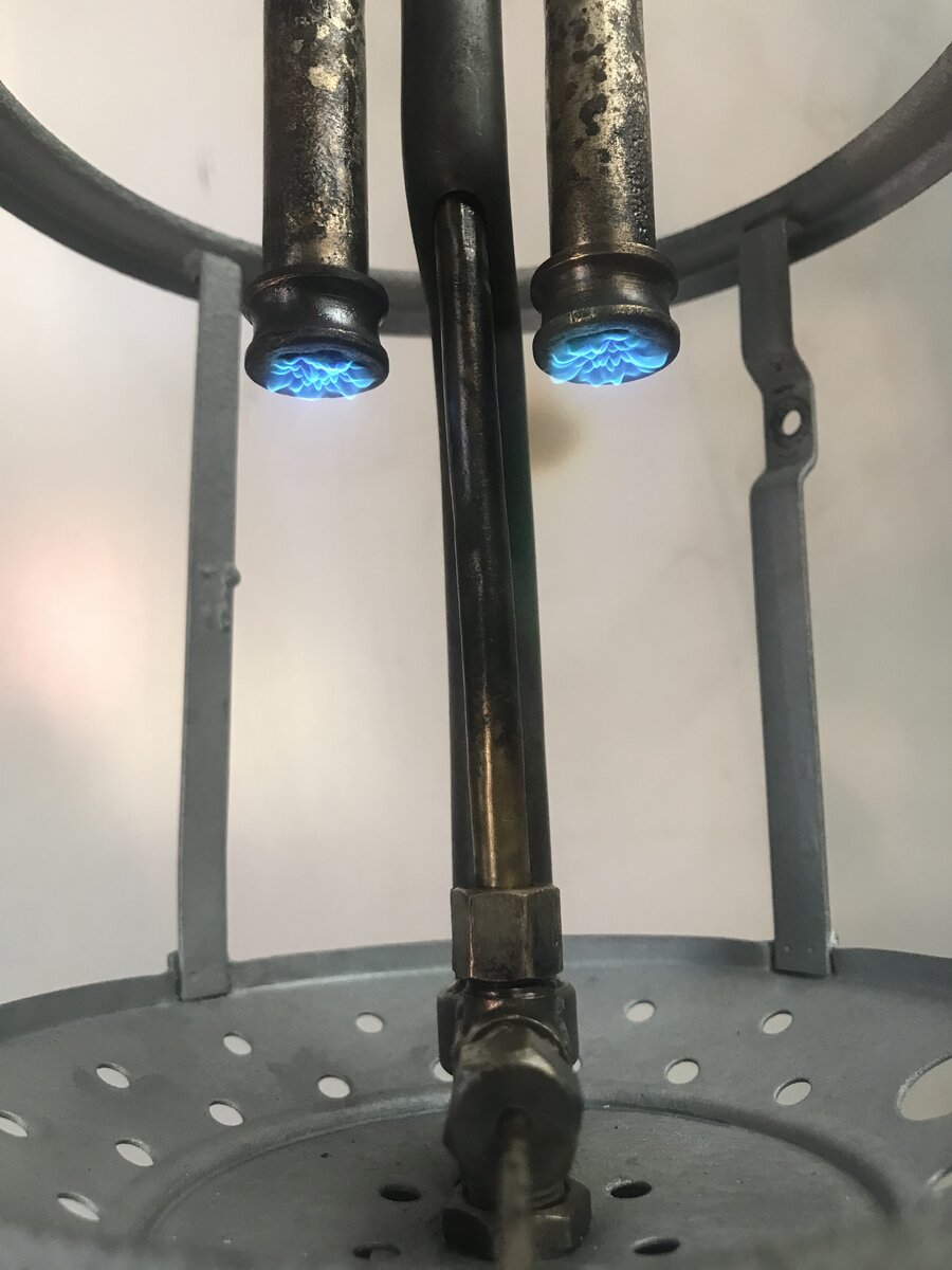

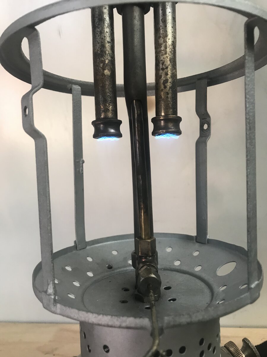

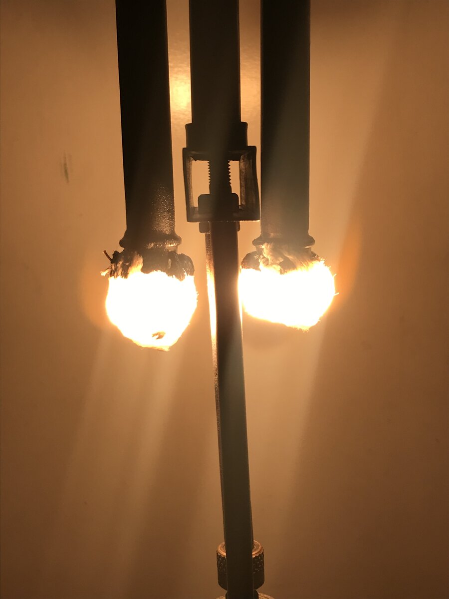

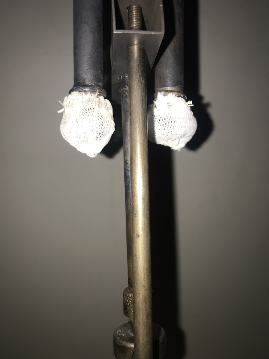

  8. Tony Press
    11,091

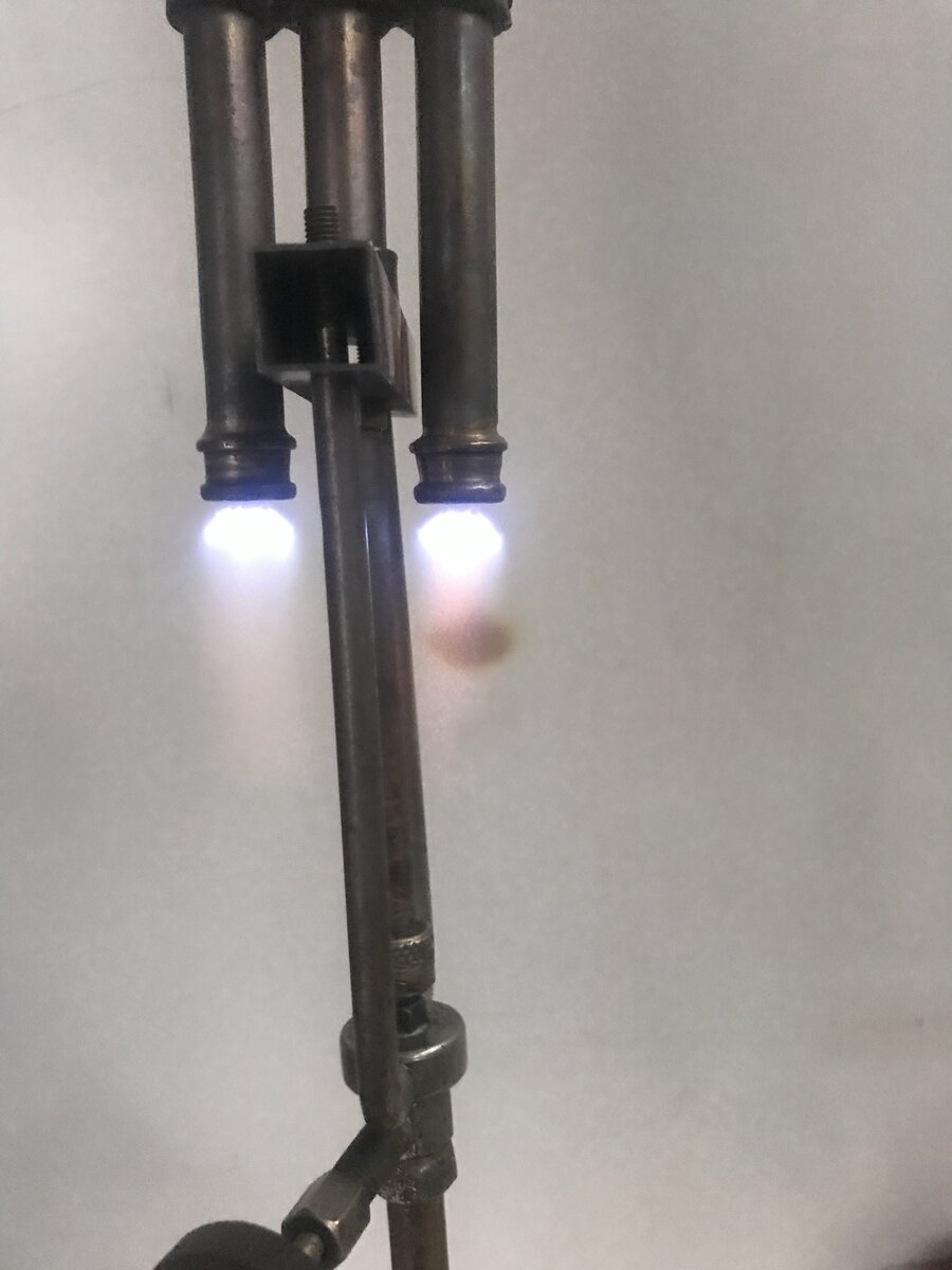

    This very old lamp gets a new life after some delicate fettling. Here I’m testing the burners after fettling, but I’ll put together a complete story in the Fettling Forum after I’ve done the rest.
    Now using my (ridiculous) throw-away test mantles:
    At least I now know that I’ve sorted the fuel, and burner systems. The rest should be easy.

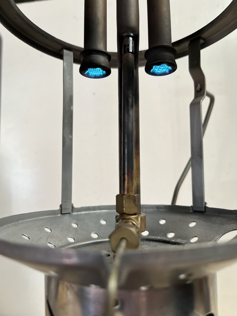

  9. Tony Press
    11,091

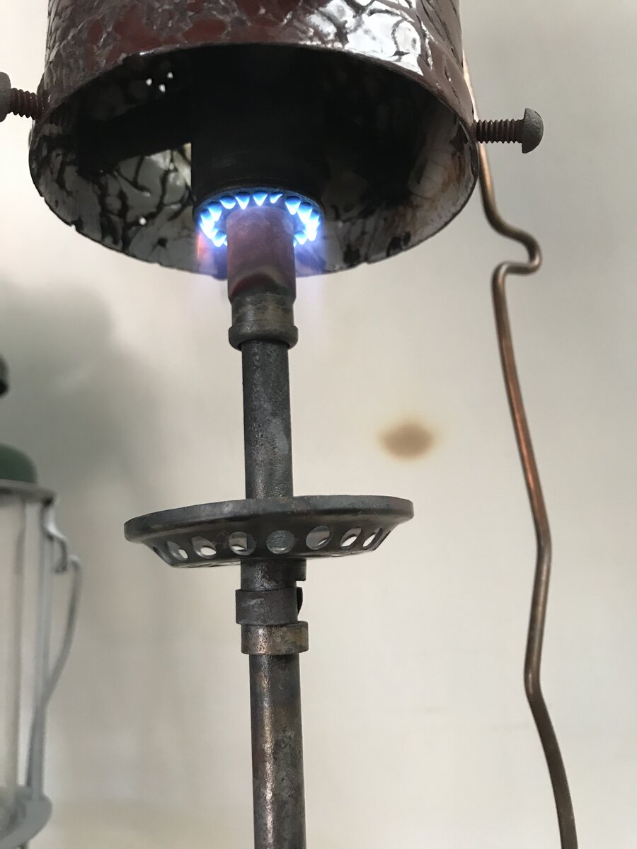

    Testing a fettled 9/38 Canadian Coleman 228B.
    Low pressure.
    Higher pressure.
    It’s running well.

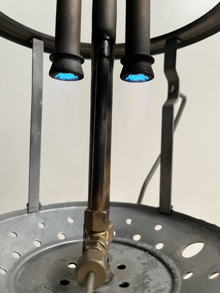

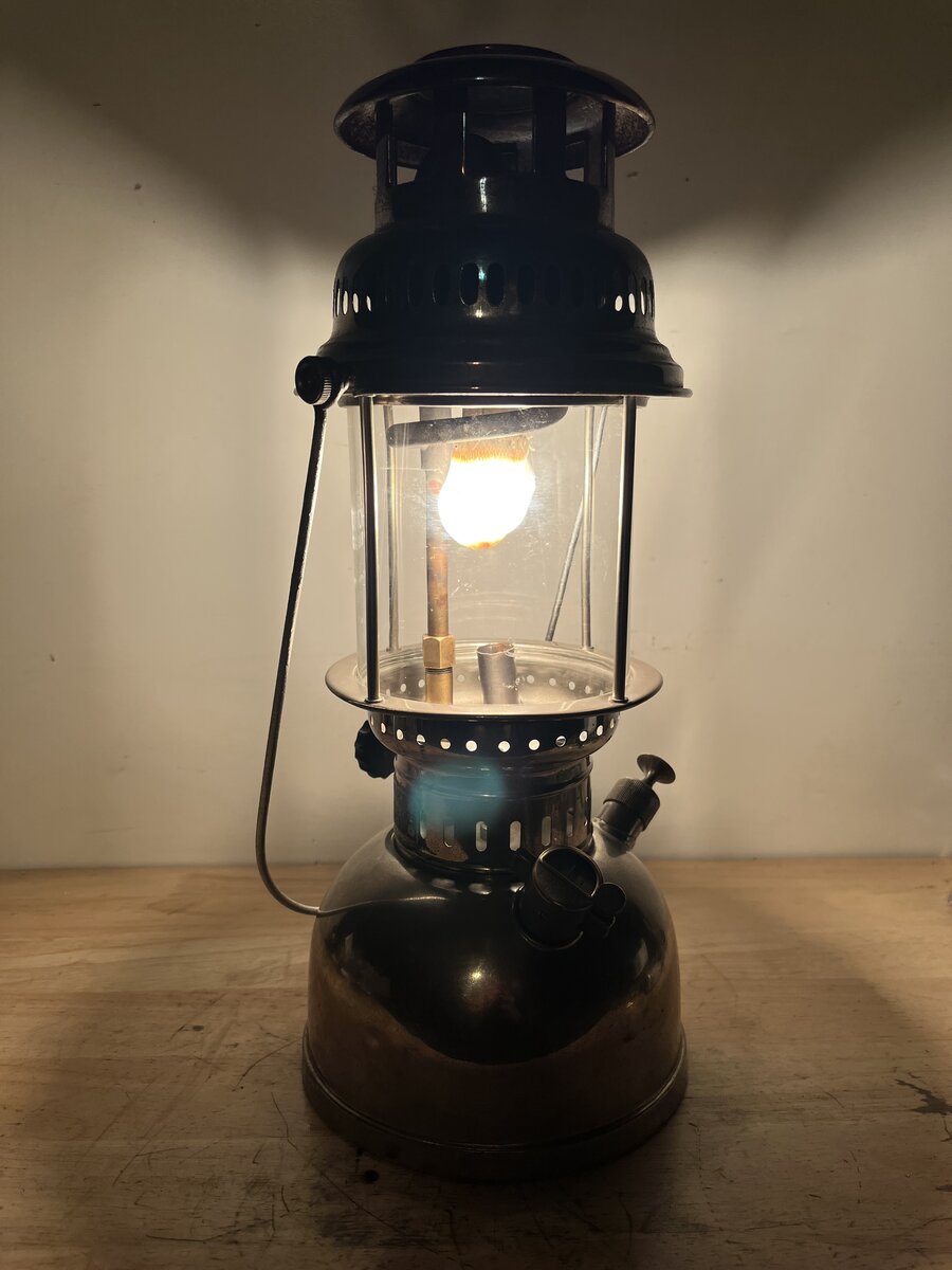

  10. Tony Press
    11,091

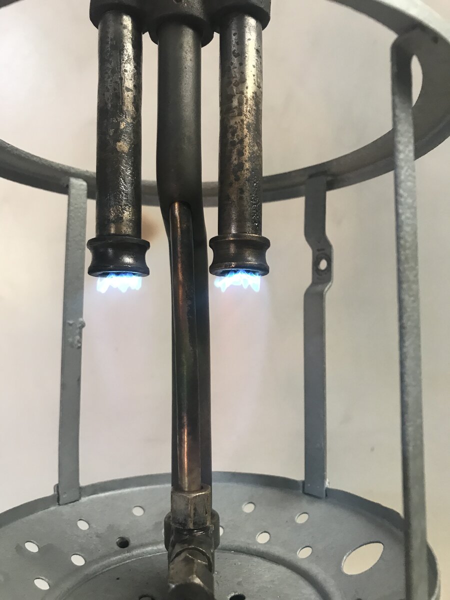

    Testing a Hipolito 250.
    I think this lantern will be fine!
    Edit: I’ve been looking at Neil McRae’s PLC and this lantern has some interesting features. I shall clean it up and put in the Reference Gallery.

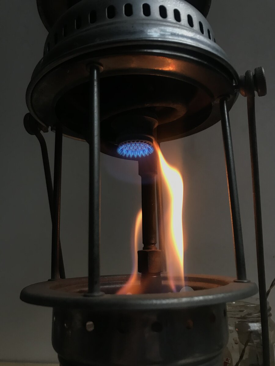

  11. Tony Press
    11,091
    This is a fine.
  12. Tony Press
    11,091

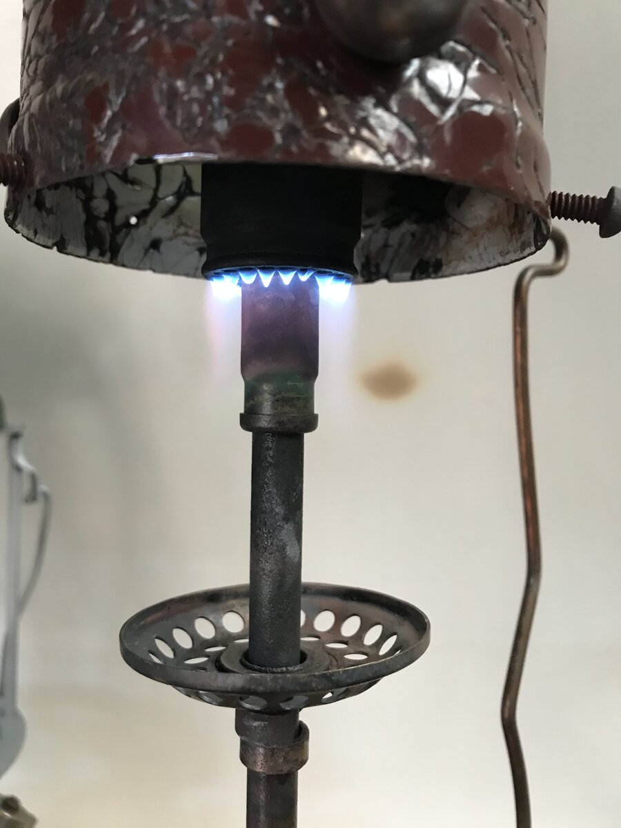

    Coleman 220D. Hard to see in the bright afternoon light, but it’s working well:

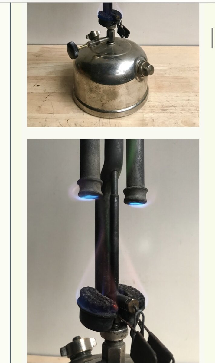

  13. Remus1956
    Jan 17, 2024
    158
    Los Angeles, Ca
    @Tony Press Hey have a stupid question but in a few of your photos you show something of a clip on type preheating cup over your generator. What is that? I am really new to pressure lamps as the only one I got going was a 159x, never seen a lot of these before.
    Thanks!
  14. Tony Press
    11,091
    The clip is to stop the pre-heating cup sliding up at hitting the mantles when you are moving your lamp around.

    11,091
    @Remus1956
    I may have misread. That clip @podbros shows is a Tilley pre-heater clip.
  17. Remus1956
    Jan 17, 2024
    158
    Los Angeles, Ca
    @Tony Press @podbros yeah that's it. Seems to be quite handy. So my understanding is that you can unclip it and clip it to other lanterns
  18. Tony Press
    11,091
    Yes. It’s designed for the Tilley 169
    and 606 (plus other) vapourisers but useful elsewhere, including stoves.

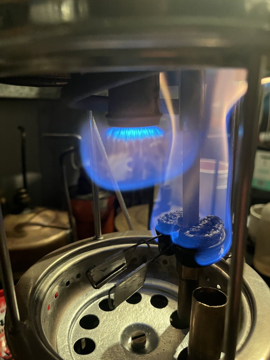

    Pre-heating torch

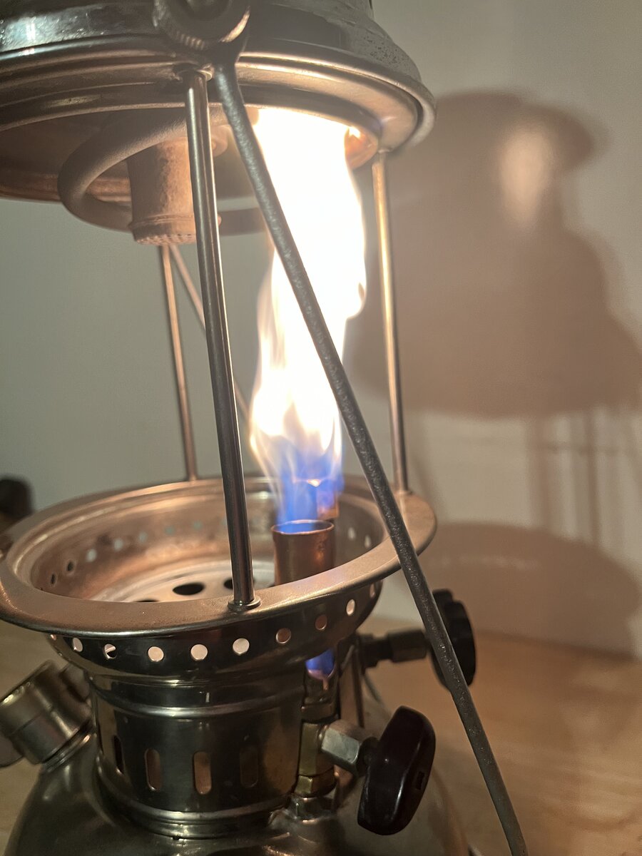

  21. Tony Press
    11,091

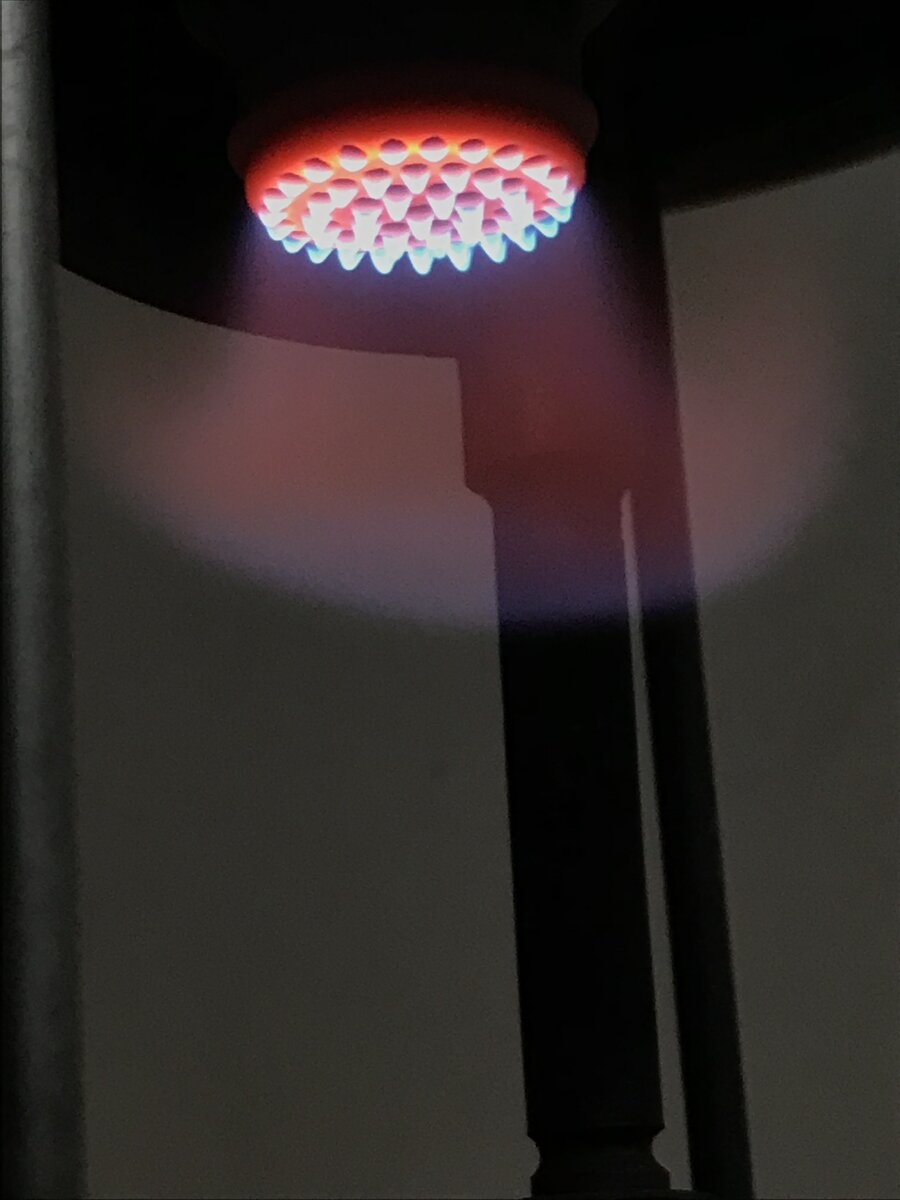

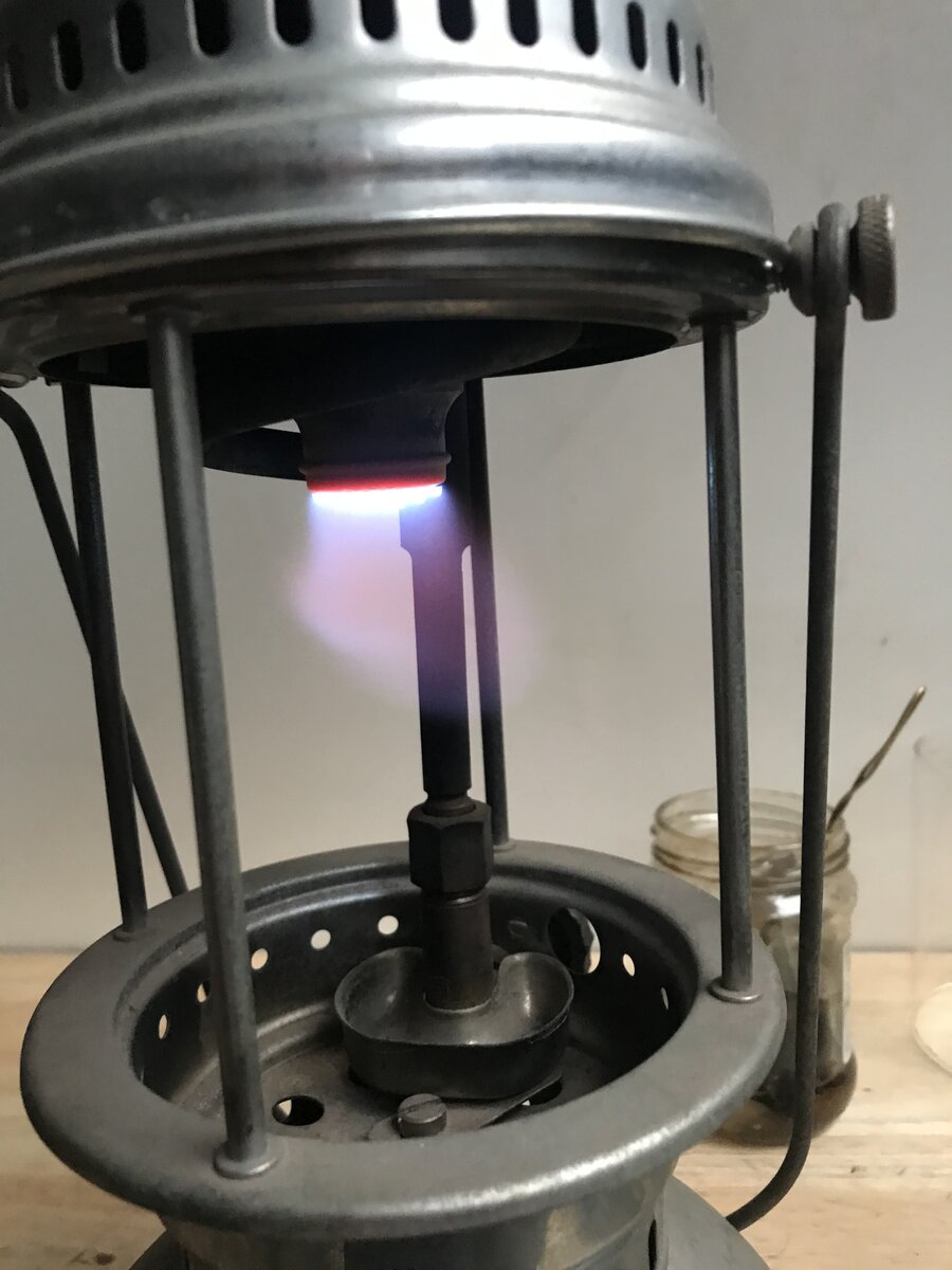

    1938 Petromax 828 ——> My first Petromax/Rapid full fettle.
    I’m not afraid of them anymore…;).

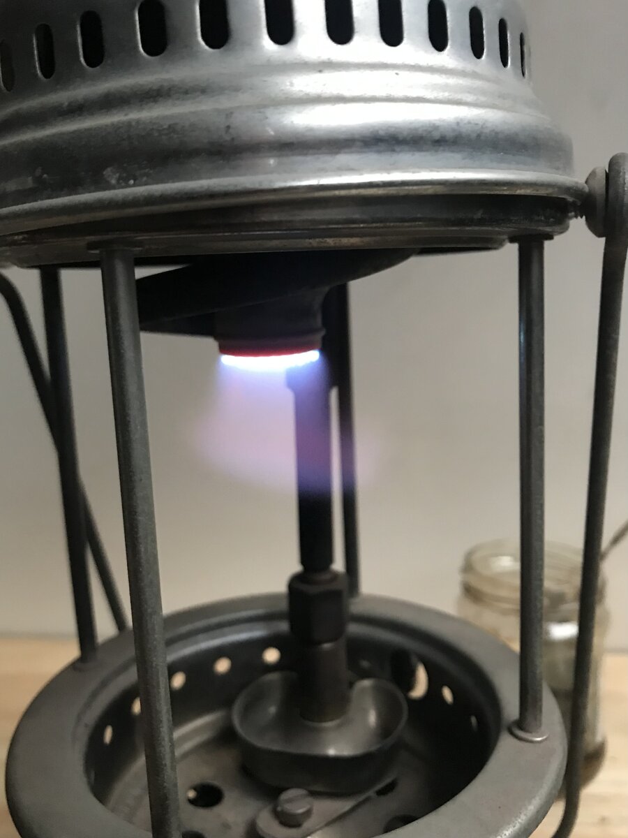

  22. WimVe
    3,537
    Nice, looking at the flame of the rapid : it isn't working like it should. It should have a steel blue sturdy flame. Like a gas torch or paint stripper.
    Do you have a pre heater alcohol disc?
    The slow start method is that way easier then the tilley pre heater clip. Especially with glass in situ.

  24. Tony Press
    11,091
    @WimVe and @Jacob van Pareen
    I’ve pulled the rapid heater apart and cleaned it thoroughly, but I suspect it has an enlarged jet. I’ll give it one more service to see how it goes.
    This is my first Petromax Rapid service so I’m learning as I go.
    But… I actually prefer the alcohol preheat, and never use the rapid on my Geniol stoves etc. I do have a Petromax spirit dish that I was going to fit eventually.
    Stay tuned.
  25. Nils Stephenson
    3,393
    This generation Petromax rapid usually doesn't have a hole in the globe rest to allow filling and lighting a pre-heat dish. Makes it bit redundant to fit one.
  26. WimVe
    3,537
    With the old style "Dreh rapid", it is possible to open the valve more or less. Playing with it may also chance performance.

  28. Tony Press
    11,091
    @WimVe
    I might give the tip of the rapid’s control shaft a good polish with fine emery paper to make sure it can be steadily opened.
  29. MYN
    Perhaps the extra tiny air holes are a little clogged.
    If it doesn't turn out well enough, you always have the option of a blanking plug...:lol::p
  30. Tony Press
    11,091
    @MYN
    I did clean the tiny air holes with a very fine tapered needle, but when morning breaks, I’ll go over the rapid pre-heater again.
