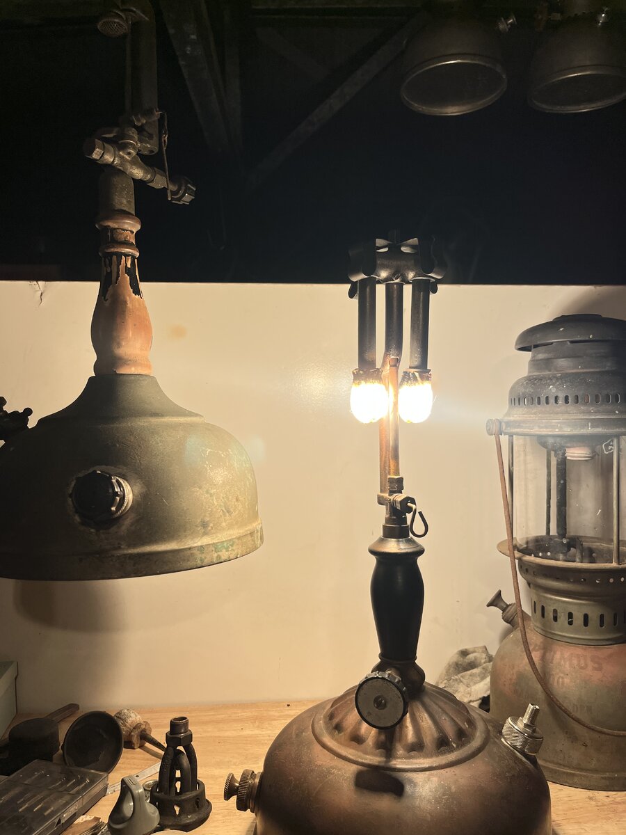

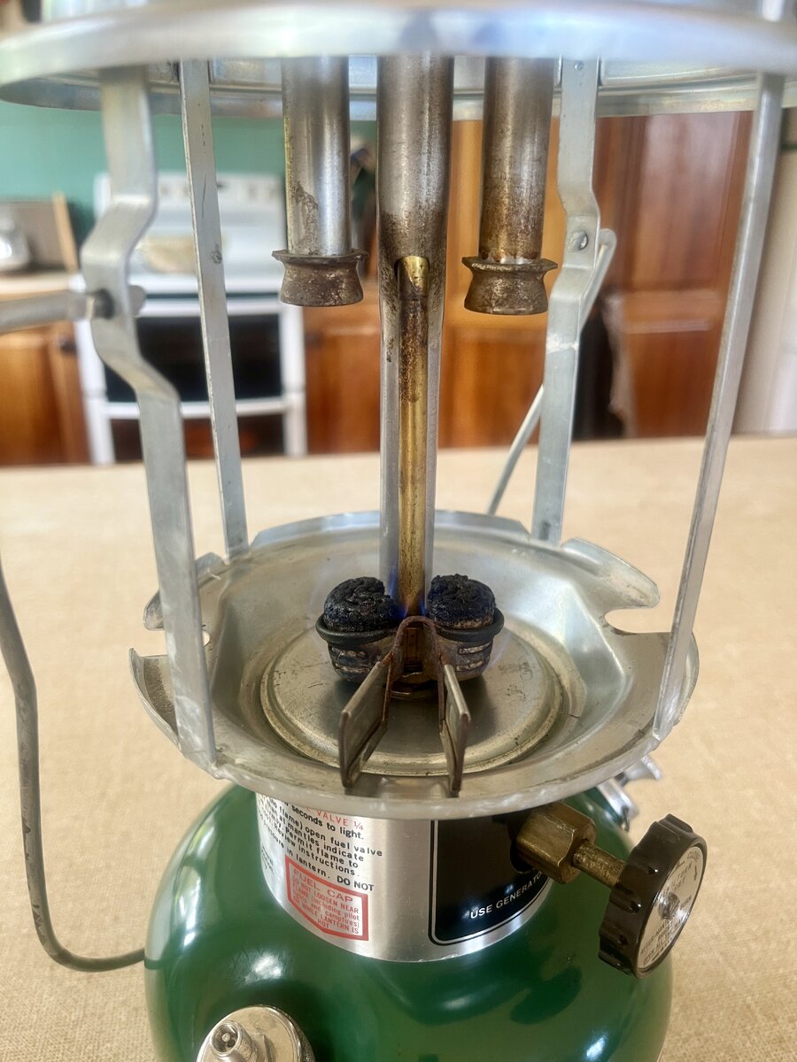

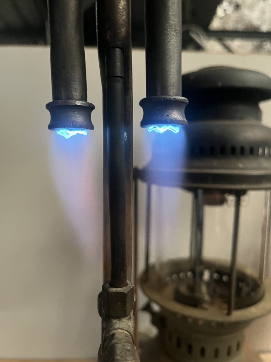

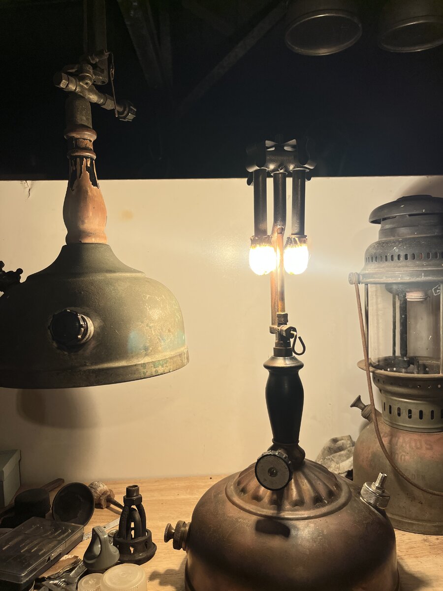

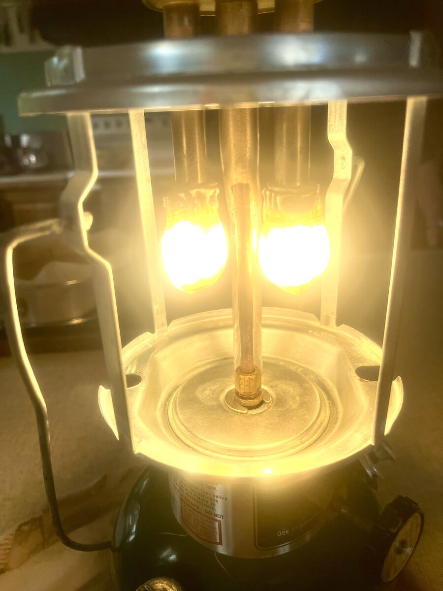

    Here is the 118A with the Peerless 2C-HG mantles fitted.
    Correction! Correction! Correction!
    The lamp is, of course, a Canadian Coleman 118B!!!! I don’t know why I started out calling it a 118A.
    This note applies to the 4 posts of mine directly above.

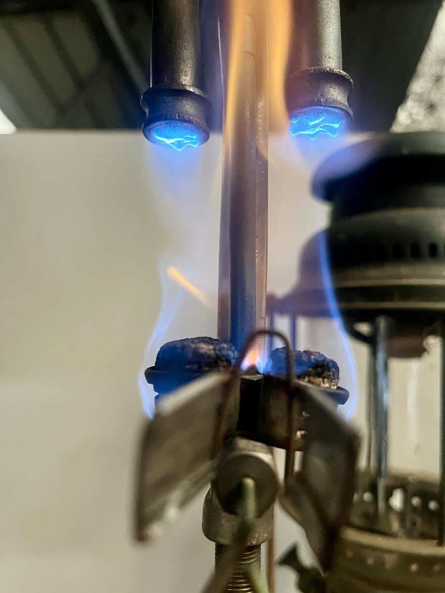

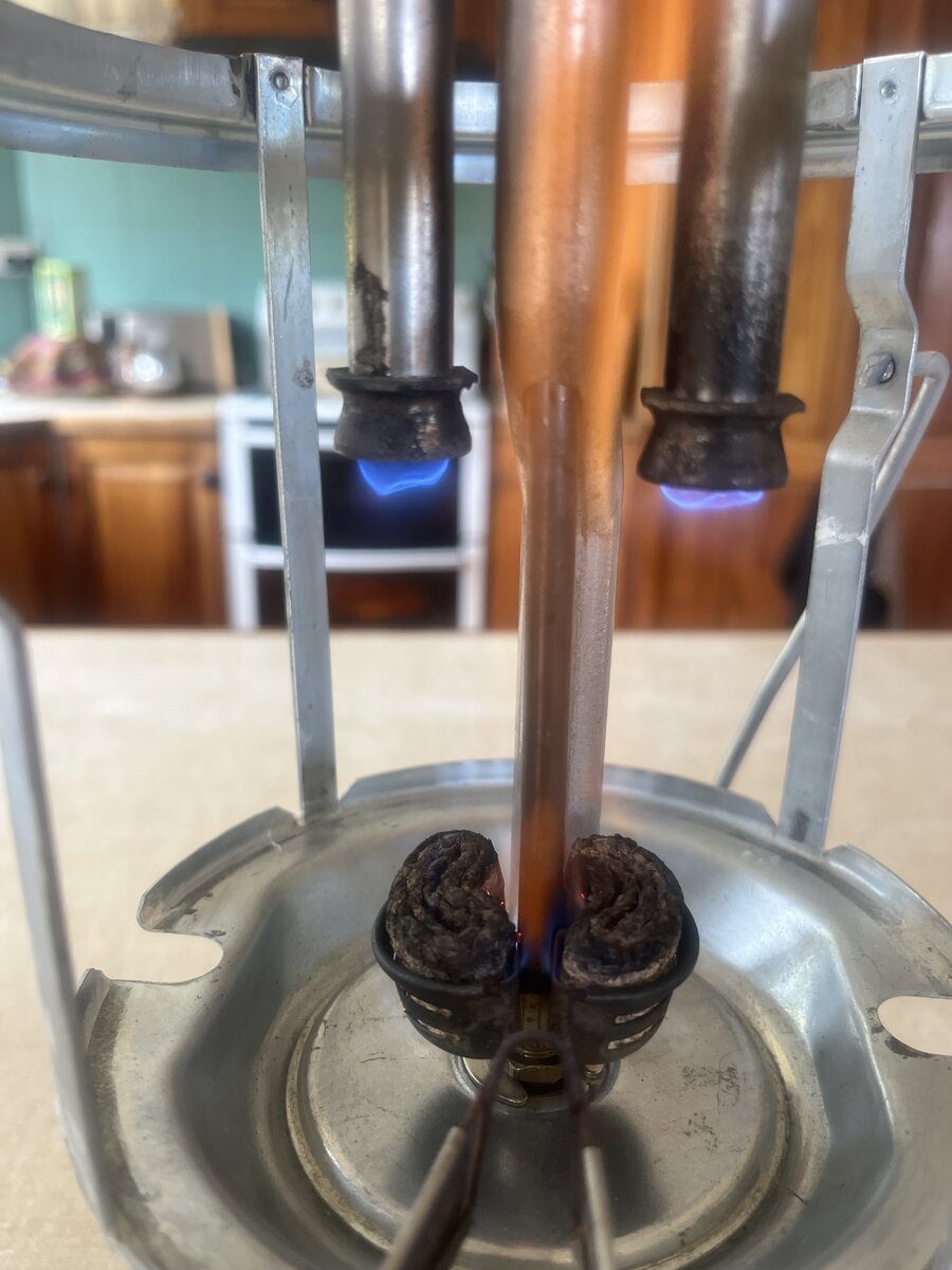

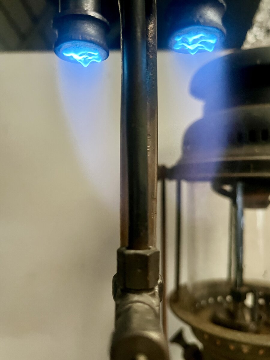

    Testing another Canadian Coleman 118B.
    Note that the original screens in the burner caps were rusted and falling apart. The screens have been replaced here by a finer brass mesh.
    Operating at 15psi with the valve just open slightly.
    Probably the burner caps should be replaced, but I like to keep as much of the original fittings as I can.
    I expect this set up will last a long time.

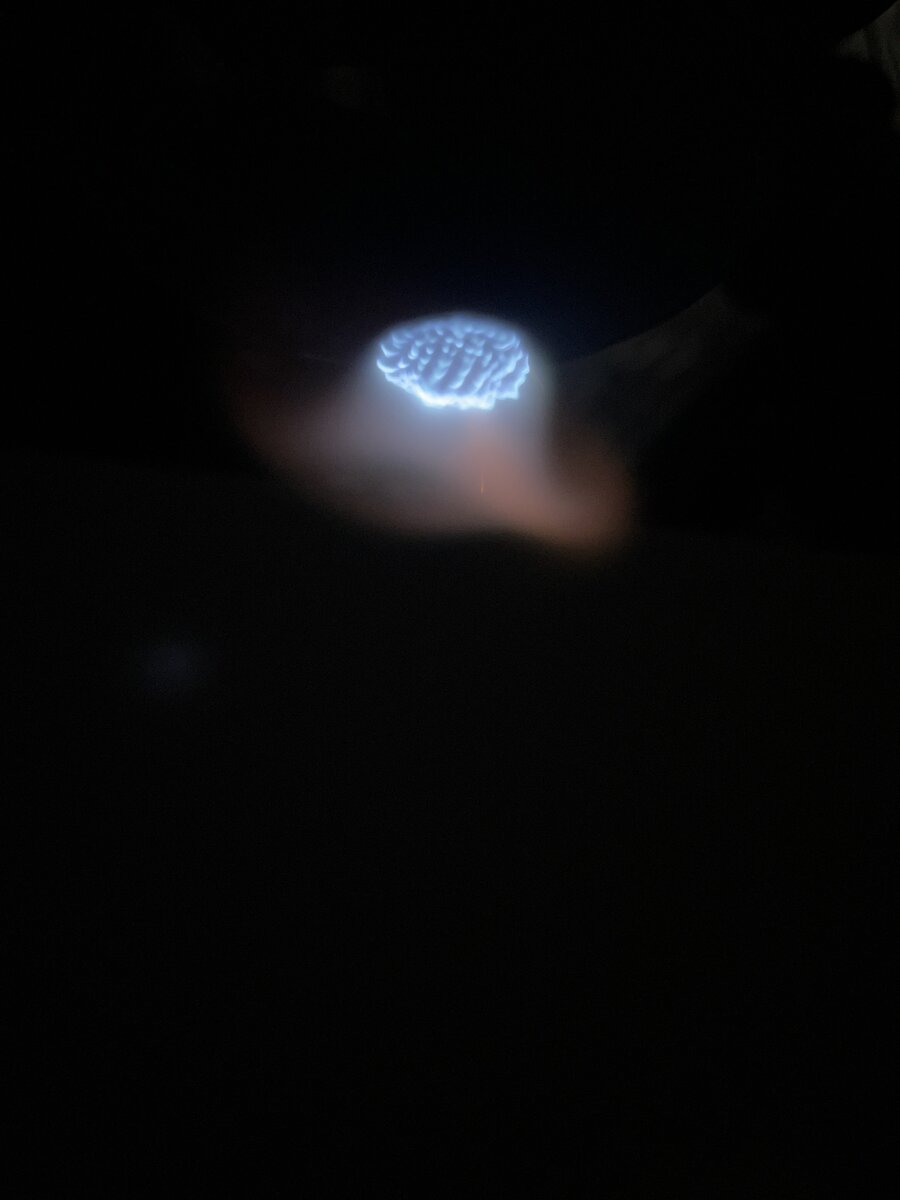

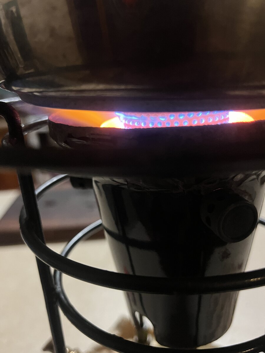

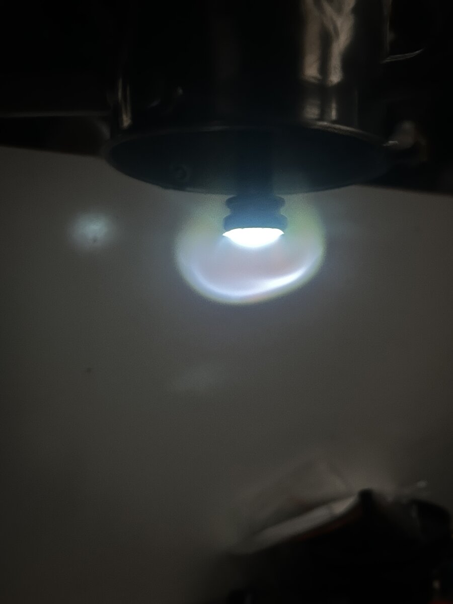

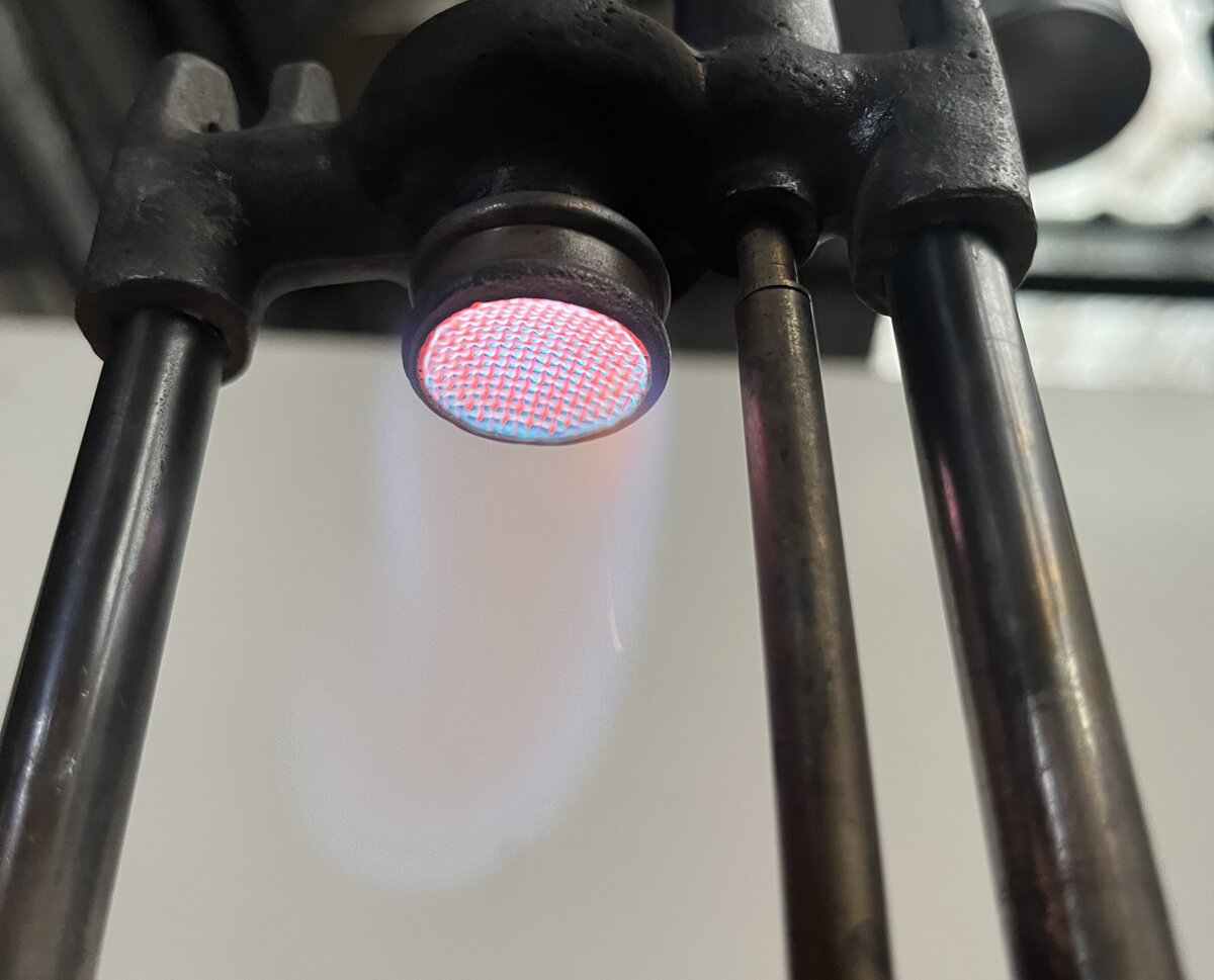

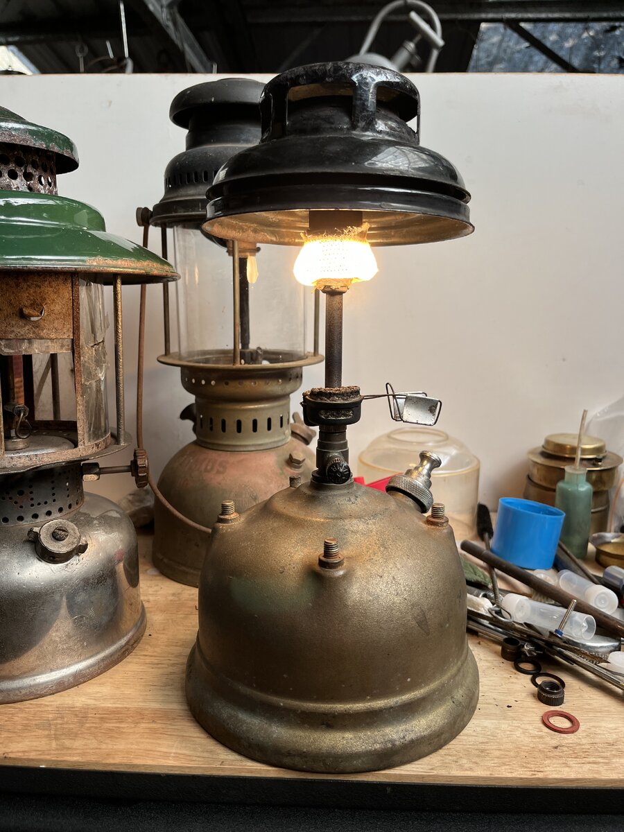

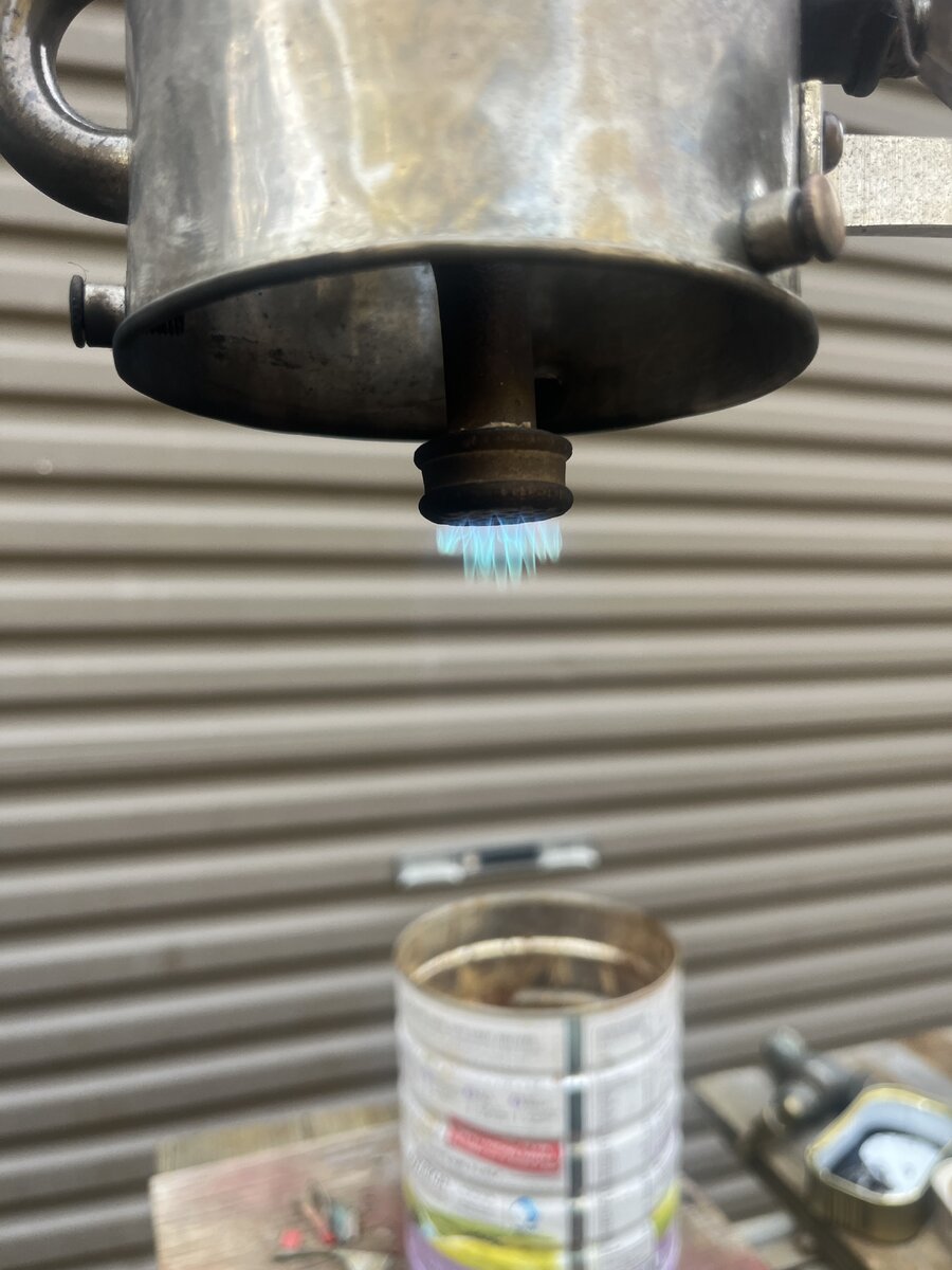

    Testing an old brass bottom, patent -stamped Tilley 606 vapouriser.
    I cleaned it up and gave it a few shifts in the ultrasonic cleaner.
    Here testing with a known working burner, hood and mantle.

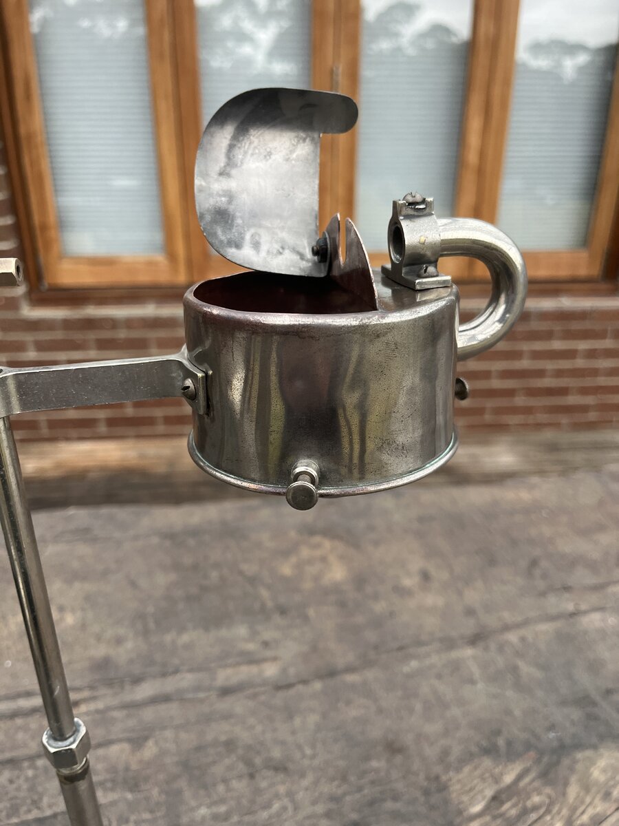

    Here, with the burner I’m fitting to a 1949-1953 Tilley X246.
    And here, the finished X246.

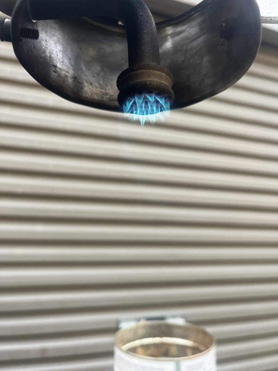

    I dug it out of the shed and got it going for a friend who’s renovating an old house. I was pleased to get a vapouriser that works like it should. The vapouriser spent a hour or two in the ultrasonic cleaner.

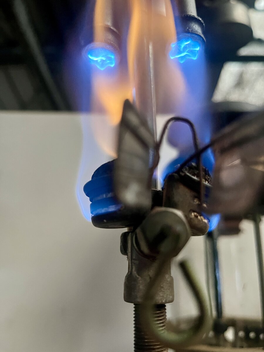

    Tony Press

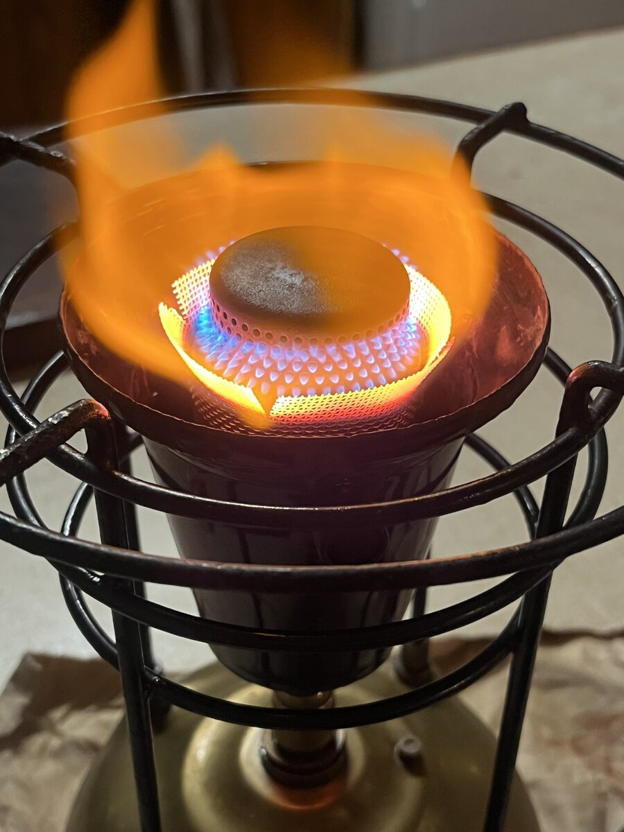

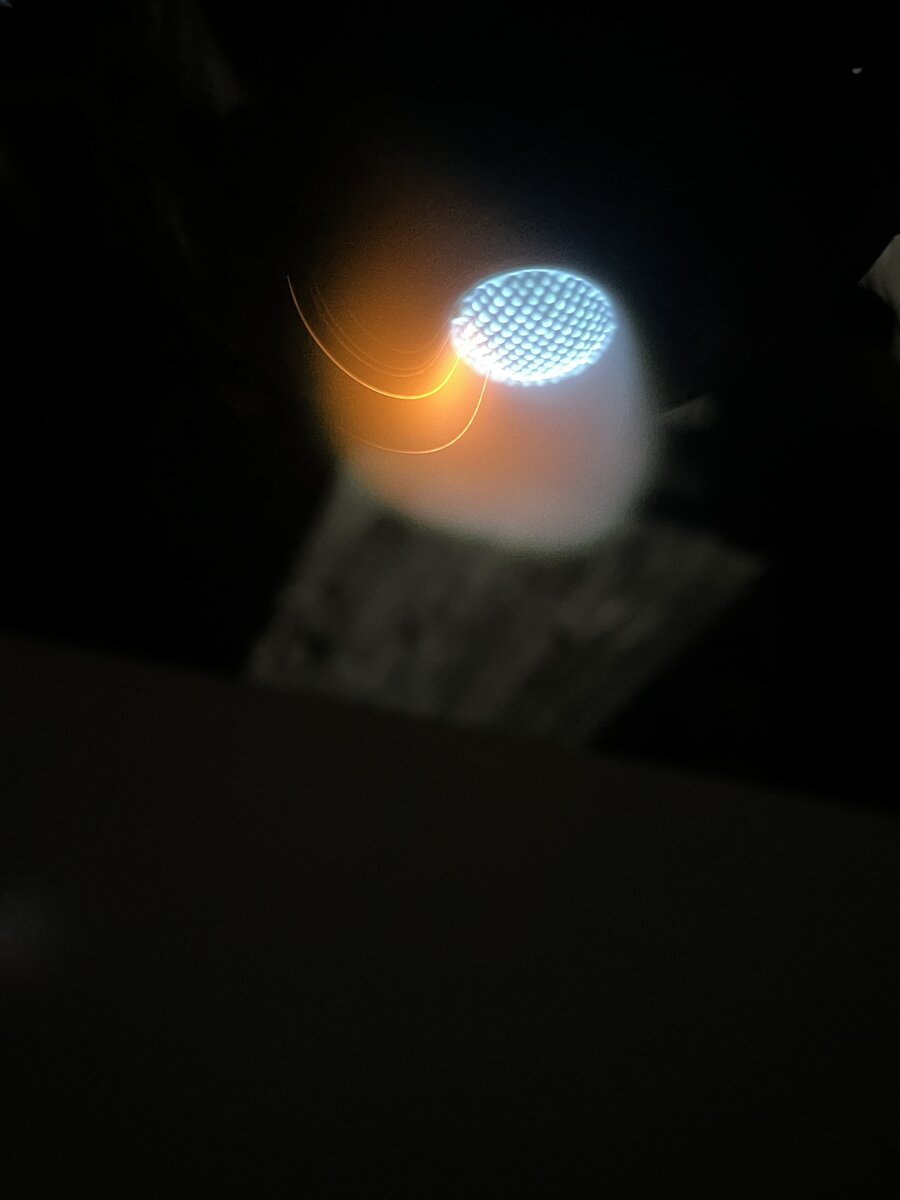

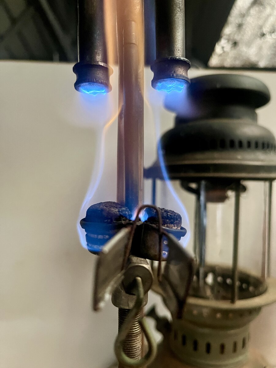

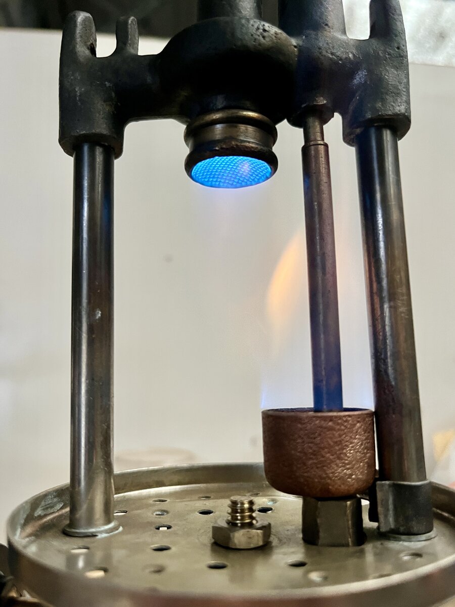

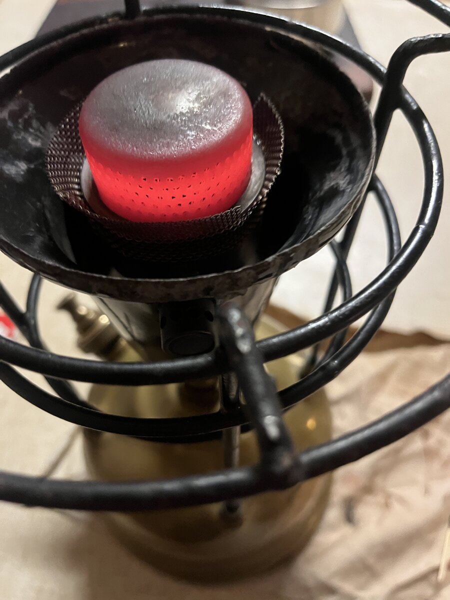

  11. Tony Press

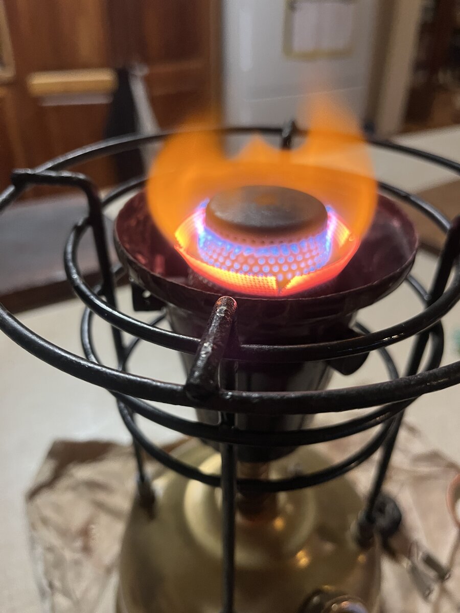

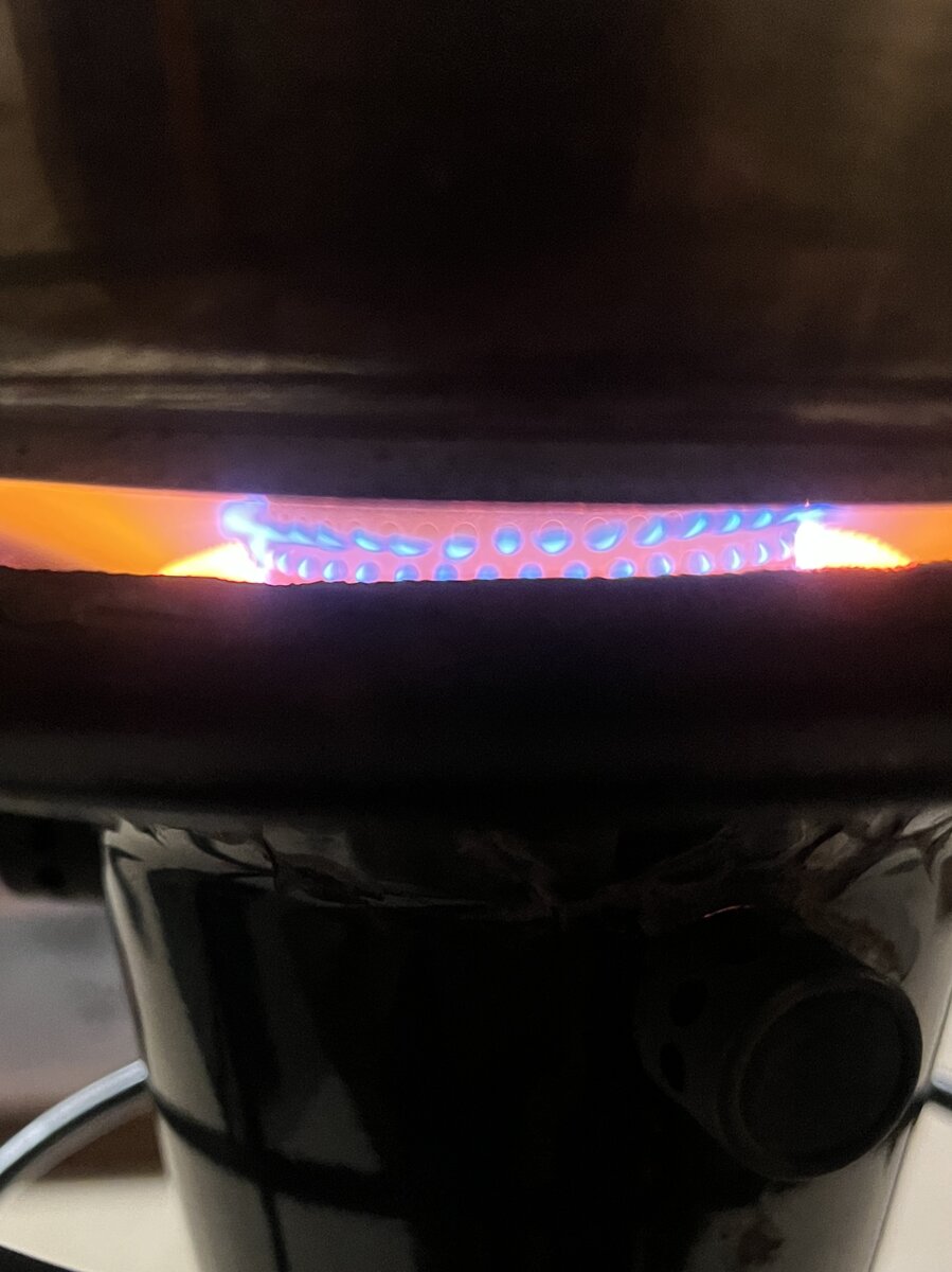

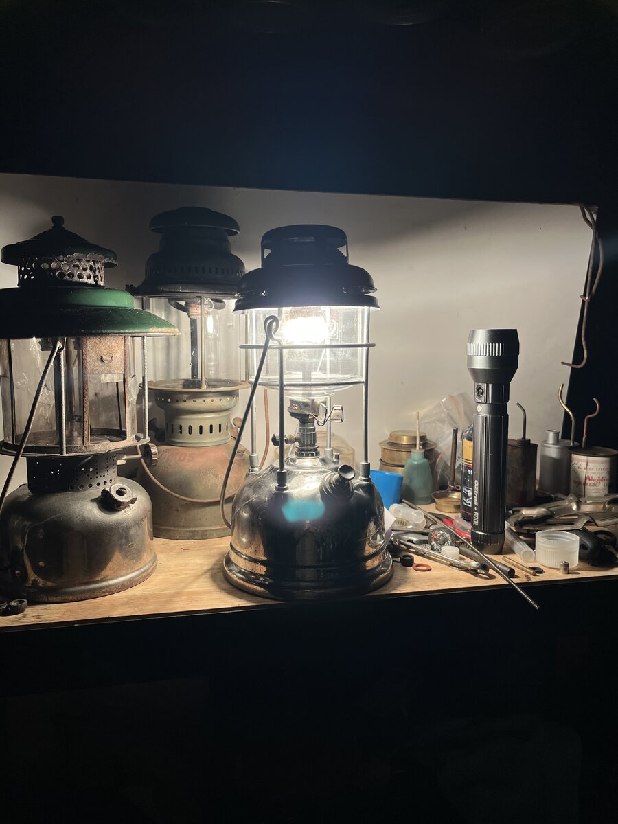

    Testing a 1956 Tilley CS56.
    Note: the orange flame is not because it’s burning rich, it is because it’s the first light up of the burner after cleaning, and a mix of cleaned brass, steel, stainless steel, and new stainless steel.
    Starting pressure (unstable)
    Operating pressure,
    No soot.

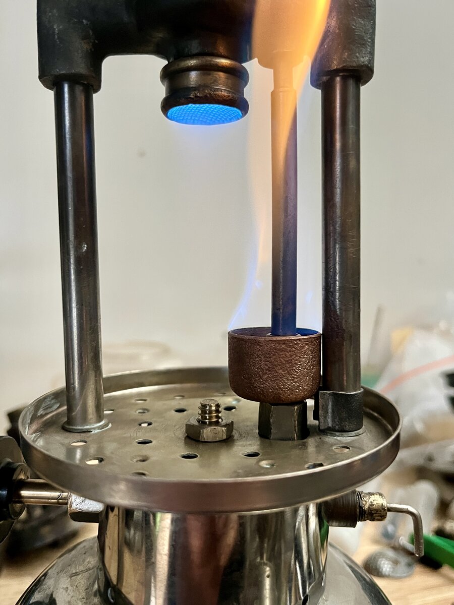

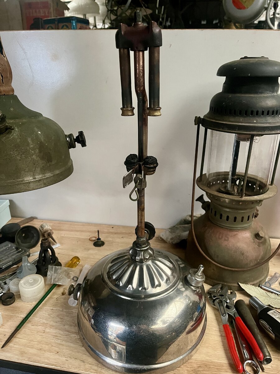

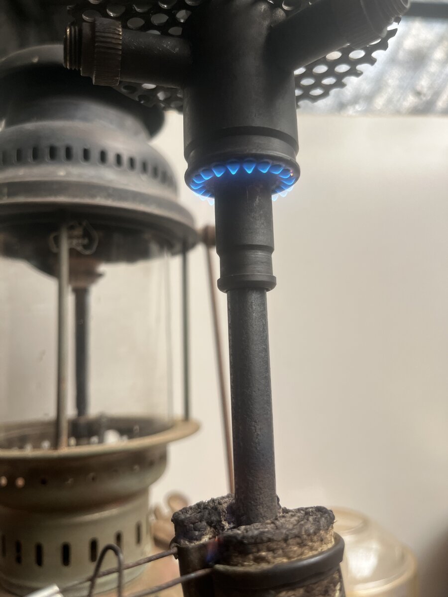

  12. Tony Press
    Testing the burners on a Coleman 220K.
    The lantern was in very good condition, but… it would not light because the bottom hole in the fuel pickup was corroded shut. It’s taken me a few weeks and some patience to get the lantern apart (heat, penetrating oil; repeat; repeat; repeat; leave along before you break something. Come back —> repeat; repeat. Notice that the brown thread lock has started to crack. Repeat… wait until brother-in-law arrives and ask him to be ready to firmly hold the tank. More heat and quench and penetrating oil —> brother-in-law hold a tank very firmly; I grab large Knipex parallel pliers… Voila!
    Back together.

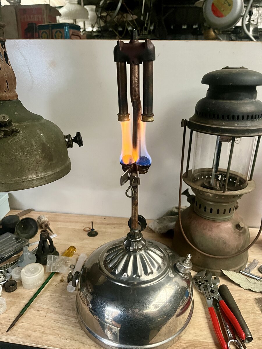

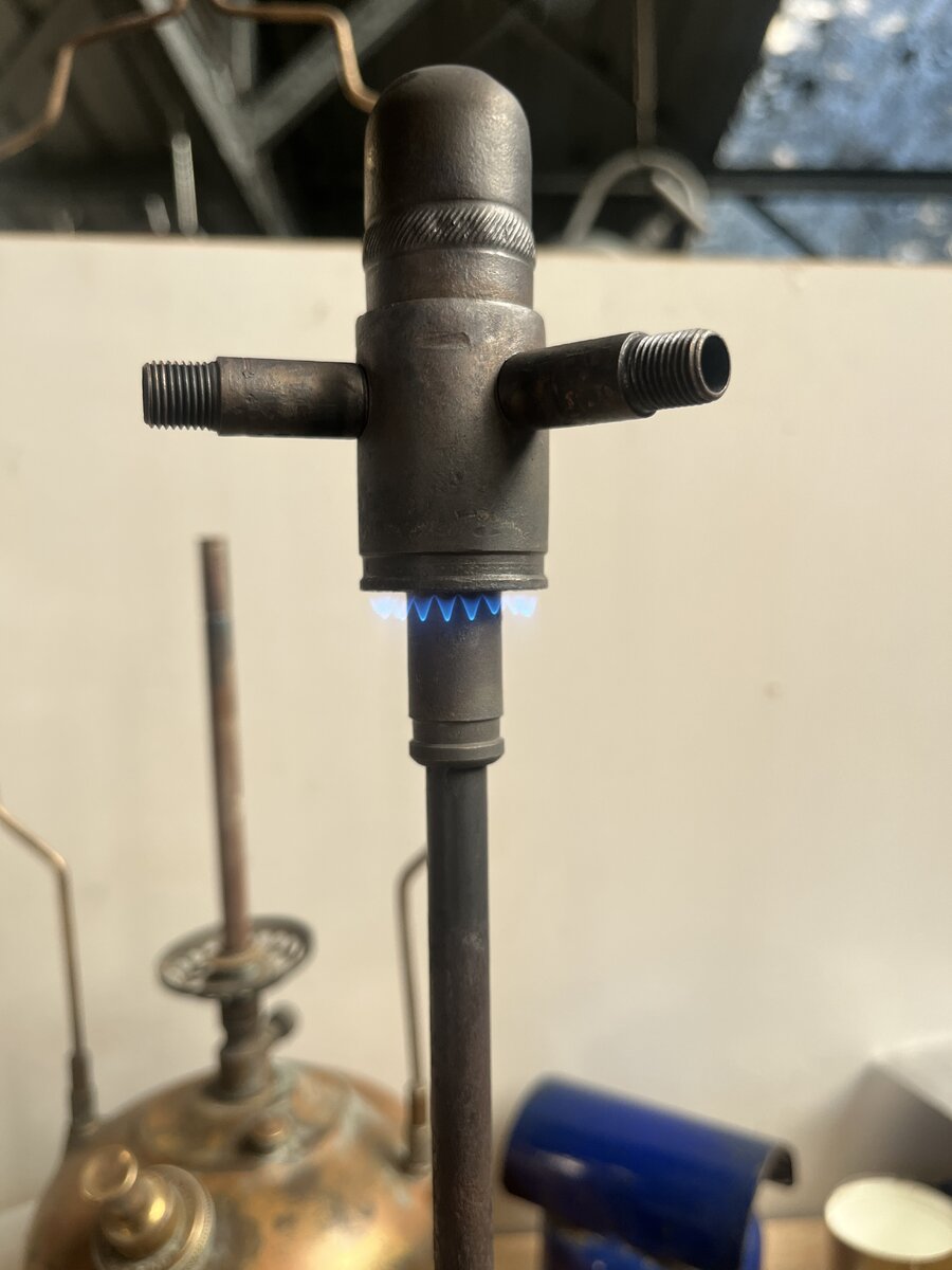

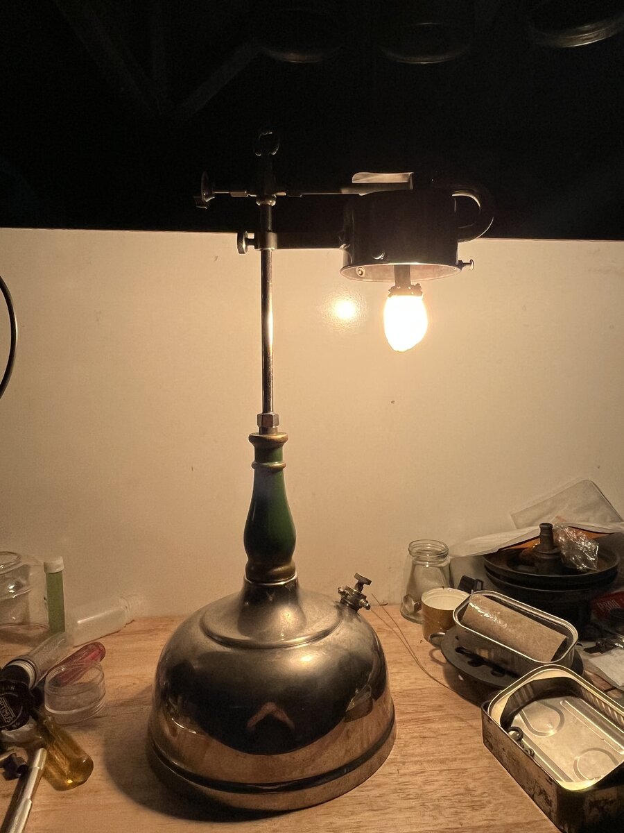

    Aussie Gloria Table lamp using a Gloria hollow wire No. 20 burner.

  16. Tony Press
    *daylight!
  17. MYN
    Nice flame.
  18. Tony Press
  19. Jacob van Pareen South Africa

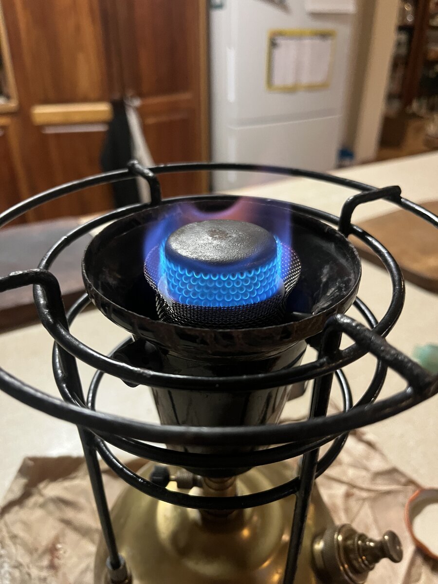

    Testing a 1958 Canadian 236 straight out of the delivery carton because it had a (broken) mantle on it.
    This should be a straightforward restoration job, by the looks of that burn.

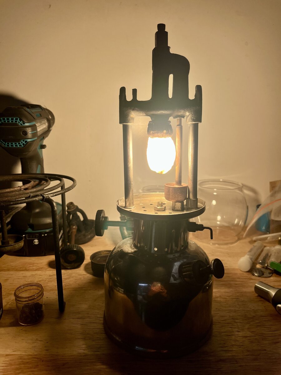

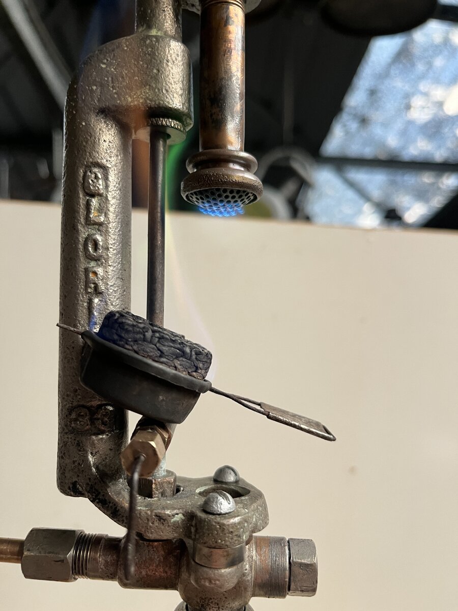

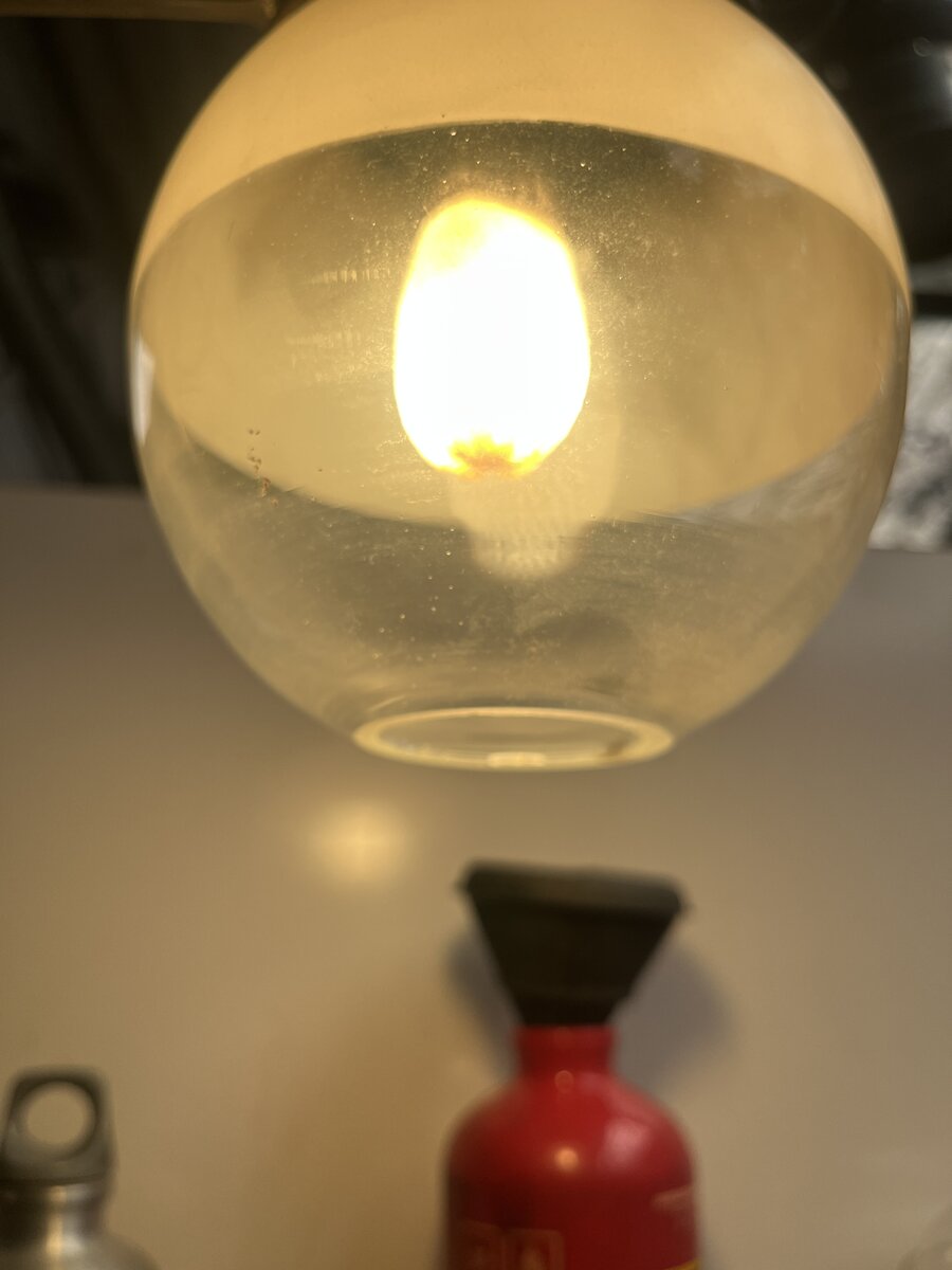

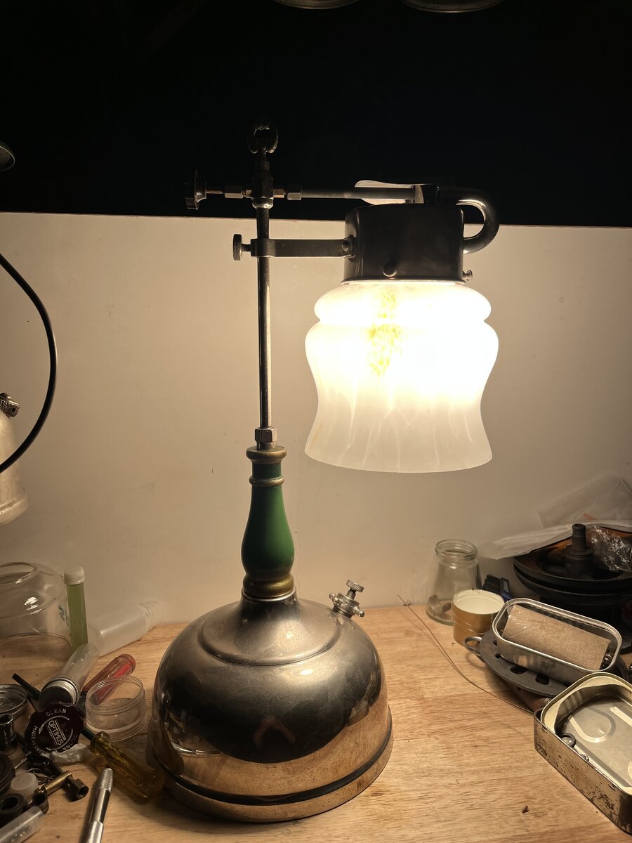

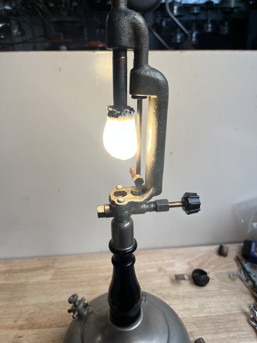

    A 1930s Australian Gloria Table Lamp fitted with Gloria 33 lantern burner (as originally fitted).
    I was difficult to keep the flame from lifting off the burner cap, but it looked fine anyway so I fitted a 300cp “Love Mantle”.

  25. Tony Press

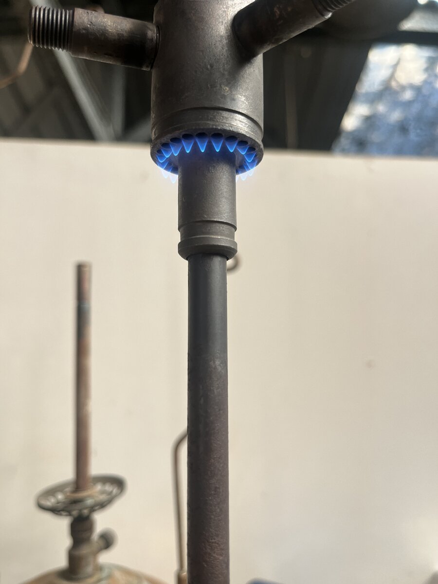

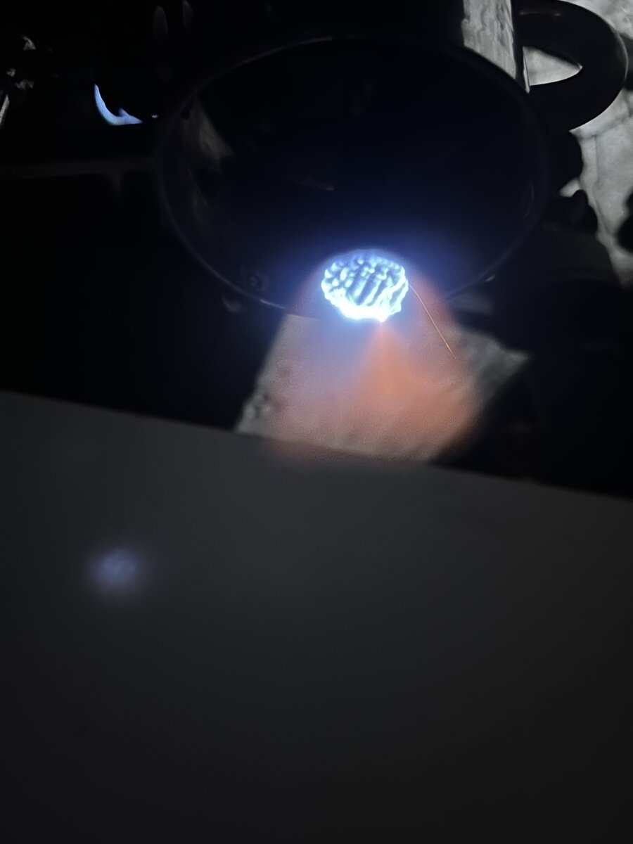

    Testing a 1930s Australian Gloria table lamp No.20 burner.
    Not the best flame photos, but the burner and generator are working well. Straight up from cleaning, so a bit of residue to burn off.

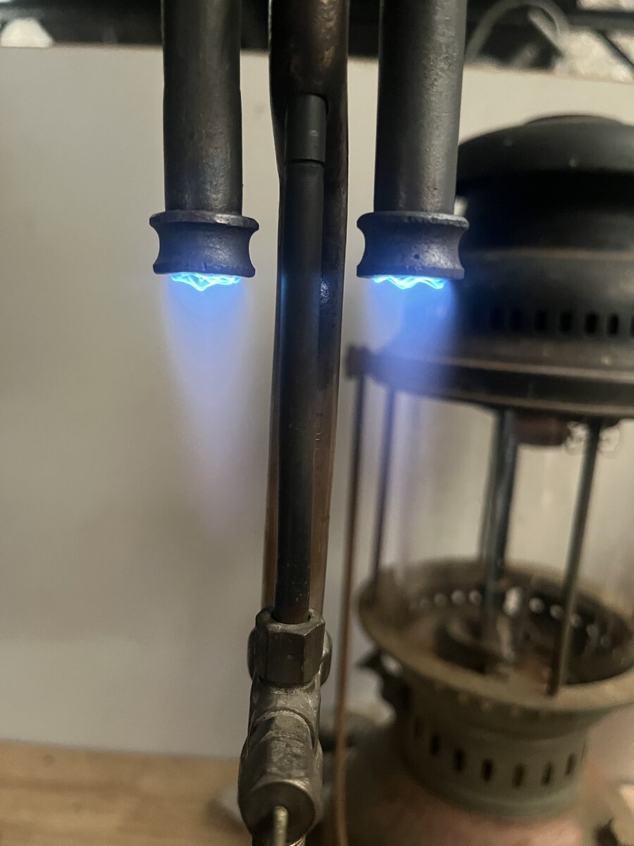

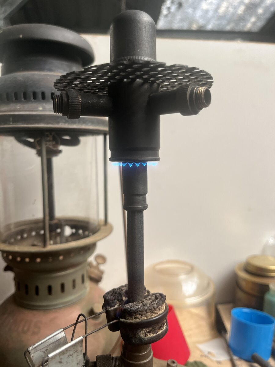

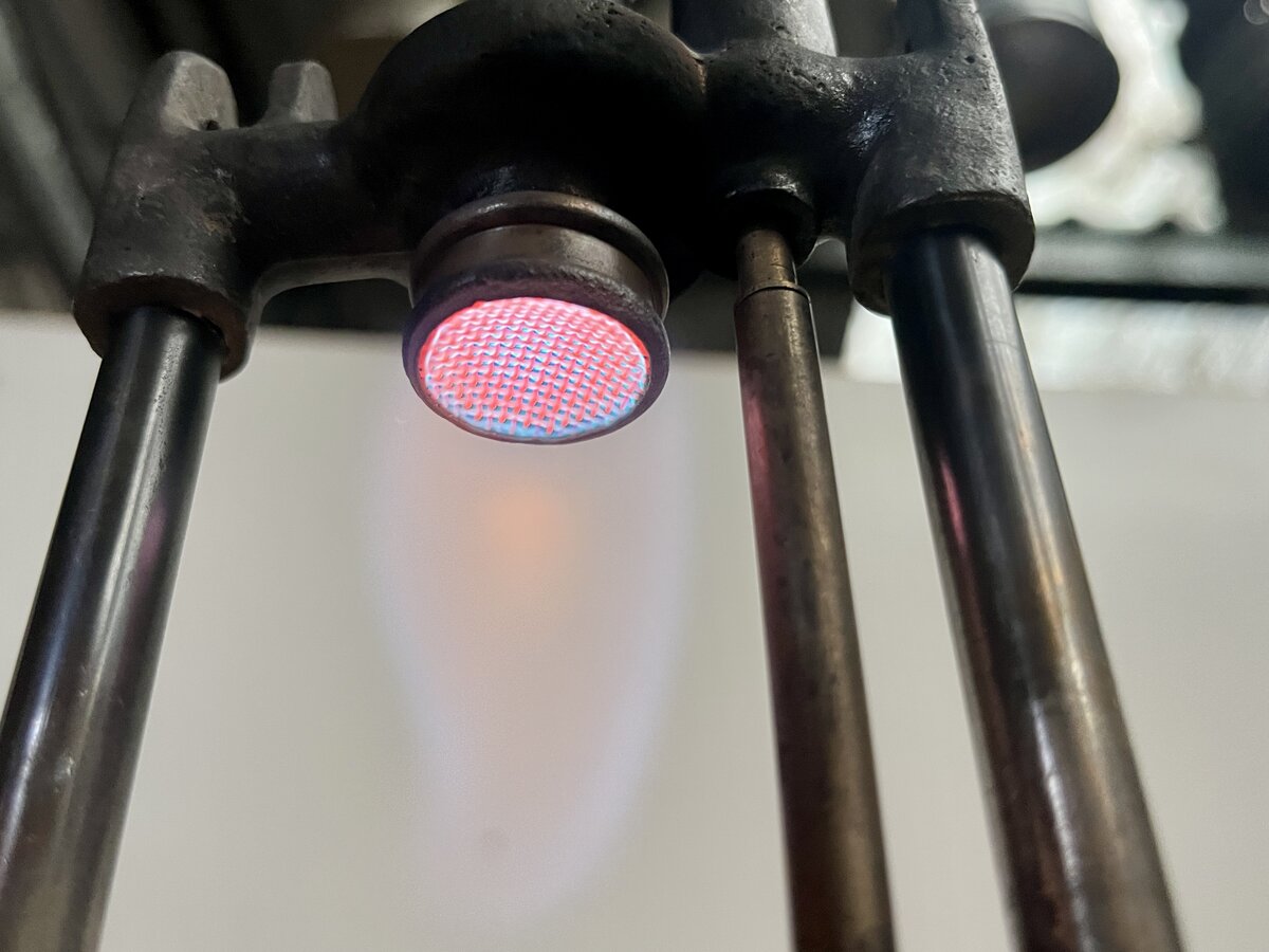

    Testing on early (circa 1935) burner for a Tilley EX4 of the same period.
    Discussion of the manufacture of this variation of the burner is here:
    Tilley Burners: Differing lengths
    This particular burner is to replace the one that came with the lantern. The burner on the lantern was disfunctional. Luckily I had the a very good quality example of the same style of burner in my used spares.
    —> Happy!
