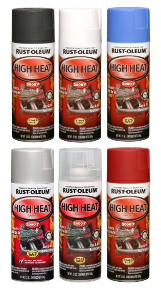

    Recently i have gotten this locally, the clear one, depending on how its sprayed on, its between gloss and satin.
    The first experiment was on
    1. 300X brass hoods, no color change after curing
    2. 150cp hood, no color change after curing
    3. E41 stainless cowl, appears to be slightly on the yellow tint side, no change after curing
    4. Quicklite bare steel frame, Fred's mica chimney metal parts, no change after curing
    I like it so far, but i cannot speak of the other colors..
