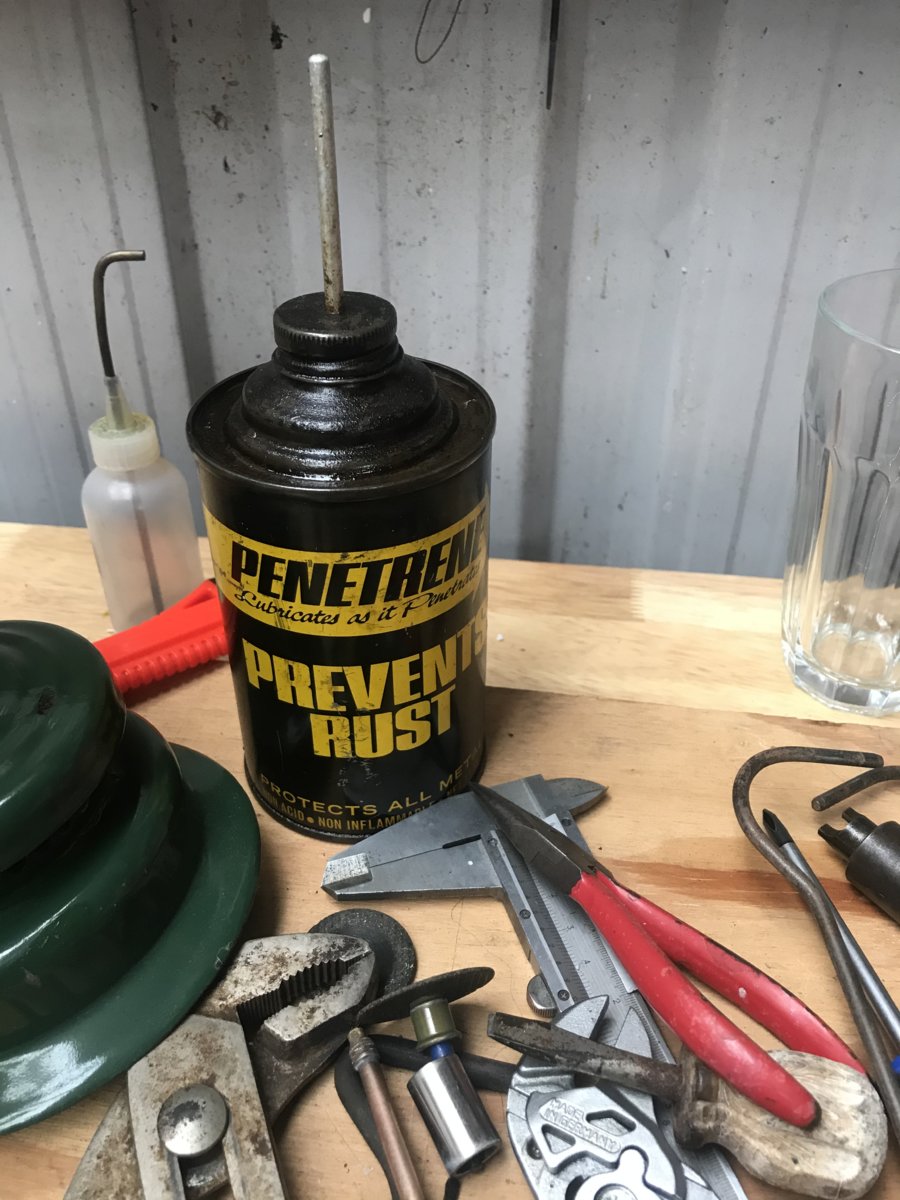

    I had read that 1 part acetone , 3 parts brake fluid, seems to do the trick, if you are going to leave it a few days, it make good penatrating oil, all so a fella used very heated cooking oil and poured it into the font just enough to cover the NRV.
    11,026
    Darryl
    I use a mix of 50:50 acetone and automatic transmission fluid for items that require a lot of penetrating oil. I find that Penetrene actually works better as it doesn’t separate.
    I’m going to fill this tank with Penetrene when it dries out, as well as fill the pump tube. I’ll leave it for a week and come back to it.

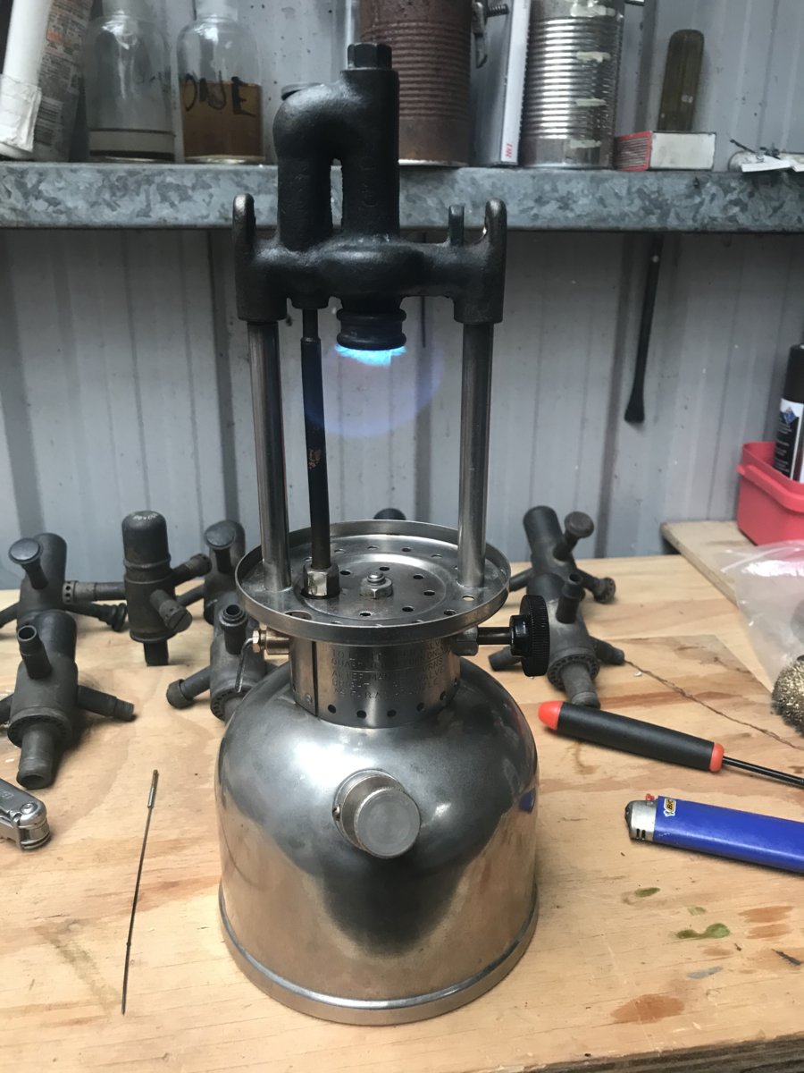

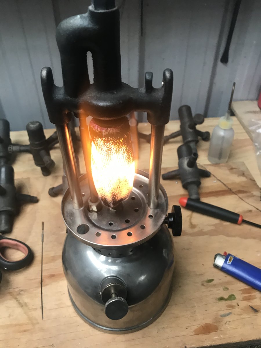

    I pondered this dilemma, and thought: if this lantern is from 1933, it will most likely have a cork pip. So I gently poked the pip and pushed it down a couple of millimetres with a broken Tilley pricker, and filled the bottom of the pump tube with 3-in-1 oil. After letting it sit for a few minutes, I tested the pump.
    The NRV is working as it should. I’ll now get this lantern going.

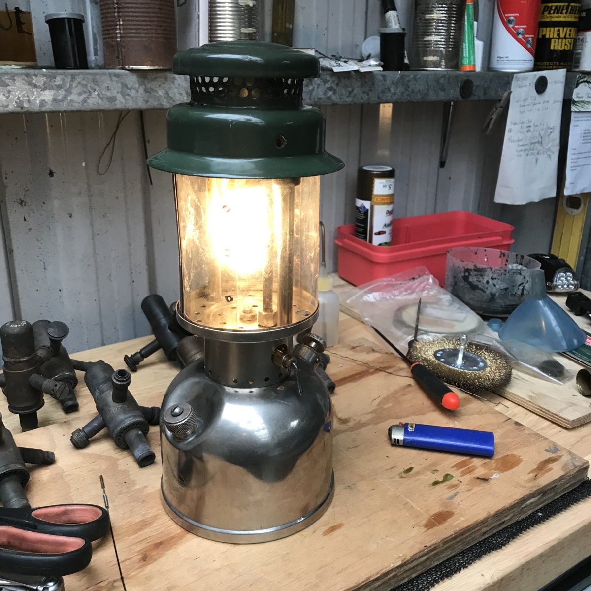

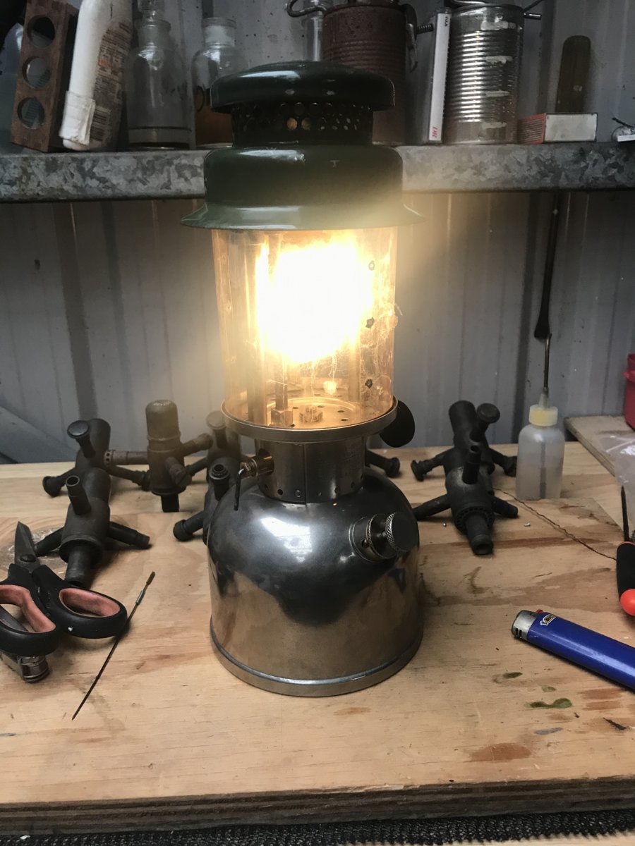

    Lovely job, running well. Nice restoration, you must be pleased.
  9. Tony Press
    11,026
    I am pleased. I’m glad I got it running, even though it will now be a shelf queen.
  10. AussiePete
    Great to see her running so well.
    Well done, you’ve done a top job on the fettle.
