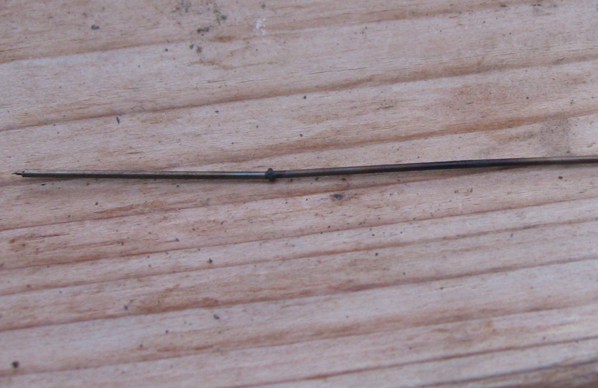

    Of course while I was dealing with the stuck vapouriser I took a look at the carbon buildup on the pricker wire.
    On a previous attempt when it had burned about this long and then started to misbehave I found a lot of carbon on the wire.
    I think I mentioned that somewhere in the earlier posts.
    This time there was just some discolouration of the wire at what I guess is now the hottest point - near the middle.
    It would fall just below the bottom of the spigot I suppose. The top part of the wire still looked like new. I'm sorry but again I was naughty about taking pictures.

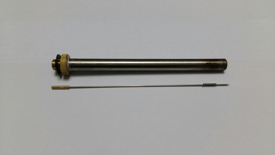

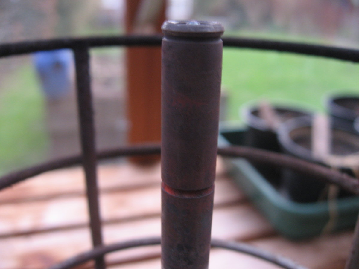

  4. JonD
    JonD Subscriber
    Apr 15, 2014
    1,010
    Hertfordshire, England
    Here is the red stuff that develops between the spigot and vapouriser.
    Luckily quite easy to remove burner & hood this time.
    Here is the pricker wire. Now a bit blacker at the hotspot than when I last looked.

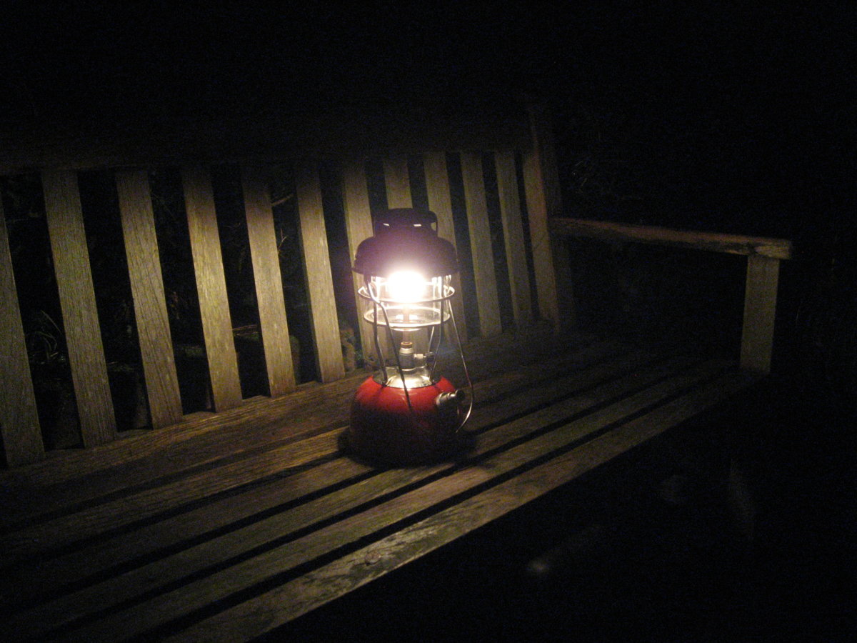

    Spread the love. It was time to check the red one from 1973.
    All was completely free and easy on this one between vapouriser and spigot/hood. All it needed was some preheating.
    It is back on all the original bits from 1973.
    This picture is stopped down to prevent flaring - it is bright.
    I think I would recommend an addition to the lighting up procedure.
    Do everything you would normally do, check fuel, clean the glass etc.
    Before you light the preheater, can the top assembly swivel on the vapouriser?
    Is it catching on the cage - or does it turn smoothly?
    If not find out why.
    If the vapouriser or spigot have crud attached to them which restricts the movement - clean it off. It will only build up and weld them together next time you burn.
    If the height of the burner and hood is determined by catching on the cage not by sitting on the vapouriser then increase the height of the vapouriser.
    Add more (or thicker) washers between fuel cock and tank top. Vapouriser must have good contact with the burner.
    Shimming this up too much will make the rim of the hood interfere with the handle when it is folded - there is 3-4mm of leeway.
    I am checking this on mine each time as I light up. It is serving me well so far - only time will tell.

    I re-tested my Korean-made steel-with-brass-nipple vapouriser today and compared it to a modern Tilley vapouriser. The rsults are at the bottom of this thread:
    Korean Tilley Vapourisers

    Disaster strikes again... The red one has swollen it's vapouriser and stuck in the spigot. So the answer is not yet found here in any of my precautions.
    That lamp was an absolutely stock X246B, it was almost unfired from the day it was made in 1973 but it has failed now after about 10hours of total running.
    While it was running it was apparently burning perfectly, very bright and little smell. A few nights ago I came to light it and the burner would not come off the vapouriser for the
    now customary check of the vapouriser mating surface. Just a little crud in there I thought, it will come. Well it didn't. It was free to move for about 25-30mm but right at the
    top of the vapouriser, just before the burner should come off, it jammed fast.
    After struggling with it for some hours it was obvious I had to kill the mantle and remove the spigot to see what was going on. Vapouriser was swollen over the top 10mm or so.
    (I was much too cross about it to take any pictures- sorry!!) It was not swollen by much. The main tube of the vapouriser measures 9.5 - 9.6mm where the top end was up at 10.5mm.
    The spigot hole is 10mm by my reckoning so of course it could not pass. I spent some time squashing it down in a machine vice and eventually had to remove the last high spots
    with a diamond file to allow it to pass through the spigot. Spigot saved. Vapouriser I might not want to try again. Thinking on it. :rage:
    So we are back where we started. Why did it do it? All the previous arguments come round again such as was it the fuel?
    The pricker wire is clean - no significant carbon. The jet is clear. So it must have distorted because of heat. Why?
    I did say it was running extremely bright - some others have reported this too - some X246B are white hot while others lag behind somewhat yellow.
    White means hot. We all know that flame temperature depends on mixture - lets bear with the idea this one was running at peak temperature and probably so are others that
    burn perfectly white.
    The top was bearing down on the vapouriser clear of the cage - I assembled it like that following my theory that contact between vapouriser and burner will take away some heat.
    I still stand by that idea but... It was also putting the weight of the burner down on the vapouriser - if the vapouriser got hot enough to soften the downward force would cause
    the bulge and we have explained the problem. But plenty of early Tilleys worked exactly like this...?

    In Case you'll throw away the generator anyhow, make a cut at the swollen section. You should find hard carbon deposit inside. This is not only deposit. The carbon swells inside the generator and creates enormous power which deformates the steel.
    As said further up, this carbon crack products happens more easily with iso alkane. Less carbon with n-alkane.
