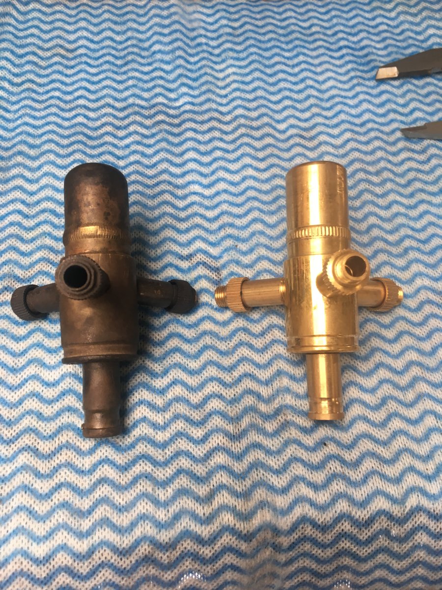

    The one on the left is from an X246 (1950-1955) (with the patent number on the top);
    The one in the middle is from an X246B;
    The one on the right is from an X246A.
    On each I measured the spigot;
    the burner body;
    and the mixing tube.
    From left to right the measurements are (not precise, and to the nearest mm):
    Spigot: 27;27;26mm
    Burner body: 40;36;37
    Mixing tube: 36; 30; 29.
    The older burner is bigger in the parts above the spigot.
    I make no claim that this sorts out any issues that @JonD has because I've not had any problems using the X246B burners in an older Tilley.

    @Tony Press Wow- You are the man! Great photos and it is so much help. Thank you very much.
    I knew as soon as I saw them I have the tiddler which sits in the middle. As you say X246B. :lol: My 1964 and 1973 ones were both like that.
    I would also say I immediately recognised the one on the left, that looks just like what is now in my 1964 one.
    That is one from juliands, obviously much bigger than the original but it fits the hood fine.
    It has worked well but the spigot does bind with the vapouriser in a minor way. So far I think that is just a metal/metal reaction effect - no bulging at all - just some reaction
    between clean & shiny (= reactive) steel and brass surfaces. I part them before every lighting and gradually it improves with time. Each lighting their parting becomes a little easier than the last.
    Great to have the dimensions too - excellent. I have no time tonight but I'm going to do some calculation work with them. I want to know the difference in total surface area.
    I also didn't have any idea there was one size in-between on the X246A.
    You have done us a great service.:clap:

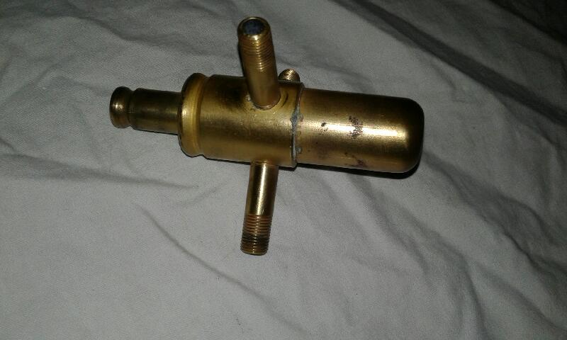

    Before you get too excited, here’s some more info:
    The one on the left is the old Tilley patent burner; theone on the right a Juliands reproduction.
    The measurements got the Juliands repel is (in same order as above: 24.5; 37; 27mm.
    I wouldn’t call this one (below) an X246A burner. It’s an oddity (so far) and I’ve only seen one of them. Because of that, I replaced it with an X246B burner and it works well. But, my other X246A has the old Tilley patent burner.
    Weight of the Tilley patent burner is 196g; the X246 is 164g; Juliands repro is 205g.
    Some of the finish on the Juliands repro is a bit rough (not too bad, though). I would get some 600 or 800 grain sandpaper and twirl the spigot over it for a while to smooth out the tooling marks.

    @Tony Press thanks - more very nice photos. That one very good to show differences between X246 and juliands.
    They are quite a near match - in the surface area, which I am thinking about, there can't be much difference. Flat top dome which could affect the mixing behaviour I suppose :-k
    I also had just a few pits in the dome of my juliands one but I don't recall any marks on the spigot. I think they are a good job at a fair price. Shipping to you could make them
    a bit expensive there though.
    Cheers. Jon

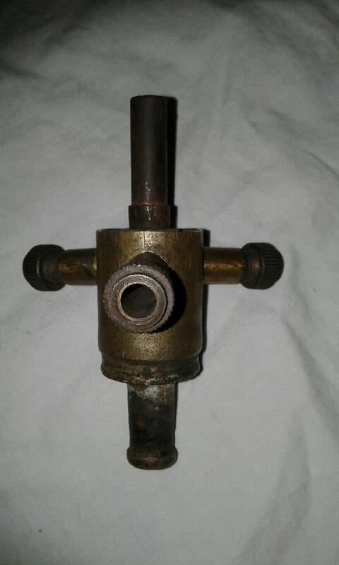

    Just like to throw a cat among the pigeons here is my different lot of burners .
    This is a brand new one I picked up
    Spigot 26mm burner body 37mm dome top 40mm.
    Enjoy Bob .
    This is the new one against an odd one I have.
    The spigot is 28mm body is 48mm dome unknown.
    One on left standard size / centre odd one /right one new one
    Another one I found had this size injector tube been reduced to fit ?
    Only found this after removing dome.
    What I did find that all air tubes are approx 15mm from top edge of burner
