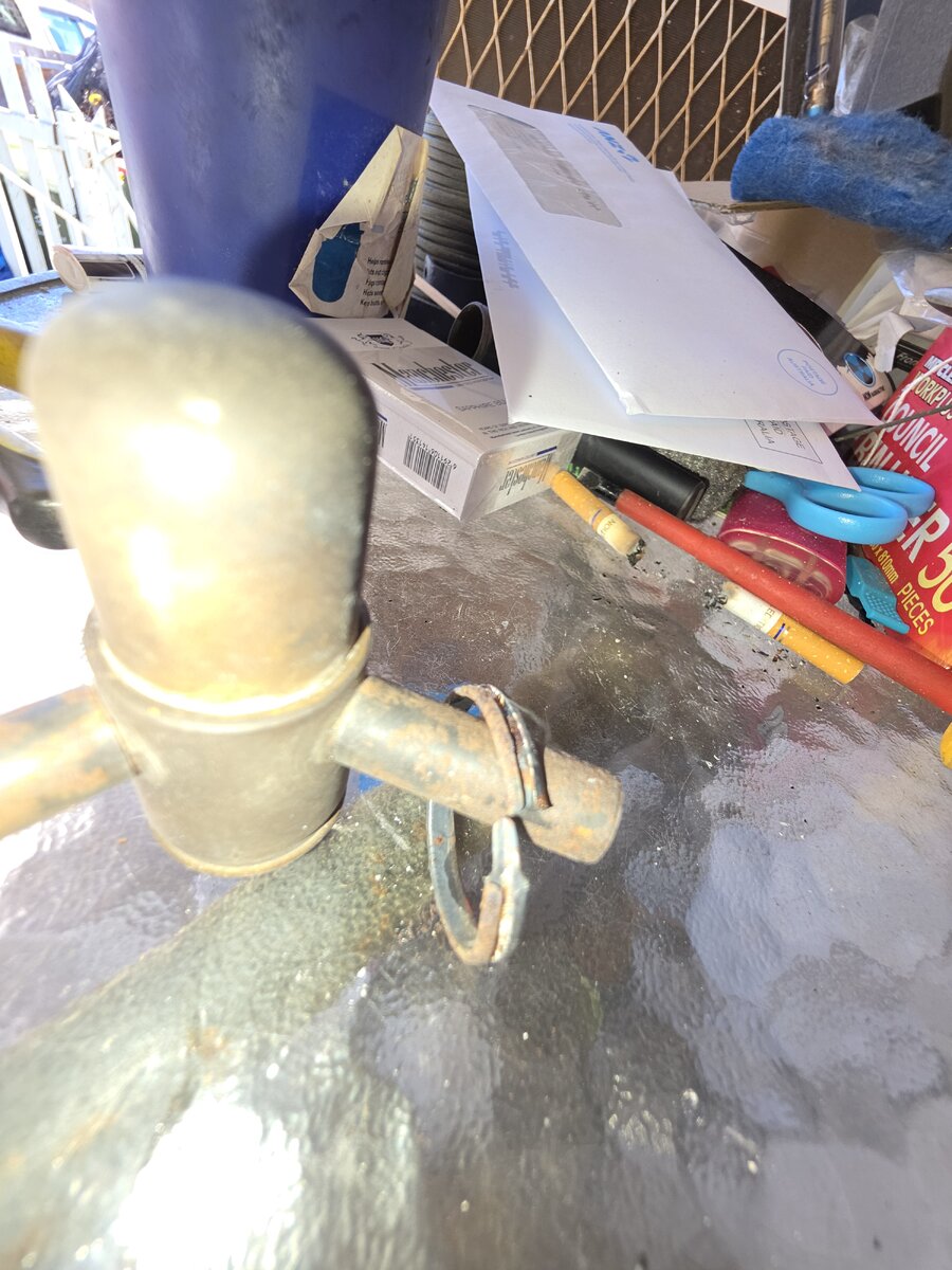

    I was dismantling a tilley lamp and found this part on a burner.
    I have not seen anything like this before, mind you I have not been into tilley lamps for very long.
    I am not sure whether I am supposed to attach the mantle to this part or use it to attach the mantle to the burner.
    Would appreciate any information regarding it.

    Hi Rob
    its the remains of a ‘Happy Mantle’
    or 164 H
    Tilley supplied them alongside the 164 X mantles for quite a few years

    Well I be @%#&ed :)
    Had me all types of confoozeled
    Thanks for the explanation
