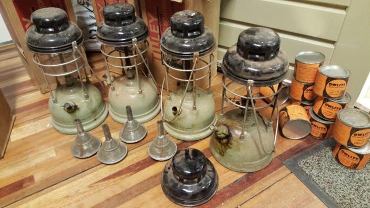

    As to its provenance, Rijkswaterstaat is a huge candidate: see picture from a stash in Zeeland - where RWS was and is intensely present.

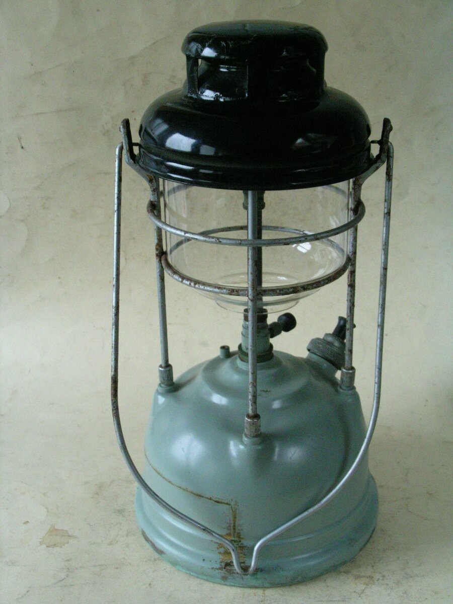

    There were likely more "Guardsman' types than SDR lamps, but many of those X246's were used to the bitter end and vanished, likely for being more practical than the finicky SDR's with irreplacable globes.
    The colour itself has been described as Duck Egg Green but also Duck Egg Blue iirc. A colour used earlier by Tilley for some heater(s), again iirc. Some ornithologist among us to break the balance?
  9. Fireexit1 United Kingdom
    3,538
    "Duck egg blue" paint was widely used in WWII aircraft undersides, by many countries. Maybe it was surplus paint from the 50's ?
