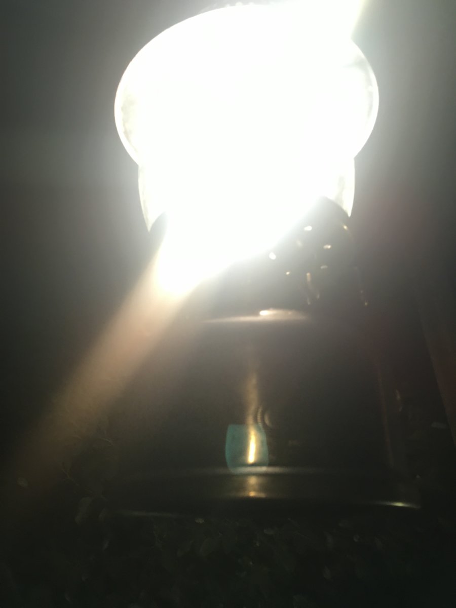

    Newly purchased, all seals renewed, 1960 Guardsman pulsing. Fitting a new vaporiser cures the problem. Decided to clean out the inside of the old vaporiser using a copper wire and carb cleaner. Pictures show what I got out.
    The old vaporiser now provides a steady ring of stable blue triangles. :)
