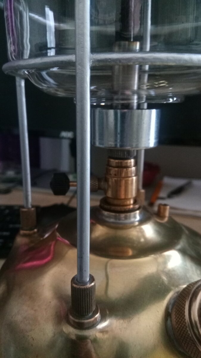

    Well the bit that has the little filter, had dropped off in the bottom so I was trying to get the spring & plunger assembled, then thanks to plantpot put the pictures on I could see there was something not quite right. Got the filter out with some long nose pliers & put that all back which was great that made me feel that bit was right.

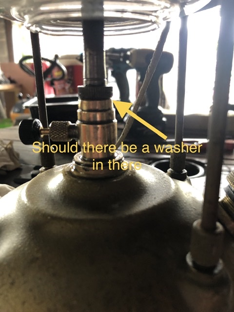

    Slight leak from somewhere about here, I can’t help thinking there should be a washer?

  5. podbros
    4,100
    Yes, there should Definitely be a washer there ( vapouriser washer 153)
    (@Richiep check your messages)

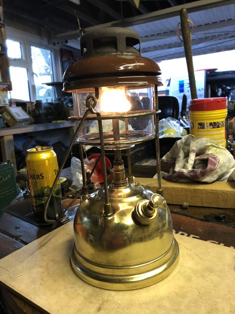

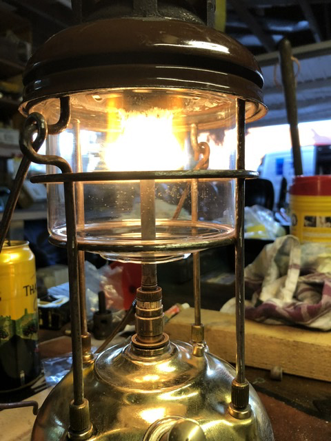

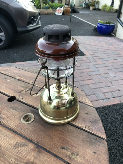

    Well I’ve been polishing like made still a bit to do but she’s coming on,
    I would just like to say BIG thank you to you all for helping me to get this nearly right.

  9. JEFF JOHNSON
    16,882
    That's good news!:thumbup:

  15. Richiep United Kingdom

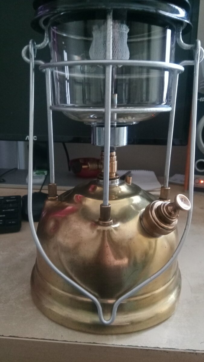

    The spirit cup is from another lamp and not a tilley item. Click on the images for full size.
