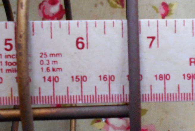

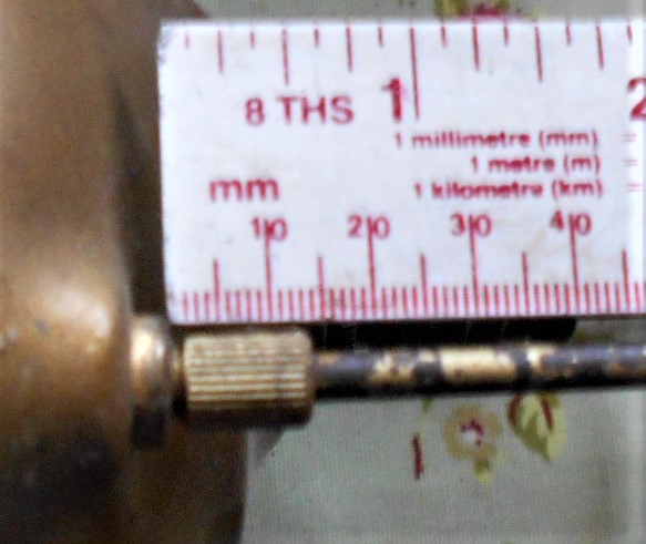

  12. Henry Plews
    3,068
    @malcolm race
    I can't get at a pork pie X246 with that frame but here are images of the frame from a regular Guardsman. Note where I have the end of the ruler in the first image.
  13. Mr cod
    Mr cod Subscriber
    Jan 21, 2018
    547
    Aylsham norfolk
    I've just been out to my shed to measure the cages, guardsman as Henry shows is six and three quarter inches, pork pie cage is seven inches, hope this helps.
    Regards Ian.
  14. malcolm race
    Sep 24, 2018
    277
    Bradford uk
    Thanks again Henry, yes my frame matches those measurements, I reckon it should be at least 1/4” taller. Which Ian has confirmed. I’ve literally just won another on the bay of evil for a very good price, fingers crossed if will be right, I’ll report when it arrives.
