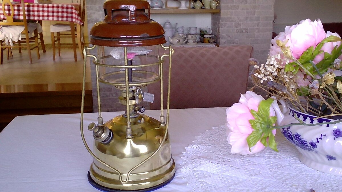

    @David Shouksmith, we talk about the temperature of the bail and the wire cage. These do get hot. The question is what temperature paint is needed for them.
    The hood gets high temperature but we do not talk about this. This is NOT to be painted.

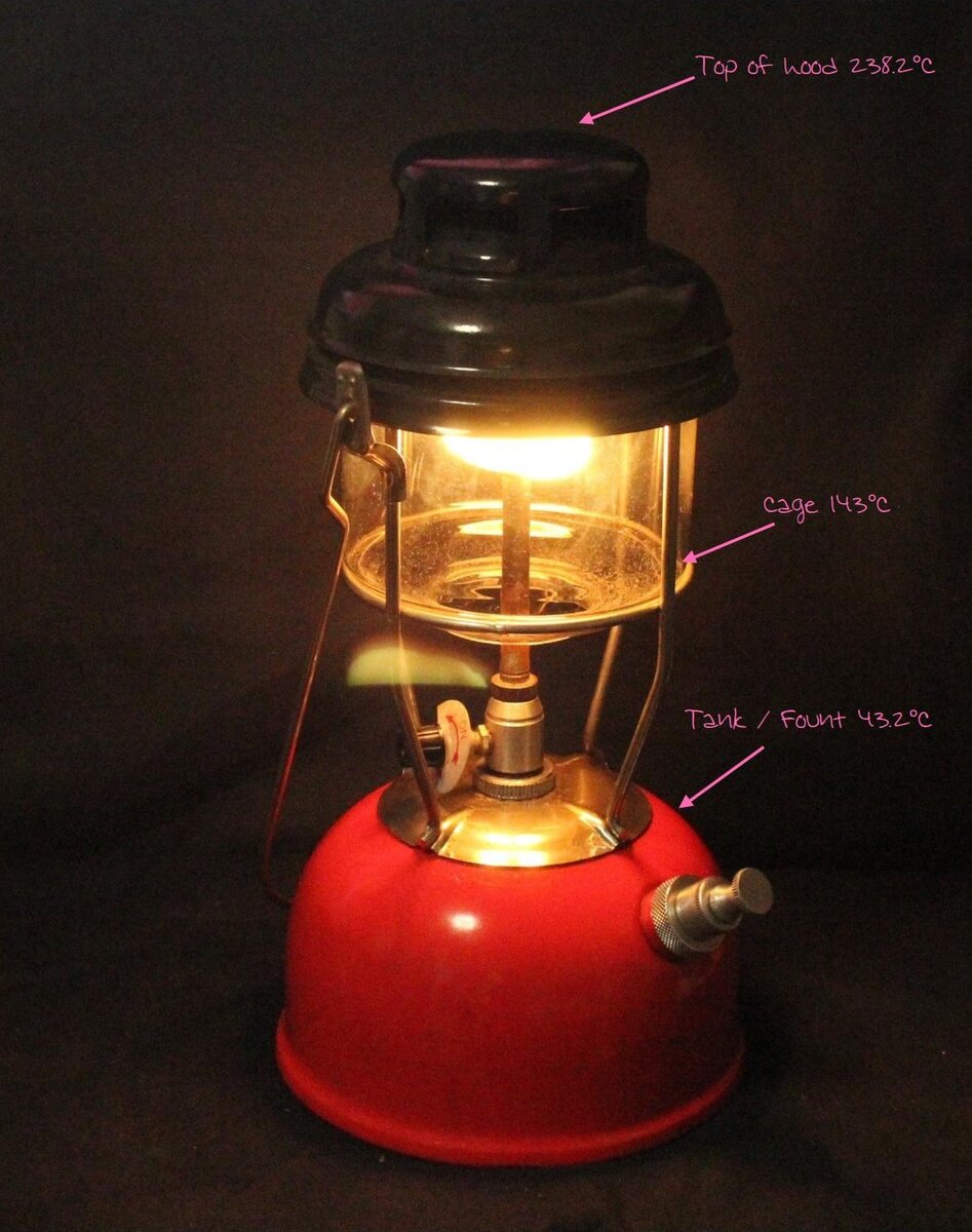

    The results of the test are as follows:
    Tank/Fount 43.2°C
    Cage 143.5°C
    Very top of dome 238.2°C
    So the bail might approach that latter temperature if the lamp was hanging up. :-k

    Oh wow! Thank you! Rechrome what? The cage? The tank is brass, the hood enameled in good condition and the cage and bail had some golden paint which was damaged by the years of use (is that chrome?).

    Yes, just the cage, once you get it off and the bail, I've attached a picture of where I took the temperature readings. :thumbup:
    Those individual legs will just screw out, you might need to use a penetrating oil to loosen them off first.:-k

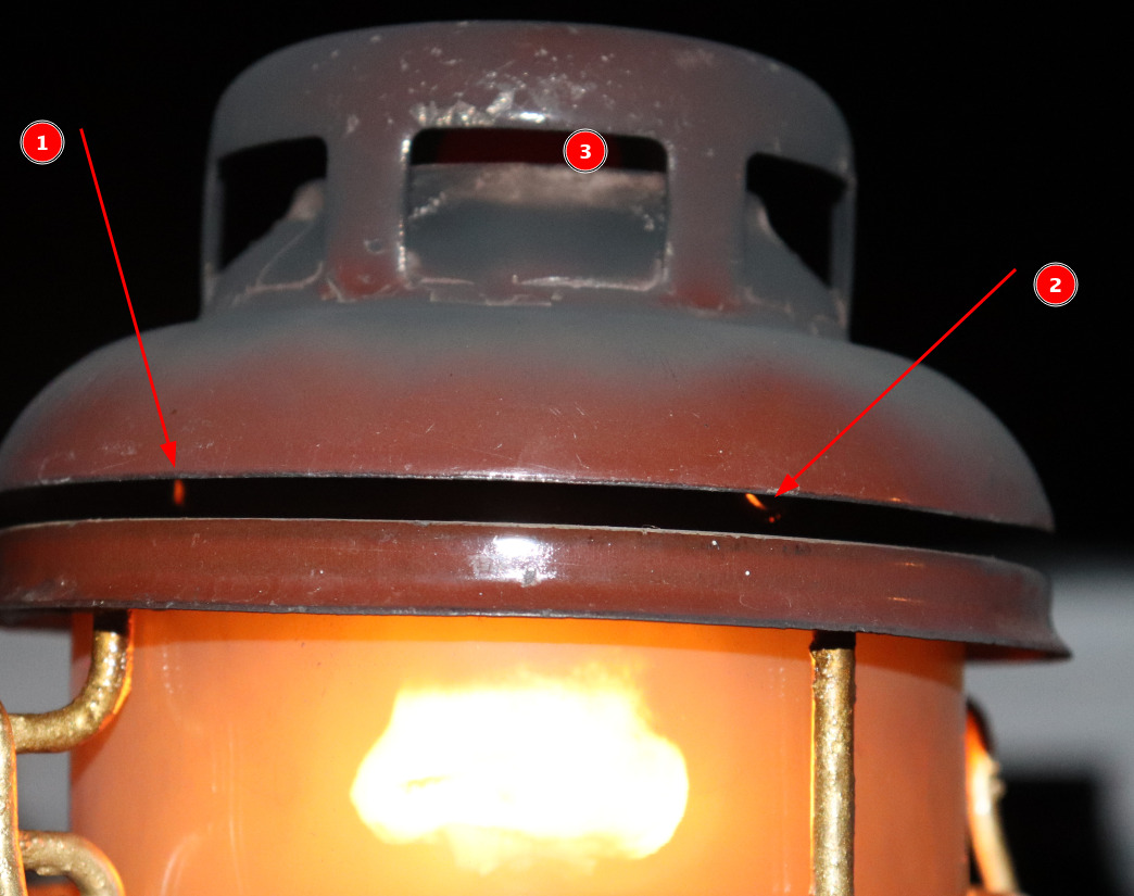

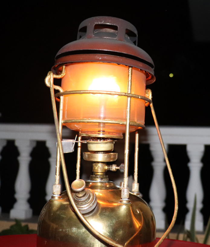

    It seems that preheating did not go well. OK, this can happen. After some shoot it stabilized. But what I can see (it is not visible in the pictures)
    (a) the flame is not contained in the mantle. How can this be possible? There are flames around the mantle going up to the hood.
    (b) flames can be seen at positions (1) and (2) (visible in the picture above) but also in position (3)
    (c) the mantle emits orange light and not bright white. Some smoke is also visible above the lantern. Which tells me that there is not enough oxygen supply. But the air tubes are new from base-camp as well as the top cup above the burner (I do not remember how it is called). The burner is old but it was cleaned.
    More problems appeared. The paint of the cage it seems to have melted at some points and now the glass is stuck. It was supposed to withstand 300 Celsius. How great.... I have to find a way to remove the glass without breaking it.

  21. Tony Press
    11,045
    Flame outside the mantle is usually the result of the jet in the vapouriser being too large (worn out).
    The other thing you should check is that all parts of the burner are tight with no distortion.
  22. Antonis Tsolomitis Greece
    Sep 16, 2019
    180
    Samos, Greece
    This could be possible since the lantern is old. But do tilleys have a separate jet like the petromax? It seems that it is one piece with the carburetor. What part do I need to replace?
  23. Antonis Tsolomitis Greece
    Sep 16, 2019
    180
    Samos, Greece
    It should be vaporizer part 606 and cleaning wire 607. But before I order this part, could it be something else? I just do not want to keep ordering piece by piece.... It makes sense though... if the jet is wider, more kero reaches the burner and the supplied oxygen from the air-tubes is not enough.
  24. podbros
    4,025
    Hi @Antonis Tsolomitis
    your lamp is coming along well but I have never heard of the paint melting or sticking to the glass like that?
    I think i would be contacting the seller?
    Tony has made an important point about making sure the threads of the air tubes and the burner dome are sealed?
    It may well be that the vapouriser has reached the end of its life as well.. (they were made as a disposable item but the early ones lasted a long time)
    I would double check the burner first before sending off for a vapouriser
    good luck
    pb

  26. Antonis Tsolomitis Greece
    Sep 16, 2019
    180
    Samos, Greece
