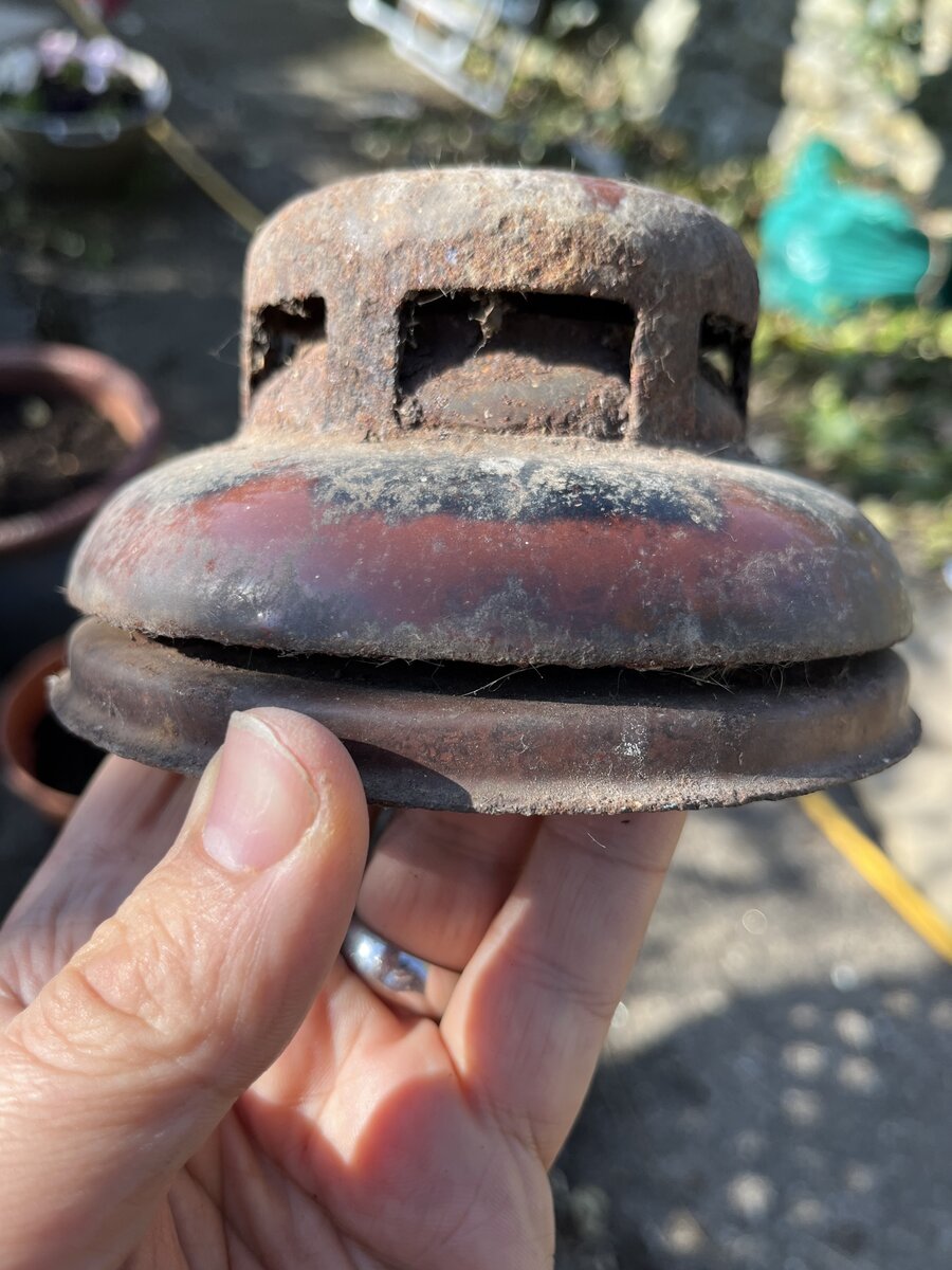

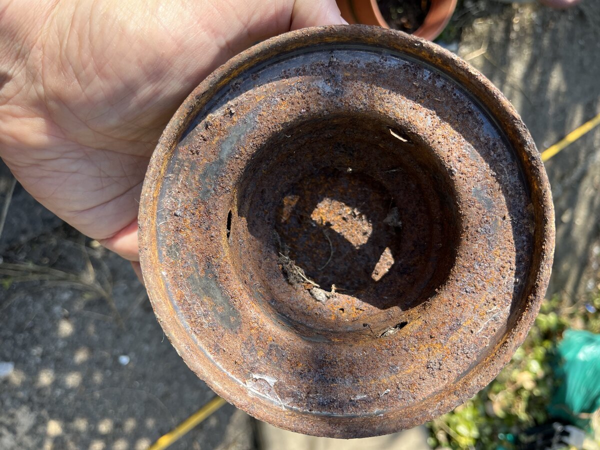

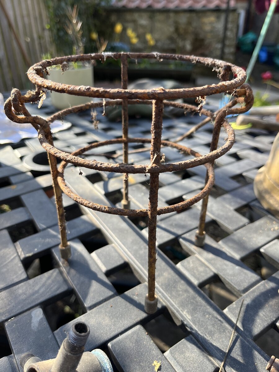

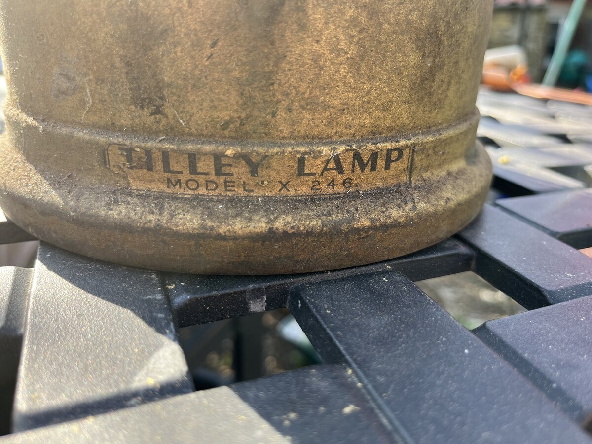

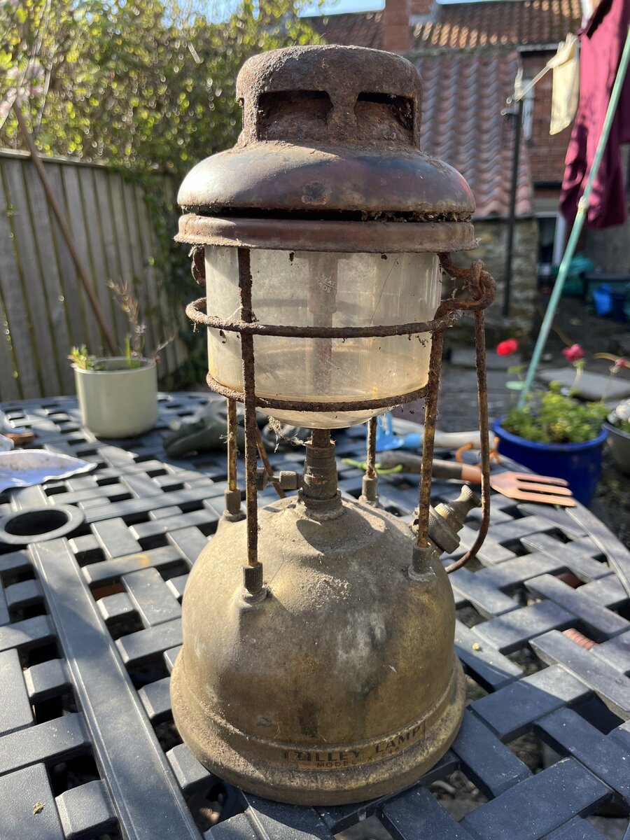

    Alas… they keep multiplying. On a trip to Bridgnorth yesterday I discovered this sad specimen… but I’m glad I did as it’s not one I’ve already got.
    It seems to be a pre-owl x246 - so pre 1954 if I’ve read things correctly? The bad bits are the rusted cage and hood (which does seem structurally OK - just a bit rusted) but the good bits are that everything else seems grubby but in good nick. It was all pretty much finger tight - even the burner nuts! - and doesn’t look to have actually had much use at all. Fingers crossed it might actually restore nicely.
    The paint work looks nice under the muck incidentally - I won’t be stripping this down but trying to restore as much as possible. I don’t want to lose any original features like that lovely decal.

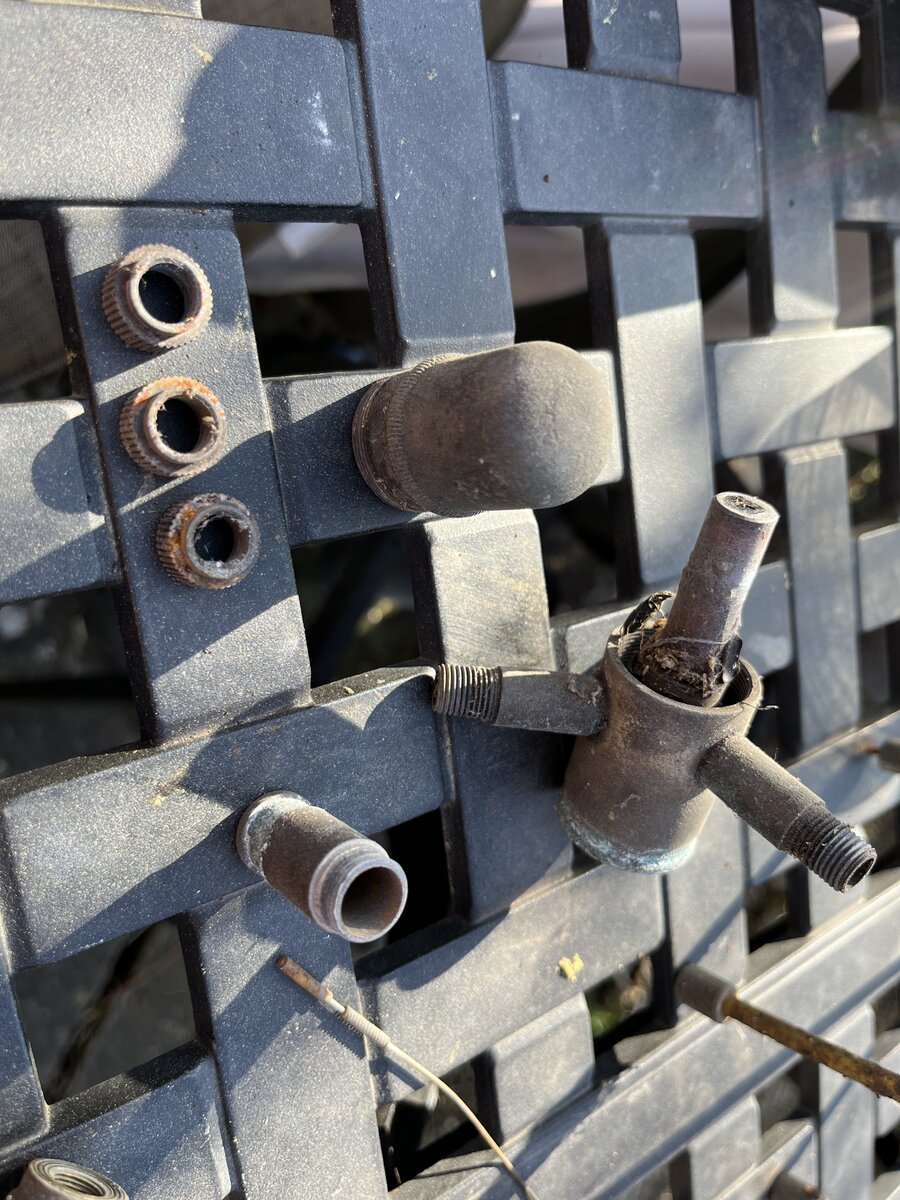

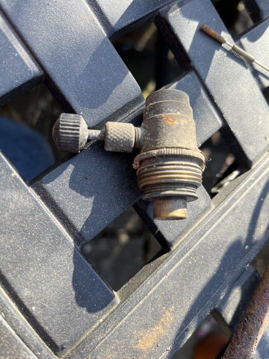

  3. Henry Plews
    3,050
    A nice find and I agree that in spite of the condition of the hood, the lantern hasn't had much use. I like the image of the disassmbled burner, it shows that small spiders can and do get in and make their home there.
    Tony Press Ukraine Subscriber
    11,036
    @Automedon
    You’re correct about the time period for this lantern. And it’s a good thing that the burner is little used, as well used burners can be problematic if taken apart, because the threads are often damaged by the heat.
    When you reassemble the burner make sure the threads are clean and use either copper grease or nickel grease on the threads when re-assembling. You might get some smoke on first light up, but the threads will seal well.

    It’s a veritable menagerie in there… much cleaning to be done! I can only think this lamp has been a very very long time in store. Also interestingly there was no trace of a mantle…

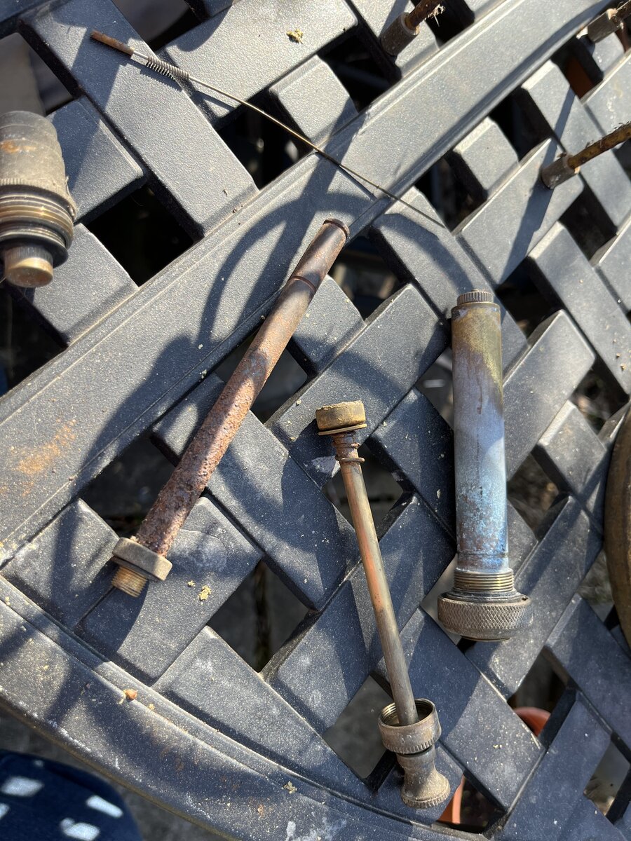

    On a different tack … what’s the best thing to do if the tip of the pricker needle has broken off in the tip of the vaporiser? A Quick Look earlier suggests this may have happened. Quenching?

    On the pricker… if it’s broken, you need a new one.

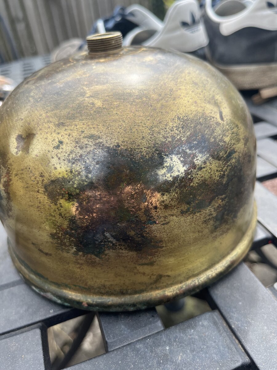

    IMG_3185.jpeg Work progresses anon … two X246a’s and a ‘b’ have come back to life but a quick question when it comes to brass … stripping down my April 1973 x246b the tank had thrown up a LOT of black corrosion stains underneath. Having removed the blue (copper) powdery coating on top, I’m left with apparently immovable black patches everywhere. See pic… is there a simple and foolproof method to get rid of such things?
    Also - and on a slightly different topic - I have a LOT of single tie mantles lurking around. I’d like to use these on a Tilley or three - I think I’ve grasped the basic way to convert them to Tilley use but just to confirm - you cut below the stitching when the sealed end is pulled through the open hole? It’s not a case of unpicking the stitching? I’ve already managed to ruin one mantle - I don’t intend to knacker another!

    The blue/green powder was probably verdigris .. it is corrosion of the brass and looks like it has pitted the surface so could be a candidate for a paint job ; polishing the pitting out could take a while and would take strength from the tank
    Must be possible to neutralise it before painting?
    Coin & button collectors recommend lemon juice so try citric acid spot testing then wash off?
