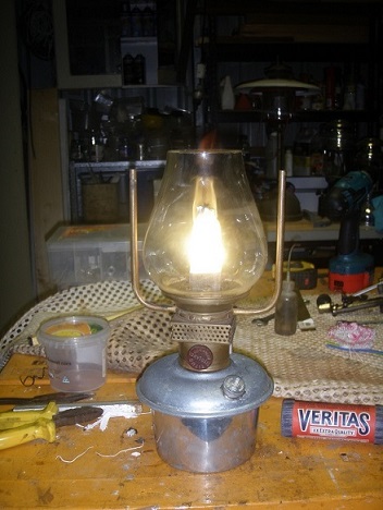

  1. David Shouksmith
    See my reply in the thread you started.
    The glass is important because, amongst other things, it retains heat around the top of the burner and keeps out cool draughts. That's essential to maintain vapourisation. I'd imagine it also promotes the correct air-flow i.e. ventilation, to provide oxygen for combustion.

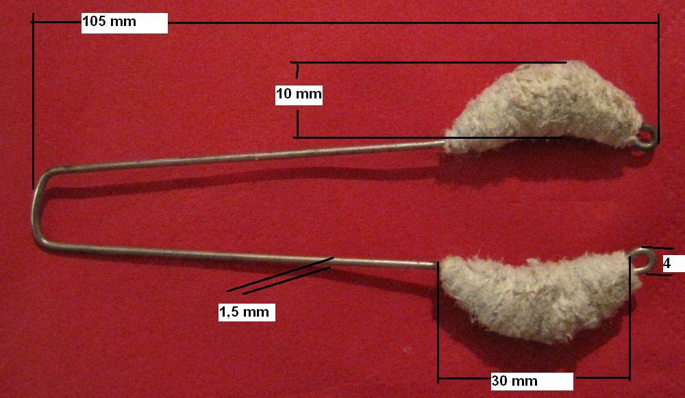

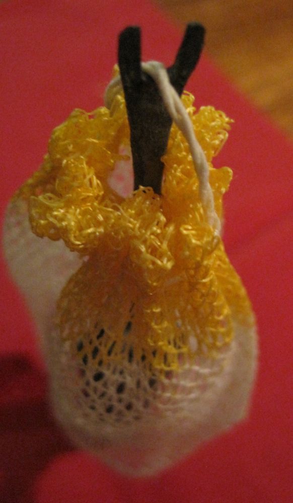

  3. tillio
    Mar 24, 2011
    25
    Nice lamp. Torsten was a great help when I purchased my Titus. He provided me with pictures of how he made mantles for the lamp using coleman mantles. Also how to make the preheater torch. Have attached a couple of the pictures. Initially I used a nail with the end hammered out into a fork to hang the mantle on. Eventually I found by using an old veritas hard mantle I could get a pretty good light. With mine I have yet to find or build the hood and handle etc. Glass wise it has a straight glass inner and a globe outer.
