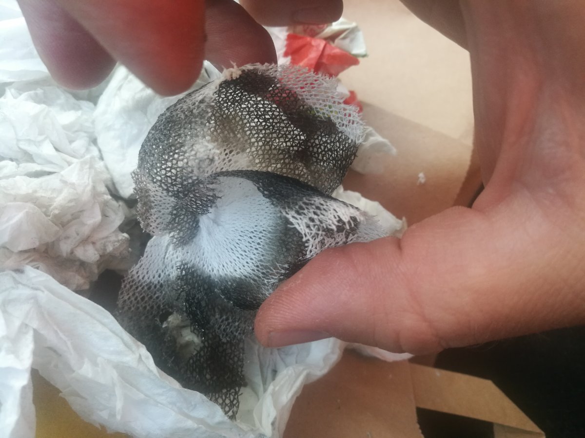

    That I would like to have seen.
    Double tie yes, double layer never seen that before.

    I could only get a bad photo of the ashes, but here you can see two layers that have been ontop of each other.. it felt really thick to hand when tying it on too.
  3. MYN
    Never heard of double-layered mantles as the norm.
    I've made my own before(one mantle inside another) but they don't light up well anyway.

  5. Heering80 Finland
    May 23, 2020
    17
    Espoo, Finland
    Nope, that might be mcdonald's bag in the back I've never had any tilley stuff. The red paper in the picture might be mantle package though, and if I remember correctly, it was Luxor. The mantle didn't have a hole in the lower end. It was sewn shut from the bottom.
