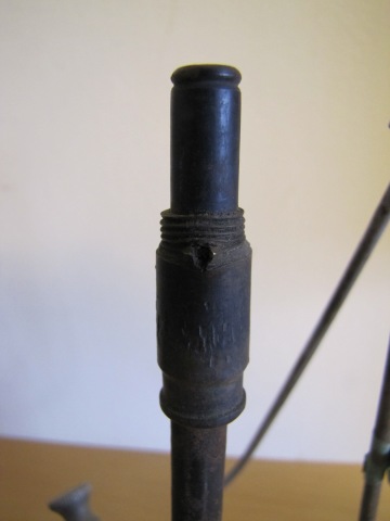

    here is another example what can happen with bad kero
    this is a vap on a X410A

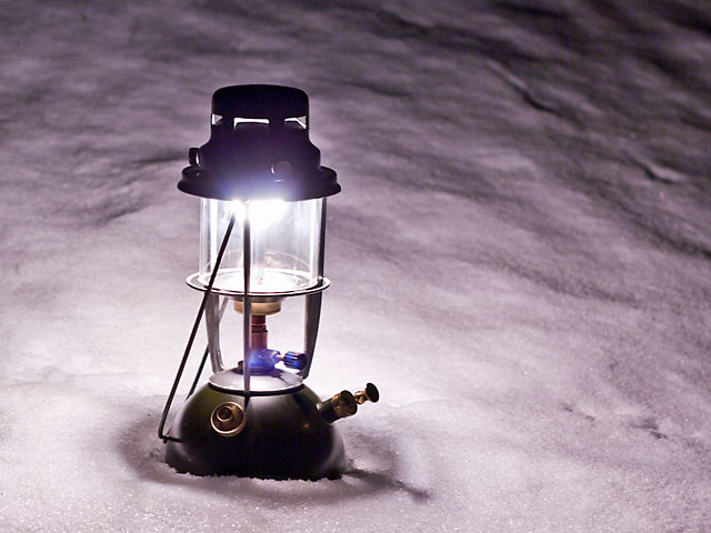

    Well, all this talk about the 320 lately got me to dig this bastard out again yesterday.
    As I said, it never worked as it should when I got it, unused as it was.
    But I gave it a new shot and dismantled everything, gave it a sweep and put it together again thoroughly.
    It had a leak in the tank lid gasket, so I had to replace that one. But after that... Well, wouldn't you know... It worked pretty well!
    I'm glad it did, because the lantern itself gives a pretty solid and robust feeling to it. It's the kind that tells you to use it, and don't be afraid to do it under any conditions whatsoever. :lol:
    The light output isn't too impressive, though, even if it isn't bad. I guess the main issue here was the sturdiness.
    I had it running for three hours yesterday without any special attendance.
    Here's an image:
  14. JEFF JOHNSON
    16,890
    Hello Christer, it looks good in the snow, very atmospheric! Jeff.

    Coming back to this old topic... Just experienced (again) swollen vaporiser and spigot in my Bialaddin 300X lantern. Above in the dialogue it was proposed that the used fuel (kerosene) wasn't proper one as a root cause.
    Still wondering about the root cause. I have two other Bialaddins, running on same fuel, but it is the second time with the same lamp I'm having the problem thus I think the problem is more on the fuel and air mix causing the overheating rather than the fuel itself, I believe. Maybe too much air vs fuel causing the overheat? This was visible as I was running two 300X lanterns side by side: When I shut down the lanterns, the one having the problem had spigot glowing really bright red, and the other one not. How to control the air mixture in Bialaddin/Vapalux lanterns? Should I change the burner as well?
    -tommi
  28. JonD
    JonD Subscriber
    Apr 15, 2014
    1,012
    Hertfordshire, England
    Hello Tommi, I have an X246B which keeps doing this too. I have also read the idea that the fuel is to blame but I find that theory hard to believe.
    If the fuel is cracking inside the vapouriser, depositing carbon, it will surely block itself long before the walls of the tube bulge and swell.
    I think this is exactly as you wrote - running too hot. The metal softens and that is when swelling happens. But why does it run too hot?
    Yes mixture can have something to do with it, but is it really enough for that?
    I have come to think it's about heat transfer away from the top of the vapouriser and spigot. There isn't anywhere much for it to go except up to the main body of the burner. The amount going down the vapouriser tube by conduction will be small I reckon. So I have come to think that it matters the vapouriser has good contact with the spigot and that the spigot has good contact with the main burner body. That is what takes the heat away and prevents red hot running.
    I know my X246B is not all perfect in that area and I think that is why it swells vapourisers. One day I will but a new burner, spigot and vapouriser in it but to be honest it has had all the money I am willing to spend thrown at it. It isn't worth following that with more. One day I will find a basket case with a decent burner and only then will it get the vapouriser I am unwilling to fit knowing it will in all probability follow the others.
    Next time I will be running in for short periods and checking for red hot running. Best of luck.
