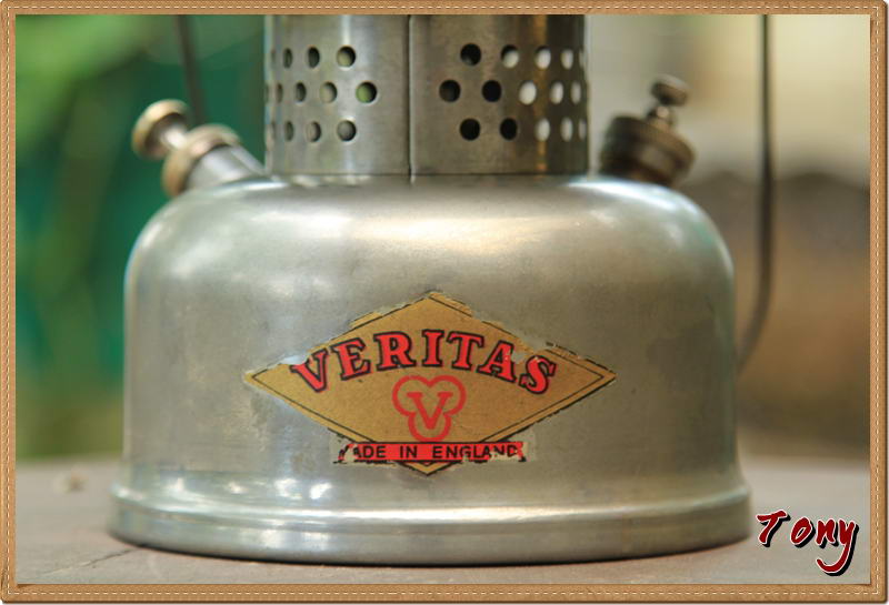

    This is the generic Veritas 350 waterslide. (P.S. Image courtesy of Tony.)

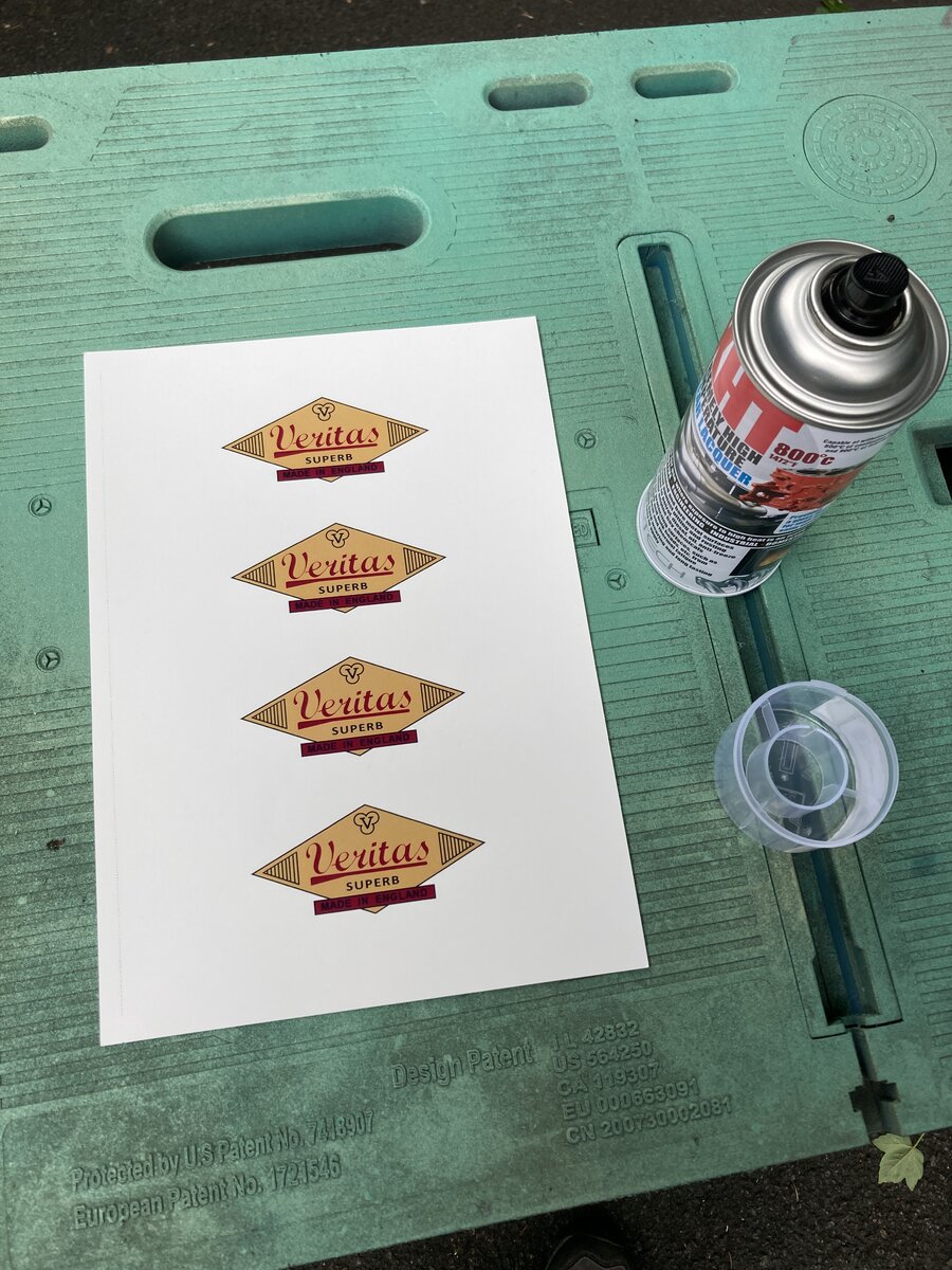

    Next step complete, I now have a decent quality print on waterslide inkjet paper. (Still debating lightening the red on the “Made in England” banner but I can amend that easily enough for the next print run).
    Sealed with 3 thin coats of lacquer. Once that has dried, it’s application time, test fount first though I reckon!

    Not a great first test applying it. The colours ran and it was impossible to get the slide off the backing. Need to try the specified sealer as I just used some spray lacquer I had. I may just cheat now I have the artwork though and find a professional printer.

    Would an option be to apply the waterslide straight from the printer and then lacquer over the top when it's dry?

    I have made waterslide decals in the past, and I think that lacquer should've worked for you. Perhaps you trimmed the decal too close to the ink? I usually need to leave at least 0.75mm or so around the ink, sometimes more.
    Also, try a tiny drop of dishsoap in the water to help the backing release.

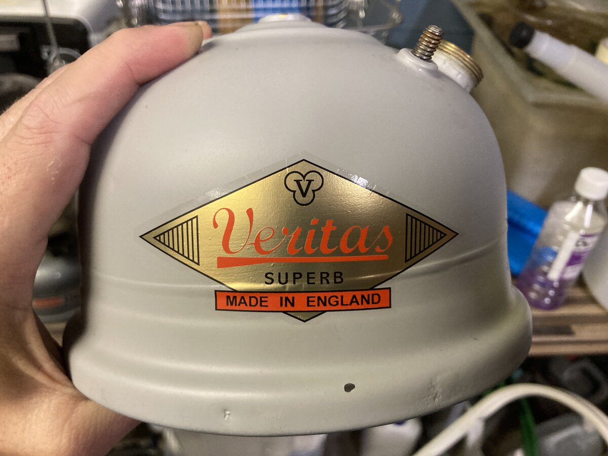

    I had planned on waiting until after I’d clear coated and rebuilt the lantern to share, but I’m just a bit too excited! This was the first attempt at applying the slide, the colours held fast and it was strong enough to be repositioned. Assuming it now dries ok and accepts the clear coat then, I may have cracked it! Hopefully!!
  23. george
    Nice job!!:D/
  24. Scott D
    Aug 10, 2020
    756
    Yorkshire, UK
    Anyone any thoughts on the likely impact of clear coating over the decal? I would be using an XHT clear lacquer as usual ideally, but the info sheet that came with the decal advised brush on film rather than spray on. So I’m now thinking a coat of brush on film over the decal, let it dry then spray my usual clear coat to finish the whole of the fount. It would be a shame to mess it up now!

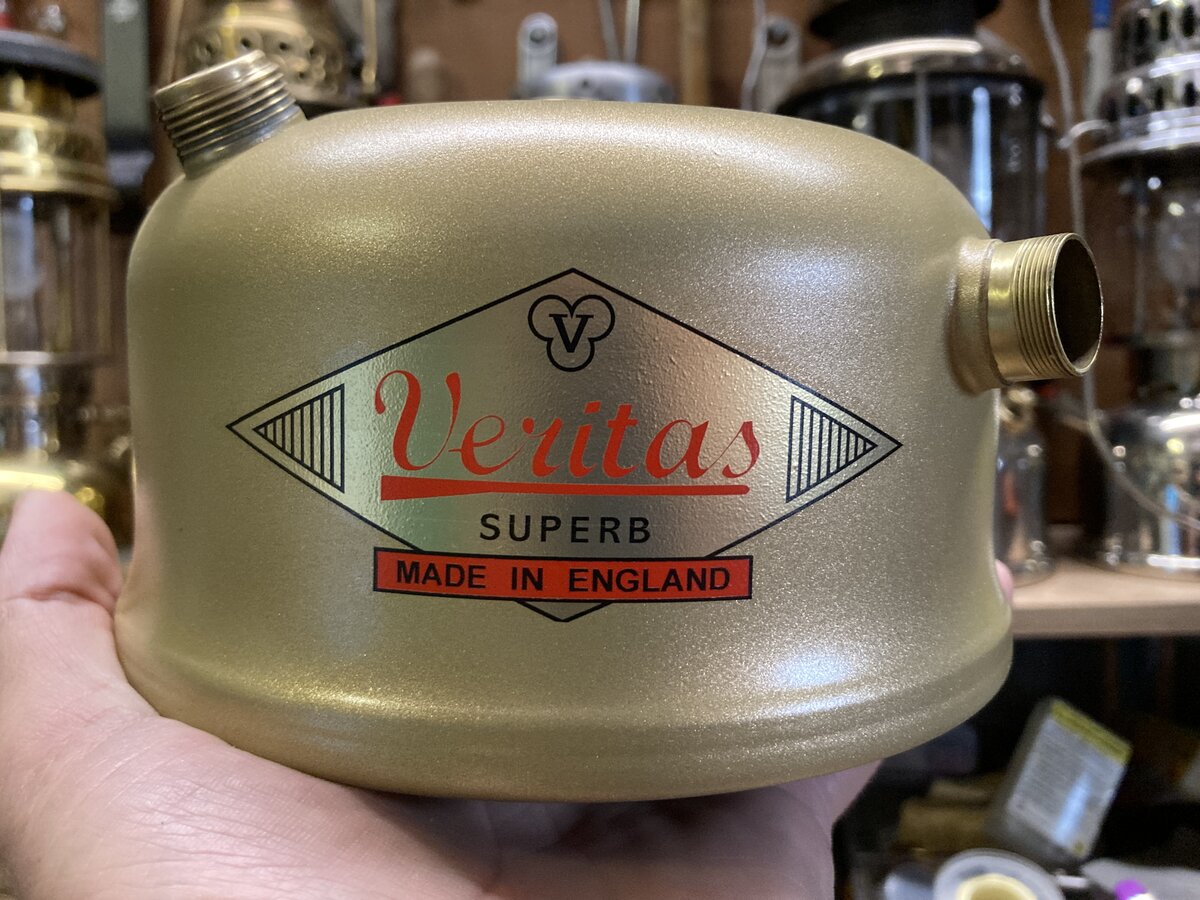

    09731A77-C4FF-4599-B586-093CDA95D1AC.jpeg 68A31E5F-9CF1-49F0-8BD2-8CA2C7AE3545.jpeg
  27. ColinG United Kingdom
    4,816
    There's something extremely weird and disconcerting about seeing a Veritas label on a Tilley tank!
    Also, who's gold paint did you use?
  28. Scott D
    Aug 10, 2020
    756
    Yorkshire, UK
    It is a bit odd, but that fount will hopefully be reused as intended one day. It has a pinhole so I replaced it with a brass donor to get my PL53 up and running again.
    The gold paint was a Rustoleum. Not one I’ve used before but I wanted a metallic finish to replicate the original. It went on really well!
