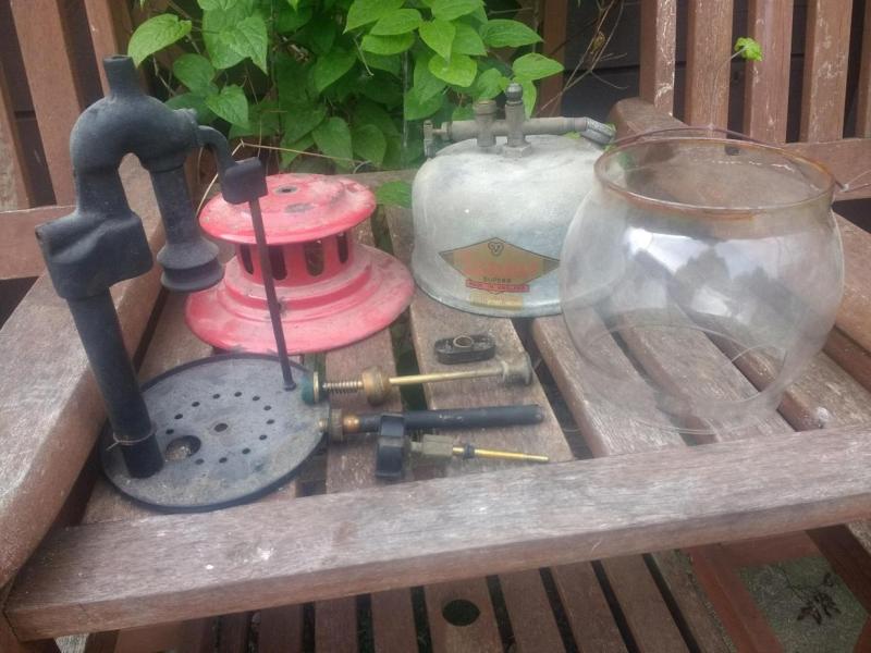

    Well, I did find one I could get to without too much difficulty:-
    From the top down, it has a missing handle, a missing stud and ball-nut, a globe with a home-made lighting hole where the glass is less than a millimetre thick, a missing pricker wire, a replacement pump-rod with a home-made pump-washer lubricated with some blue-green goo which has dried up and hardened, a shredded control-cock seal and a tank with all sorts of sediment inside. The fuel cap washer is borderline serviceable, though, which is a plus point. So, all-in-all, probably not the world's finest example...
    What really stopped the job, though, was a phone-call from Sainsbury's telling me the delivery van bringing me essential supplies had been involved in an RTC so wouldn't be coming. Unfortunately, that meant the metal polish I'd ordered last night wouldn't be delivered and obviously without that there was no point continuing with the fettle. I'm sure you'll understand. :whistle:
    I think I may need to find a better example tomorrow... ](*,)

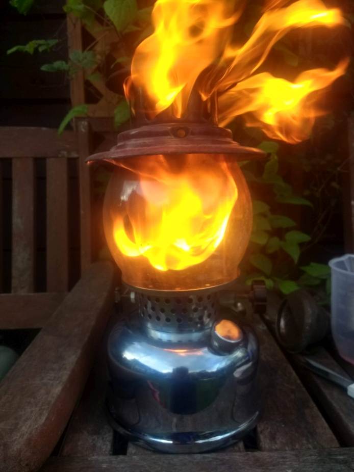

    Well, I fitted an Anchor No.4 mantle and decided to use the old hood and the globe with a lighting hole. I burned off the mantle with the first prime then primed it twice more just to be on the safe side. I didn't have any panel-wipe to add to the kero to increase its volatility. Just as well, really:-
    Slightly over-fuelling - this has got to be a Friday afternoon / Monday morning lantern! :rage:
    It's possible to throttle it back with the pricker wire to the point it's not quite so likely to set the fence on fire so I suppose there's something wrong with the jet or vapouriser - despite them being virtually brand new. I found another new vapouriser for it this afternoon so I might have to give that a go in the morning.

  14. ColinG United Kingdom
    4,808
    OK.... I've calmed down a bit now, had a cuppa, walked around the garden and prayed to the lantern God's.
    Do you think the jet may be just a teensy bit worn? In fact, has it actually got a jet at all or is it dumping kero into the burner like a fire-hose?
  15. AussiePete
    @David Shouksmith
    Bloody hell mate, there is something basically wrong here. :shock:
    Initially my first thought is it looks like it’s not had a preheat and pumping a full stream of kerosene straight into the mantle.
    My second thought is either the jet is way too large and absolutely buggered or that the jet is loose in its thread, or the thread or the jet’s seating is buggered, allowing fuel to bypass the jet.
    Simply a process of elimination, but of course you know all this.

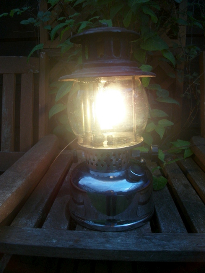

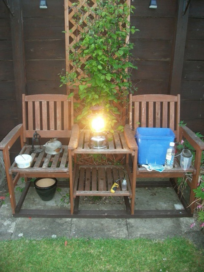

  20. David Shouksmith
    OK, once it had cooled down I checked the jet which did seem rather large especially when compared with a new one I found this afternoon. I'd been saving that NOS vapouriser for a rainy day so I suppose that was today. I put it all back together managing to save the mantle and triple primed it again. Et voila!
    It's been running nicely (and getting brighter as the mantle burns in) for an hour now which beats my previous record by 20 minutes - and counting!
    The Veritas Superb - a lovely lantern - sadly under-rated by some... ;) :lol: :thumbup:
    Still burning brightly - time for a couple of tinnies to celebrate success! :D/
