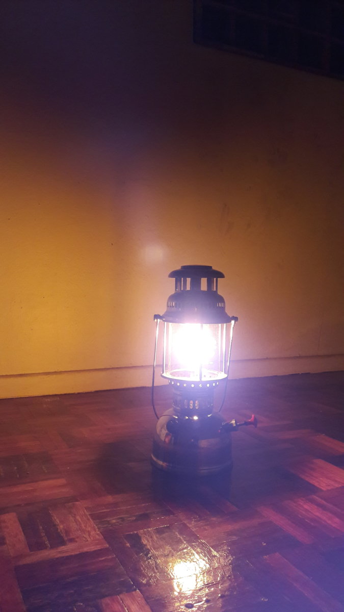

    Alex, if you use clay, lime or any other refractory powder, keep the amount as small as possible. Just a slight but uniformly distributed addition would perform. Just the slightest smear possible. If its heavy, the light would dim too much.
    I've replaced the earlier mantle with a different composition: predominatly lime and a very small percentage of chromic oxide. Its now slightly brighter with a golden yellow hue. Now its the only pressure lamp I've known to produce such a strongly yellow light. My phone camera couldn't capture the real colour but the white wall background was rendered completely yellow:

    just saw your replies and the latest photo. that looks fabulous. If the effect is permanent on the mantle then I’d say that you have succeeded in the quest for a warmer light, so it was well me starting this thread, as I don’t think the topic was ever discussed on here. I haven’t had time to buy powder oxides to experiment with yet, because of work and other commitments. This blooming virus isn't helping either! But I’ll certainly look into it and post a few photos soon. In the meantime, if you manage to improve the light output further, then let us know how you did it!

    Yes, I've managed to refine it a little. The key is, you'd need to incorporate the bare minimum of additional oxides into the existing mantle to give the best outcome.
    The oxides need to be in the finest form available(fine enough to stain anything its rubbed on, just like the way soot does).
    In my case, I've used kerosene as a wetting medium for chromic oxide. Any excess oxides must be removed as much as possible and once the kero dries up, the mantle's ready and should be uniformly stained a pale green or any other colour of the oxides used. This is to ensure it doesn't mask out the light by creating dark spots when the mantle's glowing.
    I've tried it on a thoriated mantle(which if untreated, would glow a greenish white).
    Now it glows clearly a bright yellow, which is very similar to that produced by the low pressure sodium lamps. I'd say that no manufacturer would deliberately produce mantles which emit this sort of strong yellow.
