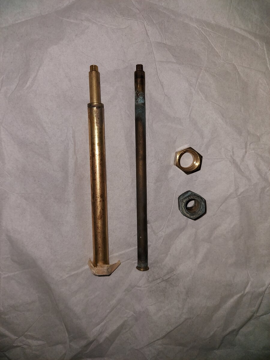

    On the whole 236/7 gen switch they are not compatible. Because I got both 236 237 gens comparison pics here. Although it would seem if you're able to run a 220 and 200 on kerosene a 236 with a preheater would be no different. Same dia but longer.
