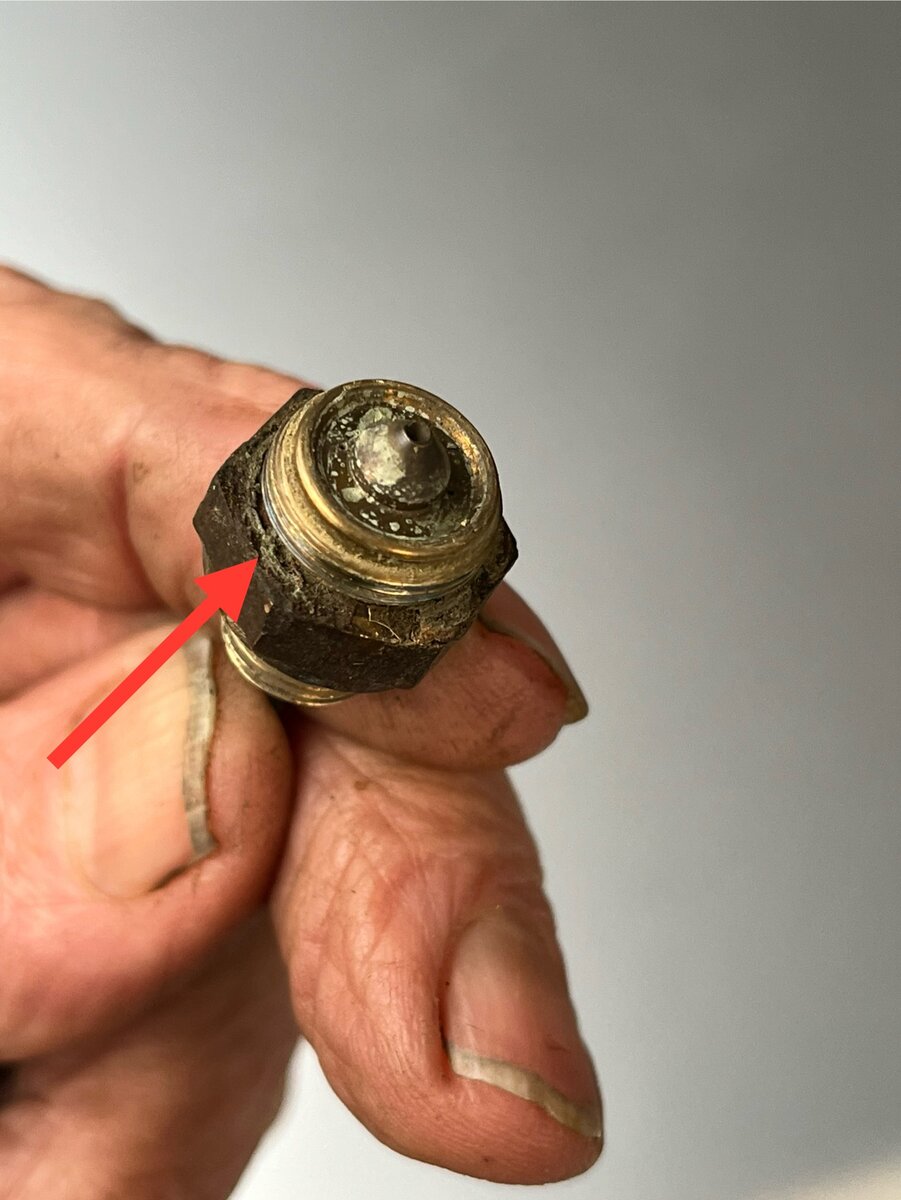

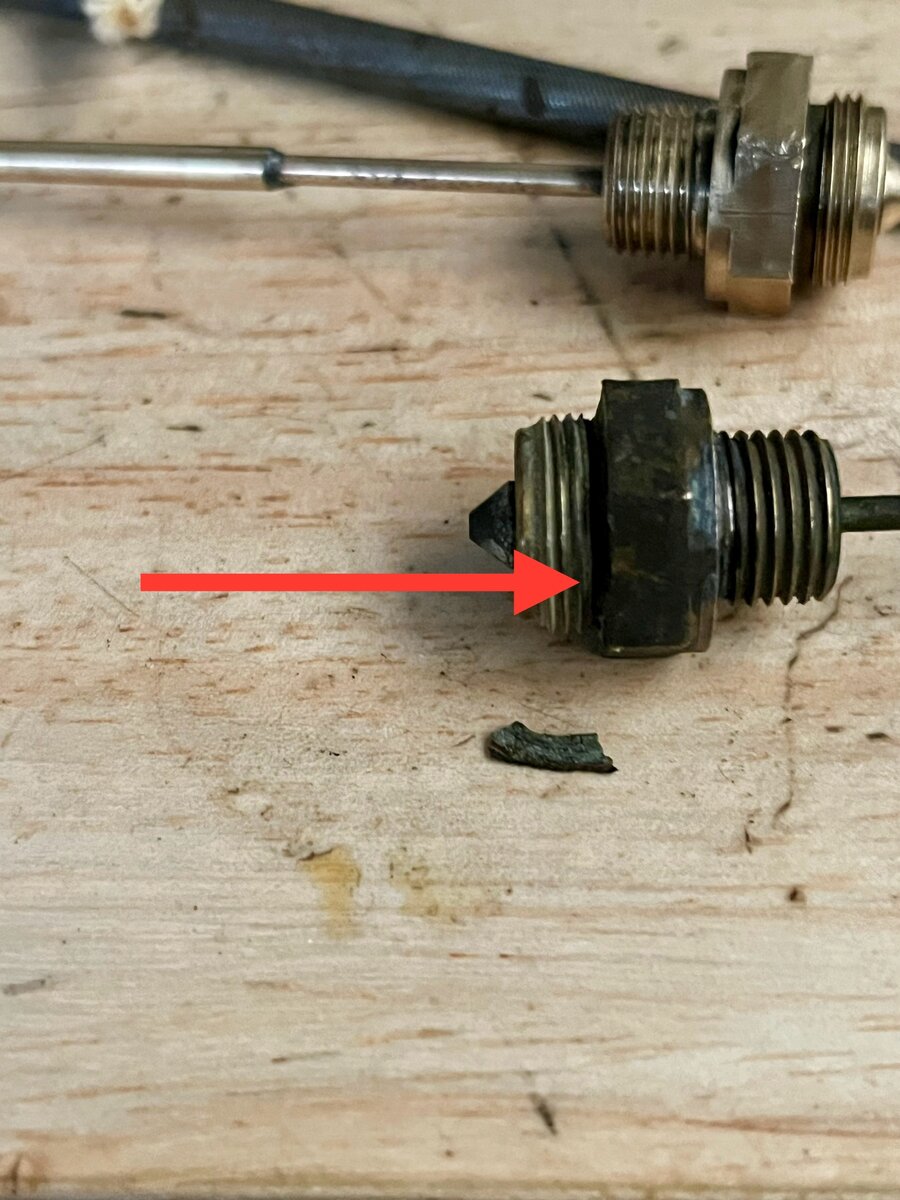

  8. Tony Press
    11,105
    @presscall, @Martin K. , @Dashwood, @MYN @Reinhard
    Apropos of our earlier conversation about the gap between the two lower hex components of the “drehrapid” (parts #14 and #15), I discovered a 1mm thick paper or fibre washer at this join very on my Petromax 882:
    Interesting…
  9. presscall
    1,792
    Lancashire, UK
    Interesting indeed Tony.
    John
  10. MYN
    Now that is interesting. Is it supposed to be present at that position?
  11. WimVe
    3,547
    No, never seen that.
  12. Martin K.
    Martin K. Subscriber
    Sep 20, 2013
    1,148
    I've never seen that too. Maybe a solution to overcome problems with leaking when the metal rim inside is not sealing properly any more.
  13. WimVe
    3,547
    I would first remove the feed tube carefully,
    then polish the rim of the tank part with steel wool and depending on damage lay a fine line of soft solder on top. Smooth that out with fine sandpaper. I don't think the part would get that hot that the solder would melt but if then use hard solder. With the upper part as a counter part you can see marks on the solder and smooth it out. At a certain point you will have a perfect seal again.
    I learned that metal seals start to wear on each other so that you can't change parts.

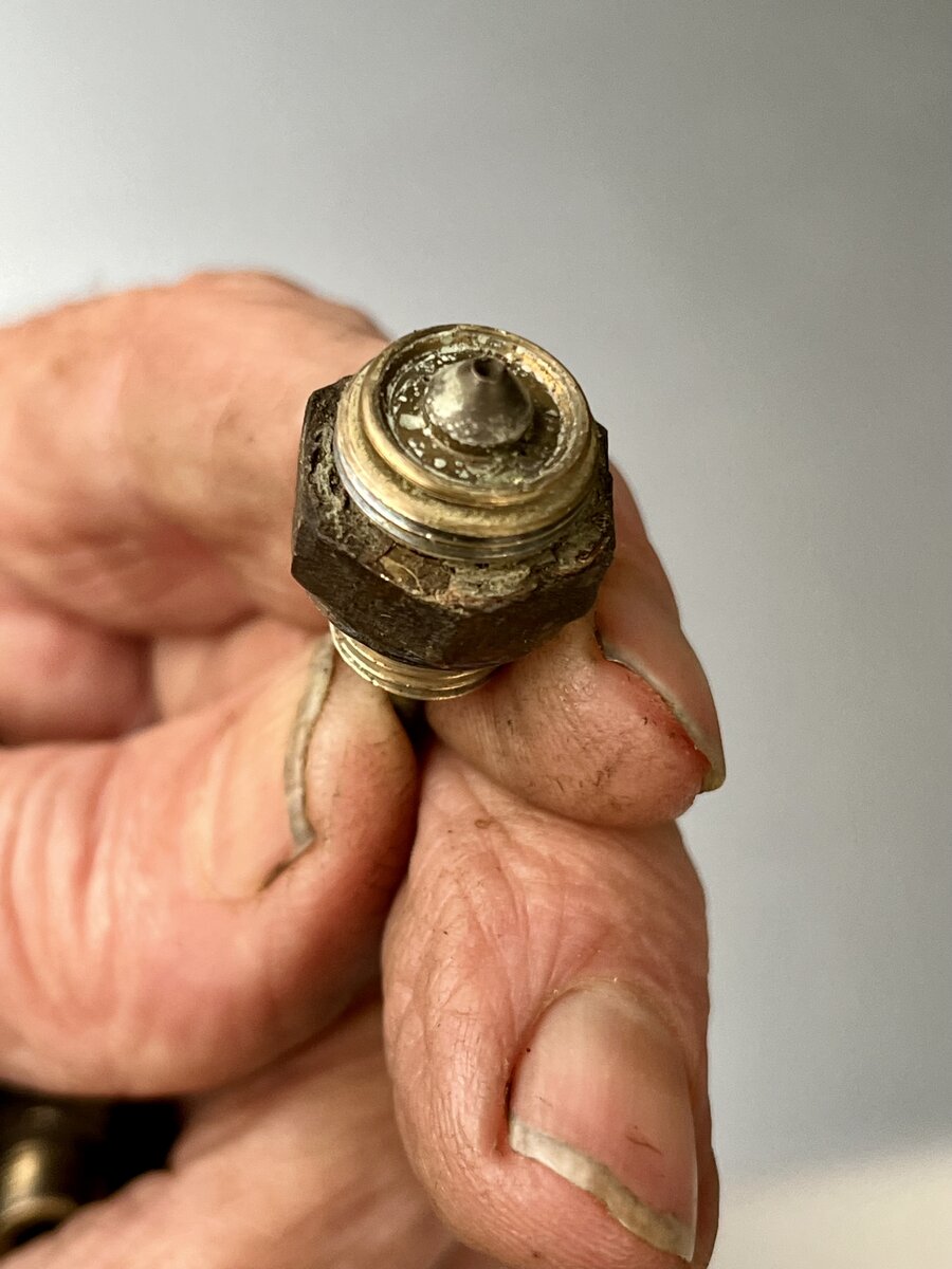

  14. Tony Press
    11,105
    Re-reading my last night’s post, I thought I should make it a bit clearer where the washer was found:
  15. Martin K.
    Sep 20, 2013
    1,148
    I think I have understood your description correctly. The point where the gasket was inserted is where an air leak can/could be repaired, even if the contact surface of the actual gasket (brass) is damaged.
    I have also tried the same thing with some PTFE tape in the thread, but the success was not so good. In the end, only replacing the defective lower part of the preheater helped.
    Please mind that even the slightest leak at this point leads to a gradual loss of pressure, which drastically restricts the lantern's operability (as do hardened seals in the newer Rapid preheater designs).
  16. Tony Press
    11,105
    Thanks, Martin.
    I'm having fun gradually working through these "drehrapids".
  17. MYN
    I'd be curious to know why the previous owner had inserted the fibre washer there.
    Was it because there had been a leak or was it for some other purposes.
    Perhaps you could ascertain by testing it both with and without a fibre washer.
    If there's a leak, perhaps many alternative sealants could also be used.

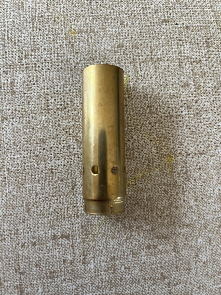

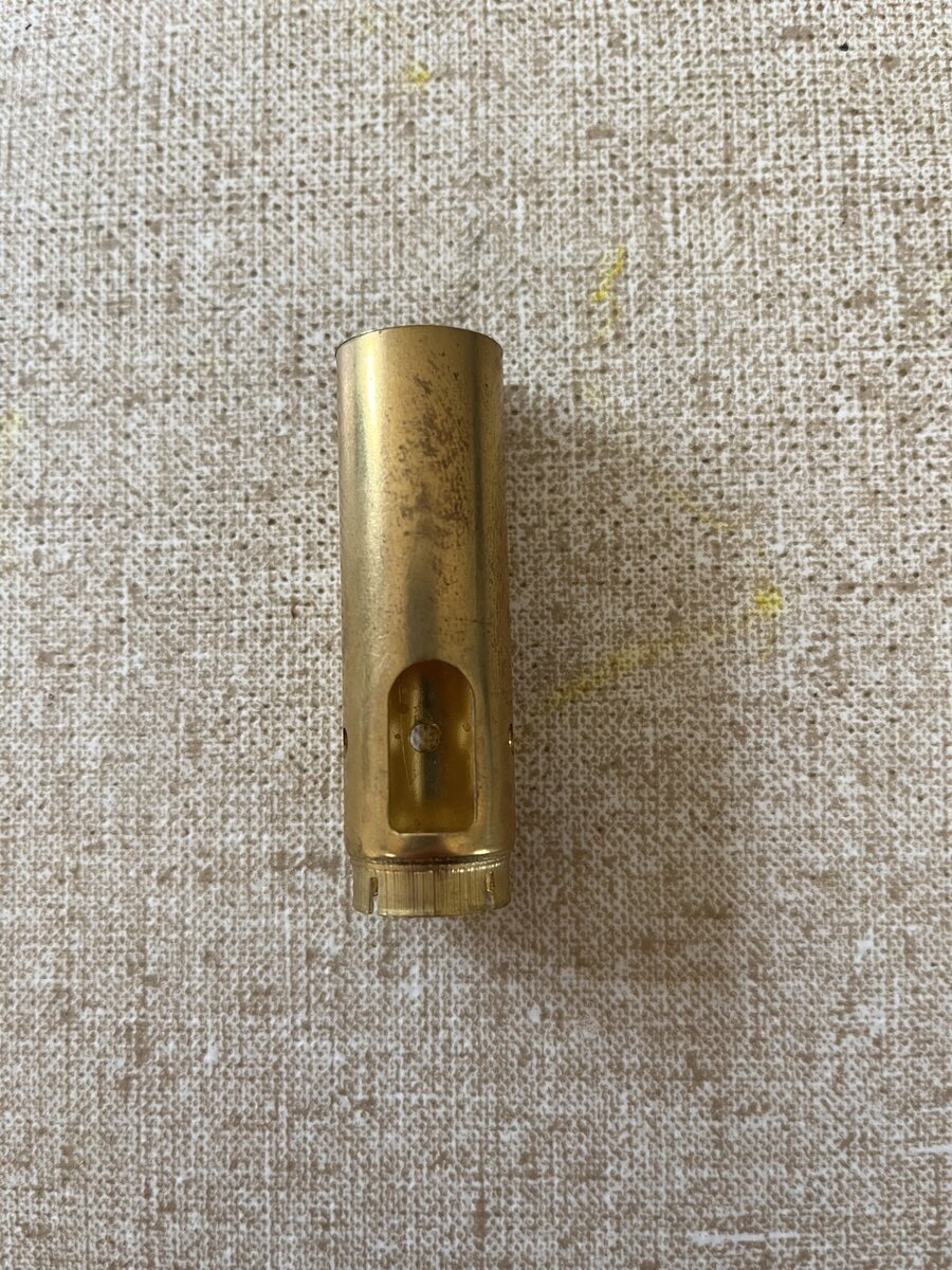

  18. Tony Press
    11,105
    Coming back to this discussion of the “drehrapid” Petromax pre-heater on the early Optimus “Rapid” lamps and lanterns.
    As I was working on the Petromax 827 that is the subject of this thread (and now posted in the Reference Gallery here), I thought “what if I drilled holes around the base of the Rapid flame protector tube? Would that allow more air into the mix and make the flame bluer?”
    I didn’t do it as I thought I’d try it on my next “drehrapid” which is a Px 882.
    But… as I was going through my spares I opened a new flame protector tube, and low and behold:
    It has a row of holes all the way around.
    When I fettle my 882 I’ll test this and compare it to an old one without holes.
    Stay tuned (for a while, as I’ve got another Petromax project to do first).
  19. MYN
    I believe opening more inlet holes around the base of the flame tube can only help to a certain extent.
    How much air being drawn in through the openings depends strongly on the velocity of the fuel-air stream leaving the Drehrapid's jet orifice.
    This is in turn dependant on both the operating pressure and the size of the jet orifice.
    A smaller orifice creates a discharge stream with a higher velocity. High discharge velocities would help create a lower pressure zone around the tube's air inlet hole(s) to draw in more air.
