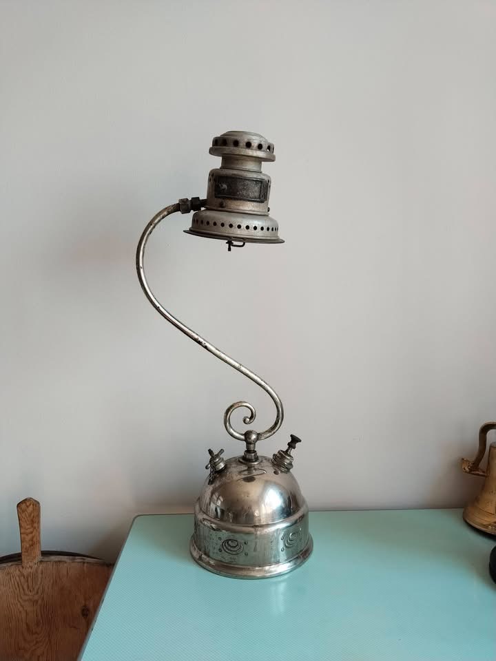

    Does anyone happen to know what brand of lantern this is and where it was manufactured?
    yes brama lampe?
    thank

    According to the Pressure Lamp Catalogue / PLC.. Brama lamps were made by Martin Brandt & Co., Metallwarenfabrik. Schlessischestr 20, Berlin SO. 33. Germany.
    That's a splendid old lamp which you have and in my opinion it's well worth restoring.

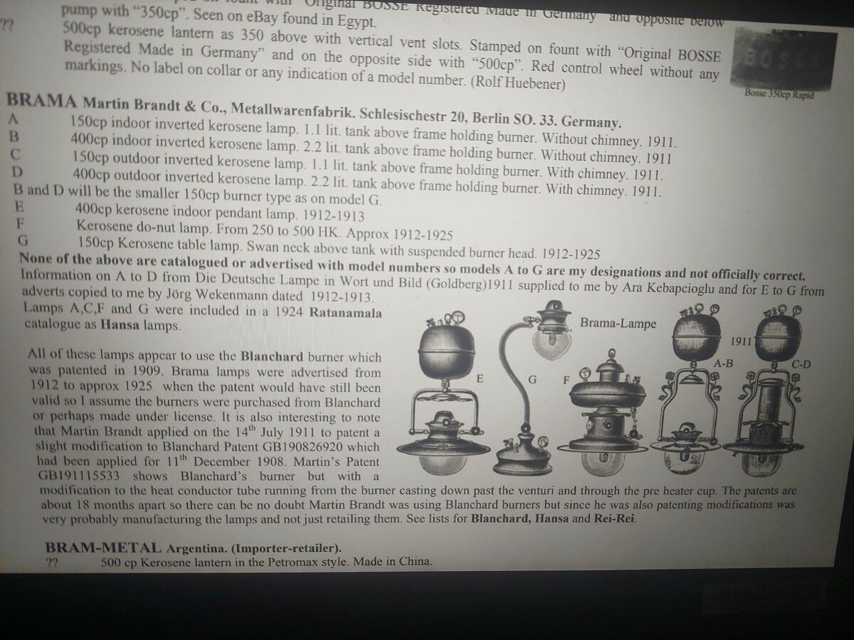

    Hi this is the bit out of Neils book maybe of intrest
    Cheers pete
