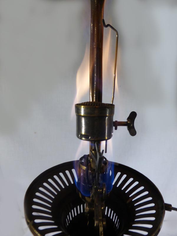

    Hi all,

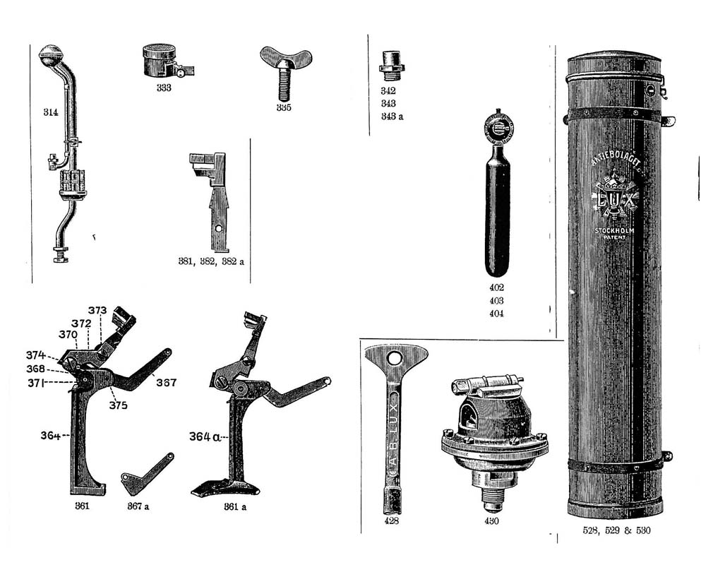

    Here is my example of the Swedish AB Lux hollow wire lamp DHK (K-for a "koppar" copper finish). The Lux DH lamp is first seen in a 1902 catalogue. This first DH lamp had a hw connection with the fuel tube sticking out of the upper end of the harp with a threaded nut for connection. In the Lux 1904 catalogue in my possession, one can see a change, and now the hw connector is integrated in the top finial "ball" with hanger. When the change was made I'm not sure of, but this version of my lamp was at least present in 1904.
    I have had this lamp for years missing the very special cleaning needle mechanism and a proper shade. This summer I found another DH lamp that I could use for parts and now the only thing missing of the cleaning needle mechanism was the needle holder/carrier.
    With measurements and pictures from a Swedish collector friend I managed to fix me a functional needle carrier.
    I also had an original cracked shade that gave me the right measurements for the possibility to make new ones. With that measurements and with a Swedish glass moulder and glass blower, I got a production of globe shades made both for me and other Swedish collectors ( the production of 25 globes were made probably only a couple of miles from where the original shades originally had been made 100 years ago, in the "glassworks district" of Sweden).
    This 200 CP kerosene fed lamp has a Lux burner (used from 1901 in Lux lamps), and was sold as a work shop lamp, also for use in churches, cafés and other big space indoor places. Later this lamp came in an ornamental version for domestic use.
    One can have different opinions about the exceptional cleaning needle system of these lamps/burners. Ingenious or just crazy? One thing though - there are so many factors with these several movements that can go wrong and the jet is not rock steady fastened either ( you need a precise alignment of the needle carrier for making it to the orifice). Most, if not all, of the circa 10 lamps with that mechanism I've seen had a broken needle, or the needle carrier/holder is gone. Also on the downside that you had to exchange the whole carrier when you broke the needle.

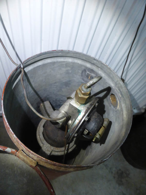

    These lamps were pressurised by different types and sizes of Lux tanks; using either air pressure or using a CO2 cartridge for pressure. Most of the tanks, maybe all, used a pressure regulator device. You can see a big Lux CO2 tank below (I did not used that in my lighting try) and you can also see an air pressure Lux tank that Christer just posted in the "Spares & Accessories section".
    /Conny

    Here´s images of the Lux tank.........

    I amended your title to just read 1904 as the starting year because in the 1903 years catalogue it looks the same as in the one from 1902.
    1904 is the first year with the fitting for the tubing in the ball like yours.
    For those who want to see more of the tank, I have one taken apart posted here.

    A beautiful restoration Conny. A great job done fabricating and aligning the cleaning needle :clap: :clap:

    The lux-tank completes it all.
