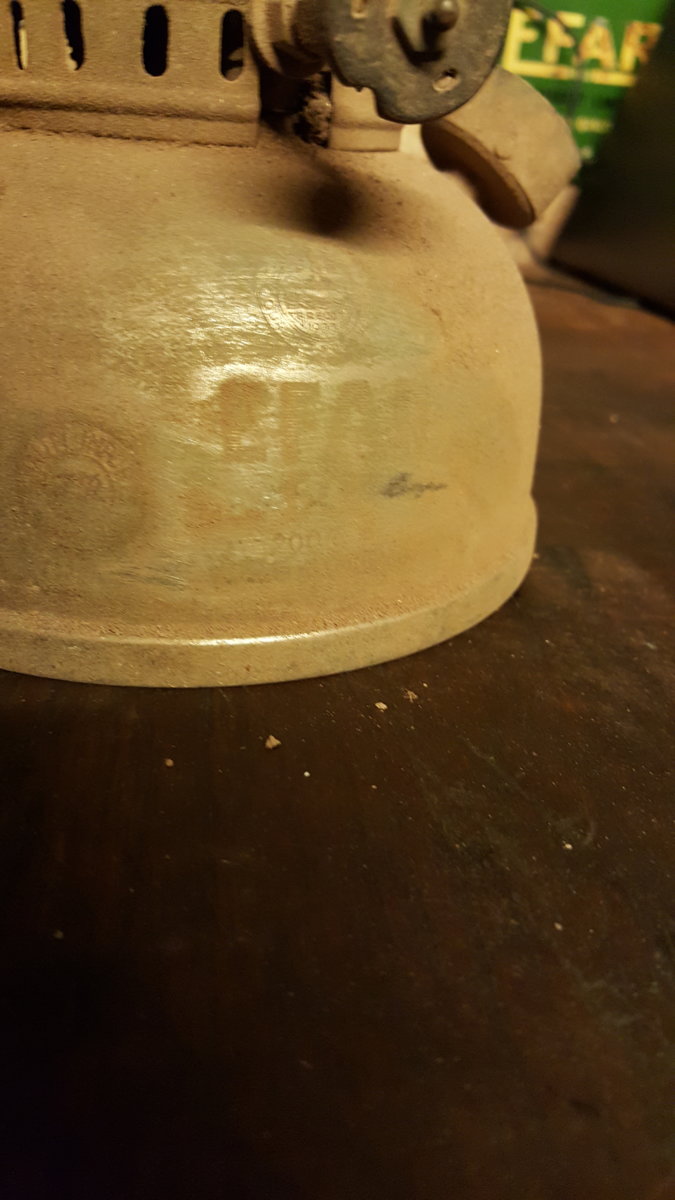

  5. Mackburner
    6,827
    Not a Petromax of any persuasion. That is a Hasag 42. I have this listed as Efar model D. Raceck didn't give their lamps model numbers. The 608 is part of the registered trade mark. Nice find. ::Neil::

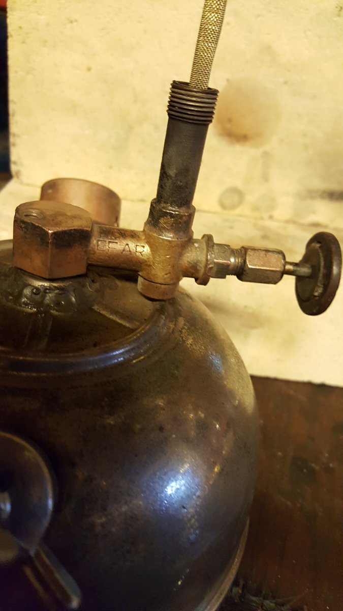

    Had a fun day cleaning this lamp although the tank has not responded to any form of treatment.
    It looks like the mixing tube has been broken and badly repaired at some point.
    The tap assembly is marked Efar Germany.
    Apart from being caked in mud like someone had found it in the bank of a river it seems in reasonable condition.

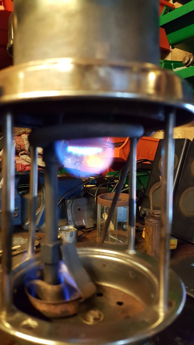

    Just had a go at running the lamp, looks like the broken mixing tube needs attention. The fuel burns in the hood and does not get as far as the nozzle.
    Amazingly the pressure gauge worked, impressive given that it's full of mud and wd40. 20191116_140815.jpg

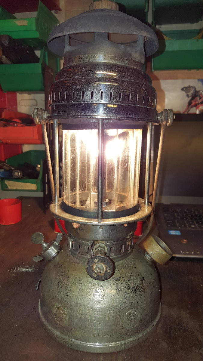

    Managed to fit a needle and pack the generator with some mesh.
    Also found a mixing tube from a veritas 350 that looked close enough.

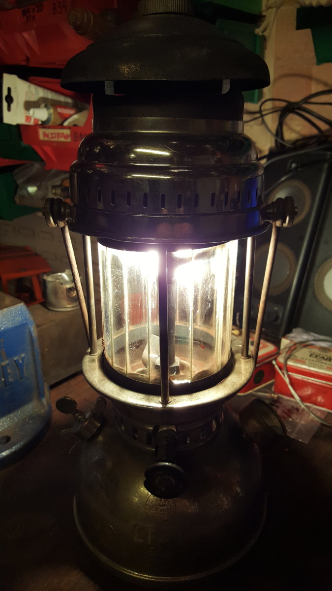

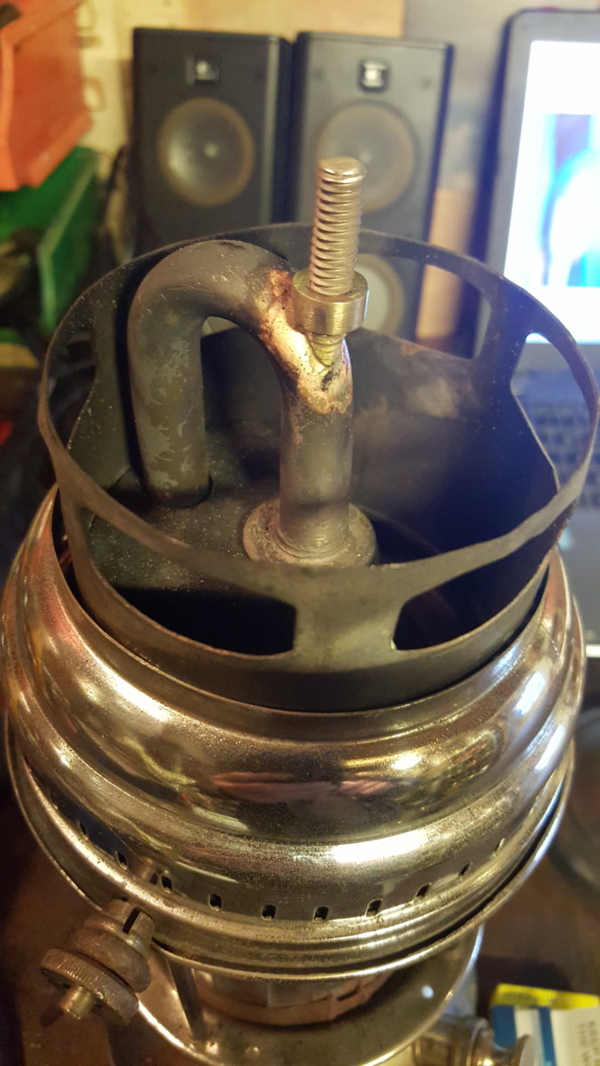

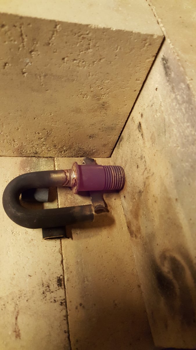

    This lamp is now finished.
    I soldered a 1/4 bsw screw to the air tube to fit the top cap.
    I had to move the pre heat dish to the centre as the flames tended to run up the glass.
    I am quite fond of this lamp, it does run well.
    20200108_213843.jpg 20200108_213833.jpg 20200108_213751.jpg 20200108_213051.jpg
  22. AussiePete
    3,643
    Jolly nice ....... Well done @James K
    How is the solder holding up on the 1/4BSW vent screw?
  23. James K
    Nov 10, 2017
    649
    Hello Pete,
    The vent screw was silver soldered to the mixing tube, that won't be going anywhere.
