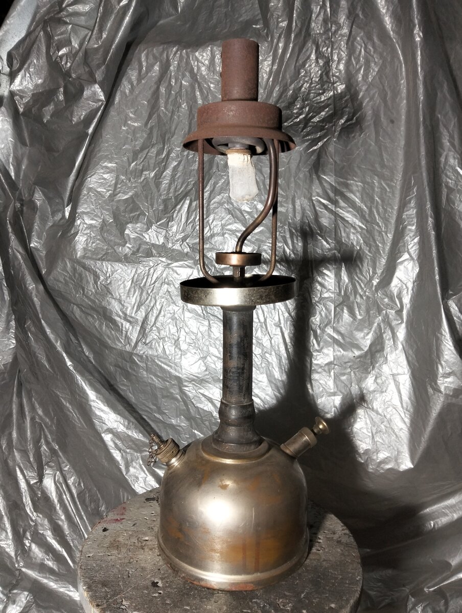

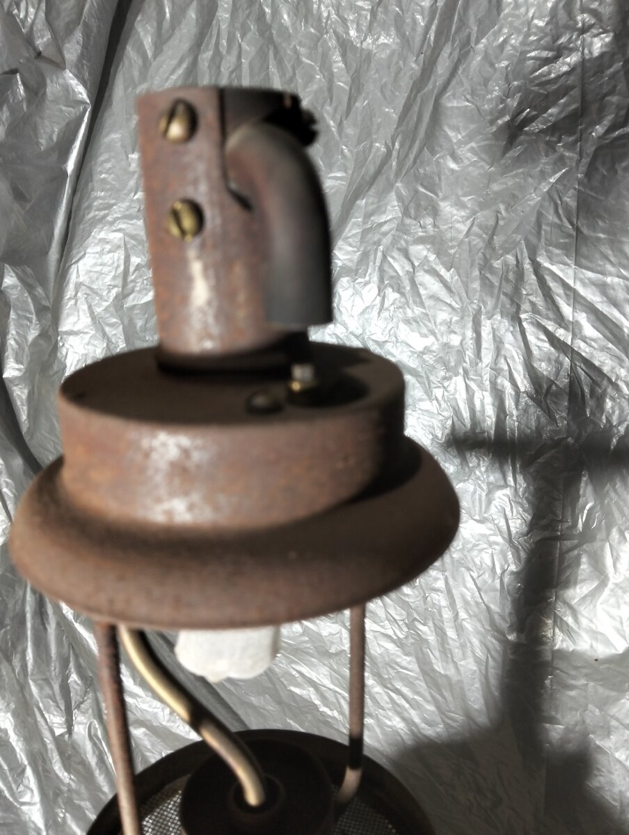

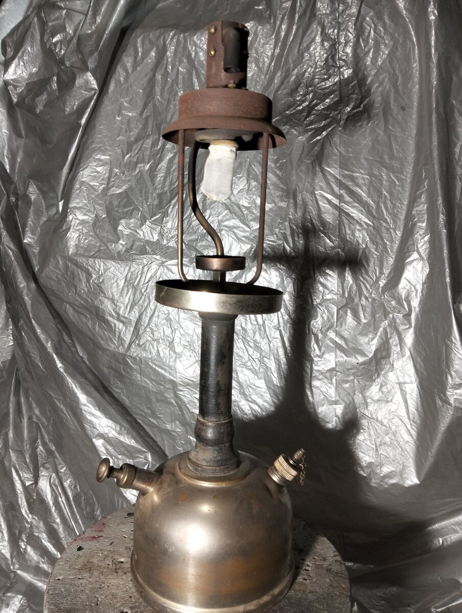

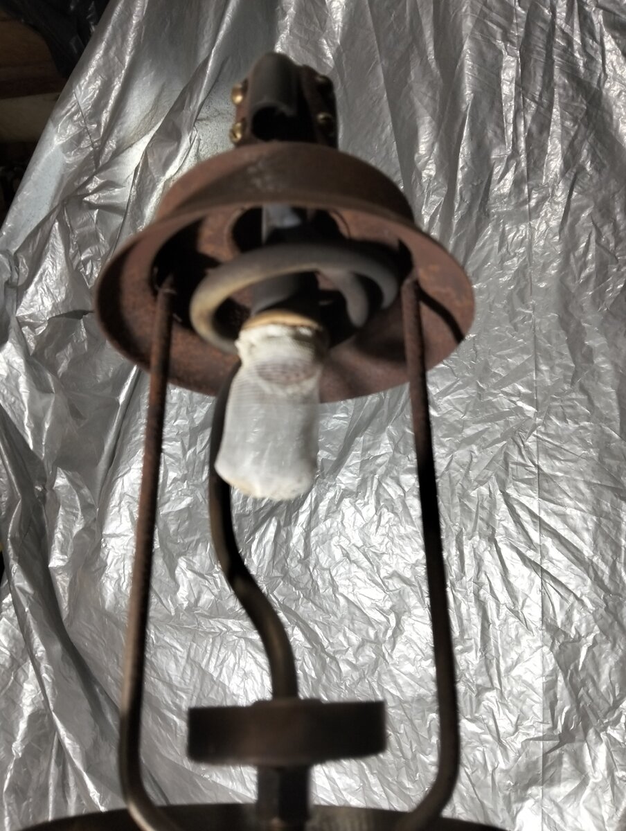

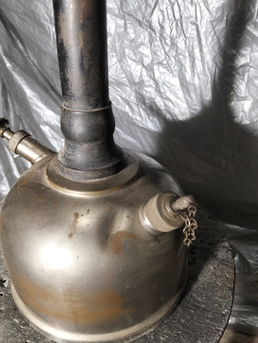

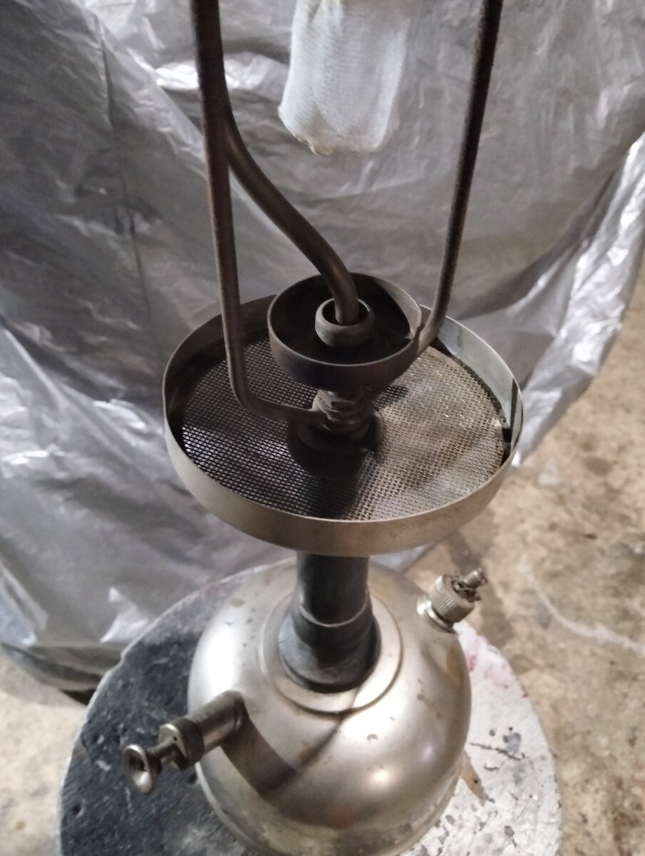

    Good evening I've had this lamp for a while but l don't know the brand and model.I'd like some opinions from you all.It doesn't have a cleaning needle, but it's working

    I believe parts are missing

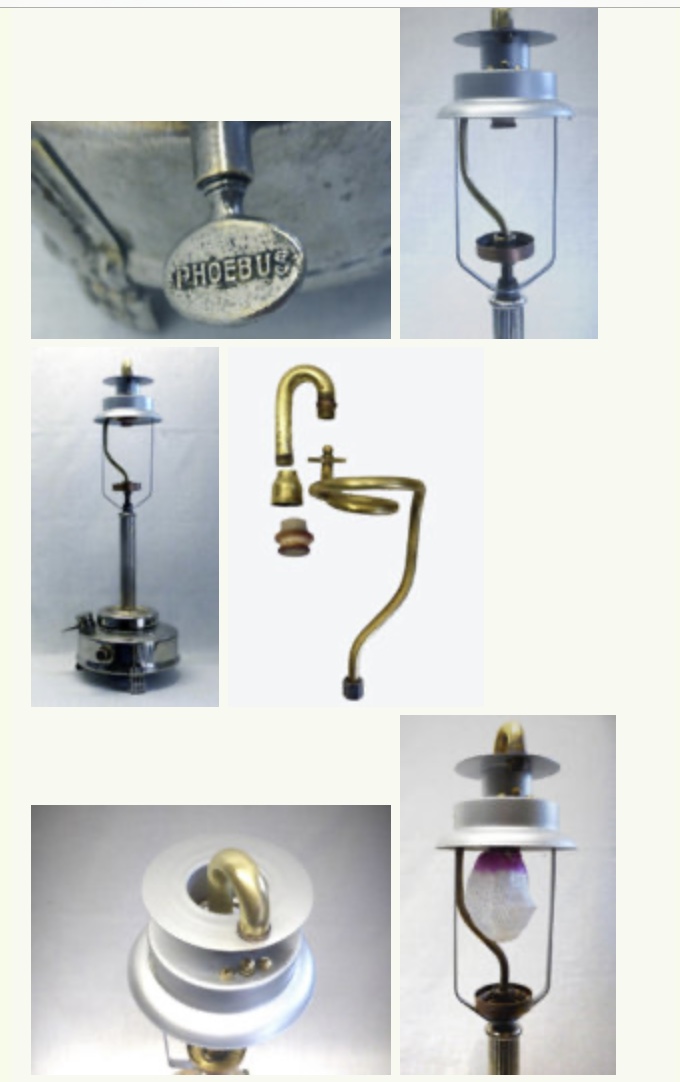

  3. podbros
    3,996
    Phoebus or perhaps under license?
    have a look for this thread in the gallery
    its a stove conversion but there are lots of similarities
    hopefully other members can help

  4. irineu Brazil
    Jul 13, 2021
    10
    curitiba parana brasil
    Good morning. Yes, the evaporator and burner parts are very similar. I've had it for about two years and I was very curious. Thank you.
  5. Henry Plews
    3,031
    Phoebus burner yes but compare the tank, filler cap and wood handle on this Standard table lantern
    Standard No.3060
  6. Reinhard
    Reinhard Germany Subscriber
    Oct 15, 2018
    1,084
    This design reminds me a lot of the Continental donut lamps 701 and 761 !

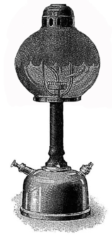

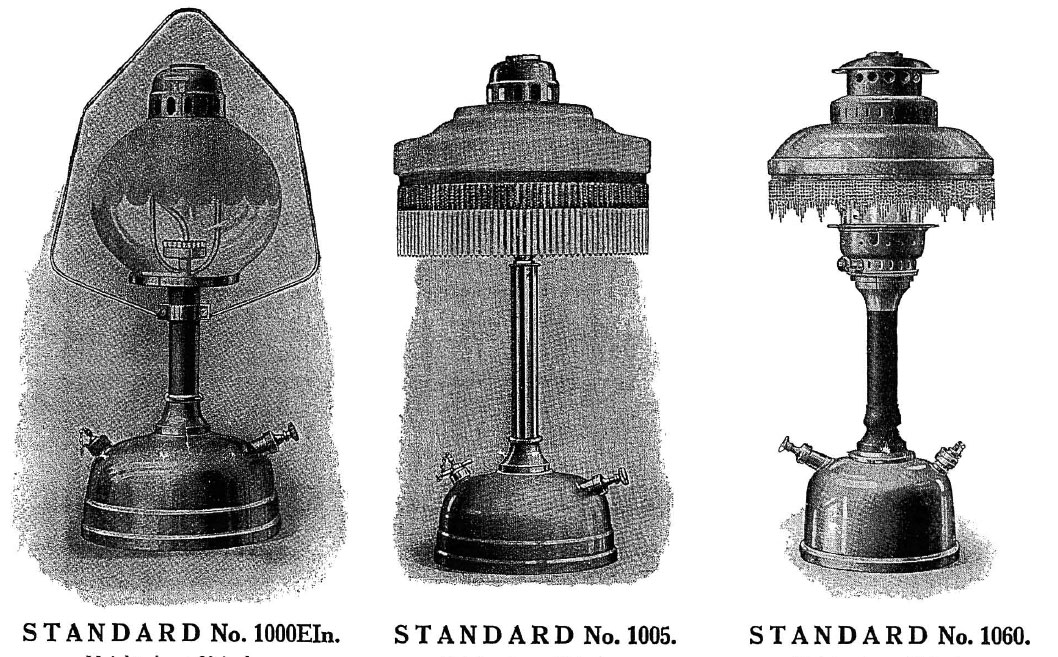

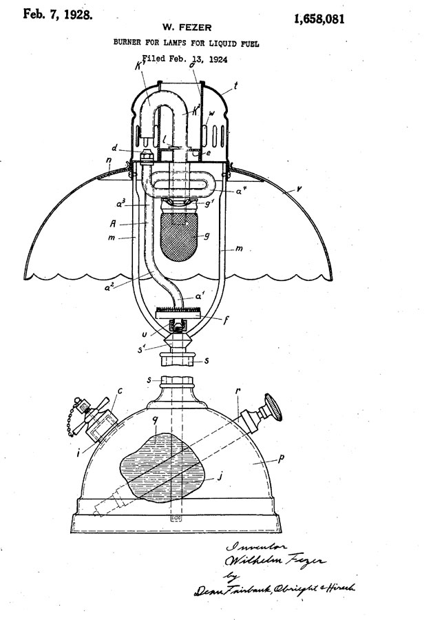

  7. Conny C
    Conny C Sweden Subscriber
    955
    I think this lamp is all Standard Licht made, both burner and tank. The upper part with burner is from the Standard Licht 1000 table lamp combined with the tank/font from a Standard Licht 1060 table lamp. This combination has not been found in the Standard Licht papers, but Neil gives a hint that this Standard Licht
    table lamp combination was a possibilty, as he says in his PLC .....
    Attached you find Standad Licht catalogue images 1931 (Neil) and the 1924 patent of Fezer.
    /Conny

  10. irineu Brazil
    Jul 13, 2021
    10
    The standard 1060 is actually the closest thing to this piece, even though it doesn't have any markings.
    Thanks to the members and to @Conny C for the image revealing the identity of this lamp.
    Regards, Irineu

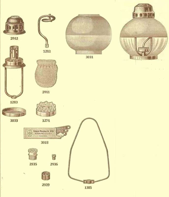

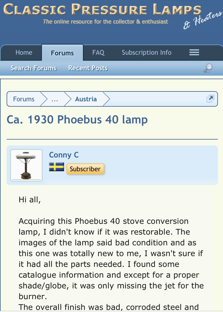

  11. Conny C
    955
    @irineu
    With that upper burner part with a globe shade holder ring I think your lamp originally looked like this ......
    Here are lamp conversion parts for the Phoebus 40 lamp and similar parts are also the ones used on your lamp .....
    /Conny
