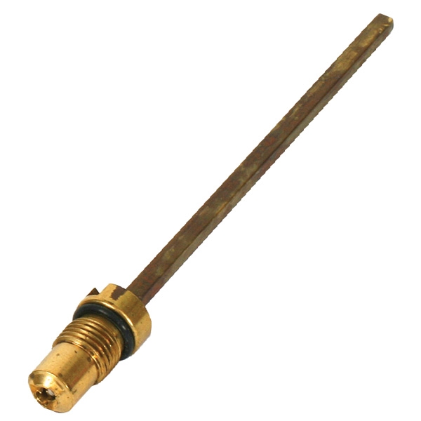

    Hi,
    Great post. I'm new at this; I just bought a used Coleman 222. But the check valve seems to leak some air (very slowly, but still...)
    I did a test: I took off the pump plunger and the stem, leaving just the check valve. When the lantern is pressurized and held upside down, I can see the fuel slowly dripping through the valve. Not enough to turn the lantern into a flame trower, but enough so I can hear a small "puff" when unscrewing the stem. Makes me kinda nervous.
    I'm glad I found your post before trying anything stupid. I'll try cleaning the ball valve first. You cautioned not to use lacquer thinner on a rubber valve. But the check valve appears to have some kind of rubber o-ring on the outside (see picture); would the thinner damage this gasket?
    thanks a lot!

    Hi Jerome,
    Welcome to the forum. Glad to have you aboard.
    Reading your post, I'm thinking you may not have a problem. The steel ball in the check valve is not meant to be a positive shut off. It's just there to prevent air from coming back out of the valve while you are pumping it up. The action of you closing the air stem makes the positive shut off. With the tank under pressure and the air stem in the open position, I would expect perhaps a tiny bit of leakage. A decent test would be to open the valve and pump up the tank as normal, but instead of closing the air stem valve (as you would do when you finished pumping) leave it in the open position and see if the pump rod gets pushed back up (from a leaky valve). If it immediately pushes the pump rod up, the ball is either stuck or gummed up. If it does not move for a minute or so, it's probably OK. A bit of movement? I don't know. I just pump it up and shut off the valve. If the rod is not being pushed back while I'm pumping, I'm happy.
    The problem with a valve that needs fixing that Flivver writes about is one that is stuck open (or closed). You'll know this when it happens.
    Lacquer thinner is usually your friend, I use it for many lamp restoration functions. It dissolves kerosene gunk almost on contact and works OK for other gummed up parts.
    However, be VERY careful using it with painted lanterns like the 222. It will dissolve most lantern paint almost on contact, making a big mess. You can be very careful pouring it in, but I can assure you, that when you go to pour it out, you will get it on the paint unless you do a serious masking job or perhaps siphon it out. Also, my 222A has some sort or red paint on the inside bottom of the tank, possibly for rust prevention, whose resistance to lacquer thinner is unknown.
    The 222 is a neat lantern. I have a 222A, and with an old coarse weave 21A Silk-Lite, it's very bright. And contrary to popular belief, I can run it for a long time before needing to pump it back up; perhaps because I'm using the original "skinny" 222-2991 generator which has a smaller jet orifice than the newer dual fuel 226-2991.
    And we love pictures.
    Dan
