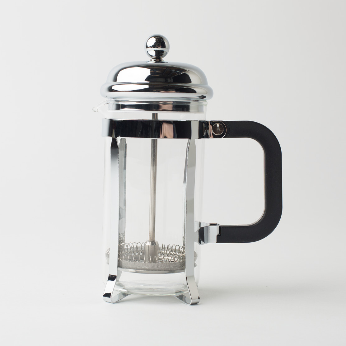

  13. ColinG
    4,692
    OK... I'll sort something out by I've run out of cafetiere inserts.... although I can probably use something else to demonstrate the principle.

  16. ColinG
    4,692
    Sorry it took a while, but here is my set-up for cutting down coffee press Pyrex glass liners.
    Please excuse the messy work environment but my workshop is long overdue a good clean up!
    As you can see, this particular Pyrex glass broke just as I was getting close to finishing it! It is a risky business but as these cafetiere inserts are cheap I'm not too bothered.

  18. ColinG
    4,692
    This is what I use... I remove the Pyrex glass from the metal or plastic and then cut it down to size.
    I ask around or go to charity shops or Goodwill type outlets to get them as cheap as possible, usually between £2 - £5
    You can buy then new for as little as £6 but I like the challenge of finding them cheaply!
    Diamond cutters can be purchased cheap on eBay.
  19. WimVe
    3,234
    I think that cutting the bottom out first will reduce the cutting vibrations whicj maybe the cause of cracking.
  20. ColinG
    4,692
    You may be right! Sometimes I've only made one cut and left the pouring spout as a lighting hole!

    Colin do you cut right through and then continue all round, or do you sort of score it all round gradually getting deeper until right through
  23. ColinG
    4,692
    I cut round and round slowly, getting deeper with each rotation. It's slow work and it can go wrong. I need a new cutter as blut grind wheels can cause chips and make breakages more likely.
