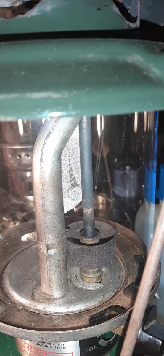

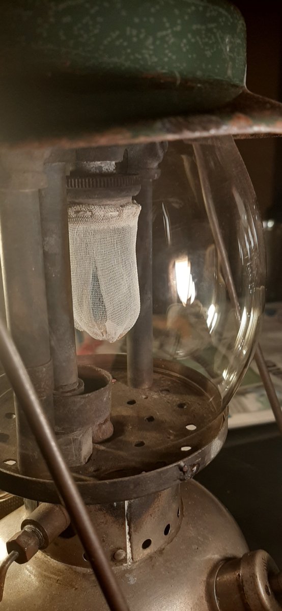

    I purchased 20 of the green tops and have tried a few of them. While they burn very bright, they are not durable. Below some photos where a 249 and 639 have split the mantles lengthwise.
    They are fine for test mantles and light duty use, 20200220_192115.jpg 20200220_193846.jpg
  23. ColinG United Kingdom
    4,808
    I've found the green tops far better than the pink tops... they split just like in your photo! The quality control and consistency of Chinese mantles can be a problem for sure.
