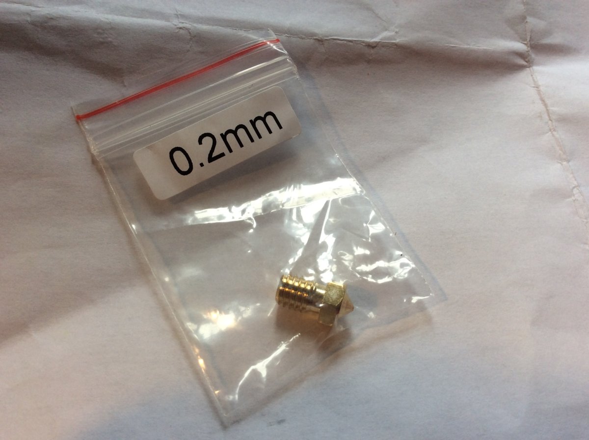

    Put it this way, I’ve given up trying to drill such small holes and now am trying 3D printer nozzles! They come in 0.2mm jet size and are cheap as chips! You can get packs of five for a few quid delivered from China!
  8. ateallthepies
    Oct 6, 2012
    238
  9. MYN
    I see... does it shoot a straight stream?
  10. ateallthepies
    Oct 6, 2012
    238
    Just tried it with a pipette of water and yes it does shoot straight and true!

    I believe thes jets go as small as 0.1mm. So should be handy for experimenting tho the 0.1,0.2 and 0.3 mm are probably the only ones that will be useful?

    What is the thread on the back end? It looks like the thread angle is quite fine.
    It could be 1mm pitch perhaps but not much meat in the tops of the threads?
    I reckon 3d printer plastic sludge wont leak past a small gap. Paraffin vapour? Just watch that space!

    Jon it’s regular Metric M6 x 1. Yes the sealing of the Brass jet to the steel body can be tricky. I had some success with very thin Copper washers. Also gonna try a dab of Stove rope adhesive on the threads. The temperature rating of this glue is 1350 degrees C so should hold up but not sure yet about if contact with Paraffin will degrade it at all? I’ve searched for another product that can seal threads while resisting the high temperatures at the tip of the Vap tube but so far have drawn a blank?
    I believe that the way the professionals get a good seal is just with a Brass on Brass conical male/female joint, correct me if this is wrong?

    I think the hardest part to replicate with these diy replaceable jets is the cleaning wire positioning so it always is dead central to the hole. The design of the standard vap tubes keeps the wire in the centre with a spring or another means. But right at the top there is a concave depression and maybe a tiny countersink?? That allows some wobble in the wire tip entering the jet hole, sort of like when jet planes refuel in the air, the fuel plane has a cone on a pipe and the empty plane with a pointed nozzle can manuever and be off a fraction but the nozzle slides up the cone and connects?
    These 3D nozzles internally just have a hole in a flat surface through them. To get such a fine wire to line up and be operational every time with the control cock is very tricky and may need the inside of the hole to be countersunk with a 0.2mm to whatever size bit?
    I’ve already tried poking a standard cleaning wire through just the jet hole and it fits just fine in length. It takes lots of delicate tries to locate the hole without any locating system in place.
  17. MYN
    I agree with the above. Poking a fine wire through a 0.2mm orifice on a flat surface is practically unfeasible. Depends too much on 'luck'.
    A conical countersunk on the inner surface of the nozzle is essential. No other means is as reliable.

    I’ve been testing various 3D printer jets and found one type that basically centres the wire tip pretty much perfectly!! I can’t quite make out how it’s made on the inside but it must be a conical hole just before the 0.2mm hole exactly like I wanted!
    The first lot of jets will be scrapped and these new ones take their place. I’m proper happy as this was one of the most difficult things to replicate in designing a replaceable jet Vap tube !
