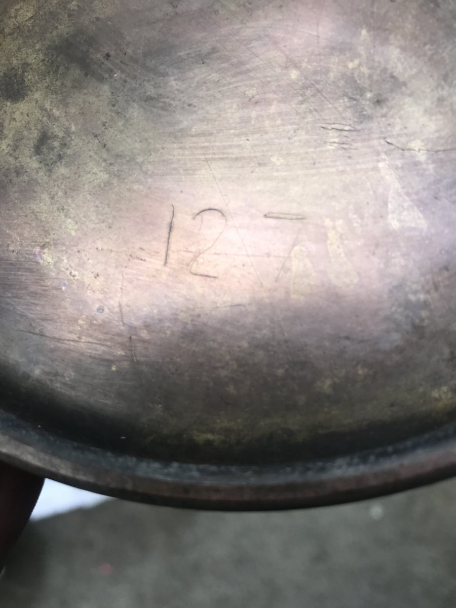

    On further cleaning and inspection I found a “7” after the “12” so it actually reads:
    “12 7”, which, using your system would be December 1937.
    I’ve gone through Neil McRae’s excellent Pressure Lamp Catalogue and I’m still unsure what version of the 837 it is, so I took more photos.

    1,091
    Oh, yes, 12 7 is correct.
    December 1937.
    This is normal for this type of lamp.
    Regards Reinhard

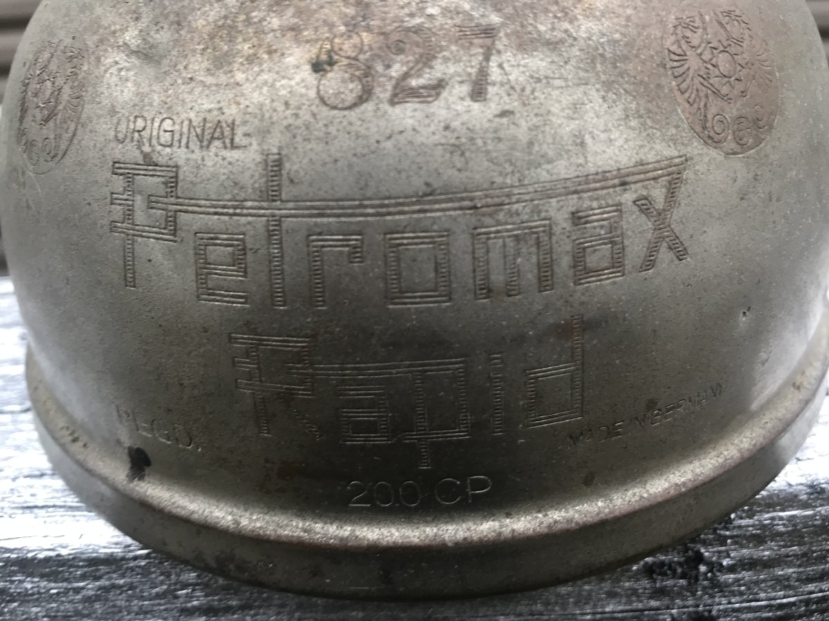

  6. Mackburner
    1932 is too early for an 827. That rapid preheater was patented in 1934 and model 827 is not listed in any catalogues before 1937. I don't have any paper from 1936 but 827 is not in any 1934 and 1935 paper I have. ::Neil::
  7. Tony Press
    Tony Press Ukraine Subscriber
    11,036
    Neil
    I found an additional “7” (see above): so 12 of 1937 for the No. 827.
    @Mackburner
  8. Mackburner
    That works. 1937 is when they were introduced into the UK. Perhaps a little earlier in Germany. ::Neil::

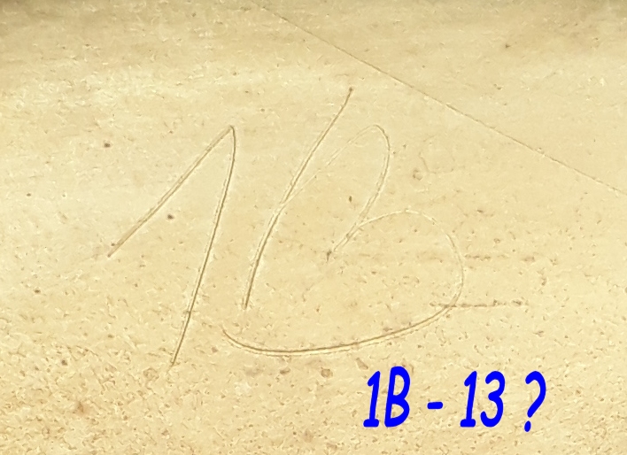

  13. WimVe
    3,530
    ok, ok, I confess, looks like they found their way here too:
    AIDA 1250 ...
    This one is interesting because somebody took his time.
  14. Nils Stephenson
    3,380
    My guess is 1/3
  15. Carlsson
    3,962
    I would also have guessed 1/3, and from what Reinhard says further up, that should be from the fifties type of marking, right?
    So January 1953?
    Does it fit your Aida's probable manufacturing period, Wim?

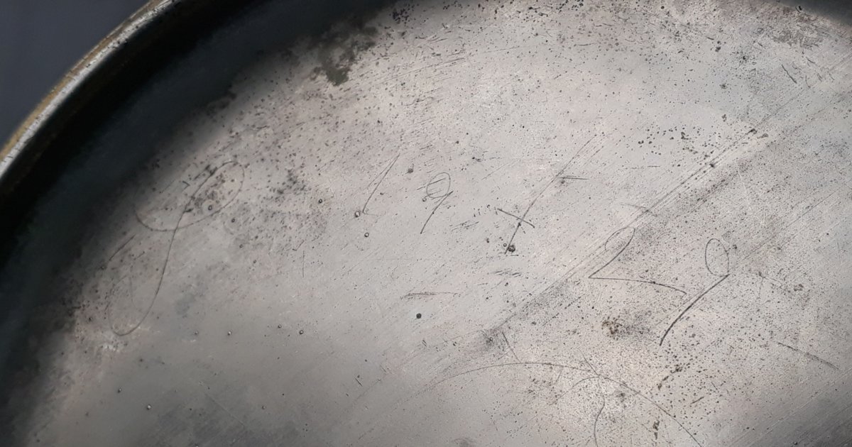

    I've another Petromax (unfettled) with scratched numbers at the fount bottom. What could these numbers mean?
    20190611_002859.jpg 20190611_002945.jpg 20190611_003009.jpg 20190611_003241.jpg
    Its quite faint, therefore I couldn't really read it clearly.
  19. Reinhard
    Reinhard Germany Subscriber
    Oct 15, 2018
    1,091
    @MYN
    26 7 30
    A complete date. Now we can assume that the year 1930 was written as the date of the 20s.An important insight.
    Regards Reinhard

  22. cmb56 Sweden
    Mar 13, 2012
    239
    Norrköping, Sweden
    It might also be 26 / 30 if the other scratches is only scratches.

  23. MYN
    Wow @Reinhard ,
    If 1930 is really the year of production, then the unit must be a relatively early on such a Petromax. If that's the case, the pricker wheel on mine must be a replacement(since its not fibre or Pertinax).

    Sure, @Reinhard
    If this is what you meant:-
  27. Reinhard
    Oct 15, 2018
    1,091
    @MYN
    Many thanks.
    It fits everything together.
    The hand wheel is a replacement, that was clear.
    The date is right.
    Regards Reinhard
