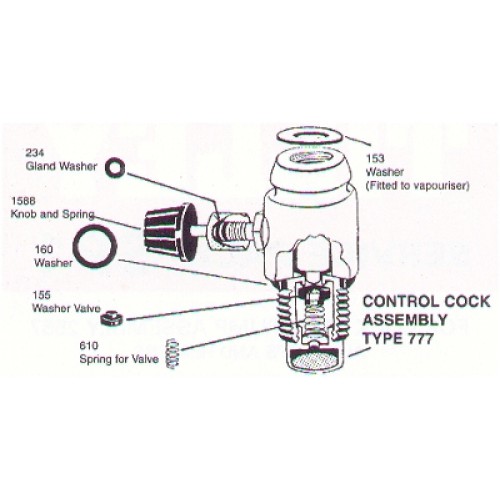

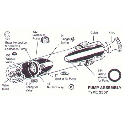

    Hi David,
    The NRV needs to be serviced. There are several options to look at.
    1. Fettlebox
    Tilley Washer Kit - The Fettlebox
    2. Tilley Lamp
    Service pack 1
    Here's a schematic of both the pump and control cock. It's always good to service both. Also what the service kit.
    I hope this information helps.
    Cheers,
    Norman
