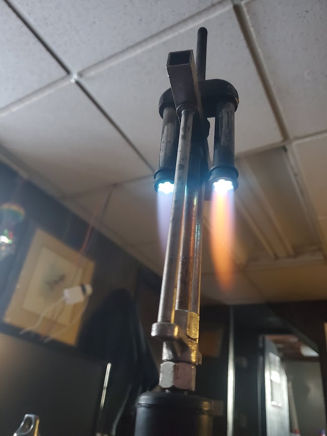

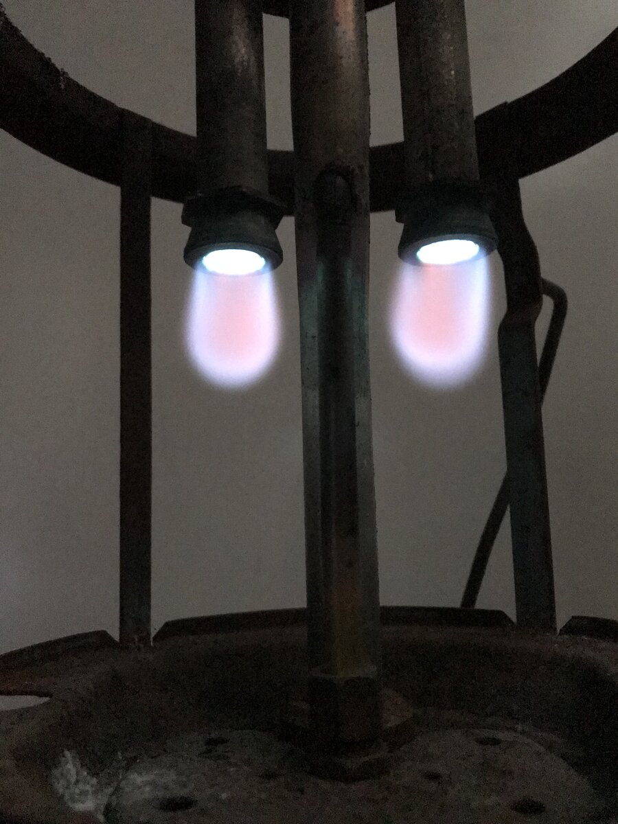

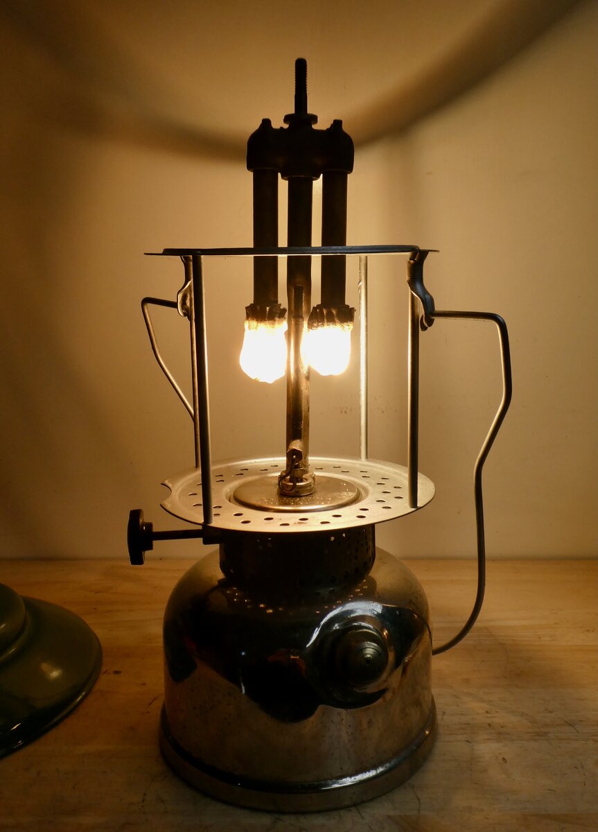

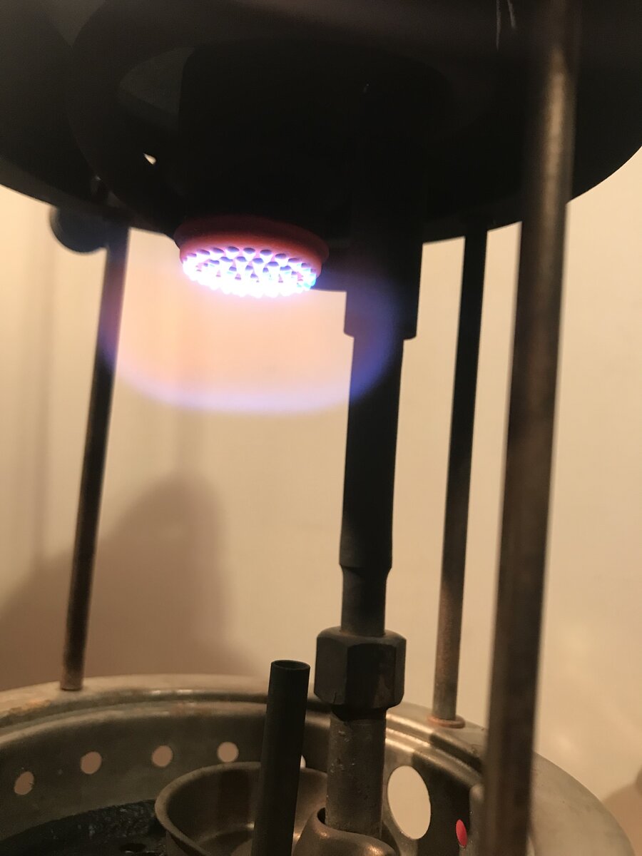

    I do it all the time, this is my latest fettel, Coleman AVK running on kerosene.
    11,105
    Nice looking flame, Dean.
    it’s interesting how some burners (like yours above) allow the flame to persist under reasonable pressure, but with others, like the Gloria 33 I just posted, the flame lifts away from the burner cap(s) at quite low pressure.
    @Dean D
  3. Dean D
    Dean D Subscriber
    May 21, 2017
    272
    Minnesota USA
    Thanks Tony,
    Sometimes just a few pumps and the the flame will separate and put a set of mantles and all is good.

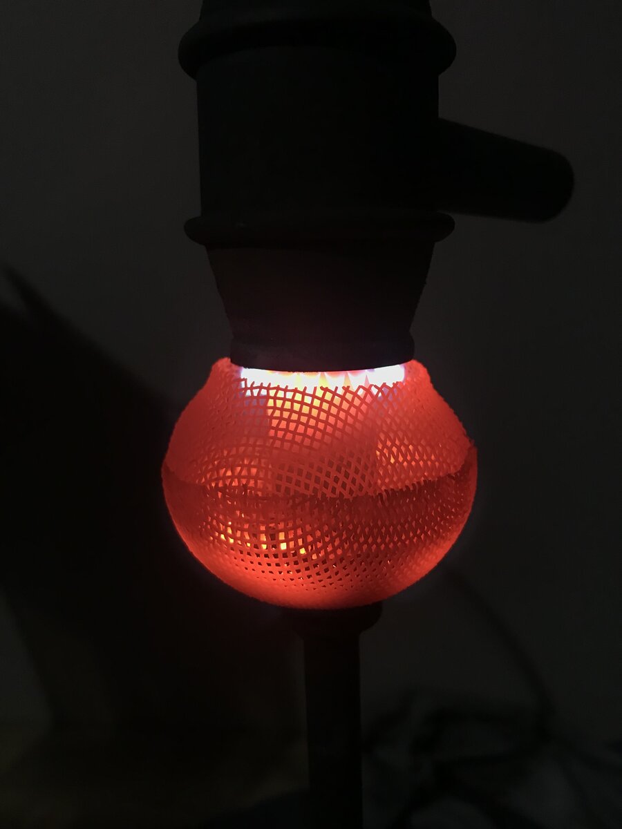

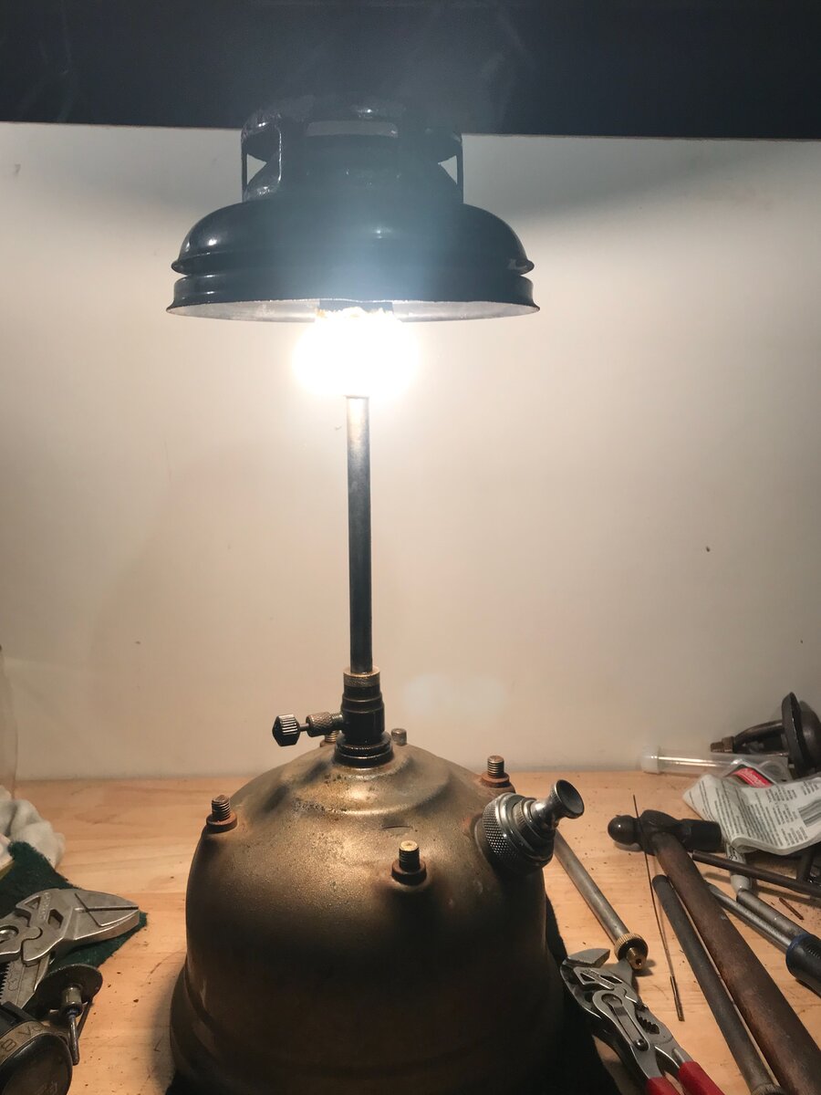

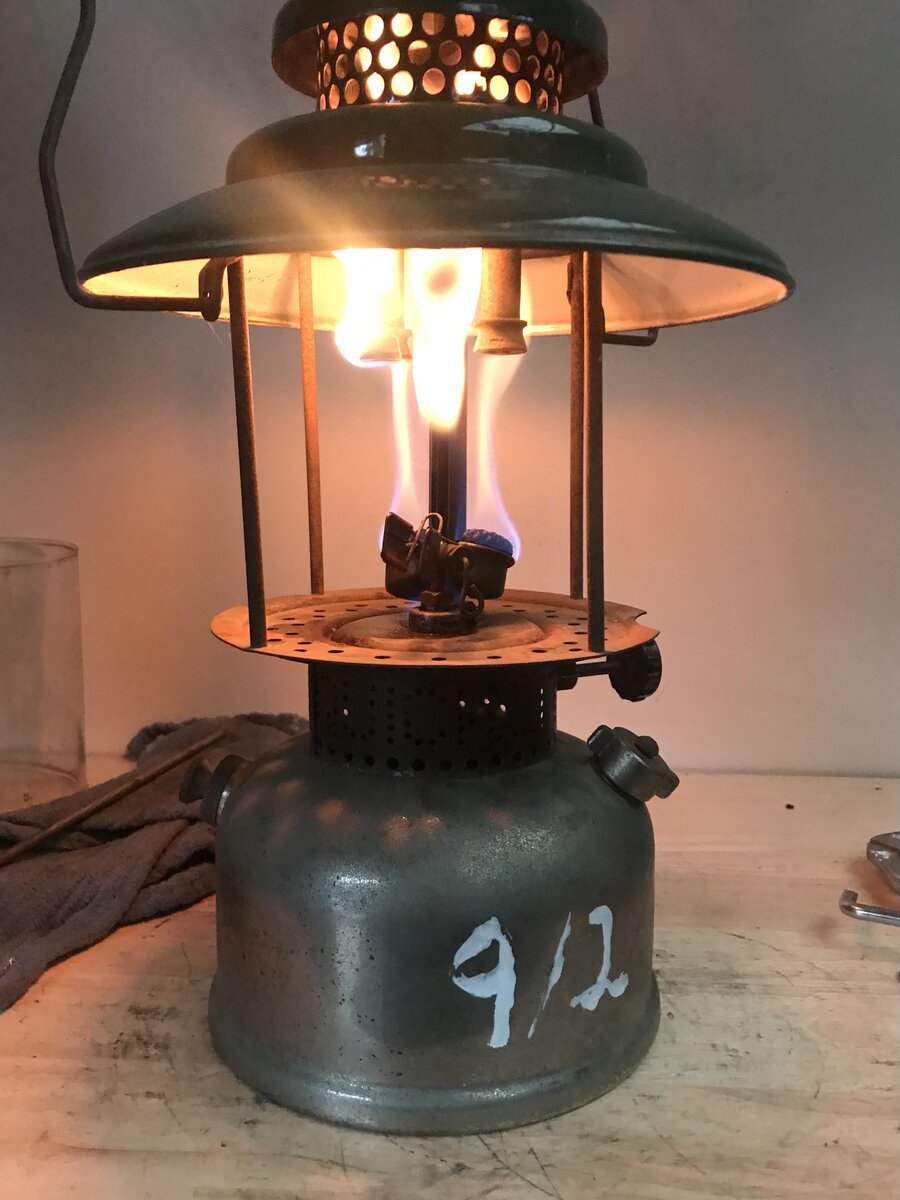

    Testing the burner on a 1932 Canadian L227 (with Canadian R55 generator).
    It's all good!

    Looks great Tony.
    Put the cutout on the bottom of the cage above the filler cap and all will be correct, it's to give room for the funnel.

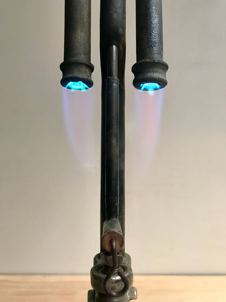

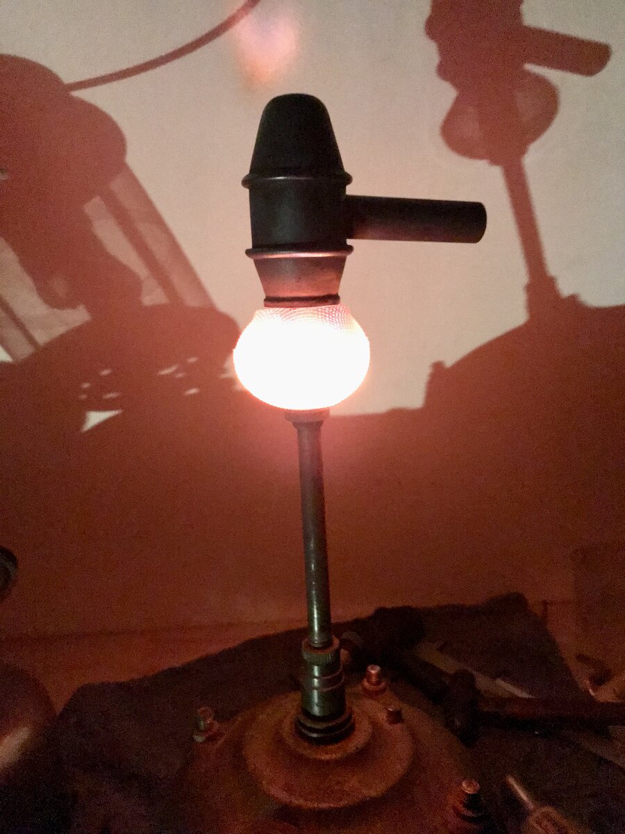

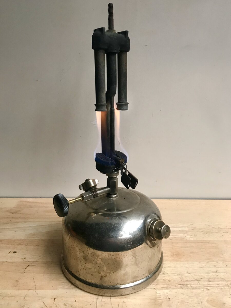

    Testing a late style Tilley R1 burner:
    Testing a old brass bottom Tilley 169 vapouriser:

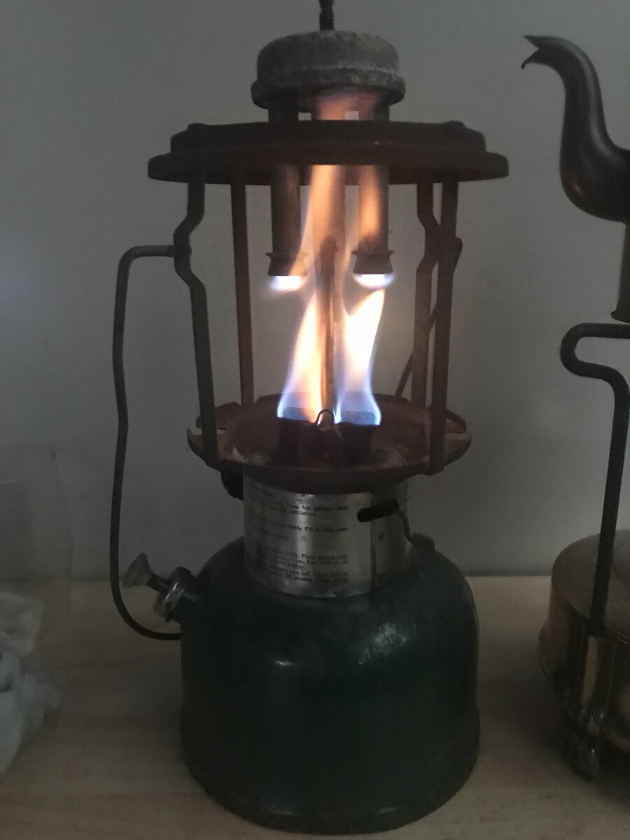

    Testing a Coleman 220J straight out of the post. It was mailed with the tank half full of Coleman fuel… [-X ](*,)!
    This lantern should be a good workhorse once I’ve cleaned it up a bit and treated the rust.

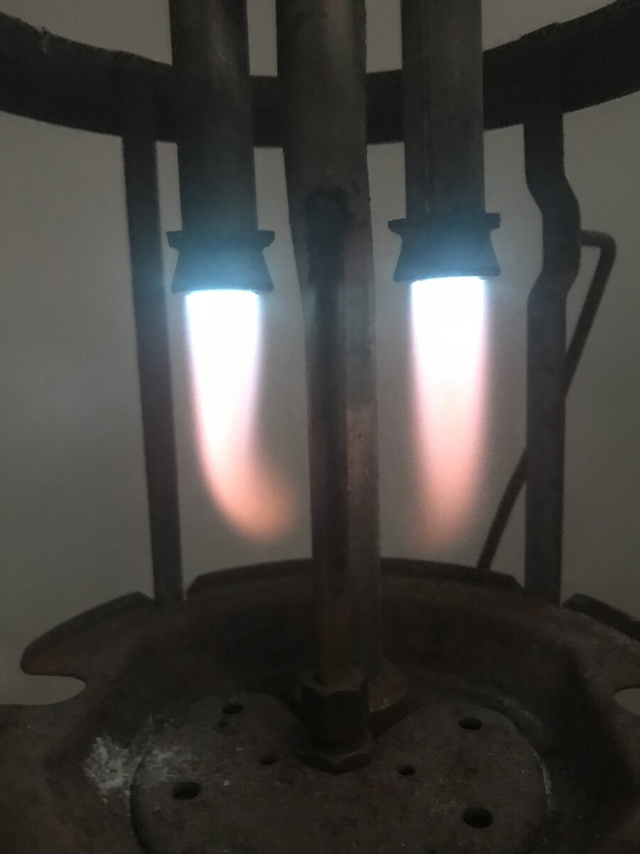

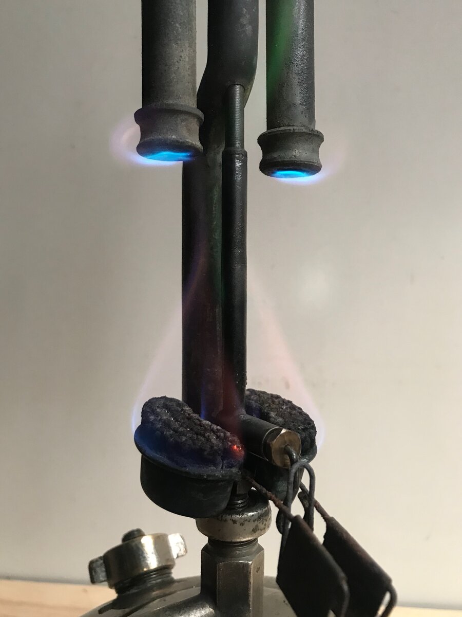

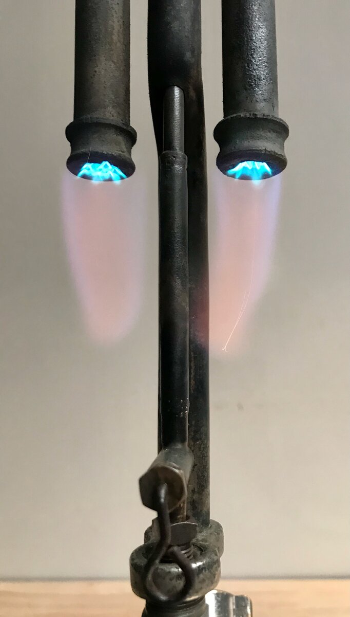

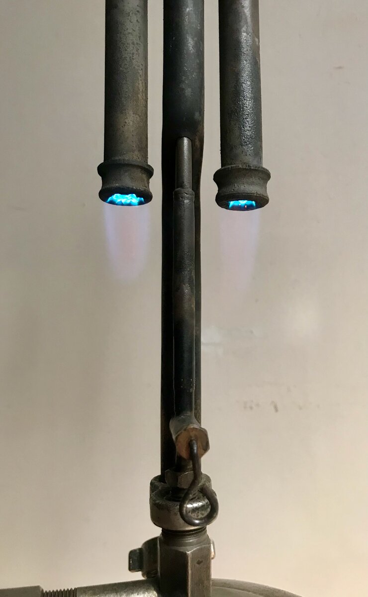

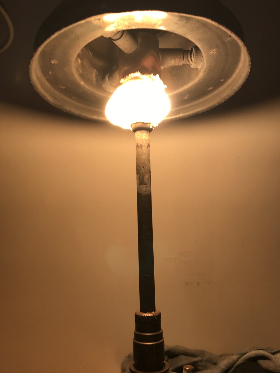

    Here I am testing one Tilley and two Kayen 169 generators on "David", my Tilley test bed.
    I know the burner and mantle work very well, so underperformance would indicate a problem with the vapouriser.
    Tilley
    First Kayen
    Second Kayen
    All vapourisers are rated excellent!
    The three vapourisers after testing.
    After testing the vapourisers were polished with 0000 steel wool, wiped with "Evaporust", lightly greased on the outside with beeswax, then wrapped in "Rustop" paper. They are now stored in old 169 boxes in a sealed plastic box sandwich box.

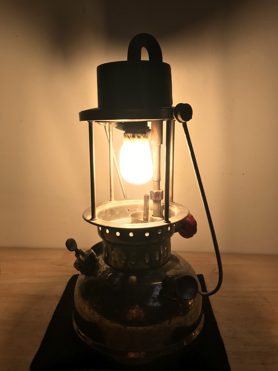

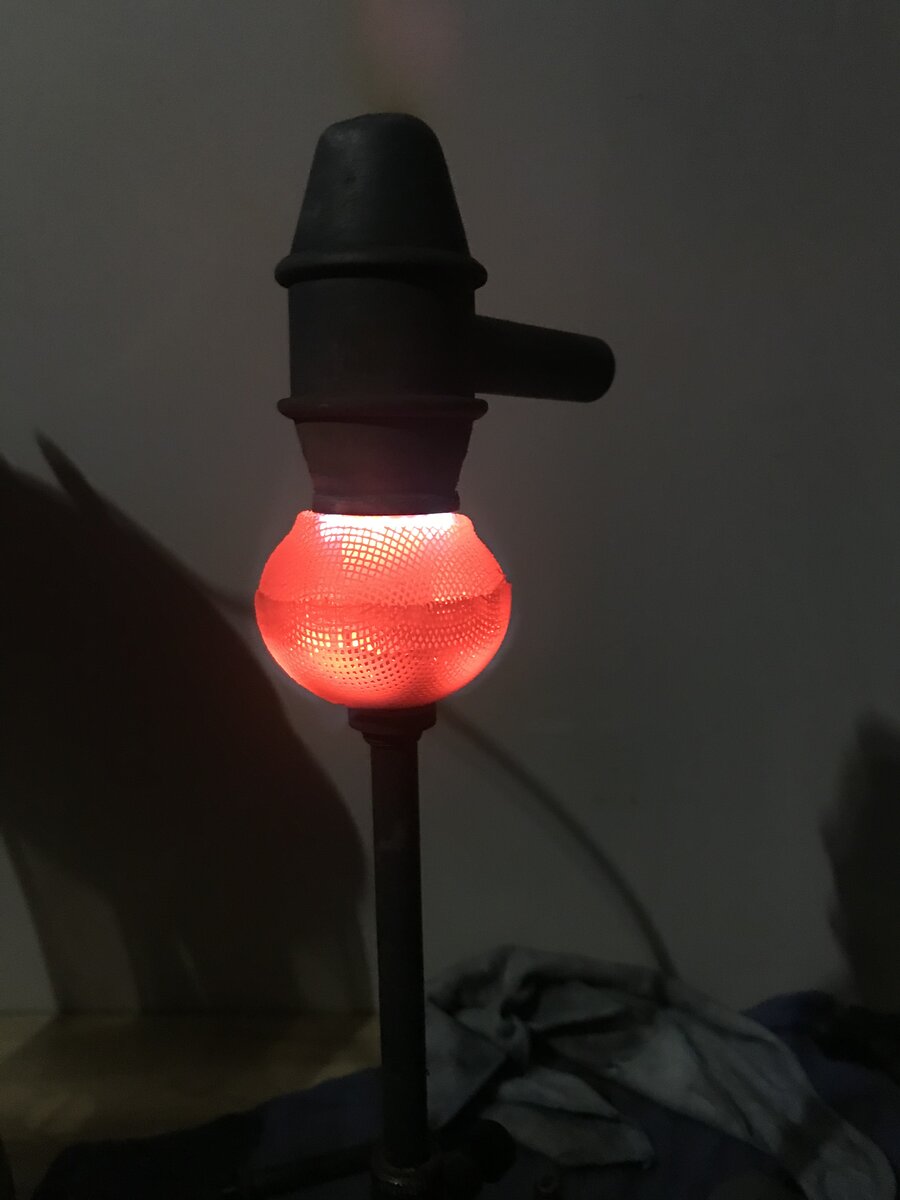

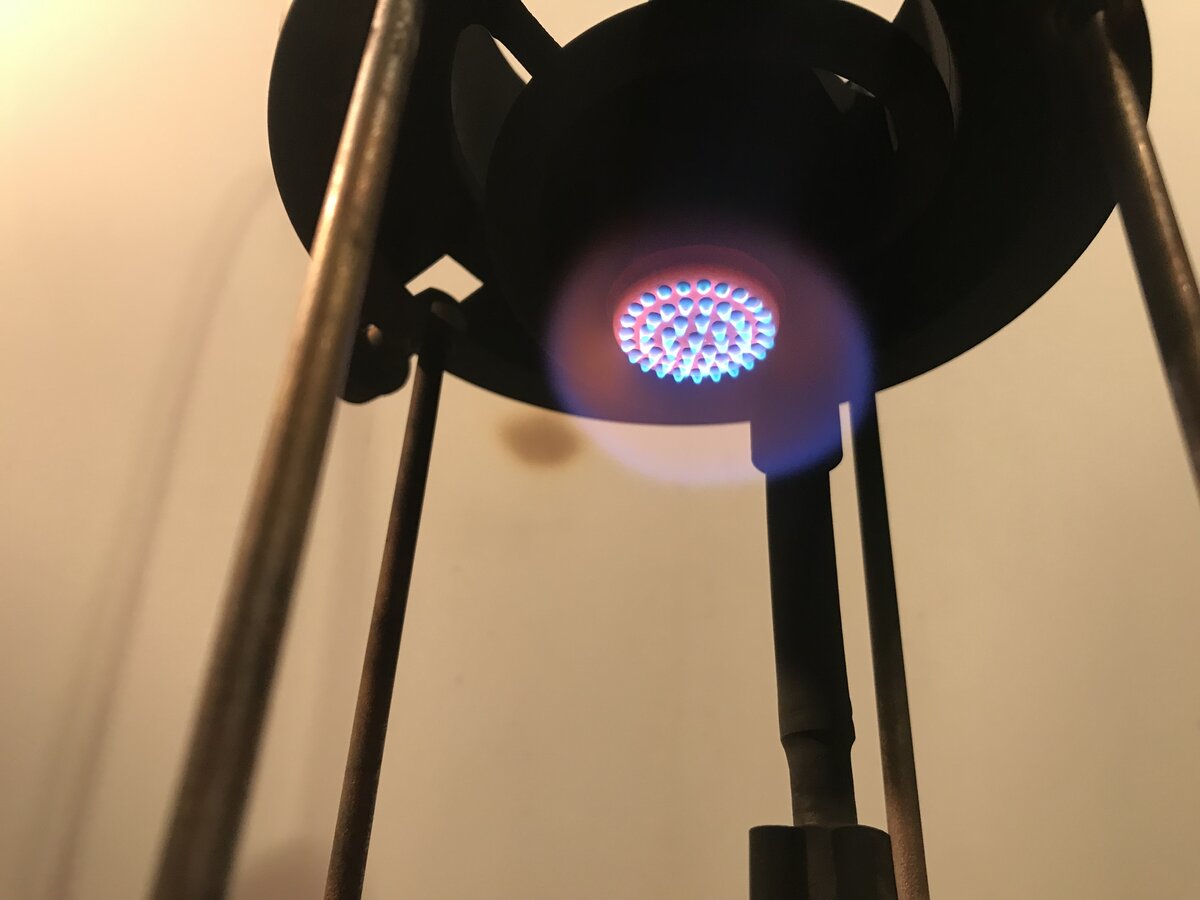

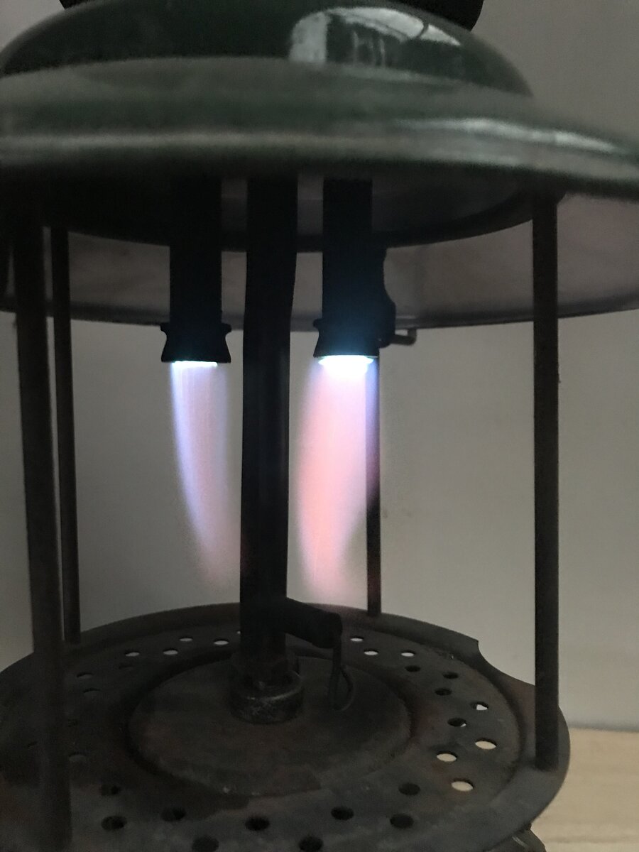

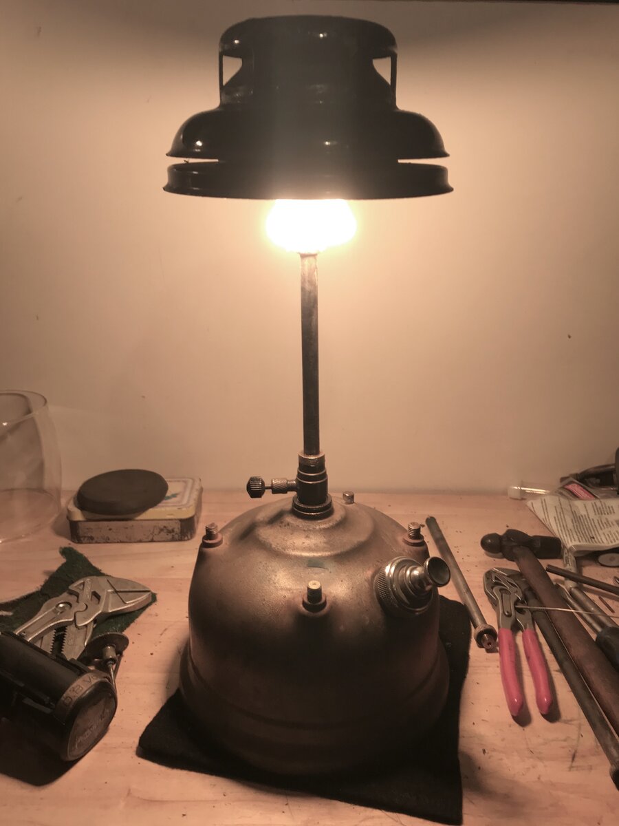

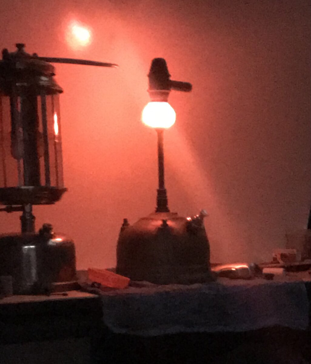

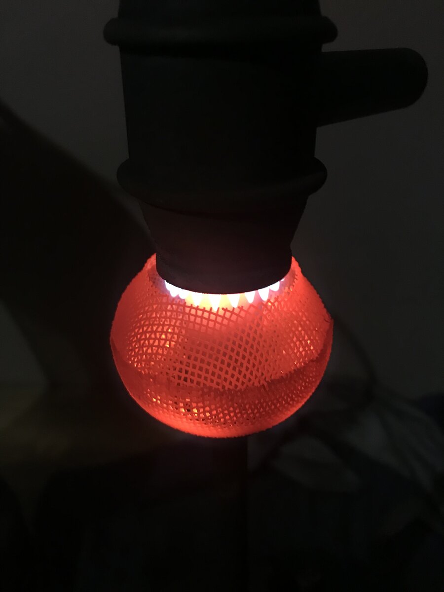

    Testing an Optimus 200.

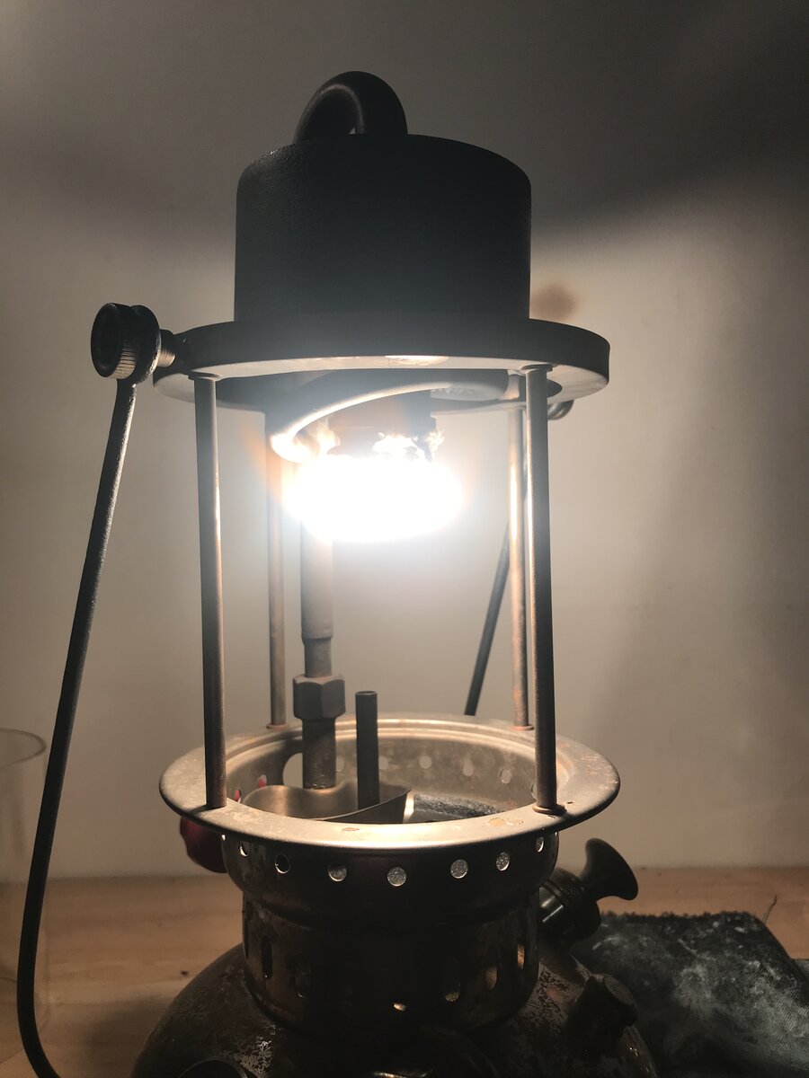

    And here with one of my 300cp Fukushima test mantles.
  20. Nils Stephenson
    3,414
    Interesting mantle shape and size (too small), but otherwise it looks like a good flame.
    Looks like a mid to late 1940s variant.
  21. Tony Press
    11,105
    @Nils Stephenson
    Yes. The mantle is a supposedly 300 cp mantle from a large number of very cheap mantles I bought a long time ago. I use them for testing burners, and I’m never quite sure what shape or size they will end up being — purely expendable.
    The lantern does look like it’s from the mid-1940s. It has the single screw for the top of the hood and red pricker wheel.
    I’ll get it in the Reference Gallery soon.

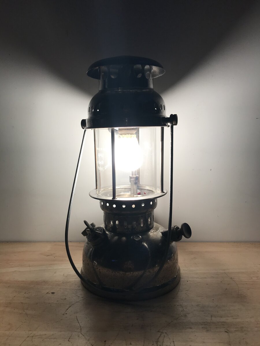

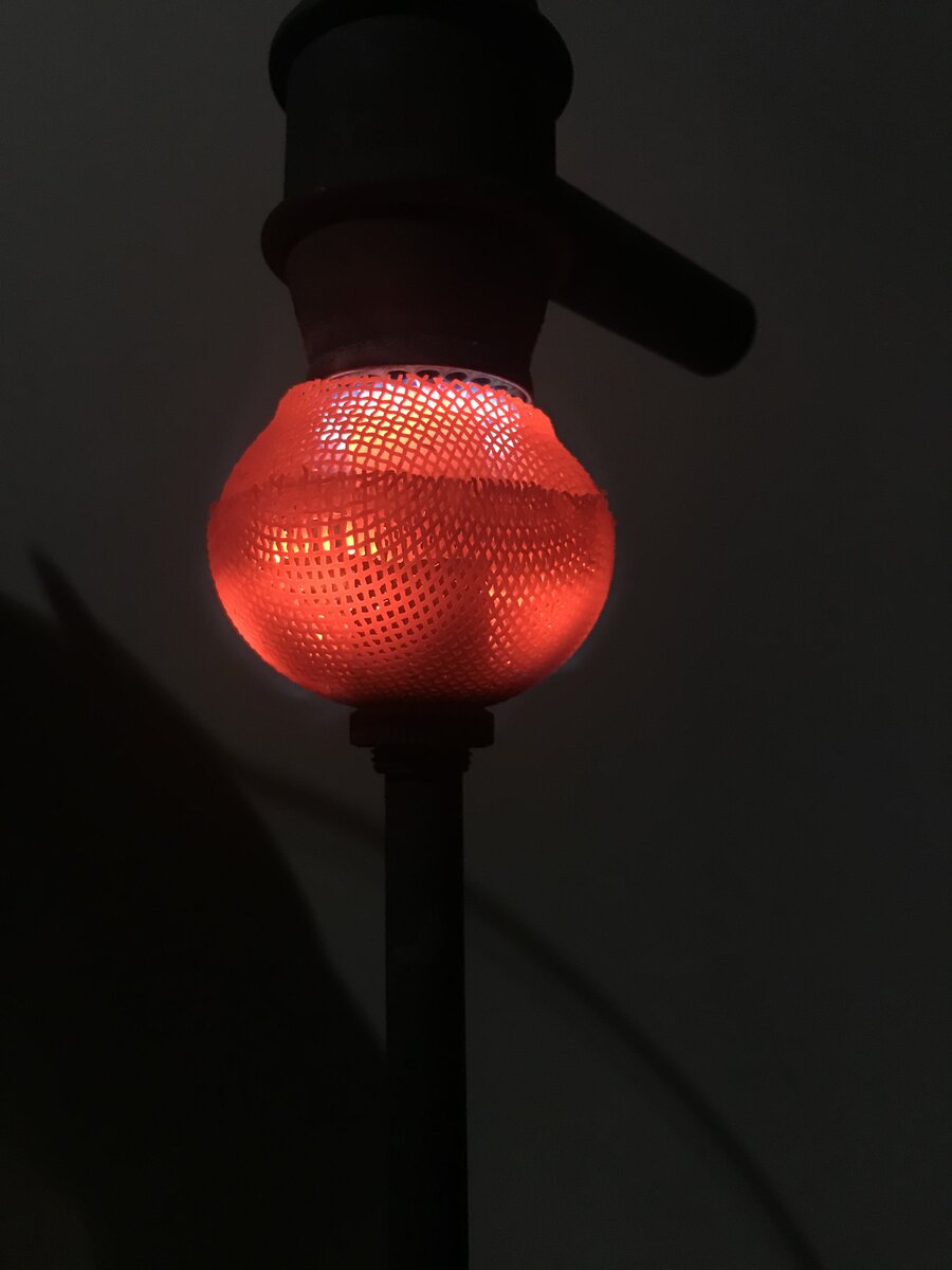

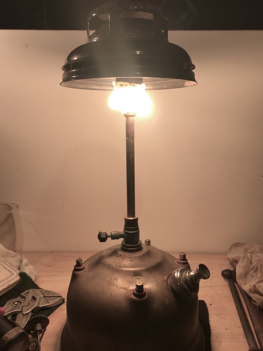

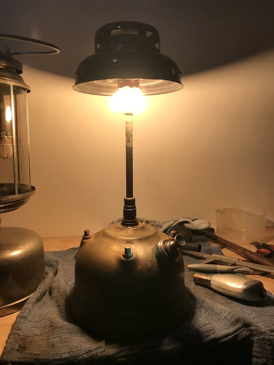

  22. Tony Press
    11,105
    @Nils Stephenson
    Here with a proper mantle, a Shields — probably among the best mantles available in Australia, but alas, no more.
  23. Nils Stephenson
    3,414
    That looks much better. :)
  24. Jacob van Pareen South Africa
    May 9, 2023
    221
    South Africa
    Thanks Tony, for sharing!
    The flame profile clearly shows that the mantle should rather be wider than longer!
    And that was the shape of your mantle!
