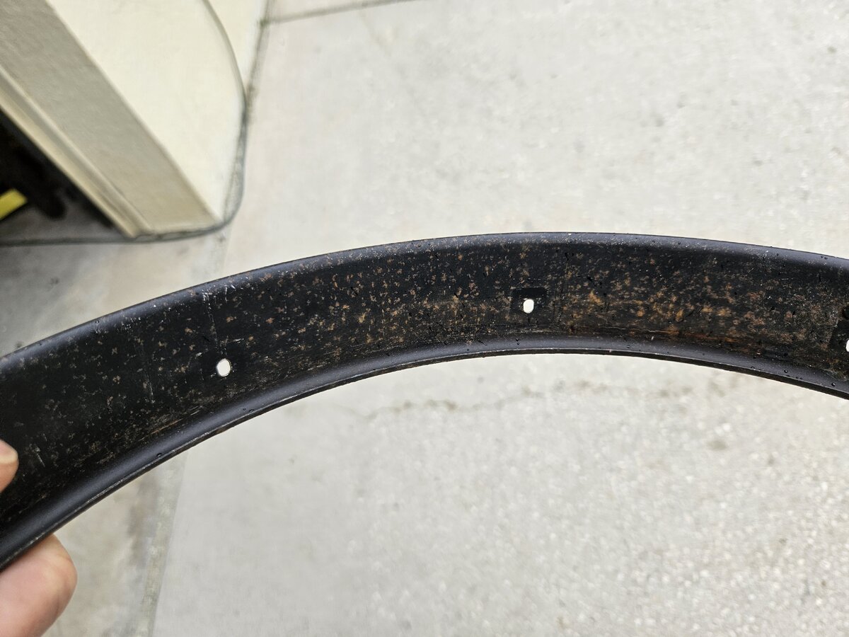

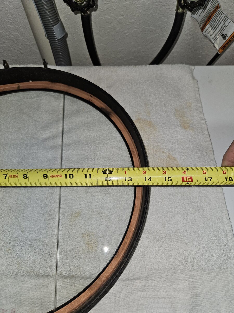

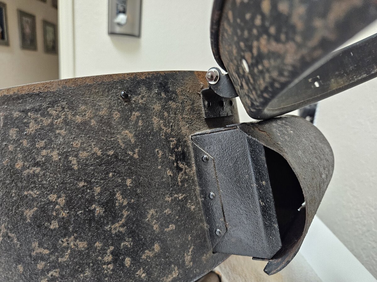

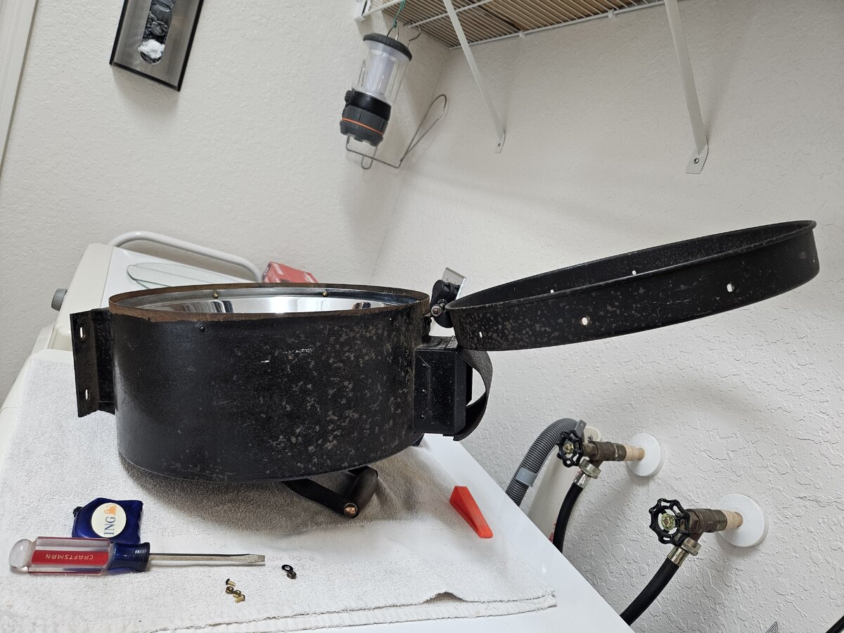

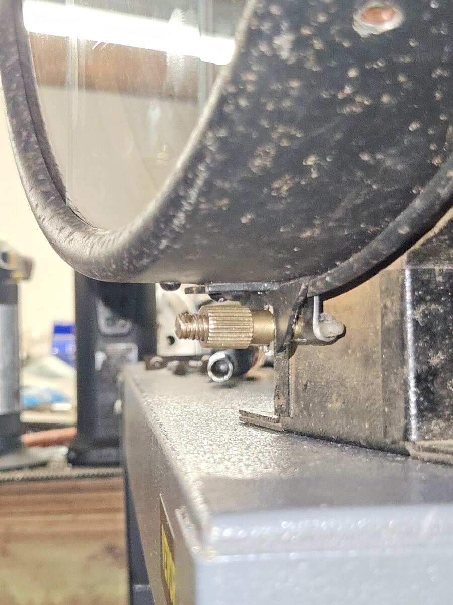

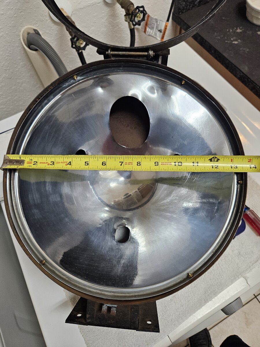

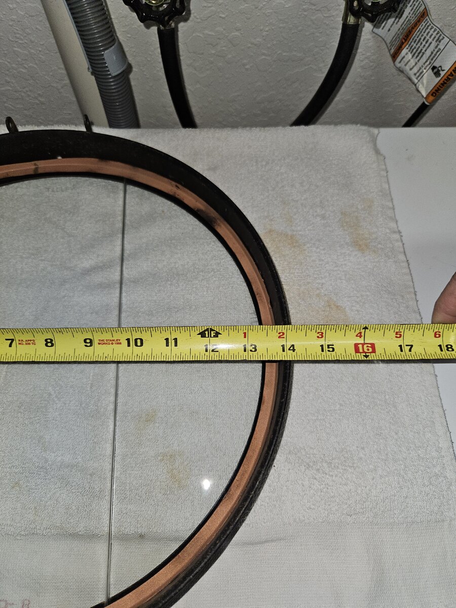

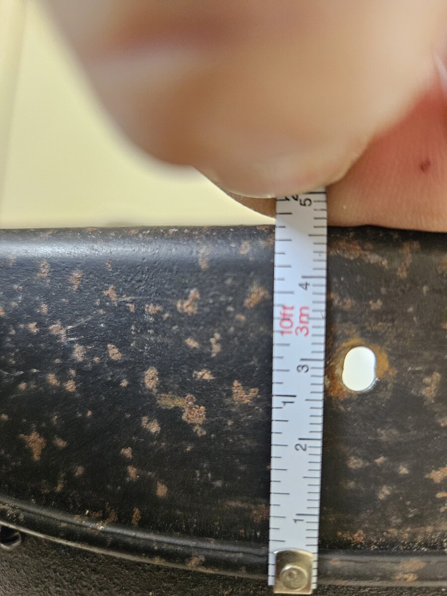

    A cheap , small measuring tape was the only thing I had that measures in metric , mine is the same across , 357mm . The top hinge is not bent out of shape and lines up with the housing hinge but my lens does not open a full 180° and hits against the hood
    That's the right measurement for the door.

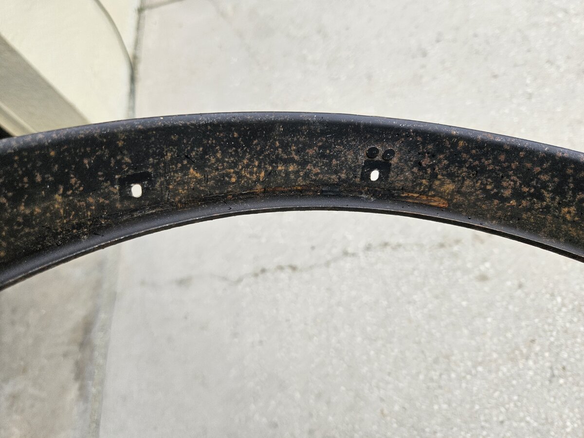

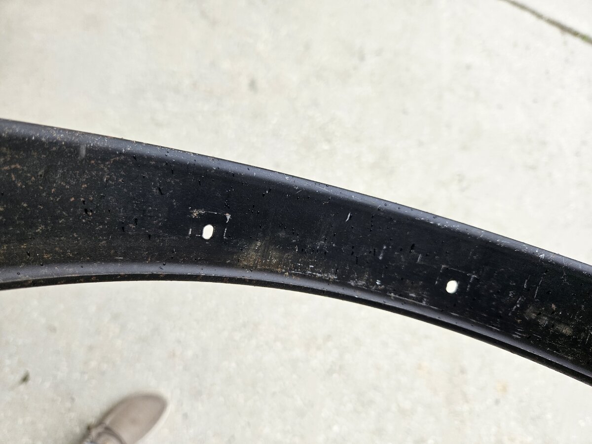

    Now... The retaining ring for the glass on the door should have 6 holes, as should the steel frame it sits in. The positions should evenly spaced starting at 12 o'clock, but with no screws/nuts at 3 or 9 o'clock.
    Why your steel door has more holes than that is still a mystery to me... But I'll ask around.

    I greatly appreciate that , the door should open far enough to stay open/upright on its own correct ?
    Not really… it’s a bit precarious.

    I'm almost at the point of just lining 2 holes up and drilling 8 more , really not wanting to ruin this copper ring if I can find the correct steel frame or vice versa.

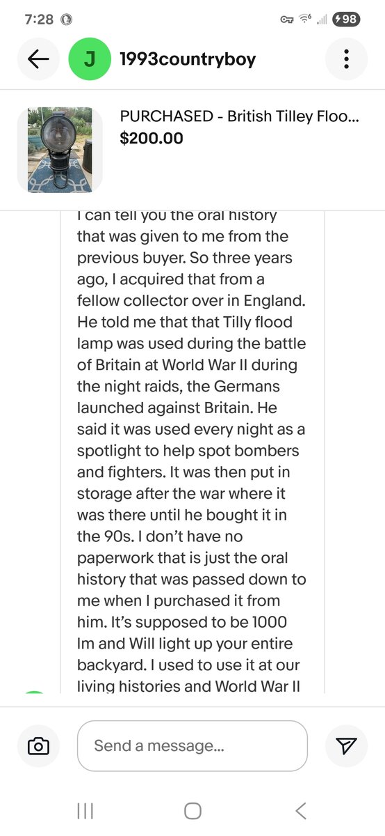

    So am I down the correct ventilator nut and print on globes and RR story beats the "crock of crap" I got from the seller but still doesn't explain 10 holes vs 6 when all 10 are identical , spaced and shape

    Not a bad price… I must say, though, these are floodlights, rather that spotlights. It’s the Tilley SL1 that was used as a spotlight. But the FL6 was used extensively during the war.

    @Anthony , I'm still having a hard time believing it (the outer steel frame) was modified by anyone after it was made , all 10 holes are identical , evenly spaced and shape . Id hate to drill 8 more holes in the copper ring only to have found a frame with 6 screw holes . I also want to get the housing , lens frame , and base cradle off to get media blasted , and have the cradle powder coated.

    Was there ever some sort of different retaining system for the lenses , I kinda expected to see an unfaded ring from the copper but in the sunlight I noticed most all of the 10 holes on the inside look like it may have had 20 square "L" brackets or something similar

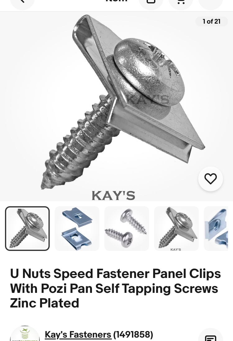

    Now what , highly unlikely I'll find 10 original brackets so I'm currently faced with drilling 8 new holes in the copper ring and having 6 empty that don't line up with anything , cut the copper ring into 10 "L" brackets , or hope for the best and someone has the brackets to sell me. Either way I think I'd like to keep the 10 hole steel lens frame
  20. podbros
    4,104
    There are lots of these available online?
    You could always make some little “L” brackets to sit under them?
    Regards
    pb
    seems a shame to cut the copper ring though so maybe make some out of galv sheet?

    Ultimately I'd like to stay all original. I can find most any "L" bracket in my local hardware store but so far they all have pre drilled holes on both ends and holes are too big

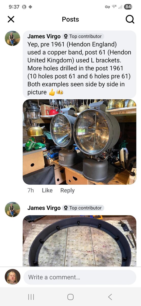

    Got this reply on a FB Tilley page

  26. Tony Press
    I went through the Reference Gallery again, carefully looking at post-1960 FL6s.
    My observation concurs with the view that the move to 10 holes with L-brackets to hold the glass in the door was feature of FL6s made in Dunmurry, Northern Ireland after the move from Hendon.
    Thanks, James Virgo.

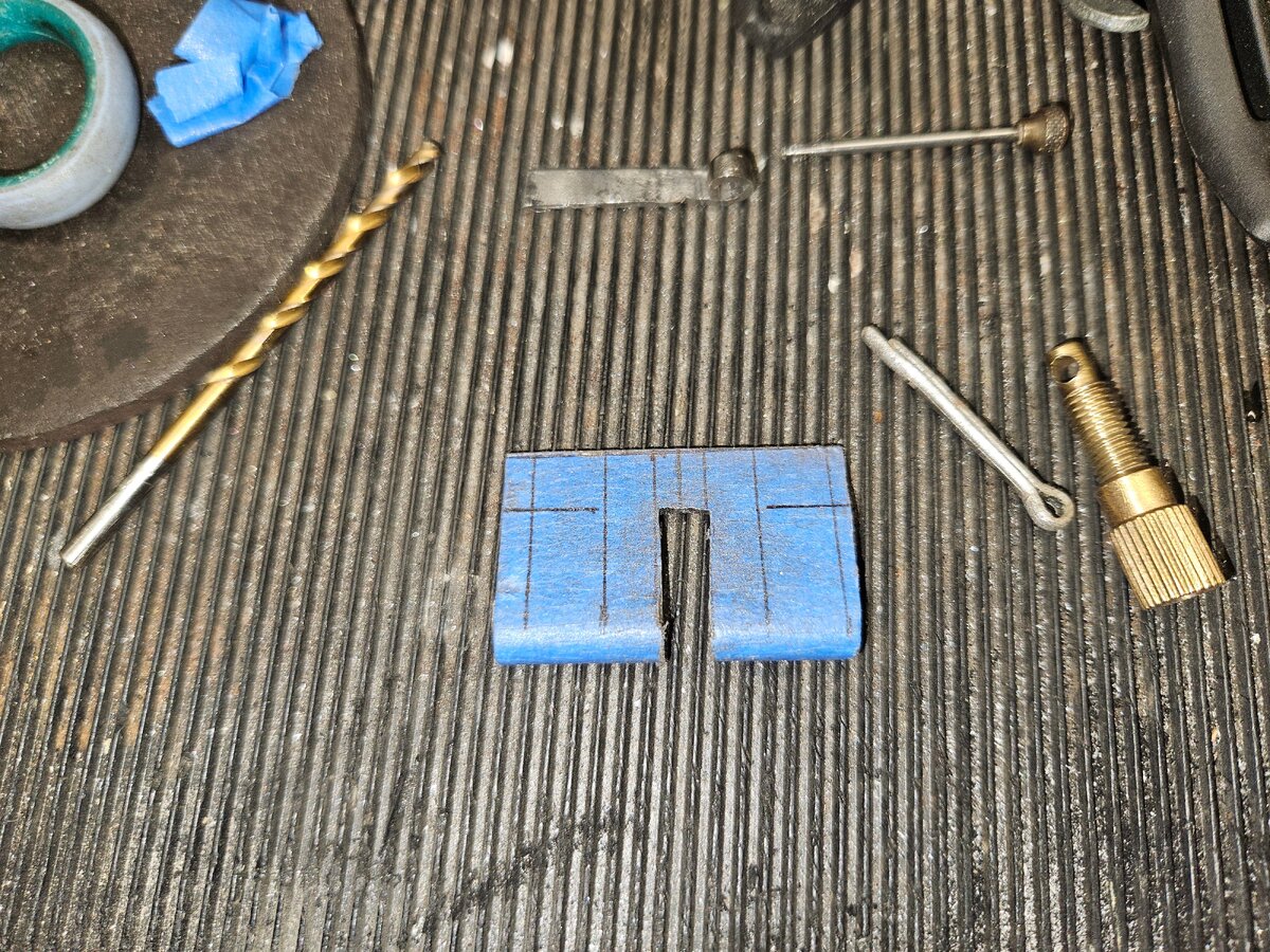

    I may or may not , maybe the right door but wrong retaining system or vice versa. Just for fun or to see if I could I made another hinged locking bracket , I don't care for it and won't use it if I can get an original
