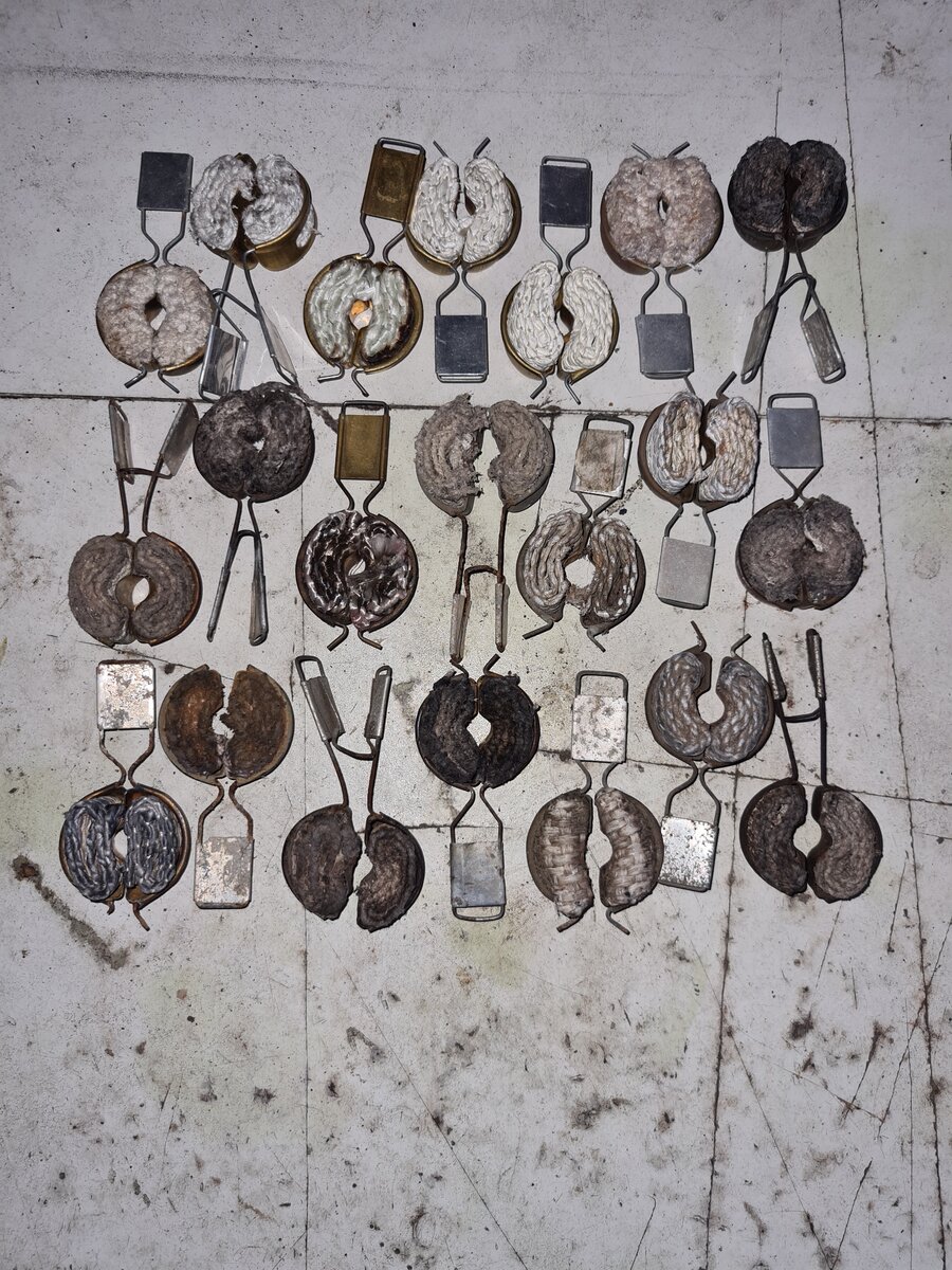

    Here is a picture of about 90% that I have and I only use one.
    I hope that helps you.

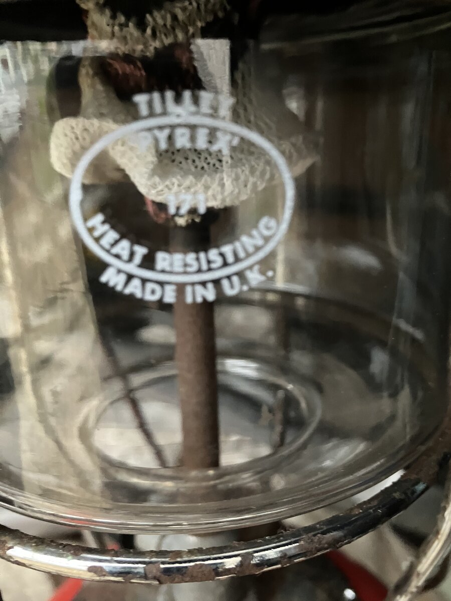

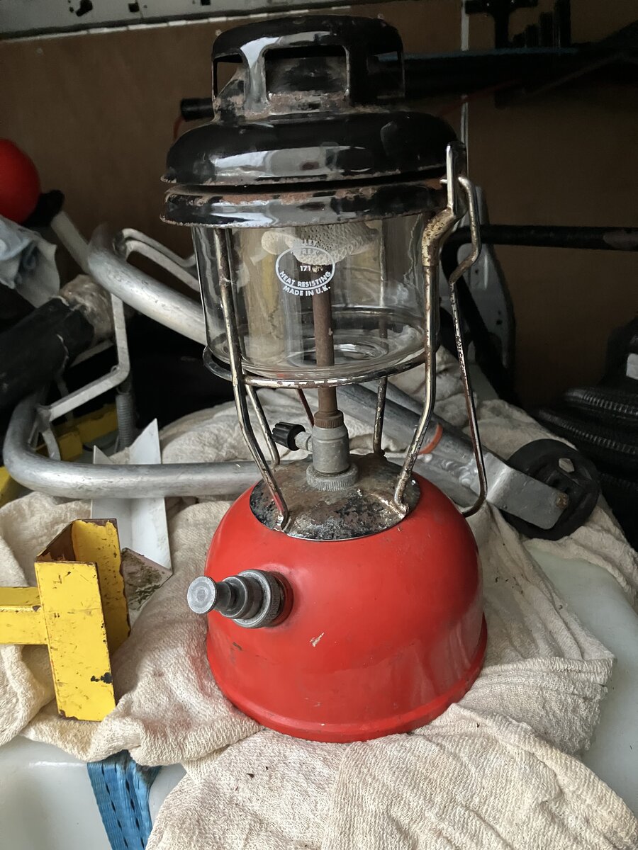

    Here is the lamp just got it
    46518395-42AF-4BDC-9B0F-E72F0F62719B.jpeg 4276F274-27D9-4474-A6A8-4C5E0CC0511E.jpeg
  9. Buggerlugs
    2,373
    It sure is a Tilley X246B.

    Just tried to get it going but the pump rubber has a split so won’t hold pressure guna pop back and change it for different one she has 3 in there may get one with pre heat thing :doh:

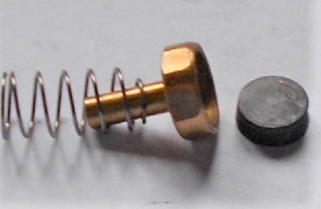

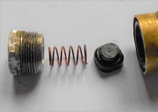

    @lee the fisherman the seals from Fettlebox
    Tilley Washer Kit
    are excellent quality and value for money but the ones for the
    pump NRV (non return valve) & control cock won't fit the modern lantern. This is because the older style is a disc stamped out from a sheet which sits in a small brass cup brass cup whereas the ones in your lantern are molded individually and fit directly into the spring.
    Old style
    New style
    One source
    pack of 10 TILLEY LAMP CONTROL COCK NRV WASHERS NEW STYLE 155 - square raised
    All the other seals are compatible.

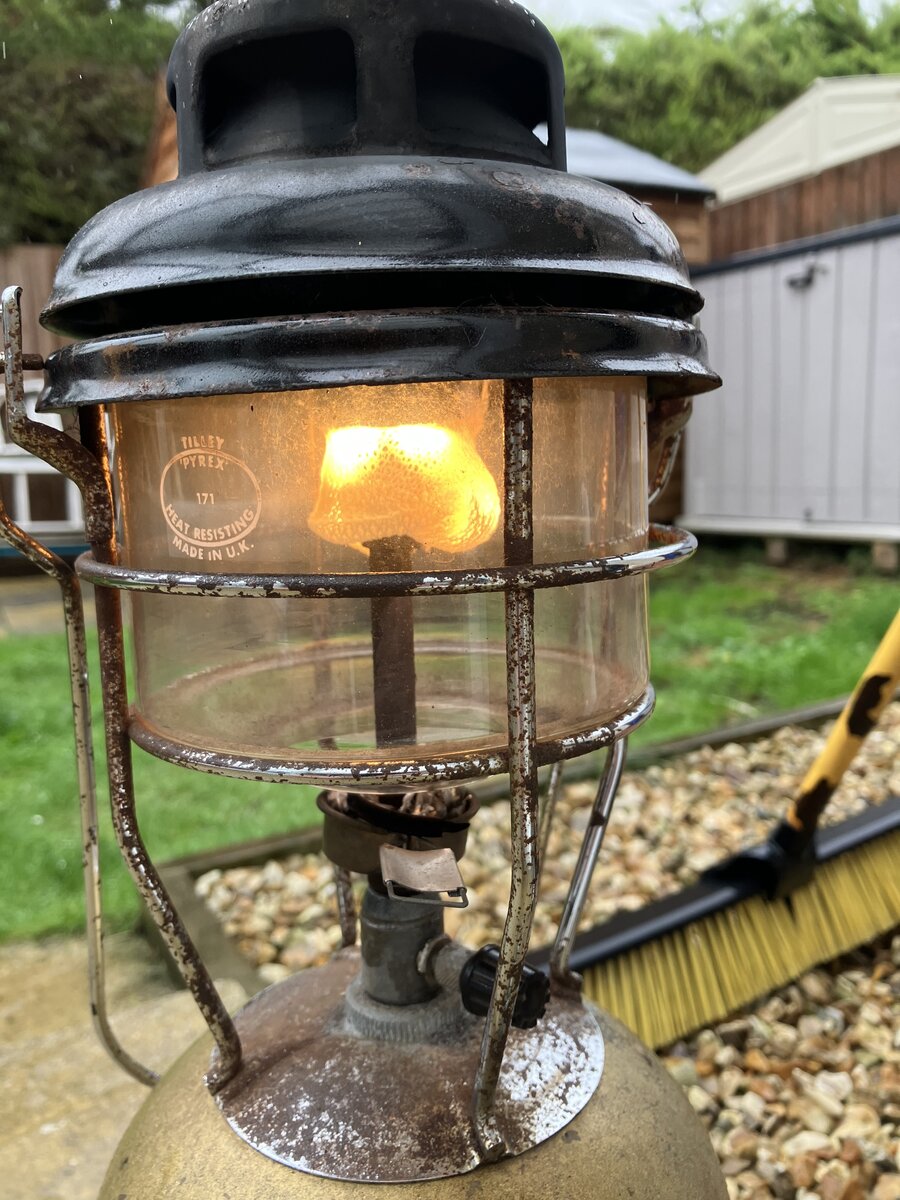

    Got it going guna do another test run tonight in dark had a slite fire ball to start think I didn’t pre heat for long enough :doh:
