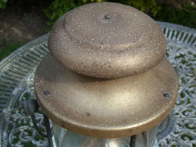

    Neil will no doubt tell you all you need to know about your amazing lamps. After finding my unusual version it has bugged me ever since. A lot of questions that can't be answered at this time. S.D.R. What does that mean, I saw a Australian advert that said they had special reflectors and said they were beam lamps so possibly special distance reflectors or even special dural reflectors, just possibilities. It's interesting if you check the original drawing for the patent number http://worldwide.espacenet.com/publicationDetails/biblio;jsessionid=541B7303C0EF2DE9AEC478A6A1DA8554.espacenet_levelx_prod_3?FT=D&date=19460909&DB=&&CC=GB&NR=580472A&KC=A&ND=1&locale=en_EP to see that it has a seperate filler and pump and the same tubed hood and even mentions that it could have different surface finishes to the glass as my lamp has. The whole hood on my one is made of aluminium and no idea what the finish is. Hope Neil sheds some more light on your great find. He will no doubt have an idea about the yellow paint.

    The alu-top on your lamp is really strange. I have never seen a pressurelamp with a alu-hood and aluminium is a rather new material to use in production. The hood of my lamp is solid brass and very heavy, so your lamp must be a improvement and a later model I think.

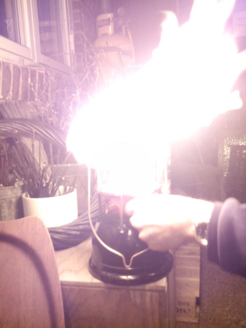

    The 4 lamps came from the same place we were told. The 2 new lamps didnt carry a yellow spot. My "user" did, and also the other used one belonging to the other lamp-guy. When I wanted to test the userlamp, then it ended up in flames first time 1395530427-SDR_i_flammer_031_opt.jpg :shock: :shock: :shock:
    And I had to change the vapourizer. After that it was burning very nice and bright - but - the yellow mark on the hood thereafter disappeared.
    I think it simply is a "fault"-mark, showing this lamp needs TLC, showing it is not useable for now. We do the same with our fencing-equipment when it fail during tournaments.

    What I meant was I didn't know what the finish was to the hood, although in the photo it looks like all the other brass hoods when you see it in natural light it is actually beige/gold colour hard to explain but a unusual colour anyway. Neil said he didn't think that very high temperature paint was made that far back, could be anodised I suppose. It has pimples the same as the reflectors, doesn't look like your reflectors have that problem or did you polish them out?

    The hood is without any traces of bubbles/pimples and the reflectors too.
    I did only do surface-cleaning - no rape-polishing at all.
    The hood do look a Little strange in the surface as it looks like the productionplant didnt polish them after pressing them. It is still possible to see the marks from the pressing-tools and the surface didnt get brass-old like brass normally do. They did look a bit more gold-ish as you suggest and I cant help thinking "white metal" wich were used a lot in the 1960's for doorhandles for cars, often cromed afterwards.

    Hope the cat has recovered. Your lamp looks exactly as it should, I think the brass is affected by the heat. Thought I had a photo that showed the colour of my lamp but it looks pretty much the same as yours in the photo I will try and take a better photo for you. It was one of the first things I noticed when I first saw the lamp then I noticed the seperate filler, the glass was very dirty and I had thought that someone had painted it half black but when I started to clean it I noticed it had a mirror finish. Wonder if your pump is original not sure what lamps used these with the ears on, have seen other pumps on the S.D.R as well.

    You might have something there, the finish on my Alloy parts have gone a bit like the old die cast door handles on cars kind of pitted or bubbled.

    http://0flo.com/index.php?threads/224 This one has the same pump. Just weighed the complete hood on my one and it weighs 405g probably not much to go by but I also weighed a x246 type 1 and it was 506g, noticeably heavier. The hood cap is not magnetic.

    A shot of the hood on my S.D.R
