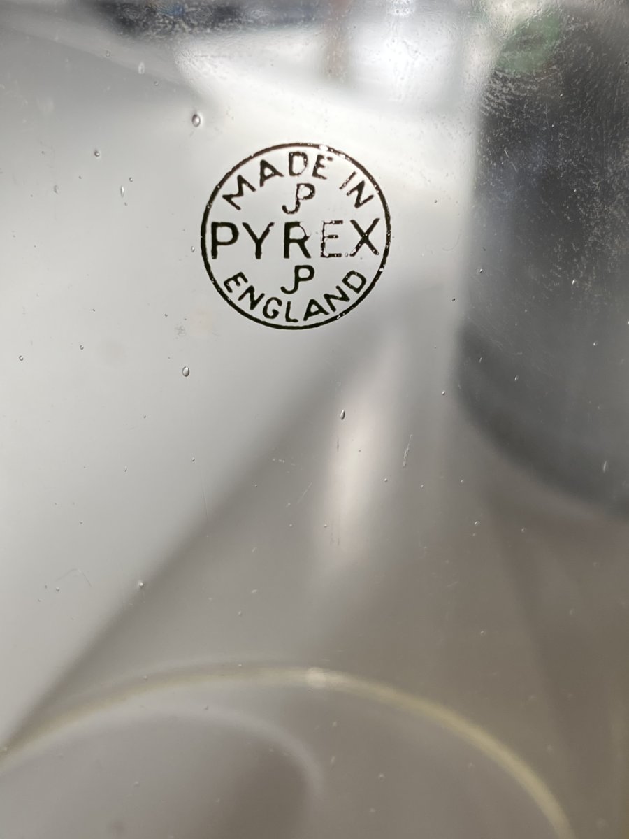

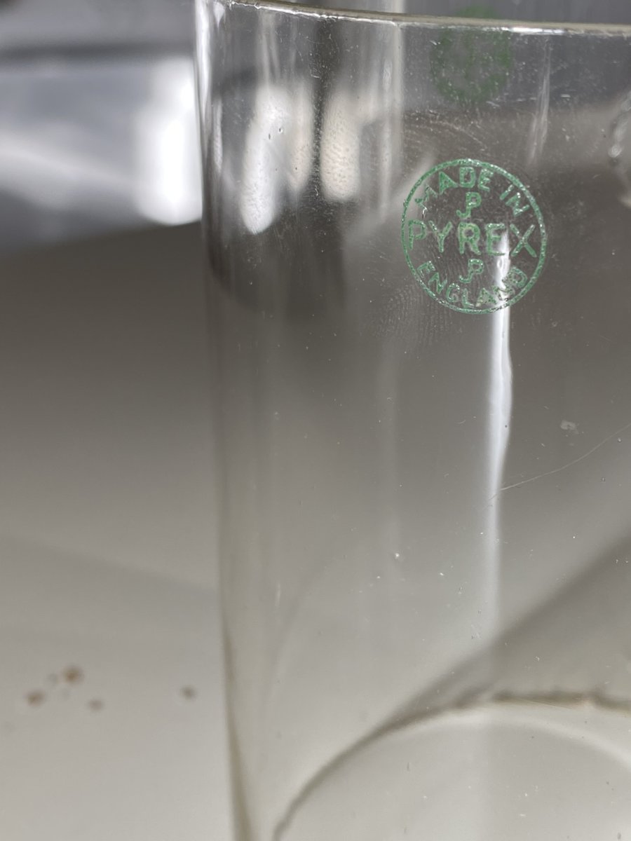

Jon, the glass or globe on your lamp I find extremely rare, as I have never seen a glass with a hole AND two , not one, green logo's. Could you make some (detailed) photo's of it? Mike
Thank you Jon! I find it remarkable this glass has two identical logo's, perhaps a production error. But I have not seen them on glass with a hole anyway. It only adds to the uniqueness of this lamp. Perhaps it is time to make an inventory of all the variations of W&B logo's still out there. In the gallery there is a later glass -without a hole - that has 'Vapalux' in a bow on top of this logo: Matthew's blinged 300X. This imo is also a rare-as-hen's-teeth glass: I love it. Due to their fragile nature original glass is much more rare then the lamps. Their often short production -based on the logo's - is another major factor.
